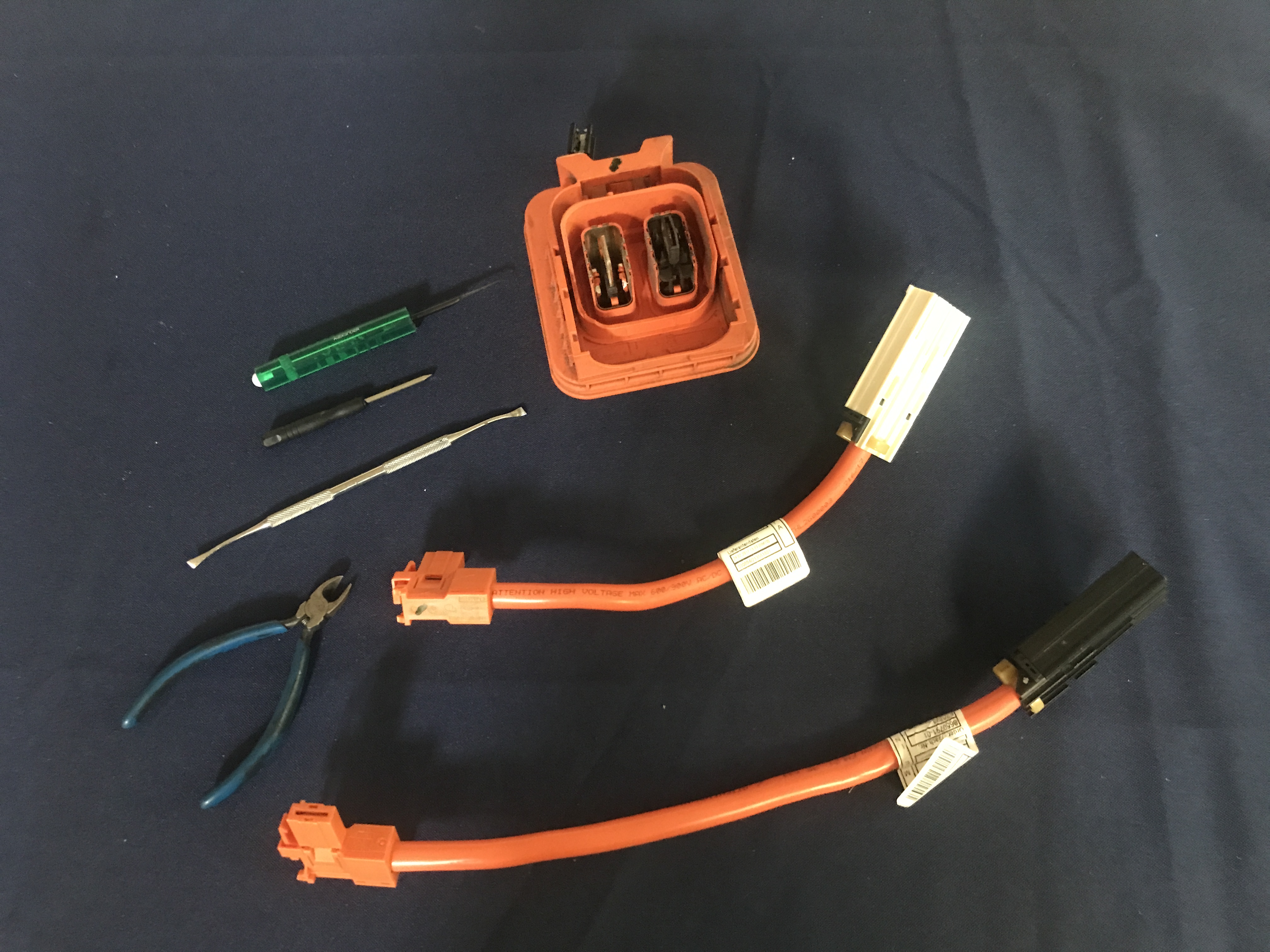

I also did a write up on BMW Hybrid Battery Cable Connectors Reconfigured Rekeyed
in order to eliminate the OEM output plug (one less connection to worry about)

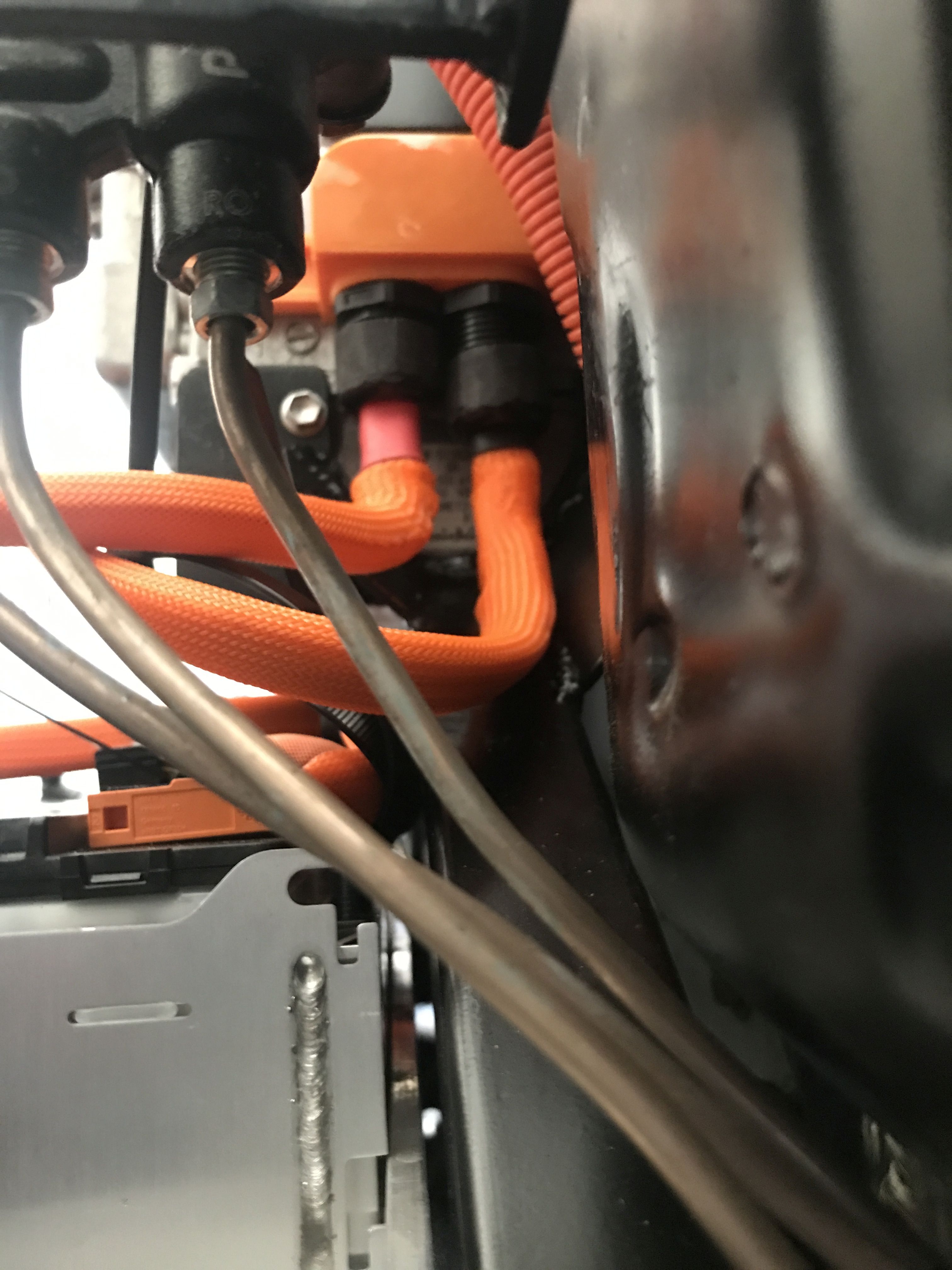

then I cut that longest OEM 5' lead in half to make two leads to the Inverted out of it

a little close up of the leads going into the inverter, 90% of all that orange will be out of sight out of mind

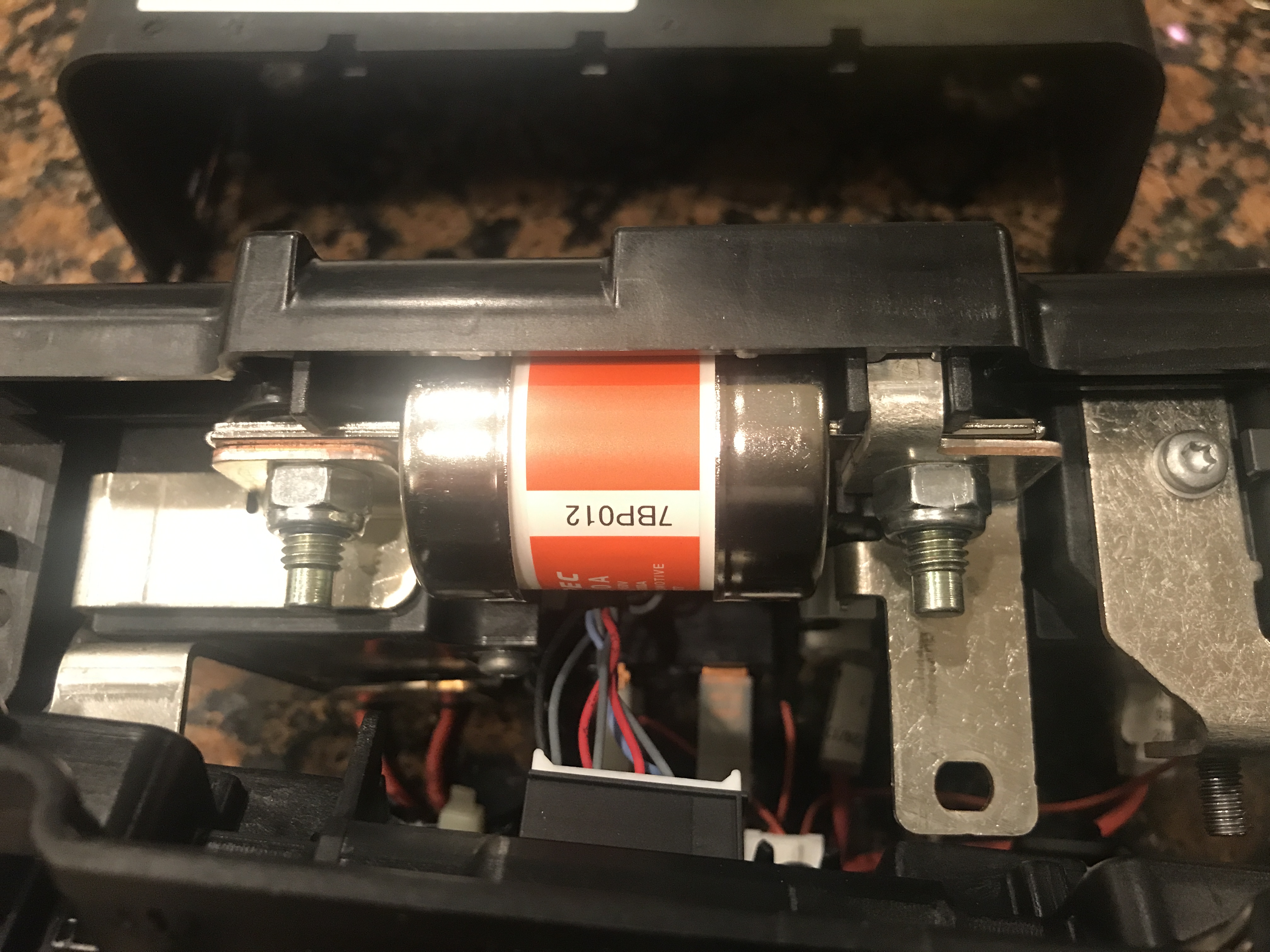

I usually like to keep to myself (I'm a very private person... I'll wait till you stop laffin') and work in the privacy and comfort of my garage, but the wife insisted I do this next part on our granite kitchen counter tops
the butter knife is there for scale purposes I so did not use it to pry that plastic lid off that it would fit perfectly under the tabs if I or any other person decided to use it in that matter, but I didn't, I swear
time to check the B.A.F. Big @ss Fuse
it beeps so I recon it's good, plus I would expect it to make a mess if it had a bad hair day

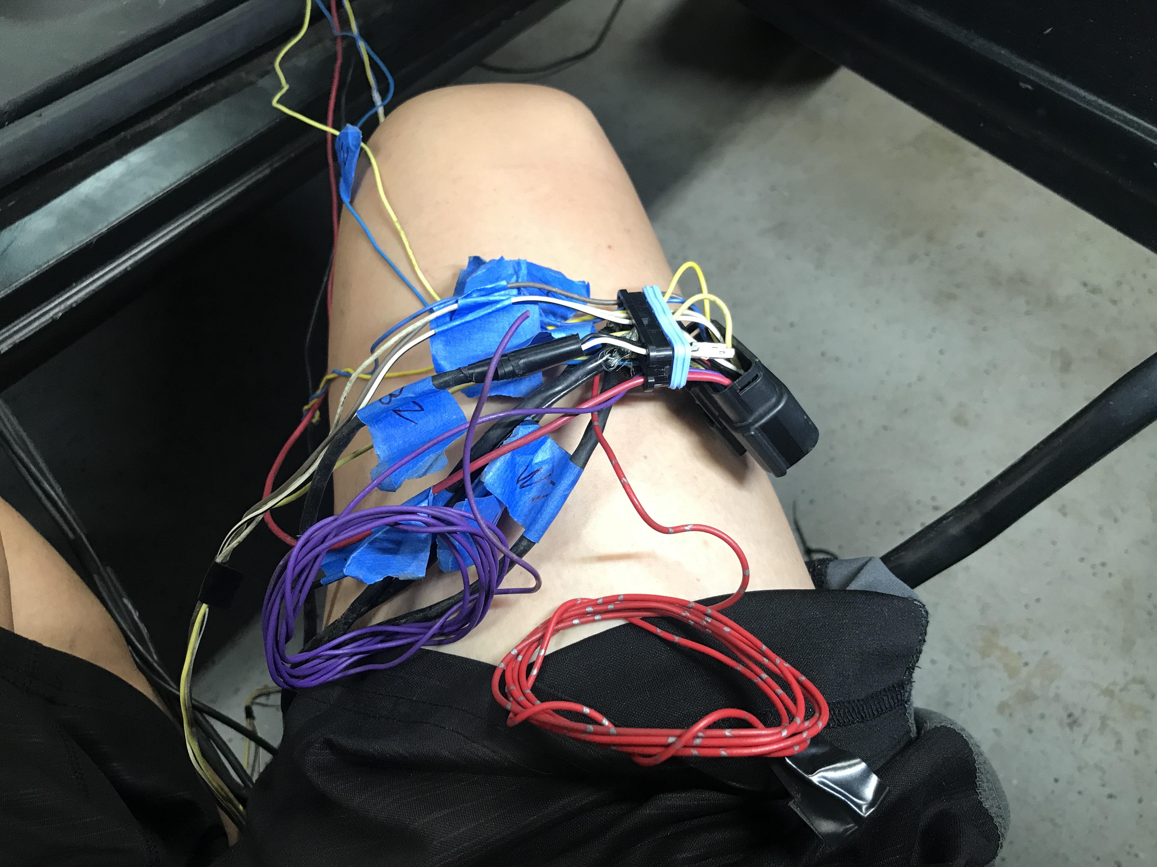

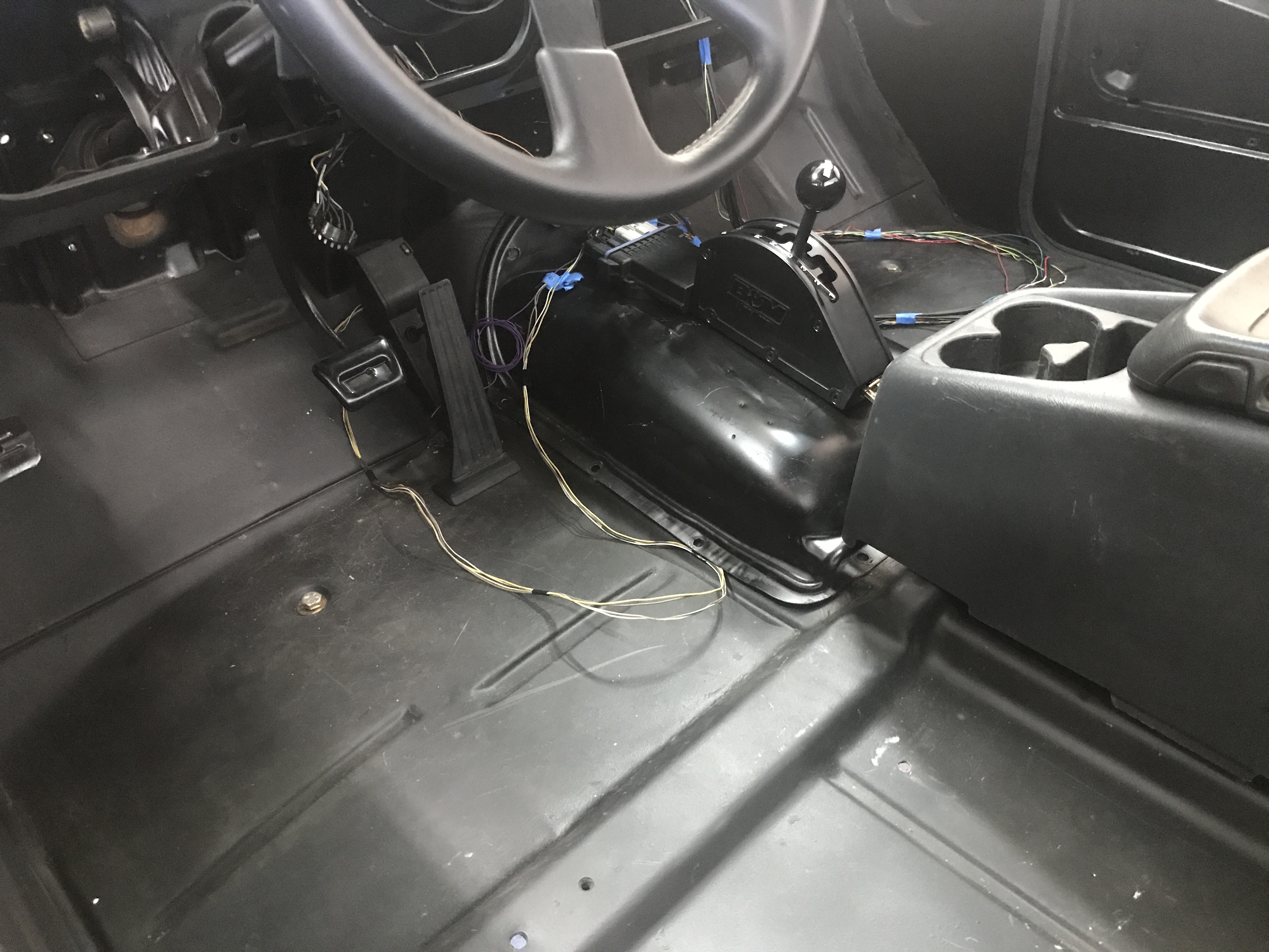

4 hours of unpinning and repining and all I got to show for it is the VCU and throttle pedal are now on the other side of the firewall

got the second connector harness through the firewall and now the EV Vehicle Control Unit (aka VCU) as well as the skinny pedal live in the cab, getting ready for the next test from within the cockpit, the goal still being running and driving truck by the end of this month

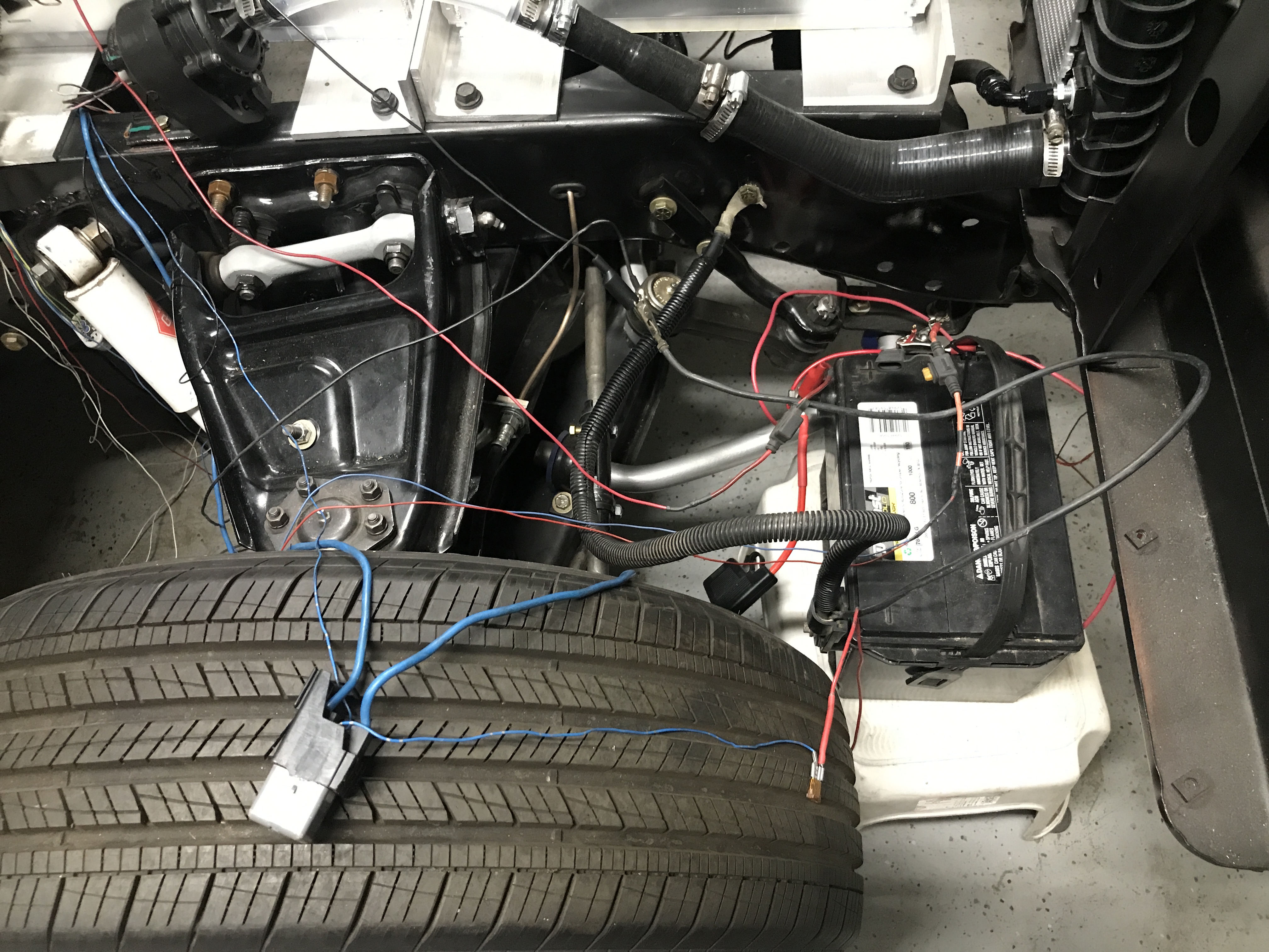

got the Lexus GS450h transmission external electric "oil" pump working for the first time today, I was so relieved to hear it a pumpin' up to this point I had no idea if it was good or not
since I bought the OEM wire harness with the fuse block I believe this is the OEM original relay

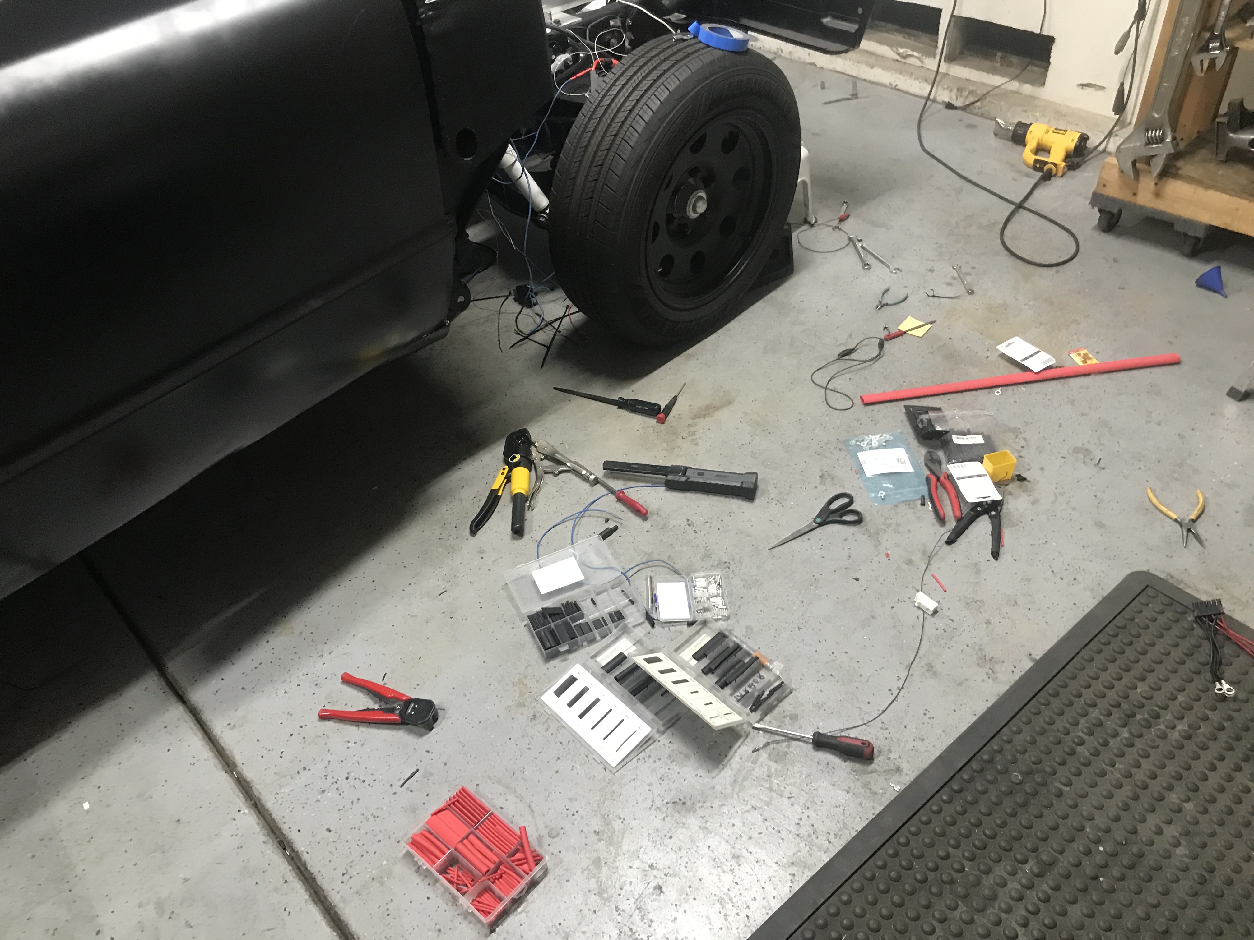

well that escalated quickly, as I spun my wheels all evening chasing over a dozen grounds, I think I'm gonna list them all for prosperity if you see one I missed please let me know (also I think I will brand the apparatus cause details are good) may take me numerous updates to this post plus it's midnight
