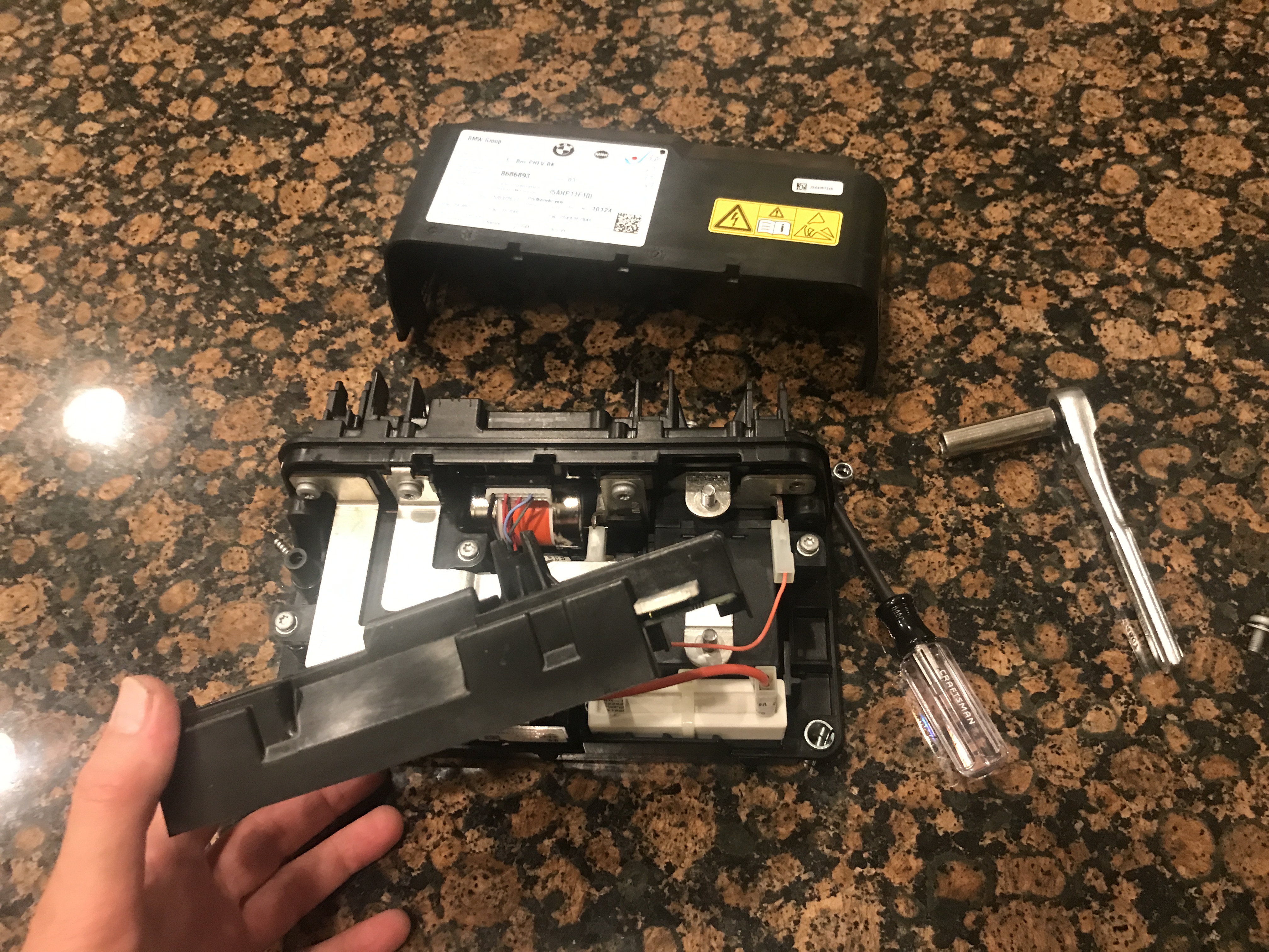

I also did a write up on BMW Hybrid Battery Cable Connectors Reconfigured Rekeyed
in order to eliminate the OEM output plug (one less connection to worry about)
so I'll just post some highlight pics here

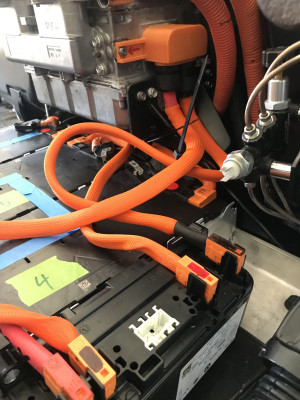

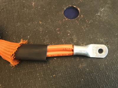

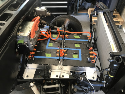

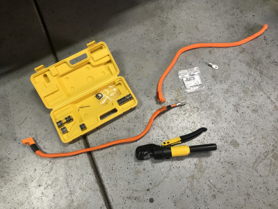

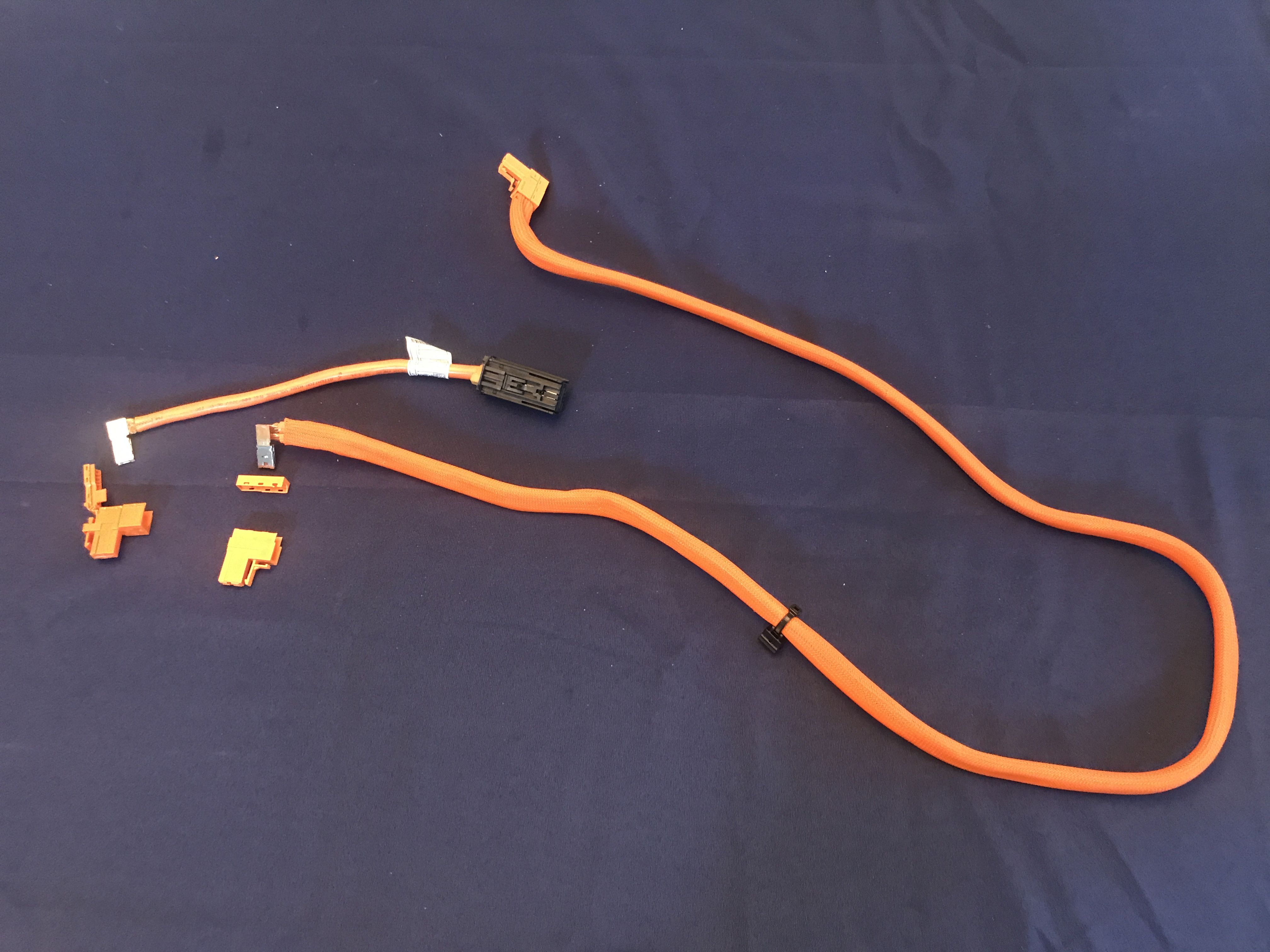

then I cut that longest OEM 5' lead in half to make two leads to the Inverted out of it
- Gregski
- Posts: 2743
- Has thanked: 500 times
- Been thanked: 946 times

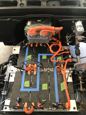

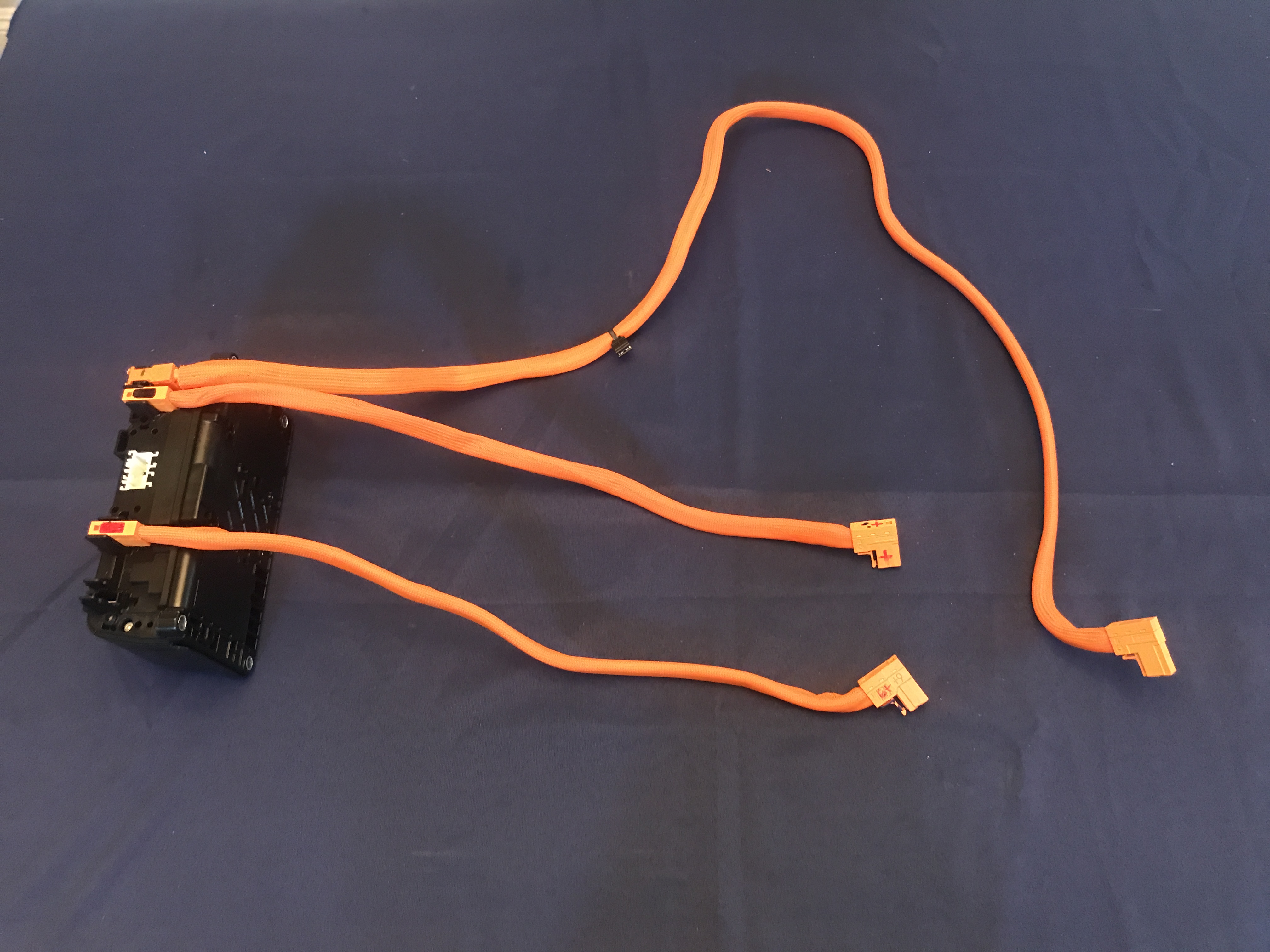

then I assembled it all for what I hope is the final time, the S shows how they are connected in series
- Gregski
- Posts: 2743

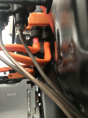

a little close up of the leads going into the inverter, 90% of all that orange will be out of sight out of mind

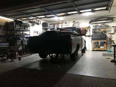

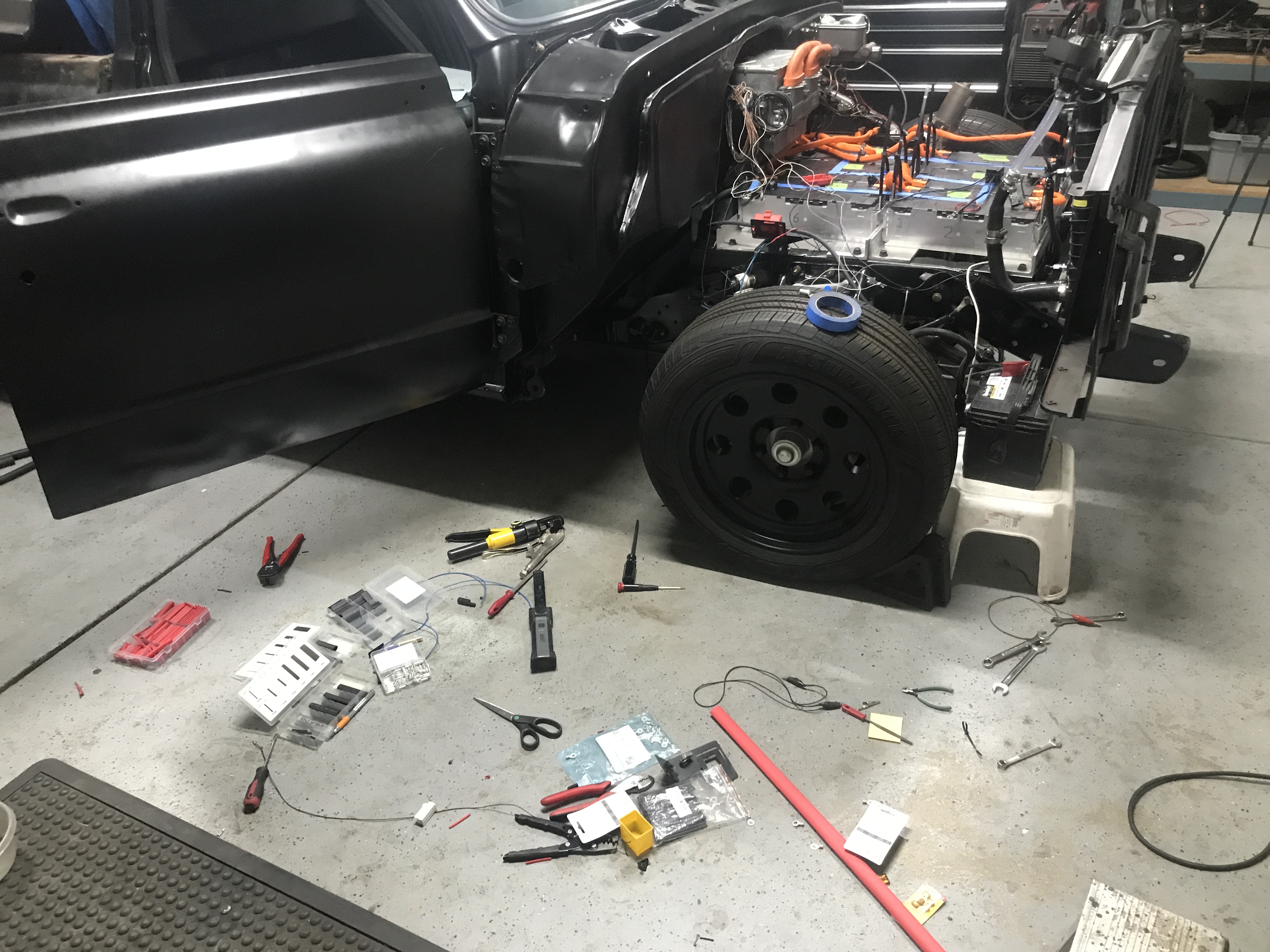

just another day at the office
... so close tonight ...

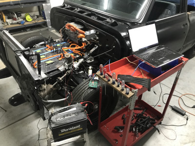

so here's where we be at, I am using the OG VCU ver 2 (the pre ZombieVerter hardware)
your help and advice is greatly appreciated
- battery, safety box, inverter, trans, vcu, and throttle all hooked up (no DC-DC converter, no charger, no BMS, yet)
- throttle calibrated
- torque set to 500
- the S box sees: 347 volts
- the inverter also sees: 347 volts - but they drop quickly 310, 260, 180, 80, 60, down to zero type of thing without me doing anything
- Posts: 1020
- Has thanked: 405 times
- Been thanked: 260 times
Not familiar at all with VCU. Barely at all familiar with OpenInverter software.
What you're describing matches what you'd expect if the power was connected, then disconnected.
I.E. You power up the inverter slowly through the pre-charge contactor that has a resistor in series with it so that the capacitors slow charge (1-3 seconds), rather than try to charge in 1/10000th of a second and blow each other up. This charges the capacitors. Normally what happens next after pre-charge is the main contactor engages that shorts out the pre-charge contactor, or, well, there's 3 or 4 variations of what clicks and clacks in a pre-charge setup, there's several ways to do it.
So that the inverter isn't left charged at hundreds of volts even when unpowered, the inverter has a resistor bank to bleed down the capacitors in a few seconds. Capacitors don't hold a lot of energy, so this is normal and not a lot of power is wasted.
If you pre-charged, then, instead of engaging the main contactors you just... did nothing.. and disconnected the pre-charge contactor too, you'd see the voltage slowly drop as the resistor bank bleeds the capacitors safely dry.
The reason you might not see the wheel spin at all, or just barely, is maybe because you're trying to spin the wheel just off the energy left in the capacitors. Seems ballpark right that you'd get enough to turn the wheel over a few times and that's all.
So, all adds up to: Main contactor isn't turning on.
Check wiring on your safety box, check our connects between safety box and VCU and make sure you've connected to the right places, check that main contactor actuates. Check code that it ever actually tries to turn the main contactor on, maybe it doesn't.

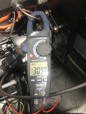

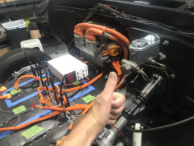

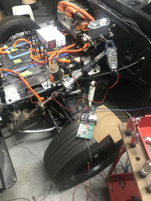

so I did a test where I connected a 300 watt (30 volt 10 amp) bench power supply directly to the inverter and the wheels spin just fine

more trouble shootin'
here I am bypassing the Positive Contactor in that black Safety Box and only closing the Negative one, and we see full voltage from the 30v bench power supply, so something is up with the Positive Contactor closing then opening, or maybe some circus board logic in that box, donno

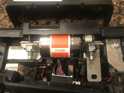

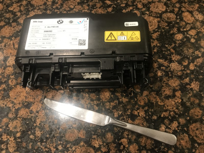

I usually like to keep to myself (I'm a very private person... I'll wait till you stop laffin') and work in the privacy and comfort of my garage, but the wife insisted I do this next part on our granite kitchen counter tops
the butter knife is there for scale purposes I so did not use it to pry that plastic lid off that it would fit perfectly under the tabs if I or any other person decided to use it in that matter, but I didn't, I swear
time to check the B.A.F. Big @ss Fuse
it beeps so I recon it's good, plus I would expect it to make a mess if it had a bad hair day

so great news I got it working, it turned out to be operator error, I did not understand/know how the logic of the S-Box code works, now I do, so here is how it works
anytime you execute a menu option (like close Negative contactor) first it opens all the contactors
So when I thought I was executing these commands stacked on top of each other, I wasn't

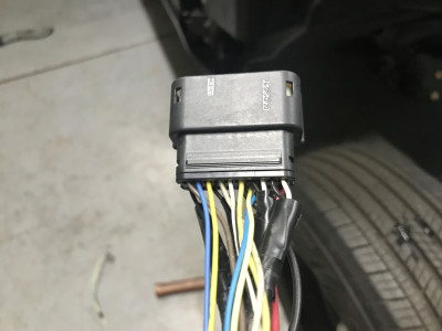

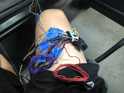

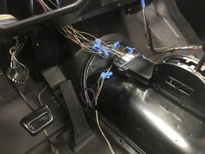

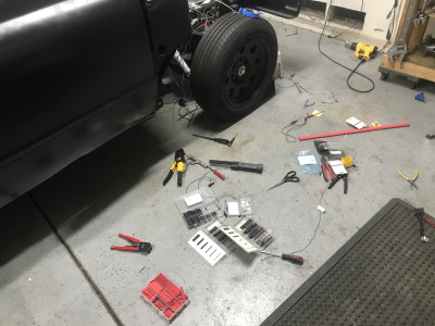

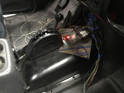

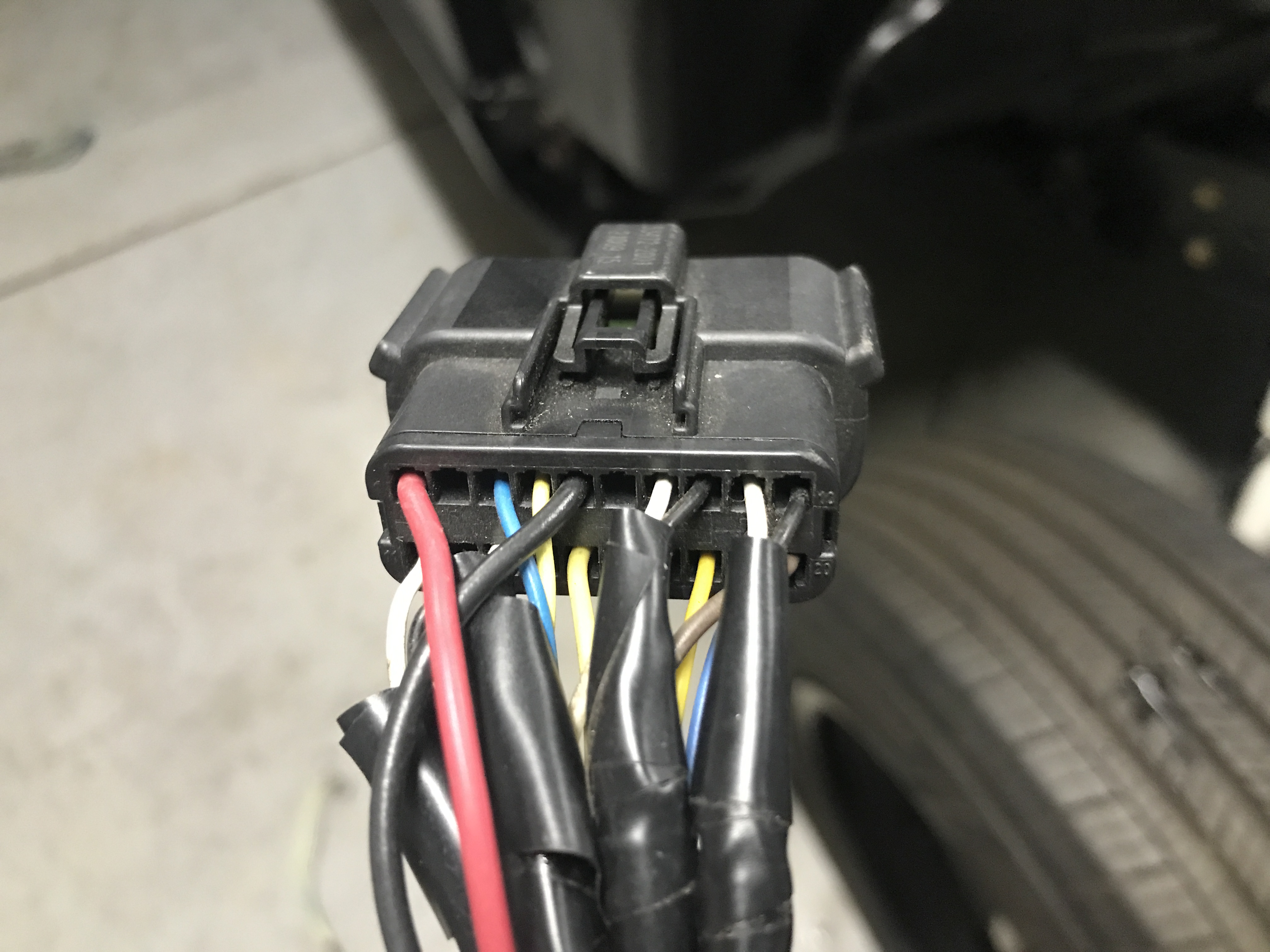

4 hours of unpinning and repining and all I got to show for it is the VCU and throttle pedal are now on the other side of the firewall

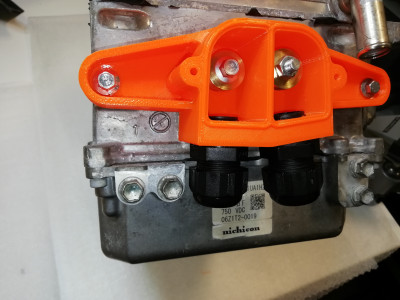

Updated side input port is now on Grabcad, the M20x1.5 thread prints a little lose on one of my slicers and a little tight on the other (Flashforge and Cura) . The small overhangs and threaded holes all print OK without support for me but YMMV. Let me know how you get on.

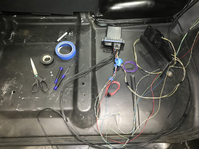

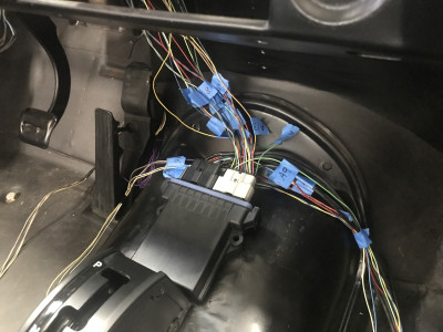

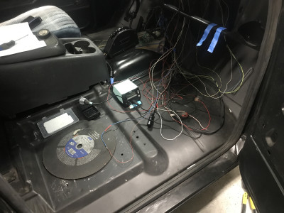

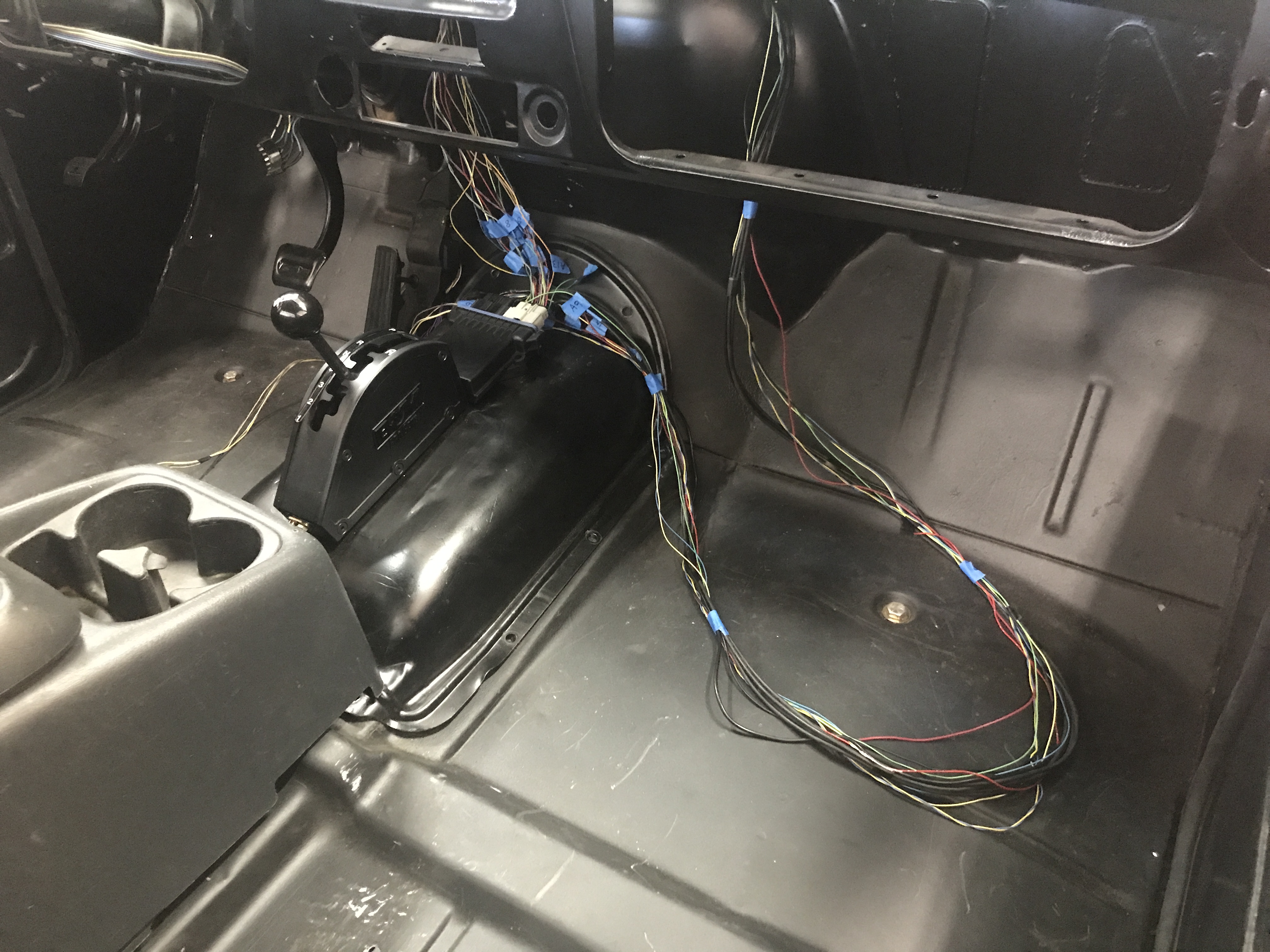

got the second connector harness through the firewall and now the EV Vehicle Control Unit (aka VCU) as well as the skinny pedal live in the cab, getting ready for the next test from within the cockpit, the goal still being running and driving truck by the end of this month

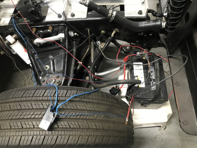

got the Lexus GS450h transmission external electric "oil" pump working for the first time today, I was so relieved to hear it a pumpin' up to this point I had no idea if it was good or not
since I bought the OEM wire harness with the fuse block I believe this is the OEM original relay
