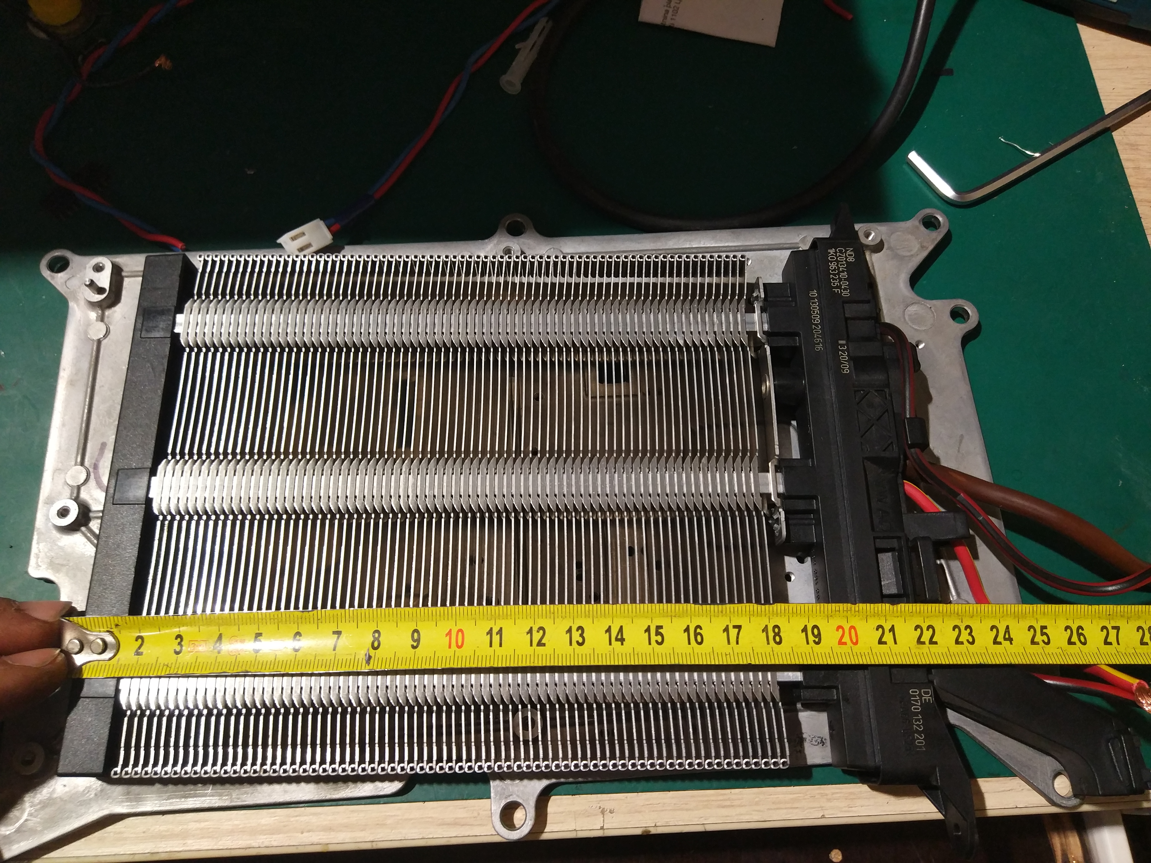

PTC preheater
I got this preheater in scrapyard for 20€!
It is like new. It supposedly belongs to VW Golf mk V.
I tested it and it provides about 800W from 14V source.
It has PTC characteristic so it is self regulated. If you lack the air flow its temperature will raise and with it the resistance.
This means less amp flow and less power untill you provide enough air flow.

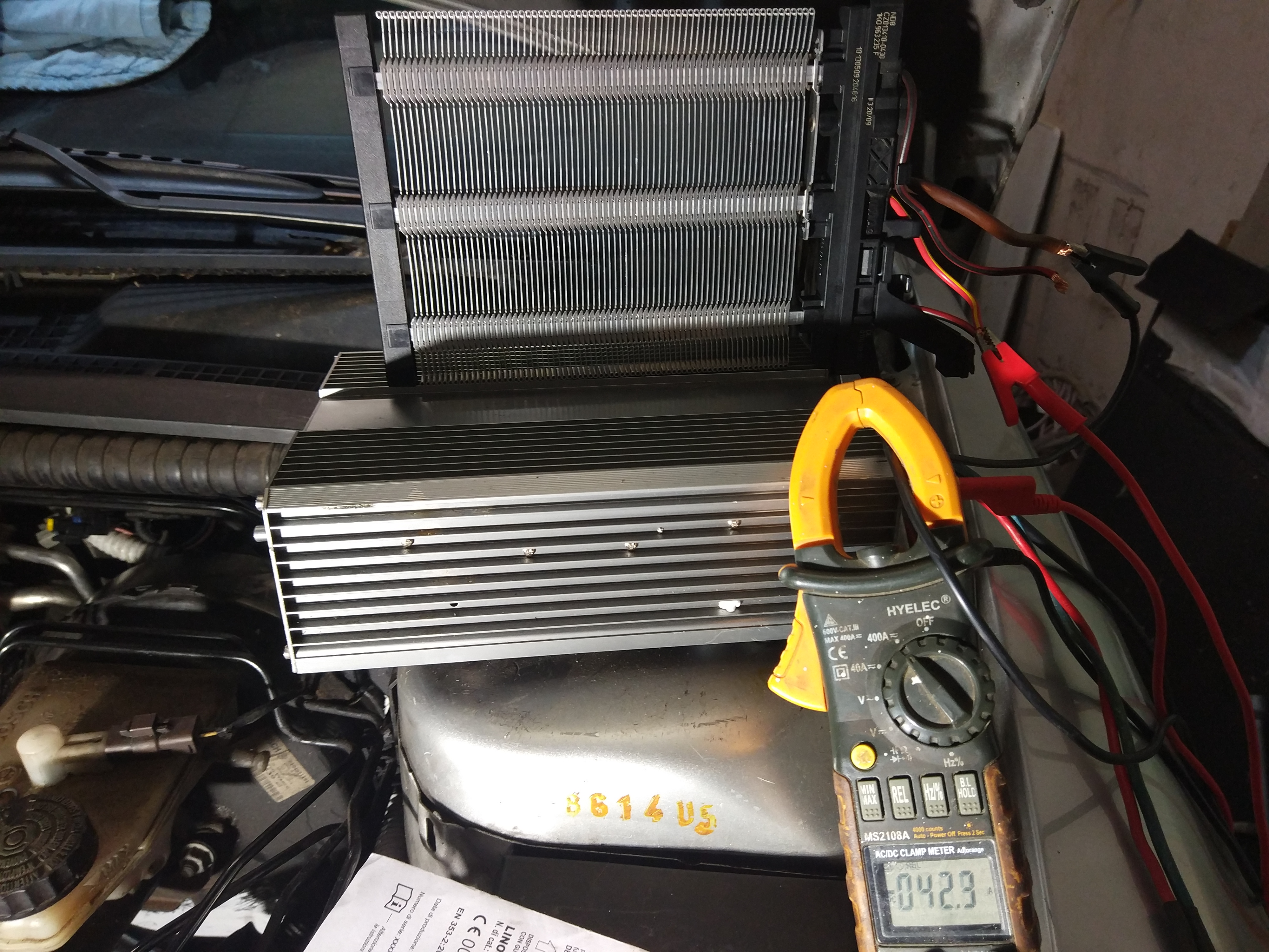

It has three power lines each worth about 25A. I tested it on my battery with power supply that controlled voltage drop to 13.6Vdc.
1st line is 25A = 350W
2nd line 42A = 600W
3rd line 56A = 800W
Strangely each element by itself consumes 25A, but if i connect two of them i only get 42A max and if i use three i get 56A.
Effective dimensions are about 150mm x 200mm x 15mm. That is the "meat" that is fixed into slot, but there is some 30mm overhang and cables that are outside slot.
My intention is to make a slot in front of the liquid heater to fit this so it will be in the airflow.
Then i will use 3x 30A relays and some switches to run it from inside cabin. Only when car will be running however!

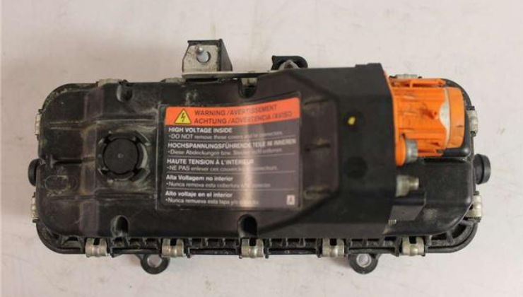

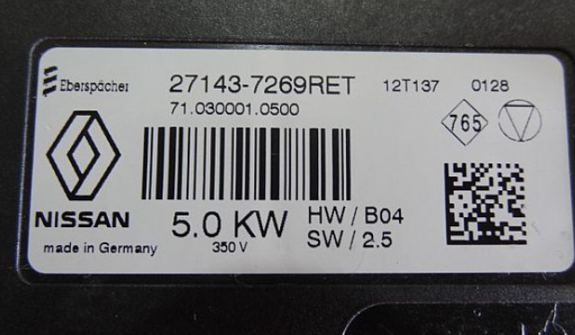

Can I ask if the 5Kw heater from the Gen 1 Leaf (27143-7269RET) is of any use for cabin heating into an existing heater matrix?

I am not sure. What kind of control is needed to run this at partial power? Is it 1kHz PWM or SW CAN?Cookie6000 wrote: ↑Sat Jan 04, 2020 5:04 pm Great thread this. Thanks for all the info!
I have the same question with heater, because I already have it. What I know from manual in 2012 Leaf communication inside is PWM, but externally is going via LIN - what I think it's some serial communication, so I don't have idea what to do. Maybe someone else will help us.
It's Ebersprecher heater and I saw almost the same model but only with PWM inputs, so maybe is possible to go inside and connect directly to PWM?

Found a bit of info at http://www.nissantechnicianinfo.mobi/ht ... ntrol.html
There is LIN bus comms from the A/C auto amplifier but it's PWM. It's not my area of expertise but, does this make any sense as to the control element and if this is a usable PTC?
The PTC heater provides an internal control circuit and performs LIN communication with A/C auto amplifier. Based on the signals from A/C auto amplifier, the microcomputer inside PTC heater controls the heater output by PWM. When current is applied, it heats up. Upon reaching a certain temperature (Curie temperature) the resistance suddenly increases, limiting the current, and maintaining a constant amount of heating.

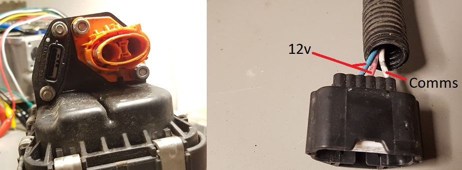

Pics of the 3 wire connector

@cookie6000 Please make it a standalone thread of figuring out how it works. But report here when you have a solution for running it.
I think you should provide 12v and GND to it and 12v pwm. Try 1khz 50% duty first. It's how I got all of Ampera pumps and fans working.

It's almost the same heater. What I see on the Damien's floor - it's heater from Volt/Ampera. In link is also Eberspacher, but from Leaf. Looks the same, but interface is different. Volt takes sufficent PWM signals but Leaf heater needs something to receive via LIN. To be honest I hope that someone in future will solve controlling heater from Leaf, because I have also this one, but I'm not able to do somethig with this
I have somewhere on another PC pdf with descripted PWM's to control Volt heater, which unfortunately I don't have.
Edit: like is written in next post from xp677 and Arber probably I'm wrong sorry for my mistake and make noise.
For my justification info where I found info about heaters:
https://www.diyelectriccar.com/forums/s ... 87931.html
I did to fast mental shortcut and this is result. So now I know, that are almost 3 versions:
1. Leaf heater with LIN interface
2. Ampera/Volt with CAN
3. Native Titronic with PWM

The heater 3-pin connector is as below:
TAB
1 2 3
1 = GND
2 = SWCAN
3 = 12V
Again, untested.
I don't know which orange wire is + and which is -, this is a problem for me as I don't have a connector on the end of my wires, so can't look it up!
If someone is able to tell me which wire is which, that would be great. Mine do not have red/black bands on them.
If the power section is anything like the Leaf heater linked above, then polarity will matter.

Re: Nissan Leaf Powered E46 Touring
I can help you with that. I managed to heat up the heater more by accident and i suspect i damaged it because it didnt had any coolant inside.xp677 wrote: ↑Sat Feb 01, 2020 12:14 pm I don't know which orange wire is + and which is -, this is a problem for me as I don't have a connector on the end of my wires, so can't look it up!
But i did managed to get the polarity by using wires and connectors from chrashed Ampera car. I checked against Ampera inverter and confirmed:
1. The contact on the connector side with the extrusion is NEGATIVE battery.
2. The contact on the flat side of the connector is the POSITIVE battery.
It is the same orientation on Ampera AC compressor and of course the same connector.
I hope it helped you, thank you for the code. What do you use for controller?
EDIT: Crap! I just saw you do not have a connector on the heater. That sucks.
Well i took off the orange wrapping from the cable and the orange cable closest to the black control cable is POSITIVE!
