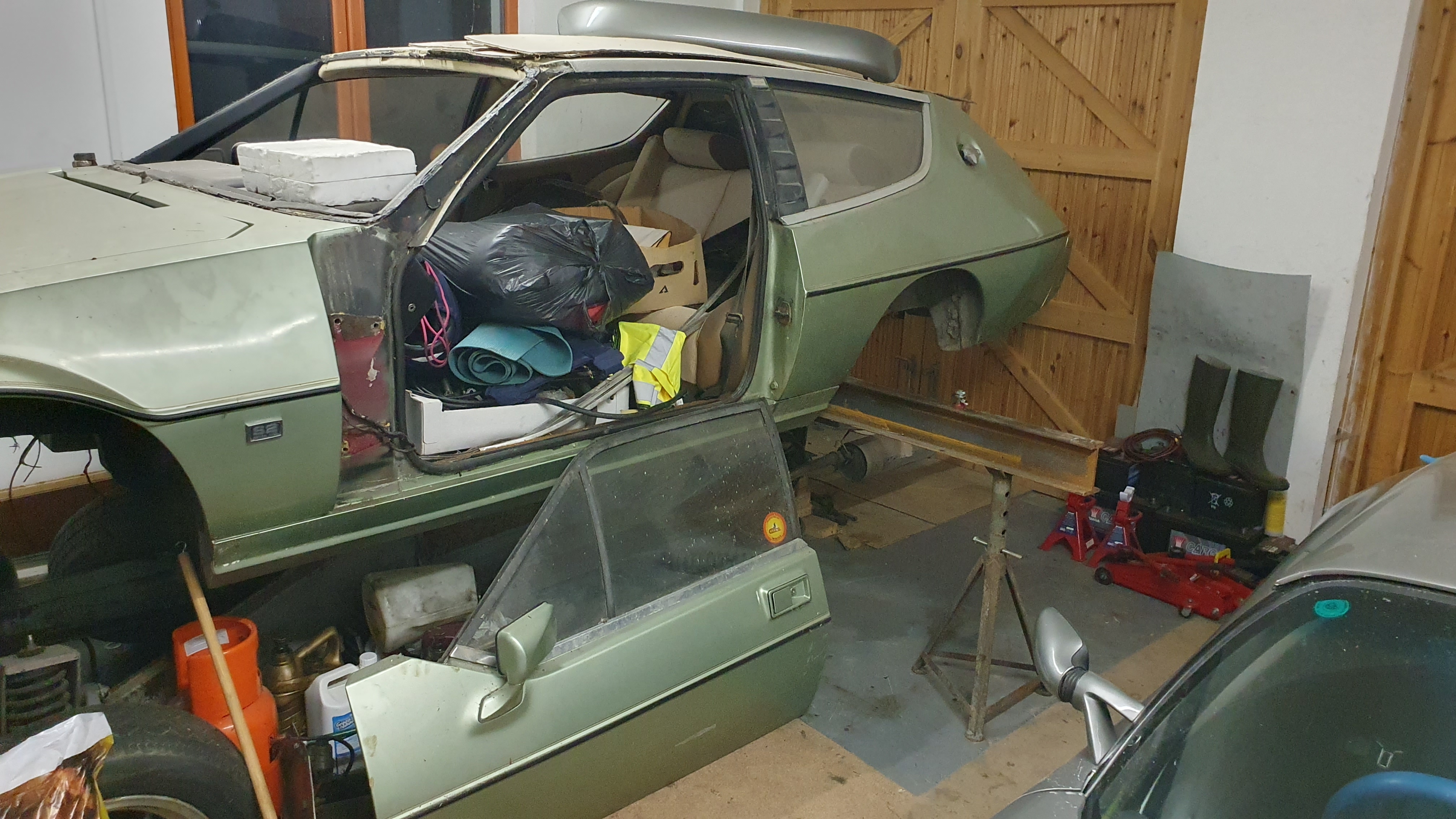

Hi everyone.
I'm a newbie to ev conversions but own to 2 oem ev's. I have an old Lotus Elite (type 75) that's been lying as a project in my garage for donkeys years. It has no engine or g'box anymore and would be hard(& expensive) to find a 2.2lt "912" eng n box, so I've decided to go the EV route using the GS450h transmission, which seems to fit in the chassis. My best buddy is also on board with the project, he's really good on electrics and has a workshop for his Eclat too.
One question.
I have the 450h g'box but no inverter yet. I came across a gs300h inverter (G9200-30132), will that work?
One question.

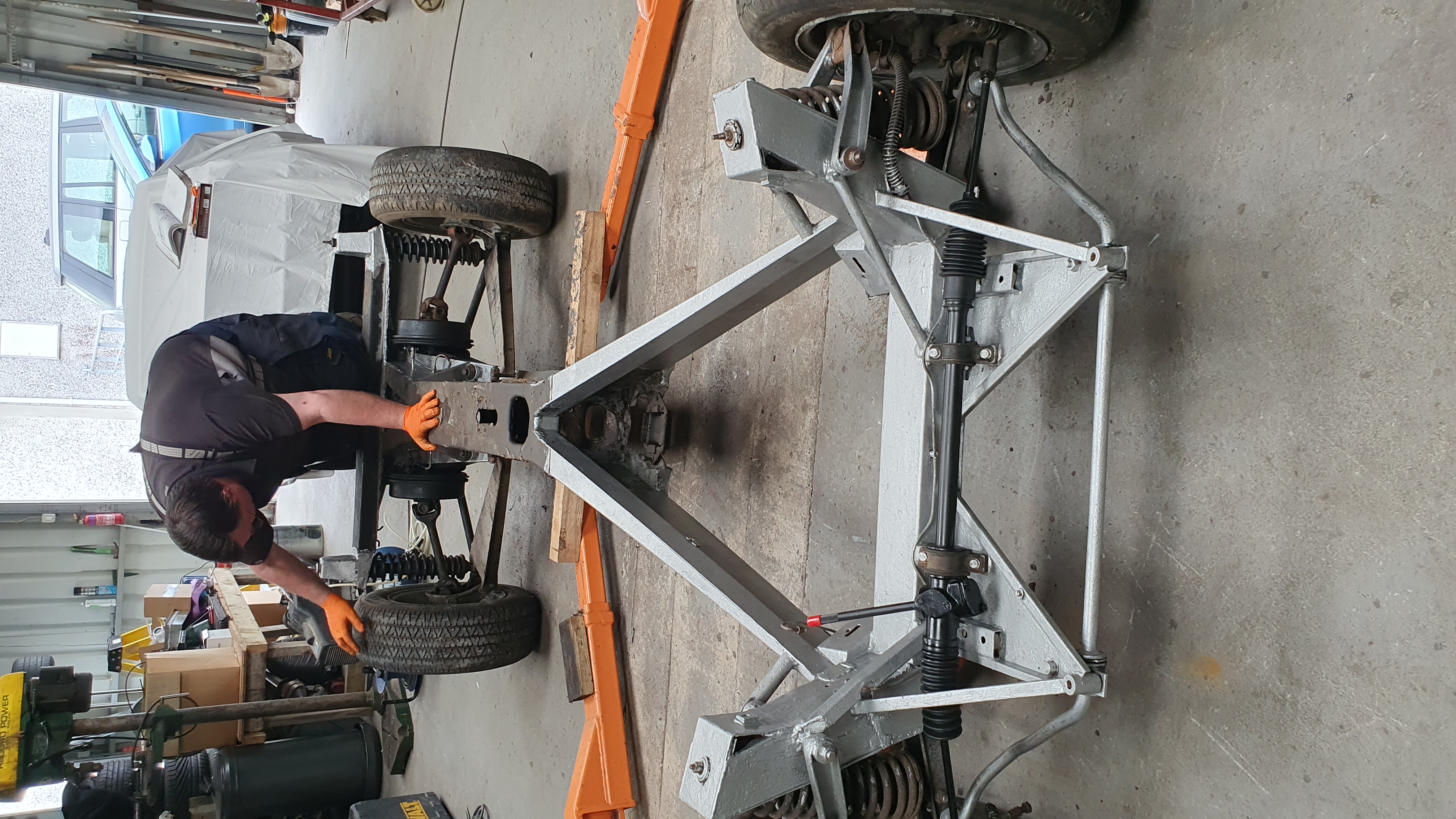

Hi all.
Bit of an update as there's been some good progress this weekend.
First the missing suspension parts finally arrived (got stuck in customs!!! ). So we got the chassis rebuilt and back on its own 4 wheels, first time in 15yrs!!!!

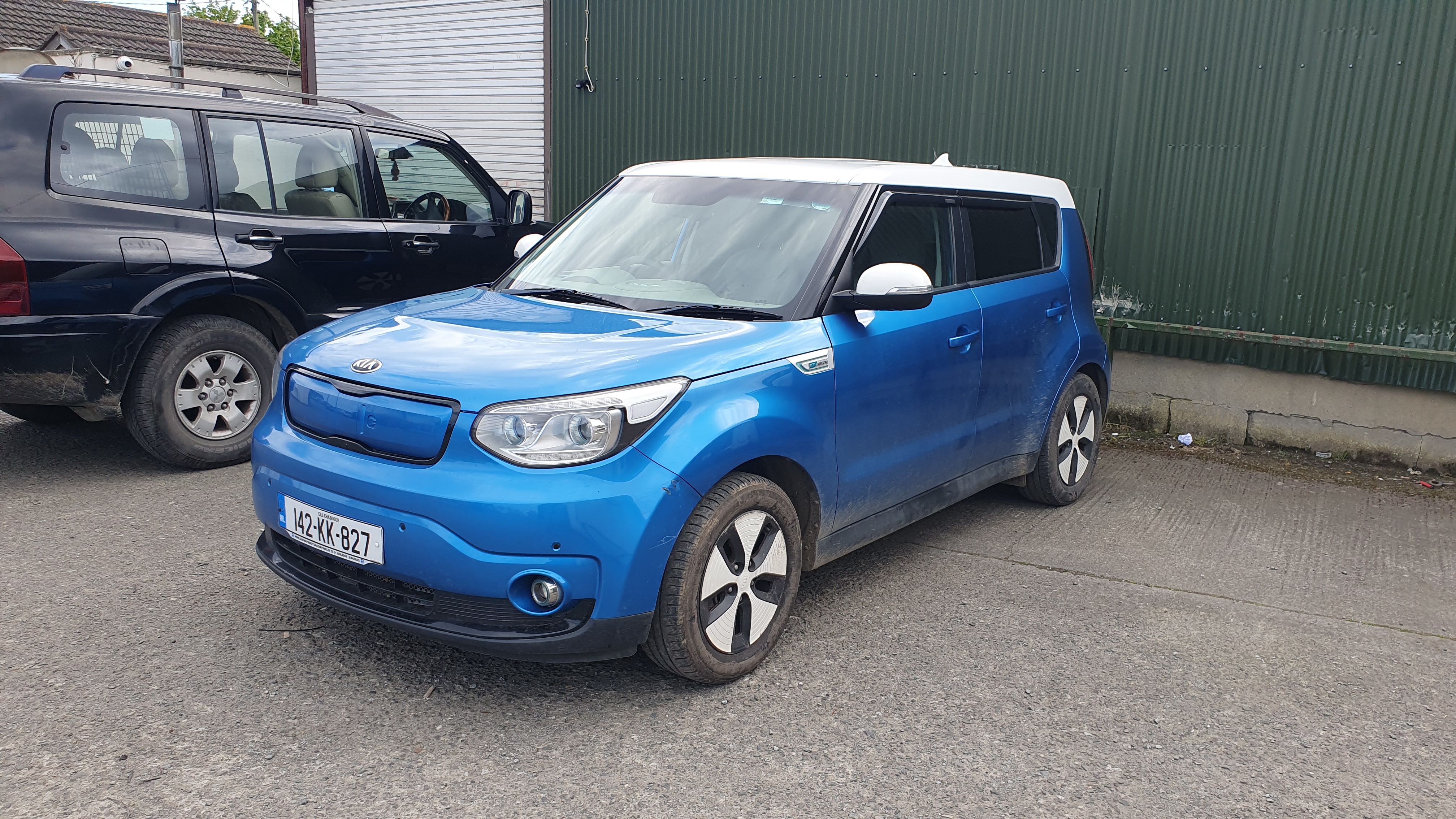

Secondly, early Sat morning I spotted a 2014 Kia Soul EV being sold for breaking due to a complete gearbox collapse. Rang the guy and went to view it, bagged a good deal on it ! I hope to get a lot of useful bits from this as well as the 30kw battery (27kw usable) which seems to be in good condition.

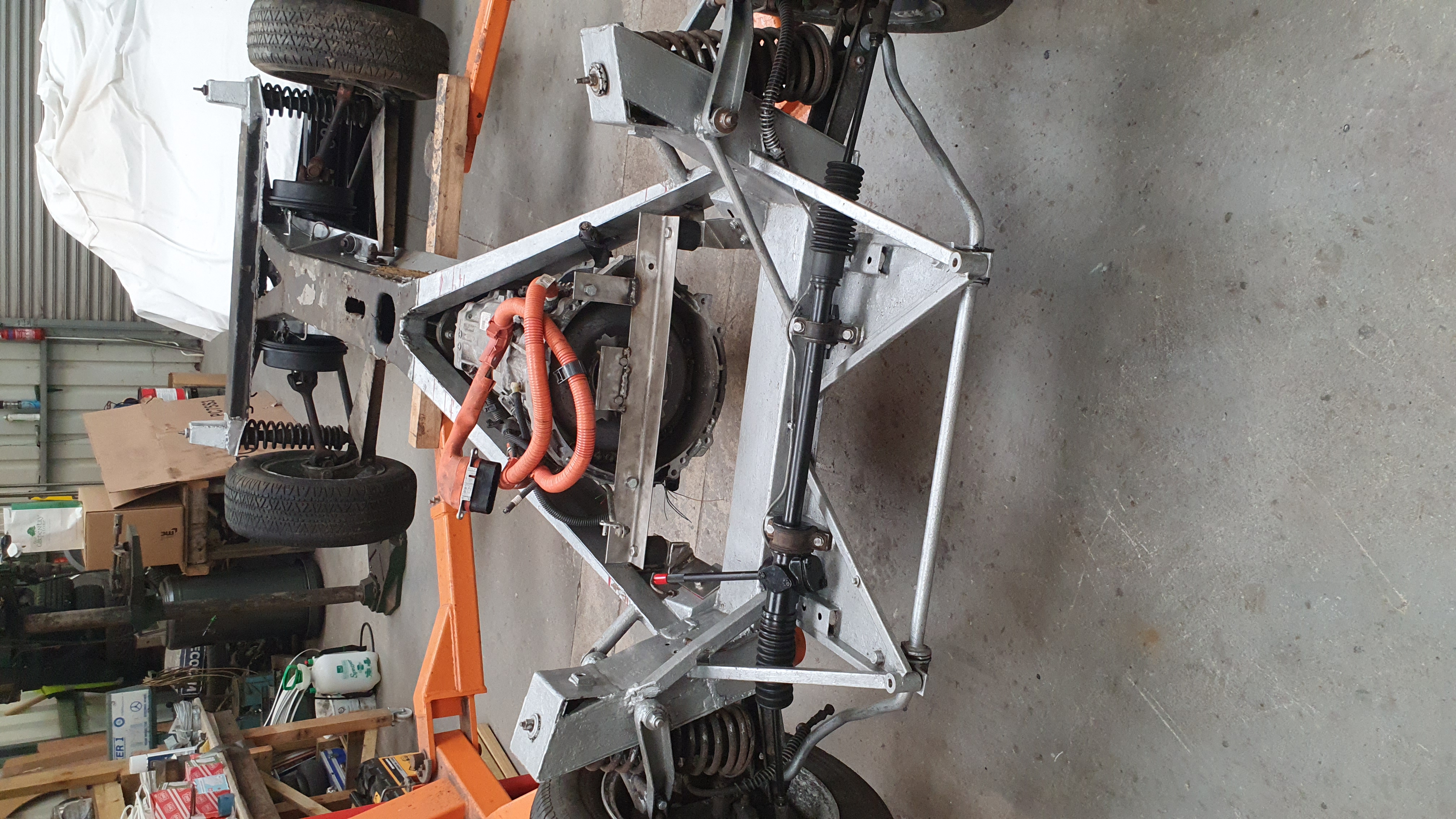

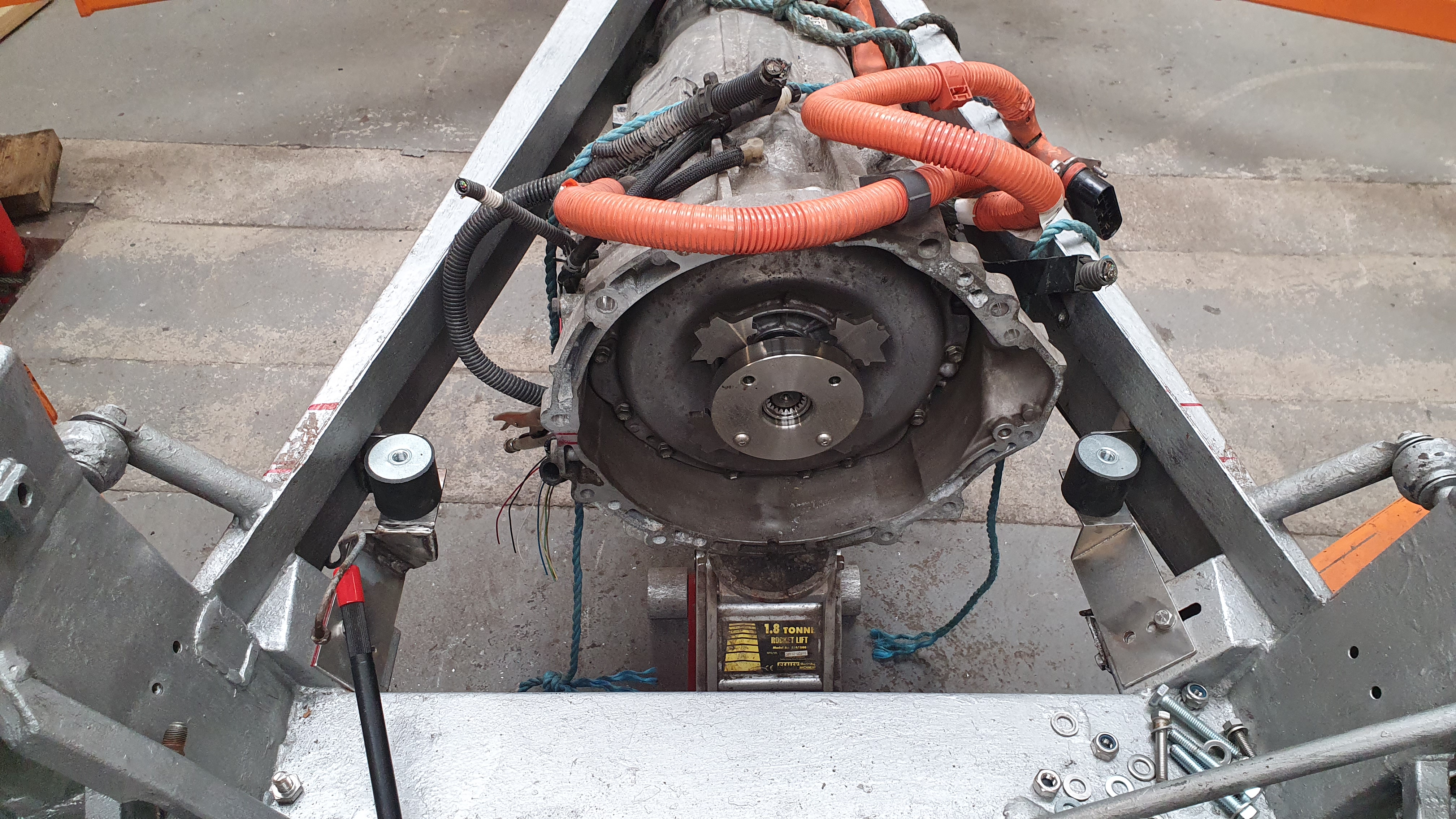

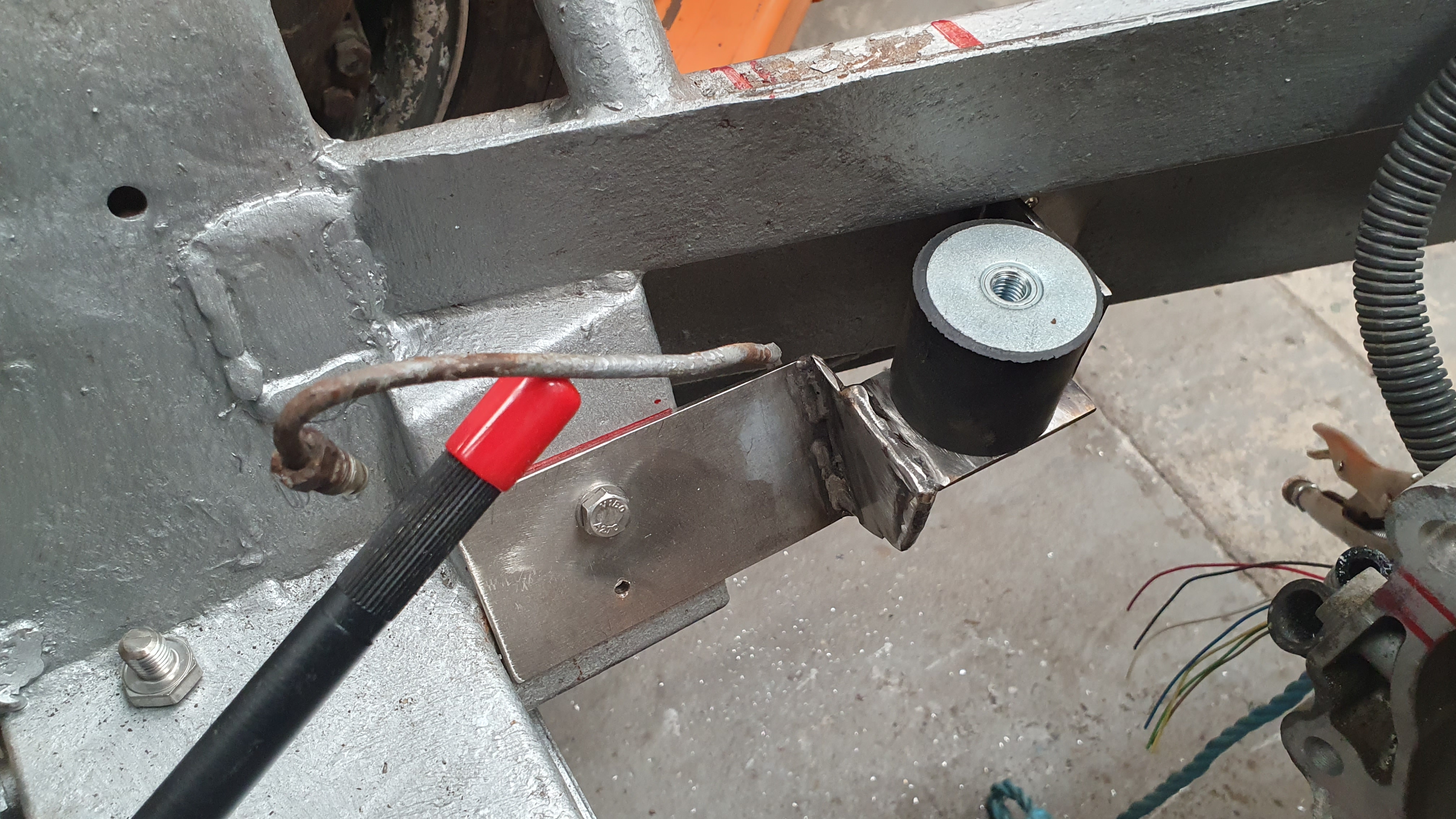

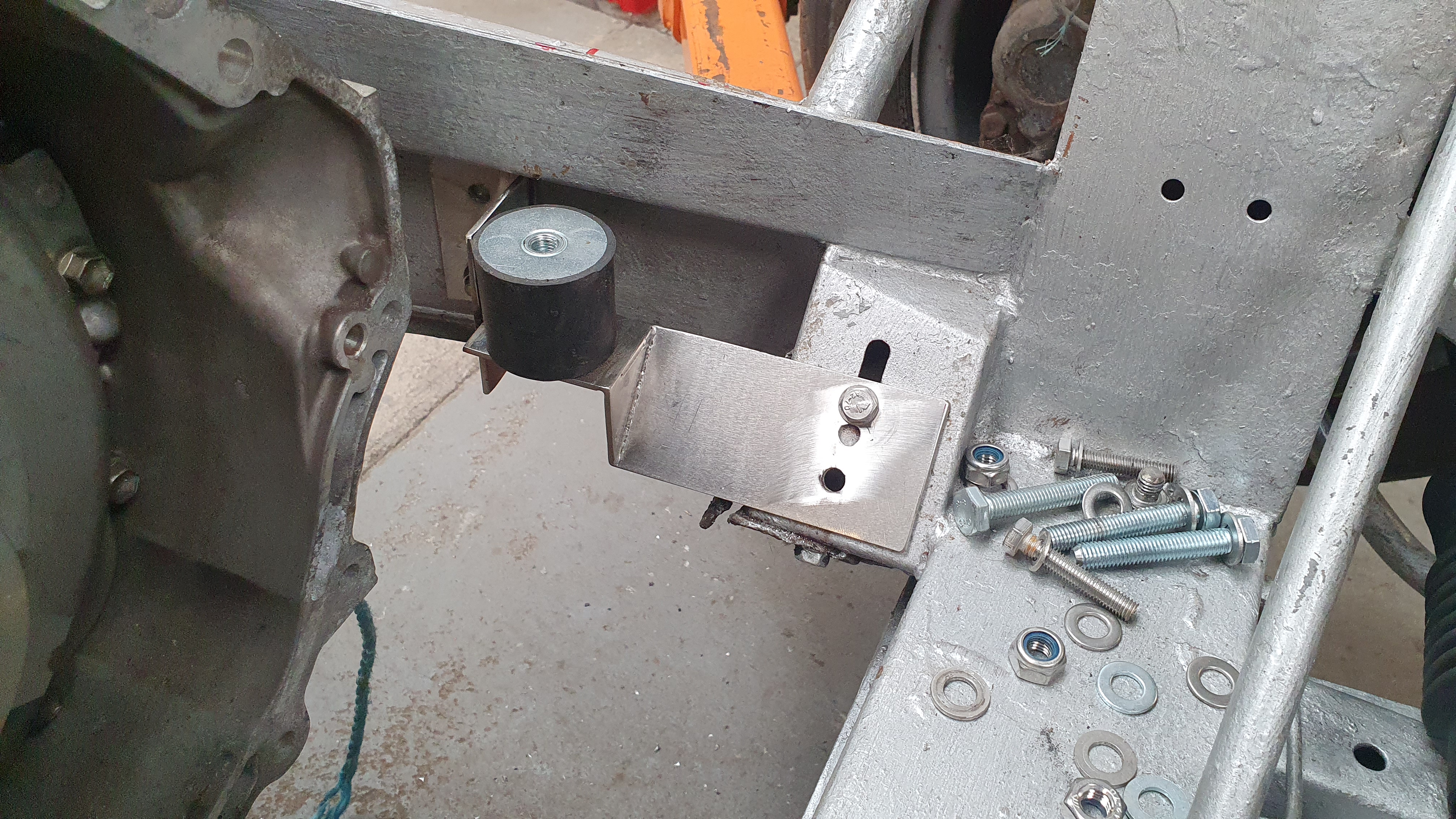

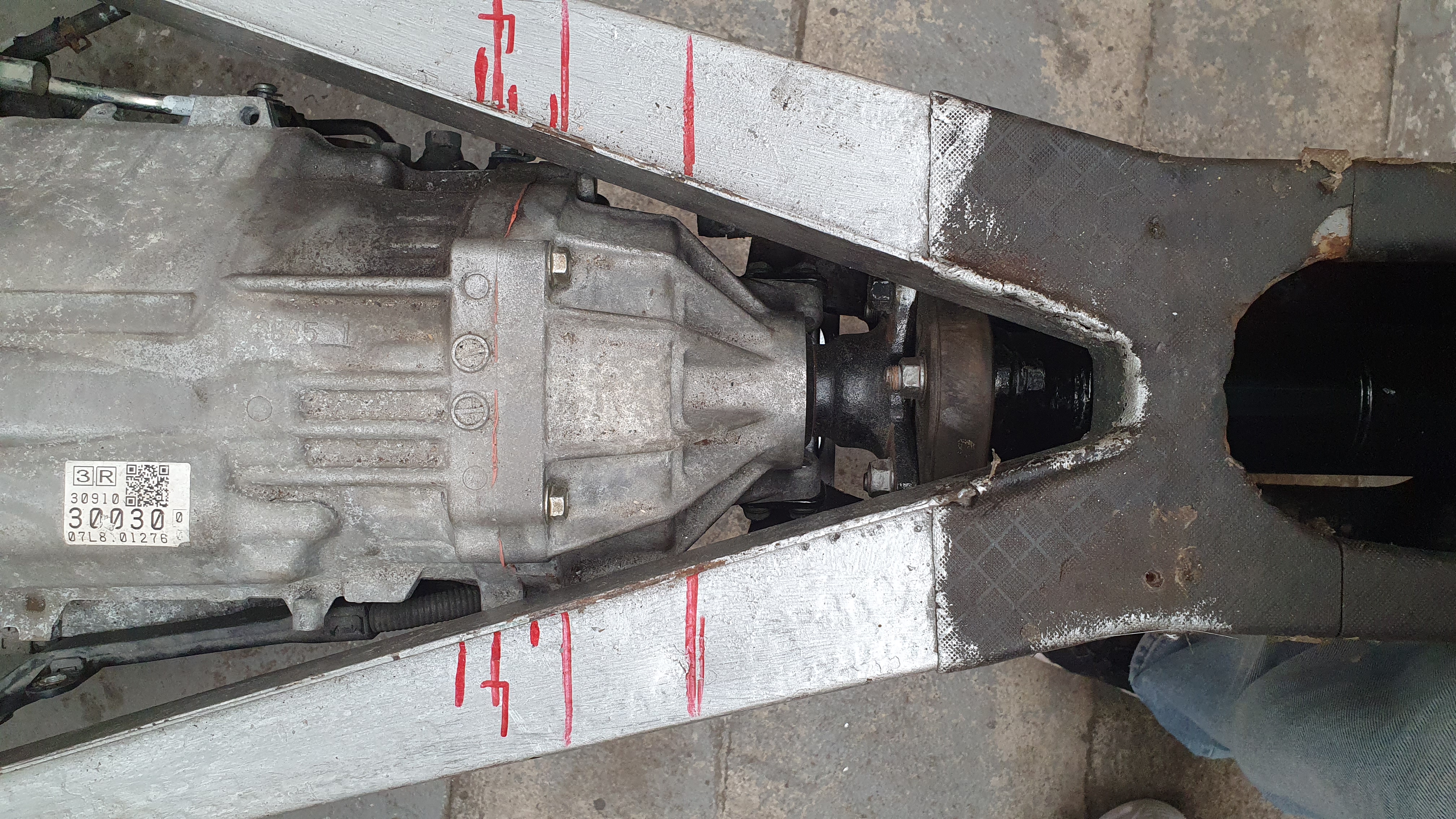

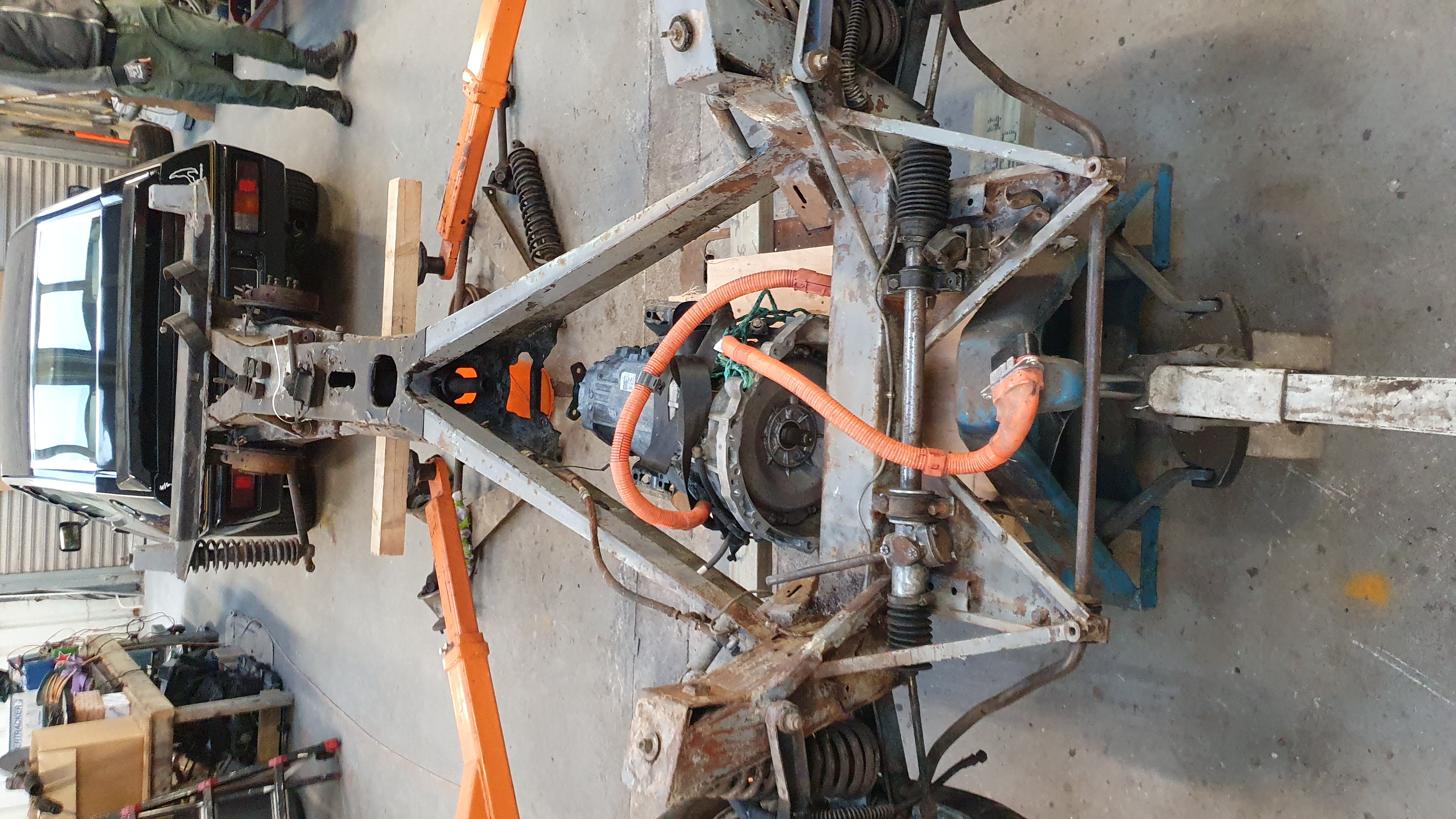

Another milestone reached today with the help and major input from my buddy Michael.
The gearbox mounts were fabricated along with the Lotus/lexus propshaft. We got the gearbox fully mounted and driveline is now complete. The chassis is now a full rolling chassis ready to start refitting the body.
The other major step will be stripping the battery, BMS, OBC, and anything else I'll need from the Kia Soul EV. But this is something that I'm not good with.
How or what will I need to do to get these bits communicating with the Zombieverter VCU? Do I need to capture any Can logs from the kia before I strip it????
I need help with this part!!

Re: Lotus Elite + GS450H
Howdy, afraid I dont have the answers there re Kia stuff.
But if it was me.. obc presume that is the charger
what interactions would the bms have with zombieverter? I'd say probably nothing major outside of power up / power down routines?

Hi all.
I'm questioning if the Kia Soul EV I bought as a donor is the wrong choice!! Would a Nissan Leaf be a simpler, better (as in comms already diagnosed and set in the Zombieverter) whereas the Kia seems to be an unknown or at best a "work in progress".
This is my first ev project and the comms side of things is my weakest strength!!!.
Any advise welcomed.
