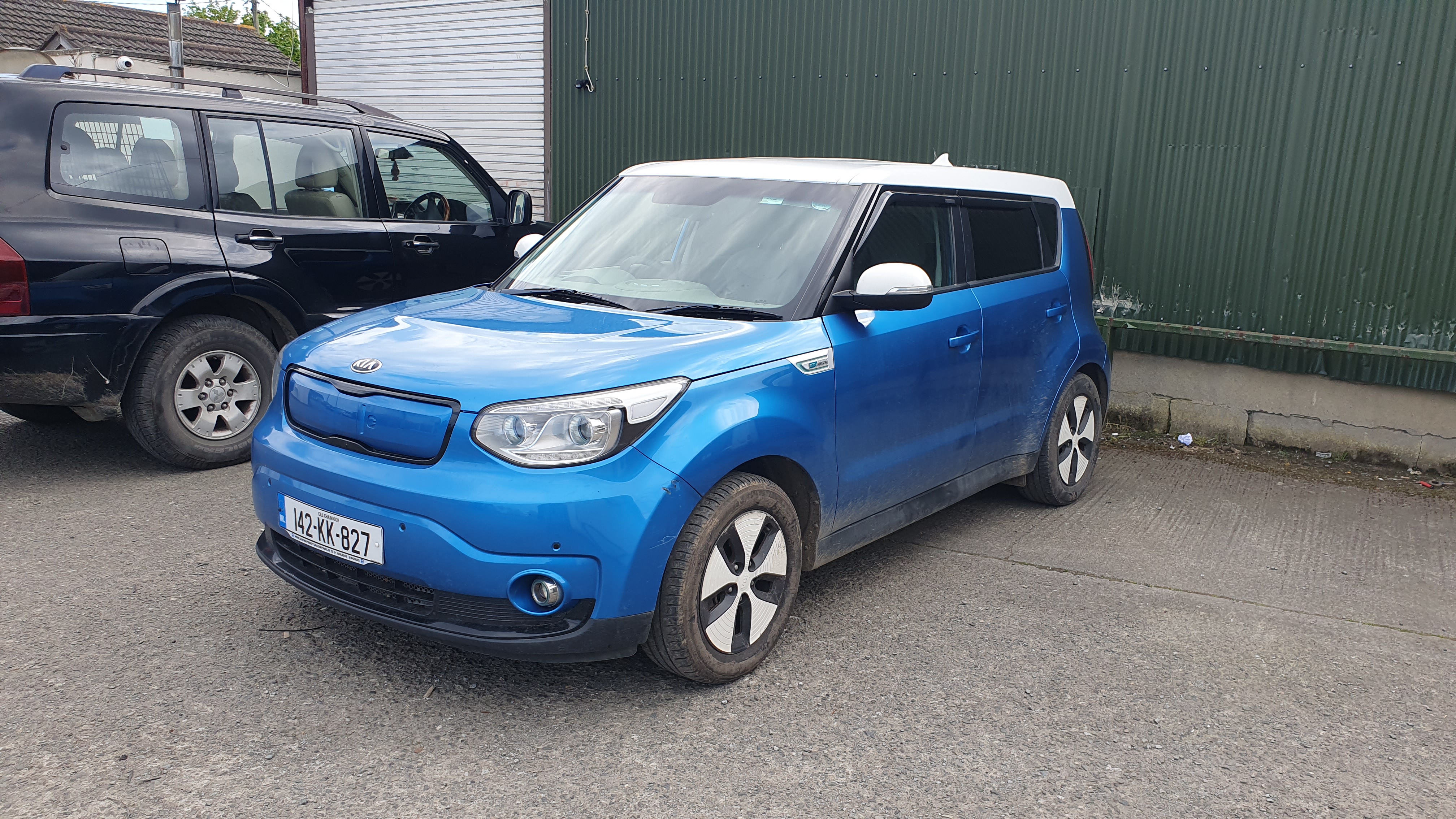

Hi all.
Bit of an update as there's been some good progress this weekend.

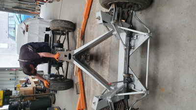

First the missing suspension parts finally arrived (got stuck in customs!!! ). So we got the chassis rebuilt and back on its own 4 wheels, first time in 15yrs!!!!

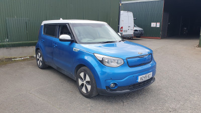

Secondly, early Sat morning I spotted a 2014 Kia Soul EV being sold for breaking due to a complete gearbox collapse. Rang the guy and went to view it, bagged a good deal on it ! I hope to get a lot of useful bits from this as well as the 30kw battery (27kw usable) which seems to be in good condition.

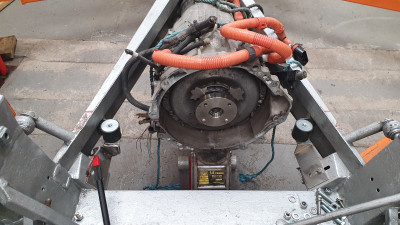

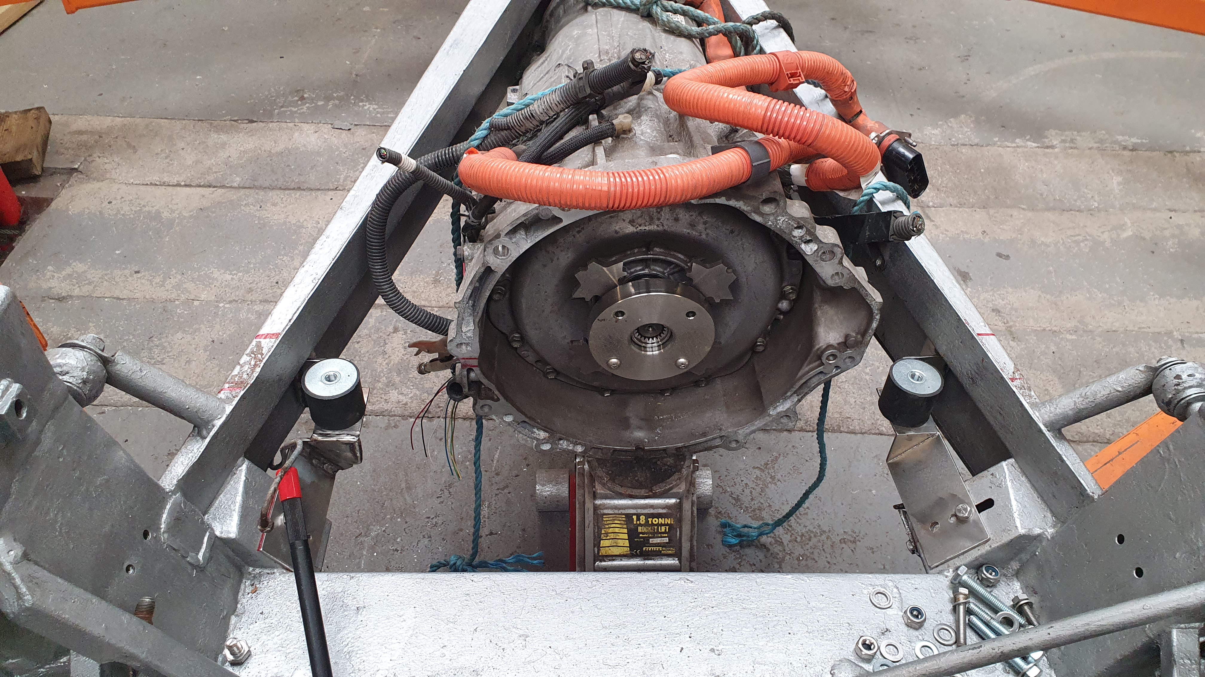

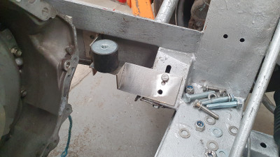

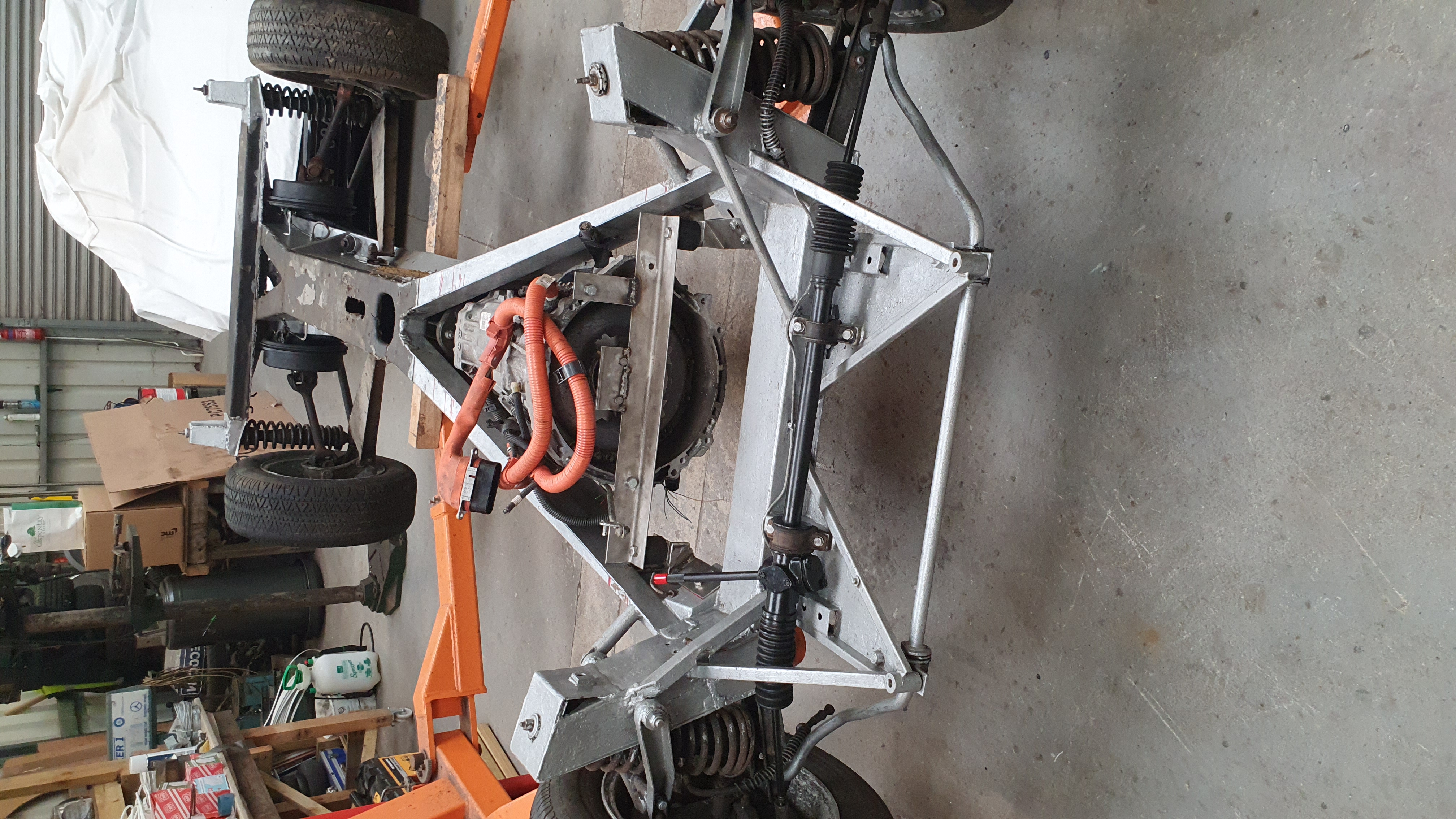

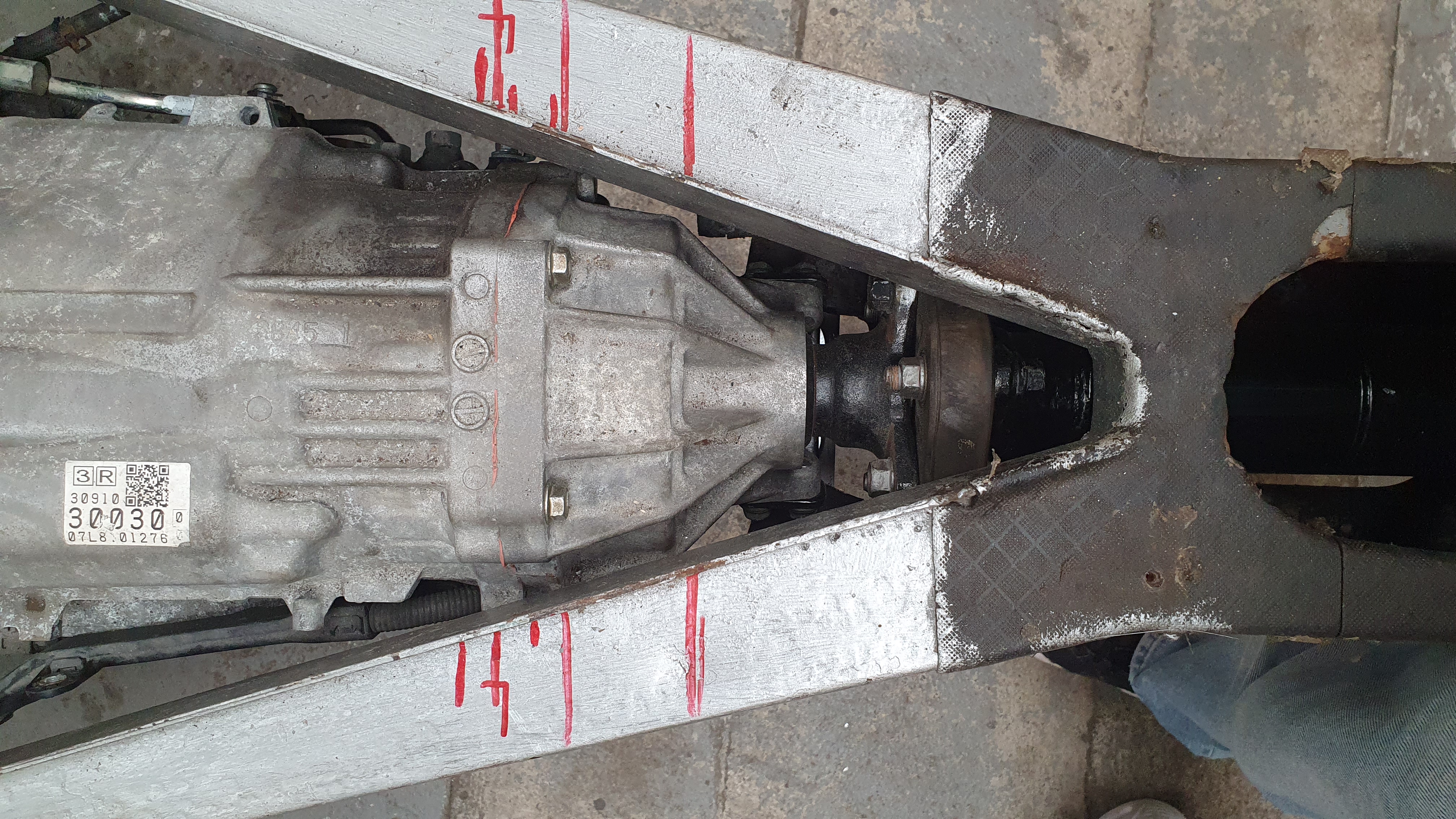

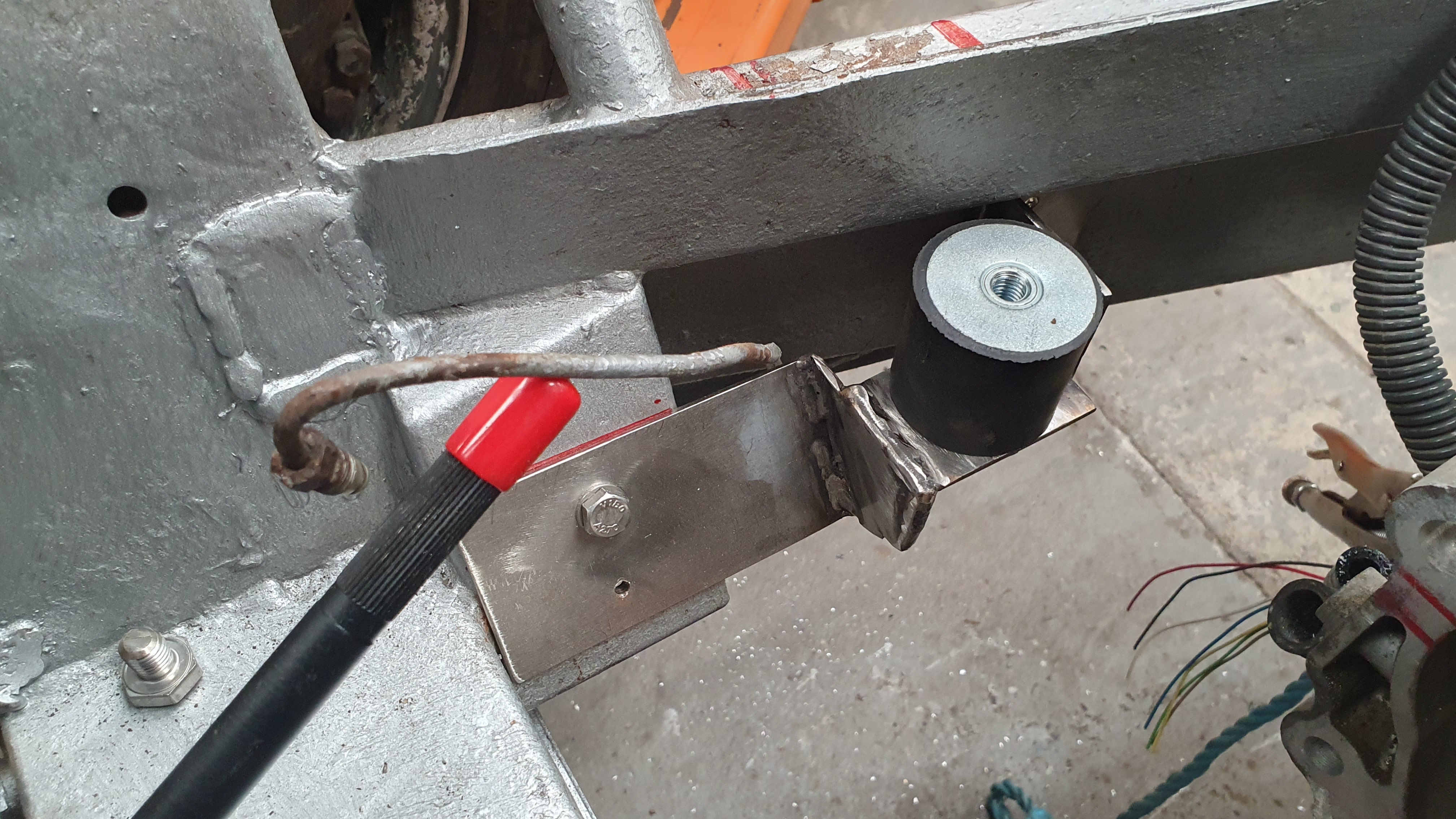

Another milestone reached today with the help and major input from my buddy Michael.
The gearbox mounts were fabricated along with the Lotus/lexus propshaft. We got the gearbox fully mounted and driveline is now complete. The chassis is now a full rolling chassis ready to start refitting the body.
The other major step will be stripping the battery, BMS, OBC, and anything else I'll need from the Kia Soul EV. But this is something that I'm not good with.
How or what will I need to do to get these bits communicating with the Zombieverter VCU? Do I need to capture any Can logs from the kia before I strip it????
I need help with this part!!

I'm questioning if the Kia Soul EV I bought as a donor is the wrong choice!! Would a Nissan Leaf be a simpler, better (as in comms already diagnosed and set in the Zombieverter) whereas the Kia seems to be an unknown or at best a "work in progress".
This is my first ev project and the comms side of things is my weakest strength!!!.
Any advise welcomed.
