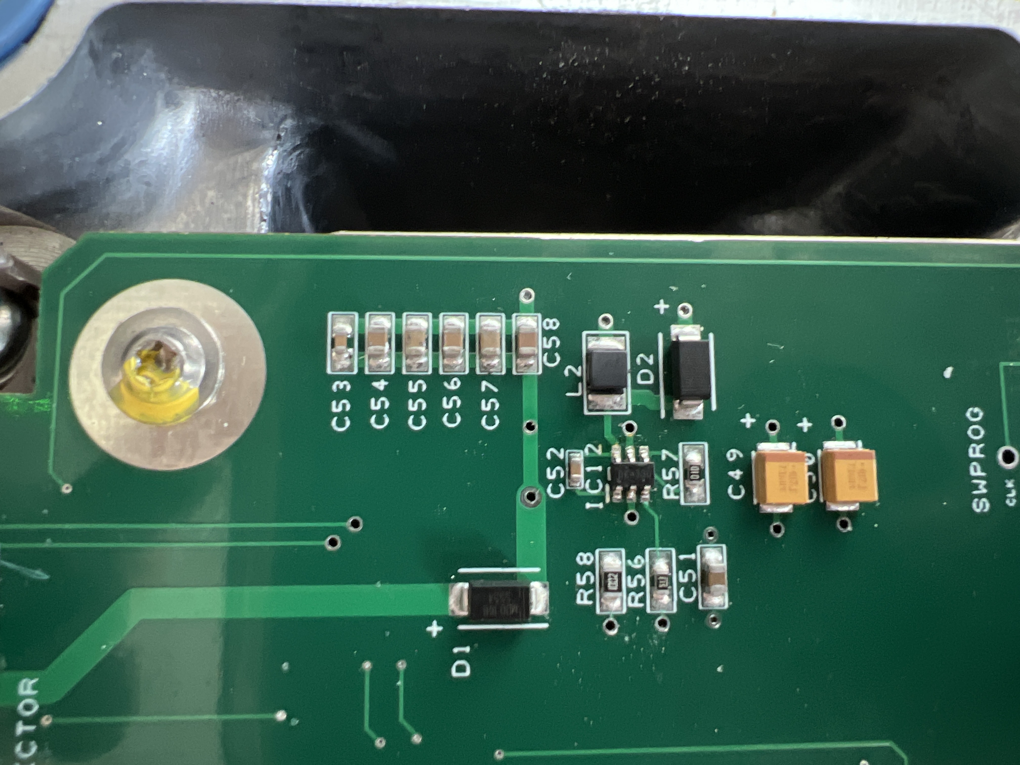

I am working on getting a Tesla SDU motor running and I may have fried the voltage regulator when testing the board.
I was looking to find a new one to replace it but I am having difficulty finding the exact voltage regulator for IC12. The pinout seems to differ from what is referenced on the most recent v6 schematic which calls for the LM2596S-5.0_NOPB. This voltage regulator has a different pin set than what is on the v8 board.
I am curious if anyone knows what the part number is for this voltage regulator? I am also curious if there is a v8 schematic that could be used to reference parts and traces for future troubleshooting?

In the latest BOM it's this: https://jlcpcb.com/partdetail/RichtekTe ... 9GE/C16819

V8 schematic and BOM here https://github.com/jsphuebner/Tesla-Fro ... /master/V8
