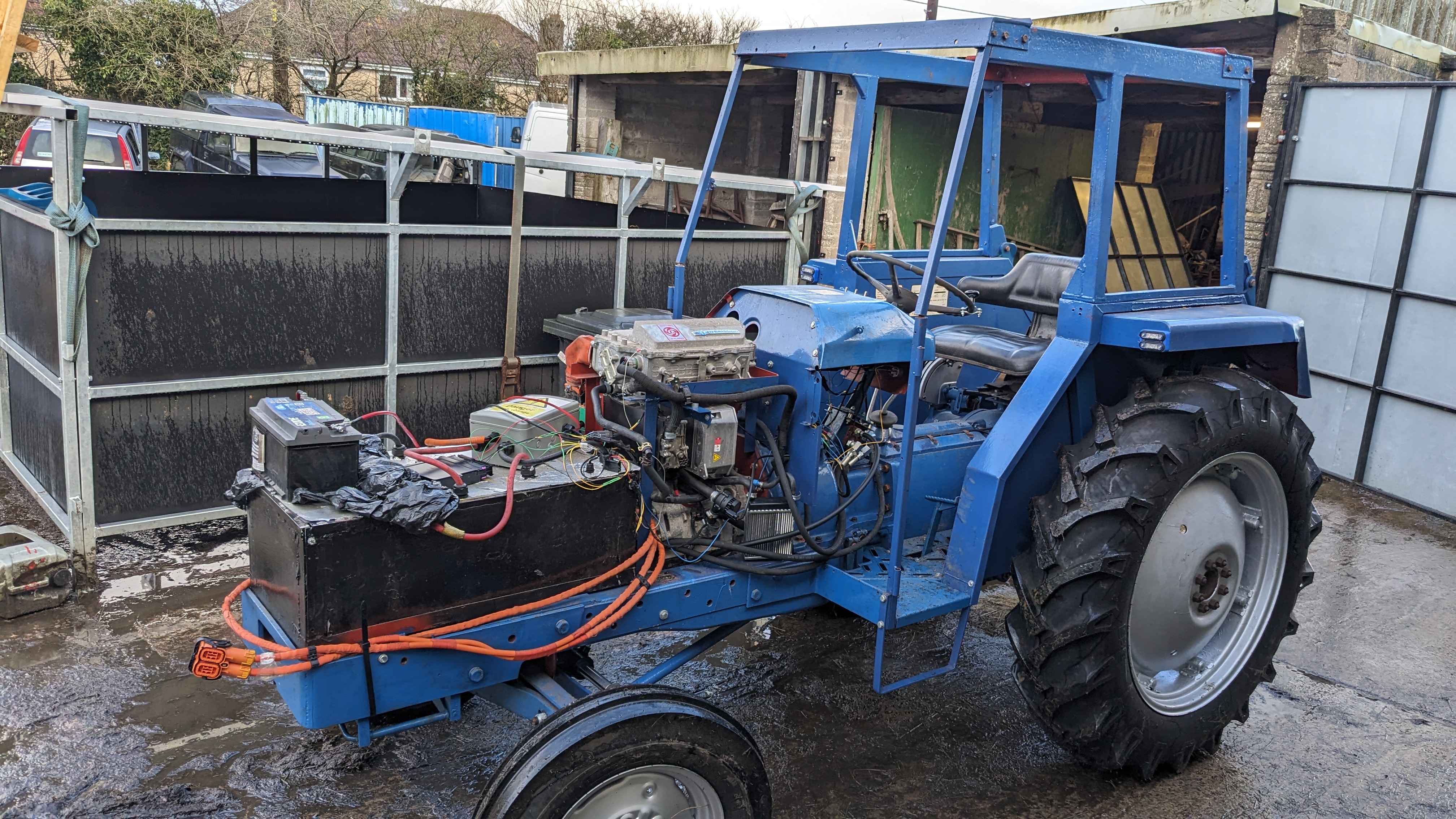

Have a test battery from the MG fitted now. Had to remove most of the tinwork at the front, but it will do the job.
Currently cleaning up and painting the rear wheels before getting new tyres put on. Then I need to look at hooking up the new hydrostatic steering.
After that it should be ready for a first test drive.
My plan is to get some initial driving done with this battery around the farm, then switch it out for the ECorsa battery for some real work. Although it's all a bit delayed at the moment until I get the MG back on the road.

Been doing a little bit of work on this in the evenings when it gets too dark to work in the MG shed. Mostly starting on the 12v system, running wires for lights etc.
It now has a full set of new tyres.
Also got it spinning for the first time tonight!
https://youtube.com/shorts/P448f2cb54c?feature=share
Couldn't go too fast as there isn't any coolant in anything just yet.

So feels like not that much has changed looking at the last photo. However there have been some pretty big changes in design.
Picked up an MG V2L charger over the holidays for cheap so I've removed the Leaf DC-DC and also the Cayenne charger. V2L is a valuable utility on the farm, almost every week there seems to be a use case for it.
I had to move the inverter over a little bit so the cable to the battery would line up better. I took this opportunity to redo the bracketry for the new charger and CCS socket. It's still a mess of angle and box iron but now it's covered up a bit more.
I did a slightly better job on the battery brackets, those were laser cut and welded up over Christmas. As for the battery itself I have made up three of the four layers of modules plus all the busbars, the last layer to do is the lowest one which is welded to the base of the box. The plan is to get as much done as possible in the workshop that doesn't get condensation. Then build up the pack and seal it up in one dry day.
Next step will be to organise and mount all the contactors on the top plate.

Re: [First Drive] Leyland 255 Tractor - Nissan Leaf EM61
Post by Jacobsmess »
Exciting news, which MG charger did you get? And how cheap is cheap? 😄 they're often foe silly money (the ones with V2L) from what I've seen on the 'bay
LRBen
Posts: 573
Location: Somerset, UK
Has thanked: 77 times
Been thanked: 220 times
Post by LRBen »
Jacobsmess wrote: Wed Feb 19, 2025 8:35 am Exciting news, which MG charger did you get? And how cheap is cheap? 😄 they're often foe silly money (the ones with V2L) from what I've seen on the 'bay
EP2CCU6625A from the MG5. Made a low ball offer of £200 and it got accepted. Had to spend almost that much again though on an MG CCS socket as it was the easiest way to get the AC connector.
