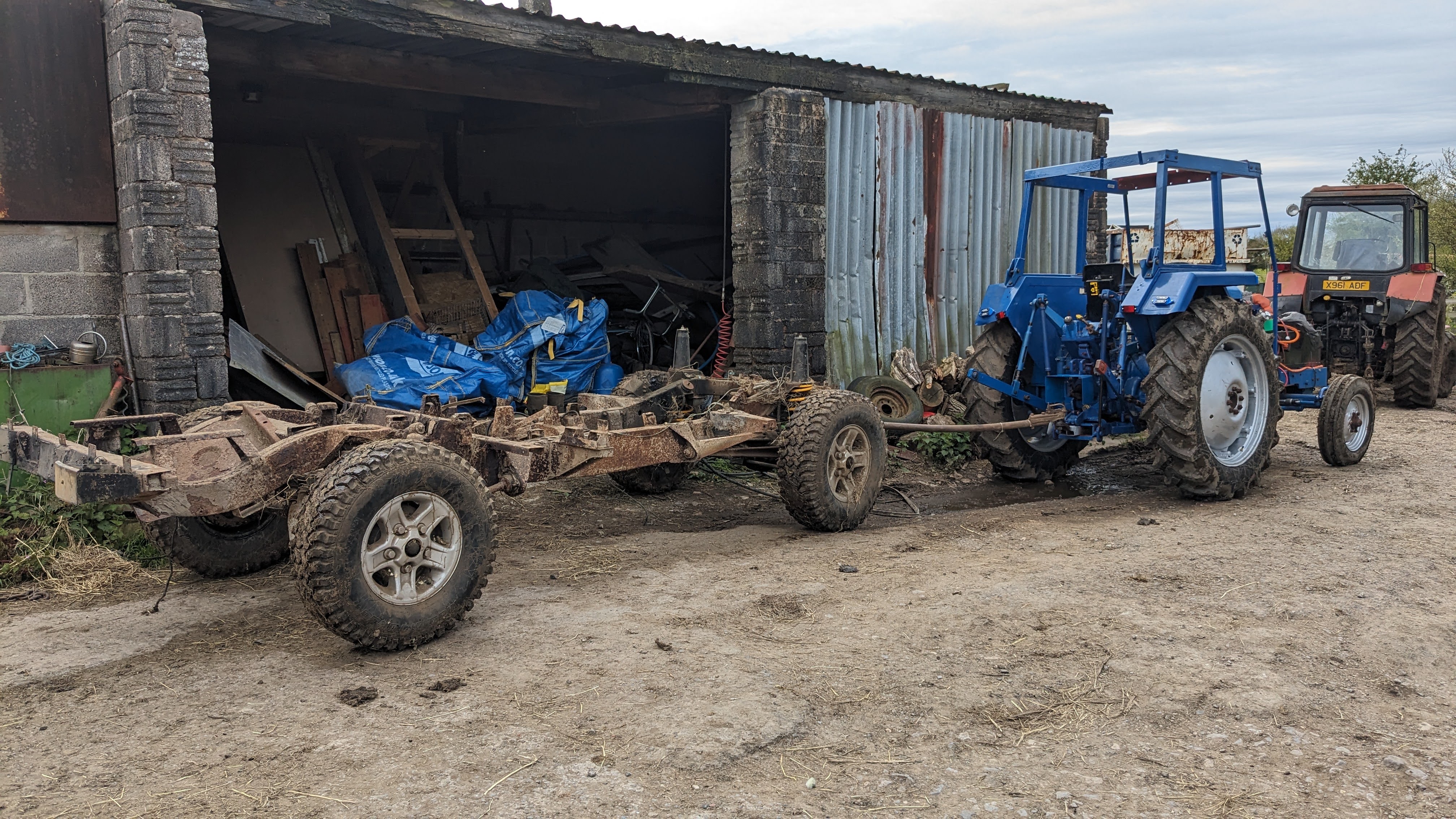

Wasn't sure which thread this photo belonged too. But I figure it will suit this one as an update. Moved the Defender to a different shed today, as well as a few other things that were in the way.
Just waiting on the fields to dry out a little more then I can take it out on the weed wiper, quite possibly this weekend.
Since the last post I have put all the linkages back on and fixed a few hydraulics leaks. I got around the hand throttle issue by extending the lever on the hand throttle, so I now have a functional foot and hand throttle.Just waiting on the fields to dry out a little more then I can take it out on the weed wiper, quite possibly this weekend.

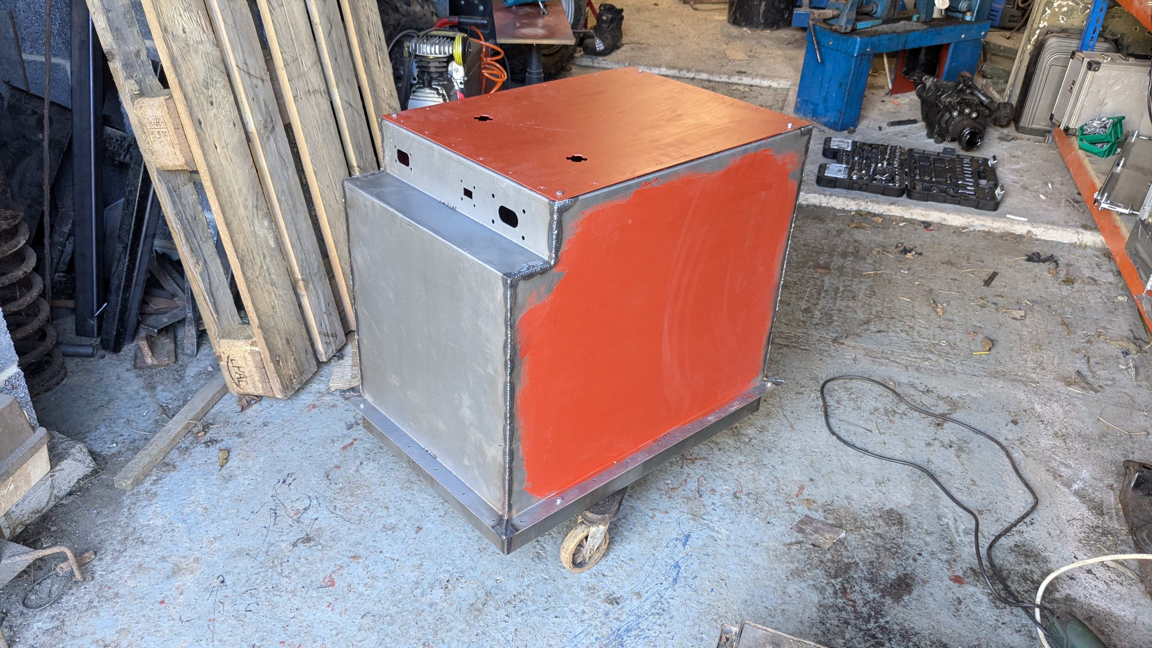

Corsa battery arrived and the modules have been harvested. The hardest part was the 2cm of sealant around the lid. Took hours to get the lid off.
I'm going to be using 16 of the 18 modules for 96s, otherwise the DC-DC won't be happy. it does bring me down to 45kWh but that's fine with me.
Been working on the design for the box in CAD. Originally I was going to go for thicker aluminium sheets and spacers. But that's expensive and weight isn't an issue so it's all steel.
4 modules per layer in 4 layers, probably solid busbars in each layer then a flexi between the levels. The top is the junction box, but I got lazy with that so I'll just drill out the holes for contactors etc when I get it. Luckily there isn't really much in the way of ancillaries for this, just the charger and the DC-DC. I'm going to use the pass through on the charger to connect to the DC-DC so that makes it pretty simple in terms of HV connectors.
Ideally I'm going to build this away from the tractor, then drop it in over a day or so to reduce down time. In reality I might just build it up in situ again since it's not like it's a daily driver.

Finally got the battery box parts back from laser cutting and folded up last week. Today I found some time to weld it all together and it turned out pretty well. Made some design changes from my last post and brought the top layer in a little bit, this way the connectors shouldn't stick out the back of the box too much. Still need to buy some more primer, final coat will be Massey Ferguson silver mist to match the wheels.

Old pack removed and new box thrown in to check dimensions. The good news is that it will fit and there is plenty of room to spare above, so I can get to work on some mounting points. I'm planning to soft mount it with metalastic bushes, although I'm not sure it's entirely necessary in this situation.
It's looking like I will also have to rejig some of the ancillaries to get it fitting well. I need to move the inverter over slightly, and turn the charger around. But that gives me the oportunity to mount those with better designed brackets that bits of angle welded together. I can also remount the charge socket properly as well.
Talking of charge socket, I decided I will use the CCS socket to it's fullest with FOCCCI for CCS control. I have some spare contactors and I bought a few FOCCCI boards from JLCPCB for the Land Rover and MG, so adding this to the tractor isn't all that expensive.
It's nice to see it finally looking like a tractor again, this the first time the bonnet has been on with everything installed.

What's the cost of the laser cutting of the box out of curiosity?
- Posts: 573
- Location: Somerset, UK
- Has thanked: 77 times
- Been thanked: 220 times
Re: [First Drive] Leyland 255 Tractor - Nissan Leaf EM61
I think it was about £110. For the the box, plus 5 thicker base places for each layer of modules. I bundled it in with a larger order with work so I think that knocked the price down a bit.Jacobsmess wrote: ↑Sun Nov 17, 2024 6:34 pm What's the cost of the laser cutting of the box out of curiosity?
I looked at laser cutting the busbars but that was £300 or so. So I'll do those manually.
