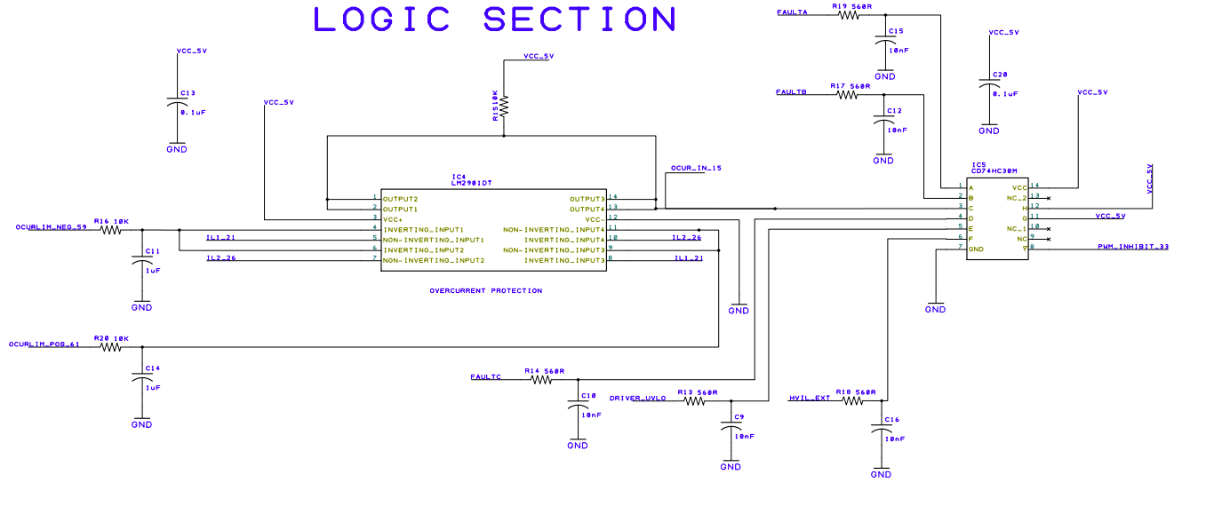

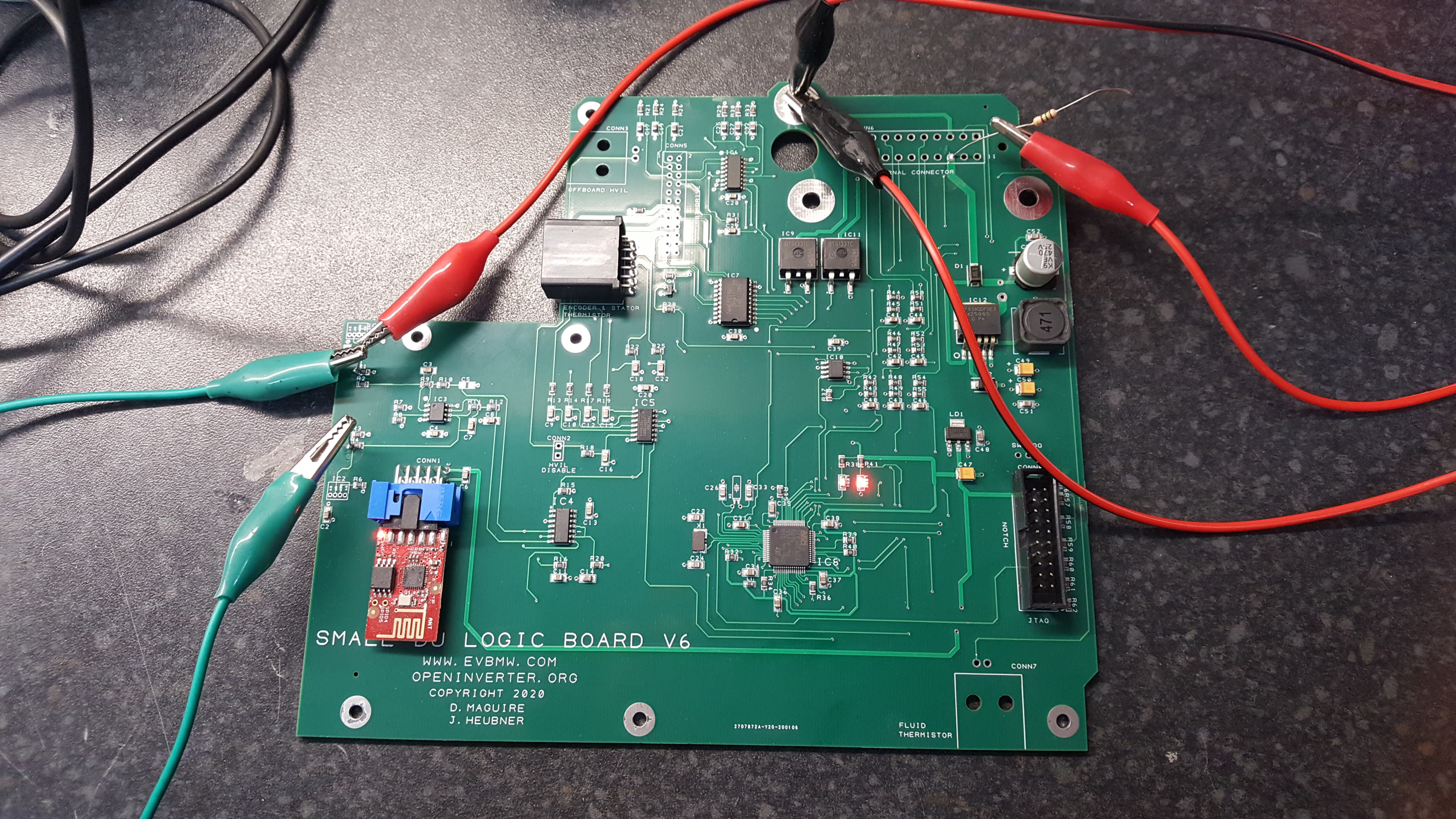

I just pulled a board at random and re ran the current sensor circuit test thinking I may have missed something. All tests out fine with the default parameter set loaded on the SDU boards at time of shipping. Between 0.1v and 5.2v on the current sensor inputs the dinocur is normal as expected. Outside those values generates a fault as expected.
Suggest investigating the following :
Voltage across R15 : should be approx 3.5v during normal operation and approx 0v during fault condition.
Voltages across c11 and c14 set the window comparator value. Should be approx 0.05v and 3.2v depending on the value of ocurlim set.
Can some people with experience running the SDU please chime in and help? or am I asking too much?

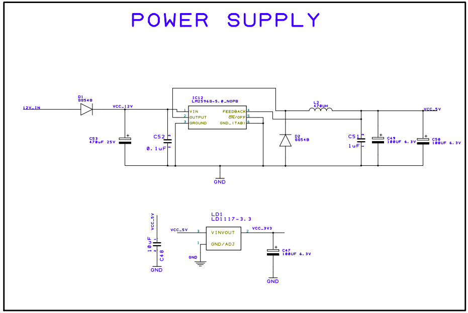

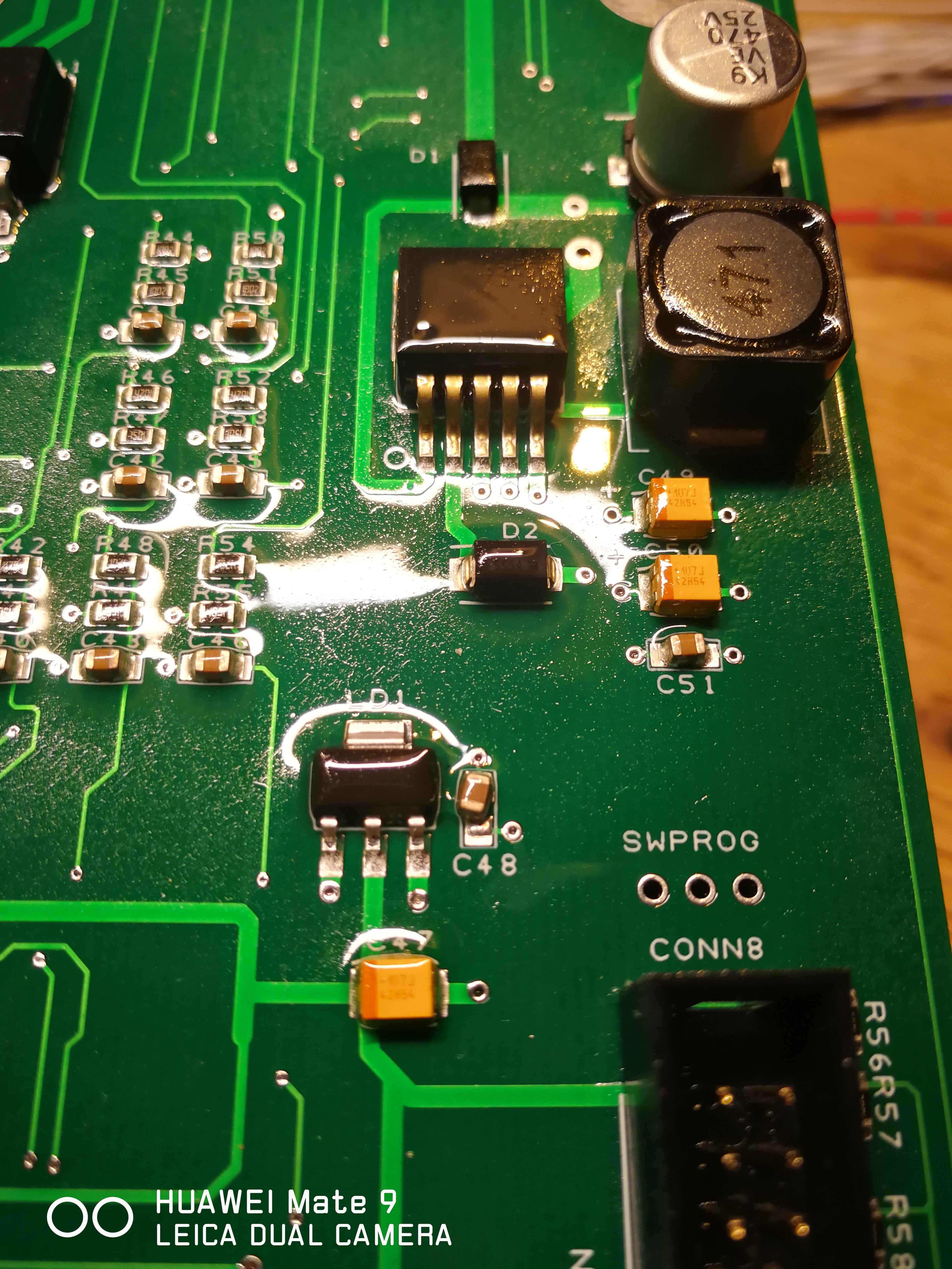

Can this make the mess?
C48!
On R15 i can read 4.97 Volt on the Meter!??
C14 is 1.86V (ocurlim 1200 A)
C48!

Looking at the V6 schematic (here) it's clear C48 is one of several bulk decouplers and unlikely to be an issue if it's not connected.

You don't say which side of R15 you're measuring (It's a pull-up to the 5V rail).

Can you report C11 and C14 at several ocurlim settings?
Jack Bauer wrote: ↑Tue Feb 04, 2020 1:10 pm Voltages across c11 and c14 set the window comparator value. Should be approx 0.05v and 3.2v depending on the value of ocurlim set.

R15 i measured on the right side next to whole is 4.9Volt on the other side is 0.02!
C11: 3.31v .no change with ocurlim!
C14:1,87v@1200 ,2,7v@500 ,3.31v @-500
Anyone have an idea what here happen?Thank you for your support!

Seeing as my hopes for community support are going the same way as those for today's general election I figure I'll jump in.
So, if we are seeing 5v across R15 this means that one or more of the comparators in IC4 has tripped and pulled low thus sending an ocur error to the mcu. Next thing we need to do is check the voltages across C5 and C8. If these are outside of the window set by the voltages across C11 and C14 then we have our problem.
- Posts: 3831
- Has thanked: 75 times
- Been thanked: 696 times
Re: Tesla Small Drive Unit Support Thread

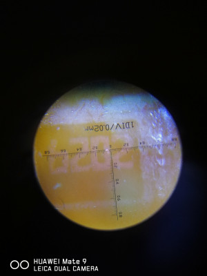

Also voltage across R7. Should be approx 1.7v.
- nesto1972
- Posts: 48
- Joined: Sat Jan 11, 2020 7:14 pm
- Location: Austria
Here are my measures:
C11 = 3.31V
C14 = 1.85V
C5 = 3.8V
C8 =3.8V
R7 = 4.6V
Do we have the problem!?
C11 = 3.31V
C14 = 1.85V
C5 = 3.8V
C8 =3.8V
R7 = 4.6V
- Posts: 3831
Ok we have our problem. The voltage across R7 is the center reference for the opamp. it should be approx 1.7v. The fact it's 4.6v is skewing the outputs outside the comparator window and tripping the overcurrent. With the power off can you measure the values of R8 and R7. Should be 4k7 and 3k16 respectively.
- nesto1972
- Posts: 48
- Location: Austria
Ok
on my R7 i measured 6k!
Change this ?
@ sparky61
You can run the motor with this fault(ocurlim err)?
Change this ?
@ sparky61

Yes it would have. In fact when Nesto reported the problem I grabbed a board from stock and re ran the current sensor test. All normal. But I've found the problem. JLC fit a 3k3 as they don't have 3k16 so I went ahead and ordered some 3k16 from Farnell. Boards arrive and I test them. All good. Then before shipping each order I swap out the 3k3 for a 3k16. Trouble is, the bag says 3k16, the order says 3k16 but they shipped me 6k2! Apologies everyone. Damien screwed up. Again. You can fit a 3k3 as the difference is only a few amps on the top end of the current limit. There will be four boards out there with this error (including Nesto) so if anyone wants me to rework their board or ship a replacement resistor please contact me via email.
