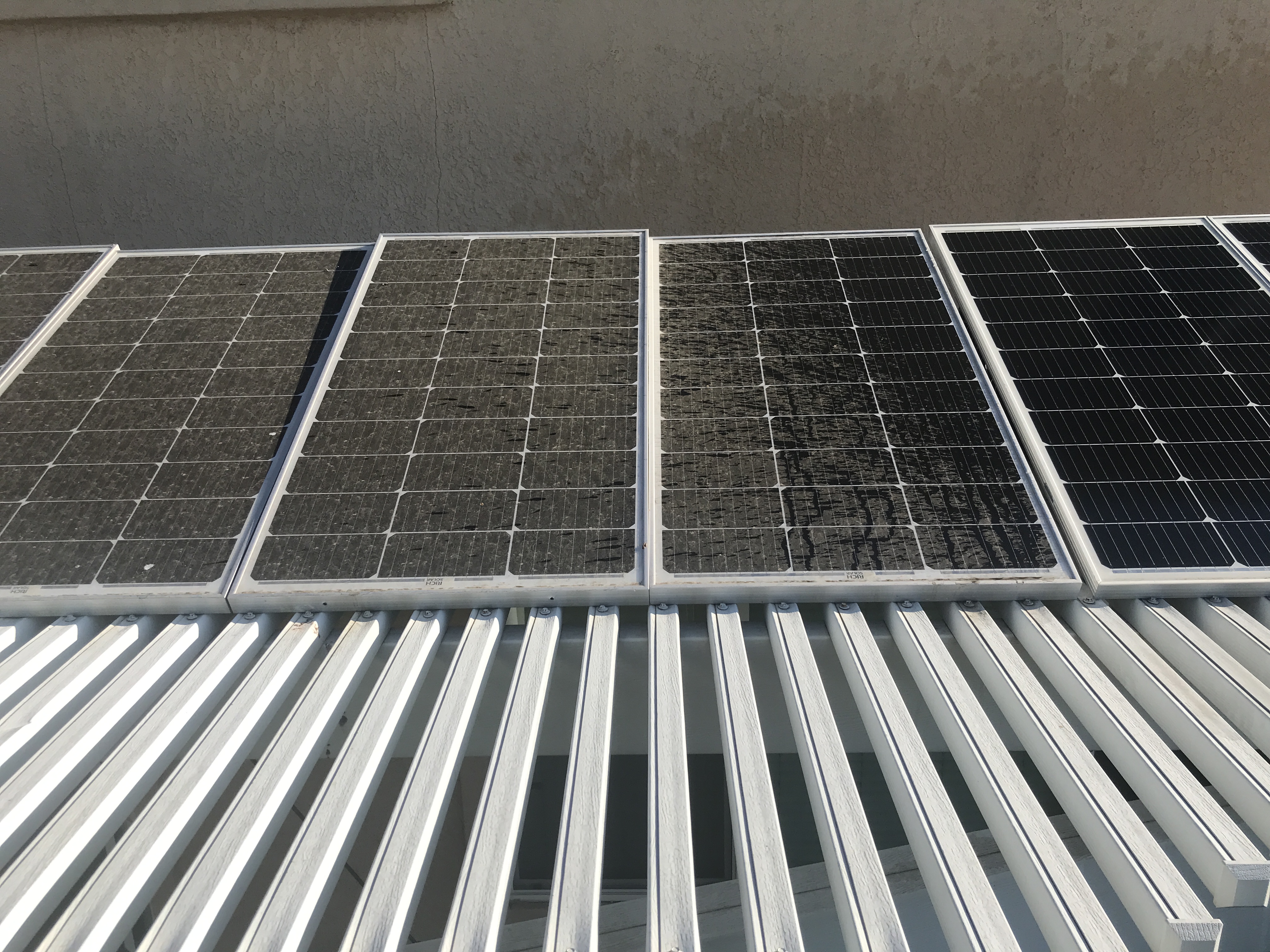

so this morning I decided to hose off the ten 100 watt solar panels that make up Solar South
don't mind the free range organic cable installation, I am still chasing a potential bad connection

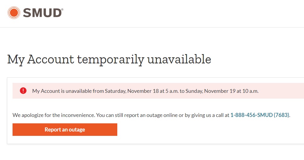

and this is why I hate The Cloud
I was trying to see my energy usage and of course their website is down middle of the day
