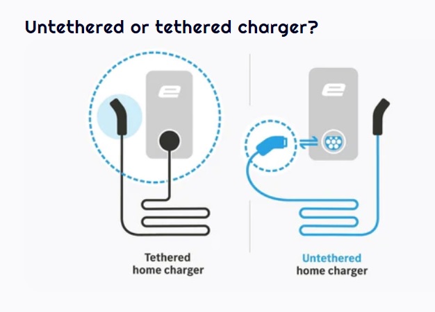

Tethered vs Untethered Chargers
Bigpie wrote: Tue Oct 03, 2023 4:06 pm The Prox pin doesn't connect though the cable, at least not here in the UK where public chargers are not tethered. The EVSE side connector has a resistor between PP and GND to denote the MAX current the cable and connectors can carry. Our public chargers are Type 2.
On the Car side, I use the PP to wake up the charger etc.
thank you for your answer, let's start off by understanding the difference between tethered and untethered chargers, I mention this because here in the States all the public charging stations I have seen look like gasoline fuel pumps with the shower head like cords attached to them, aka tethered, so the concept of untethered is [ahem] foreign to us, I wonder how they do in Canada, or Mexico?

thank you for this explanation, please bear with me as I dumb it up so I can understand it.
"... Each plug has a resistor between PP and PE. " PE stands for Protective Earth aka ground

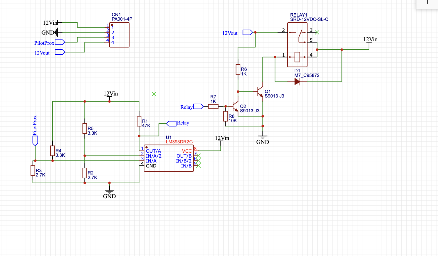

So thanks to Jamie Jones who heard the cries for help on Facebook a comparator LM393P is winging it's way here so with any luck we'll have a working setup sometime next week.
This is/these are the circuits he sent me but it should be easy to find more on t'Internet if I struggle.
Also I ordered 5 JIC. :P

So after a bit of messing about I came up with a circuit that works well enough to turn on the relays when the charger plug is inserted and turn off the relays when the catch is pressed on the J1772 handle so that I can't pull the handle out with the current still flowing.
In my case the J1772 socket already has a 2.7k resistor going to ground built into it so I took that out of the circuit.
I also found that with 3.3k resistor in the voltage divider circuit from 12V to pin 2 the relays were on all the time even without the cable plugged in. I tried changing the 2.7k resistor but couldn't get the circuit to trigger when the catch was pressed so changed the 3.3k resistor instead. I used a POT fo figure out what the ideal resistance was and it ended up being 255R. I didn't have a 255R resistor have so used a 240R and 13R in series which was close enough.
The relay module I'm using is a 12V 8 way block that can be set to trigger on a neg or pos signal.
https://amzn.to/4hroiOX
This is it on some strip board and so far it's working so now I need to work out how to implement it.
