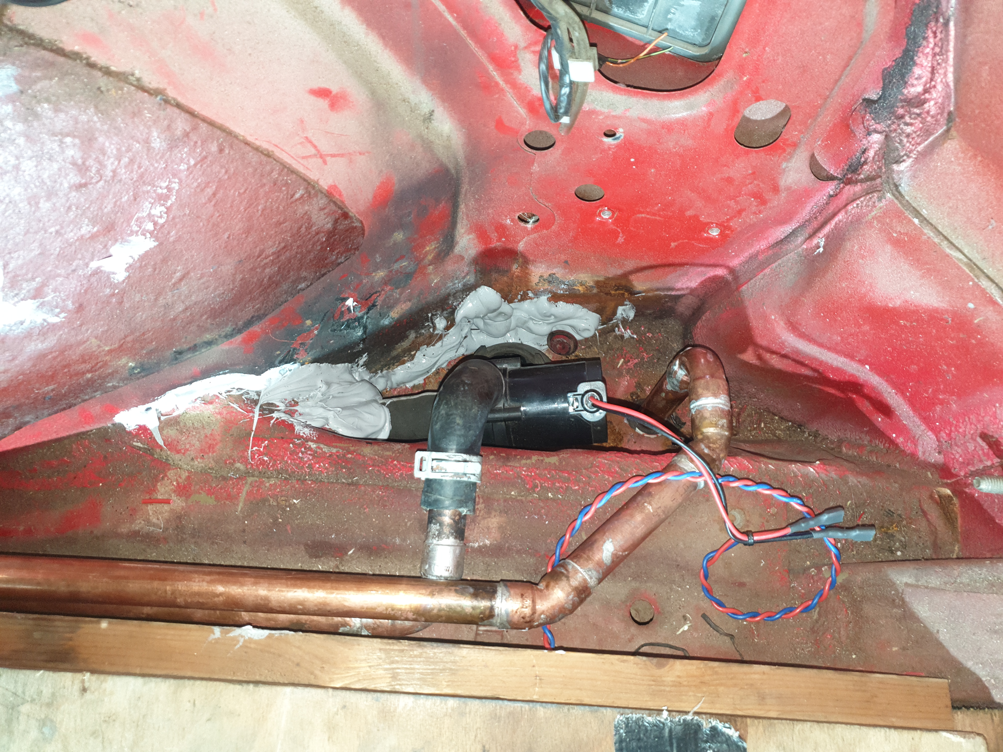

When thinking on how to route cooling hoses i decided to use 18mm copper tubes. They can be soldered and i tried to form straight lines whenever possible. Small mixing bottle will serve to remove air from the system and i will release it from the top valve.
Whenever tube was routed throught car casing - sheet metal i used small piece of coolant hose which i cut in the middle. This middle part would caught on the hole in the metal and form a sort of grommet. This is so that i dont get metal on metal contact...
Underneath the car i mounted a small radiator. I used reducers to bring 18mm tube to 10mm hose which will connect to the computer alu radiator. I hope radiator and one fan will be enough.
Now i need to test the system by filling water and circulating the pump. I have that wired so when charger is active it will automaticaly power the pump and the fan.

arber333 wrote: Wed Apr 03, 2024 9:01 pm Small mixing bottle will serve to remove air from the system and i will release it from the top valve.
What that small mixing bottle is from? I'm looking for a small coolant bottle but I'm struggling to find something that small. And which valve you used? Thanks 😊
Posts: 3571
Has thanked: 134 times
Been thanked: 339 times
Re: Mazda MX-3 electric
m.art.y wrote: Sat Sep 14, 2024 6:06 am What that small mixing bottle is from? I'm looking for a small coolant bottle but I'm struggling to find something that small. And which valve you used? Thanks 😊
I had some trouble to deair cooling loop and i had this Opel Ampera coolant bulb handy. It is made so the coolant from 3 sides enters this bottle and the air is trickled out while mixing. Great stuff! I wanted to use this with cooling/heating system for battery modules. I expected a ton of problems with air bubbles there... https://rrr.lt/en/used-part/air24690-20 ... NjU0NzkwNQ..
I also go a small header tank from Mercedes Benz cars and was considering of using it...
https://rrr.lt/en/used-part/zeb11792-a2 ... -reservoir
There is also Ampera coolant tank meant to keep battery coolant and it is great for suplying two separate systems. It has the same bulb installed. This tank sits upfront under the hood. Great for mixing fluid for two systems. download/file.php?id=27005&mode=view
