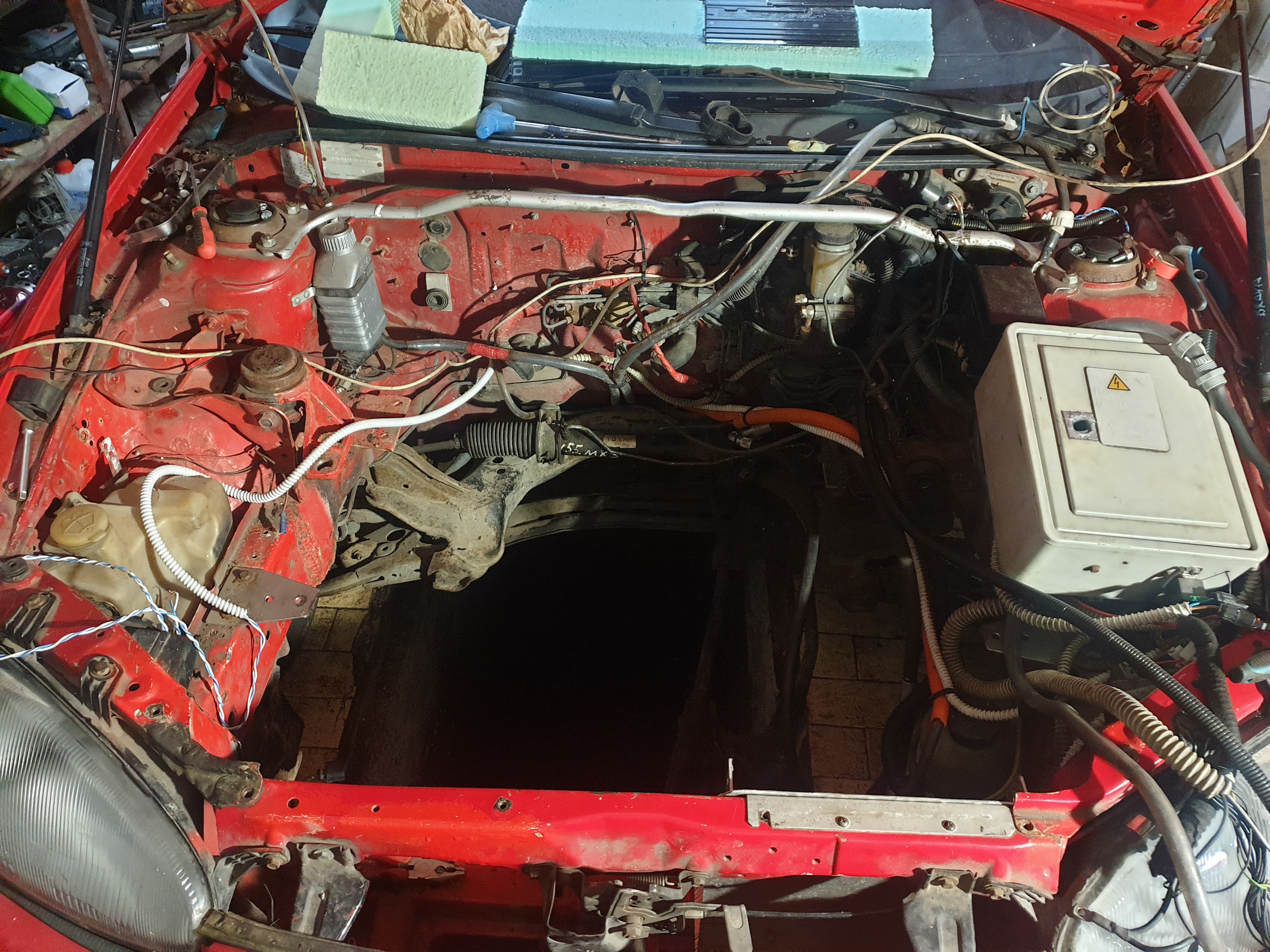

I came back to roots and decided to remake my first EV.
Mazda MX-3 that i converted back in 2013. Old build log is here: https://mazdamx3ev.wordpress.com/

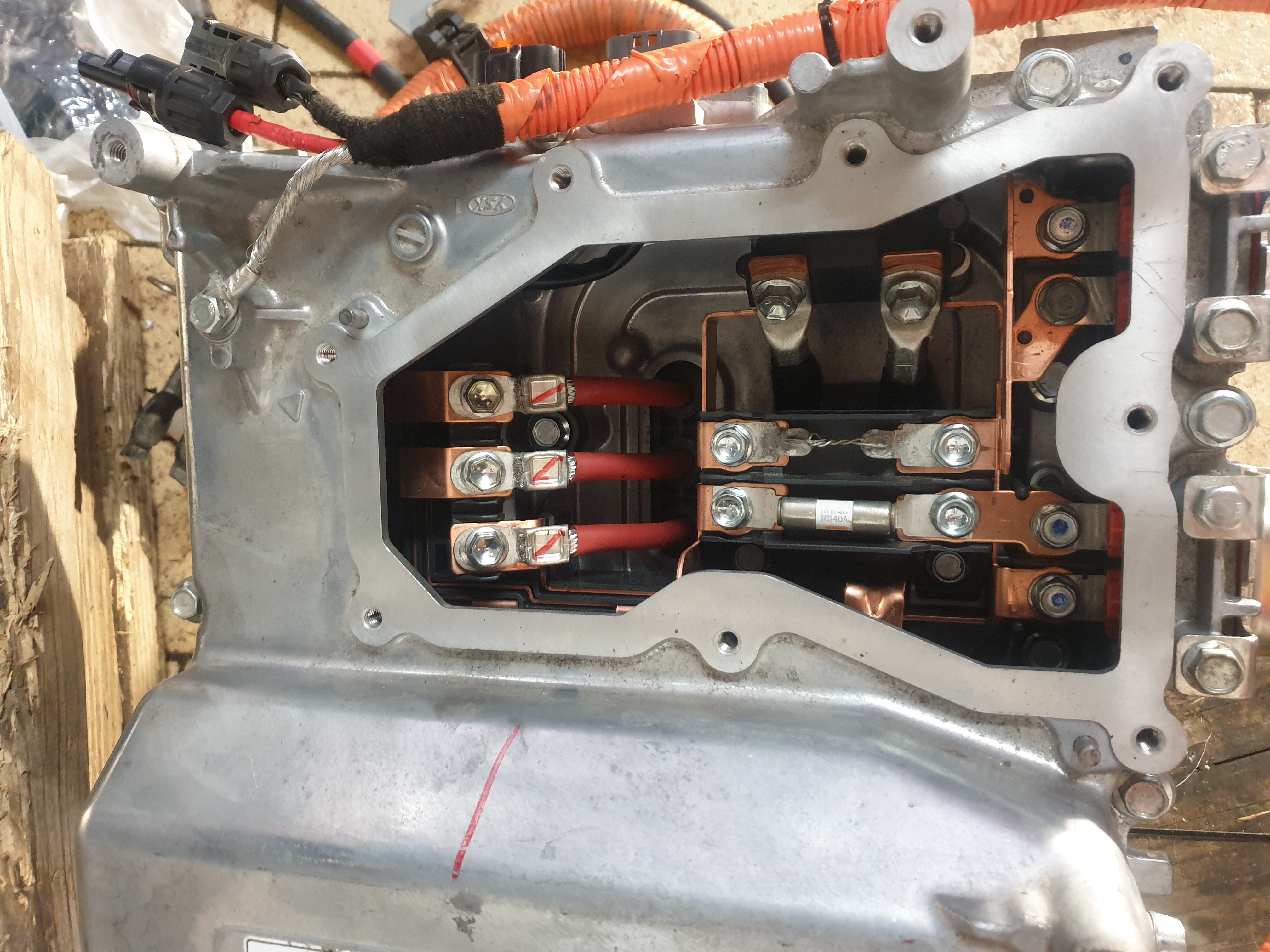

Well i decided to remove the old air cooled ACIM motor and install Outlander rear motor in place.
I will use OEM inverter and my ESP32 VCU built to control Outlander inverter, charger, heater and JK BMS.

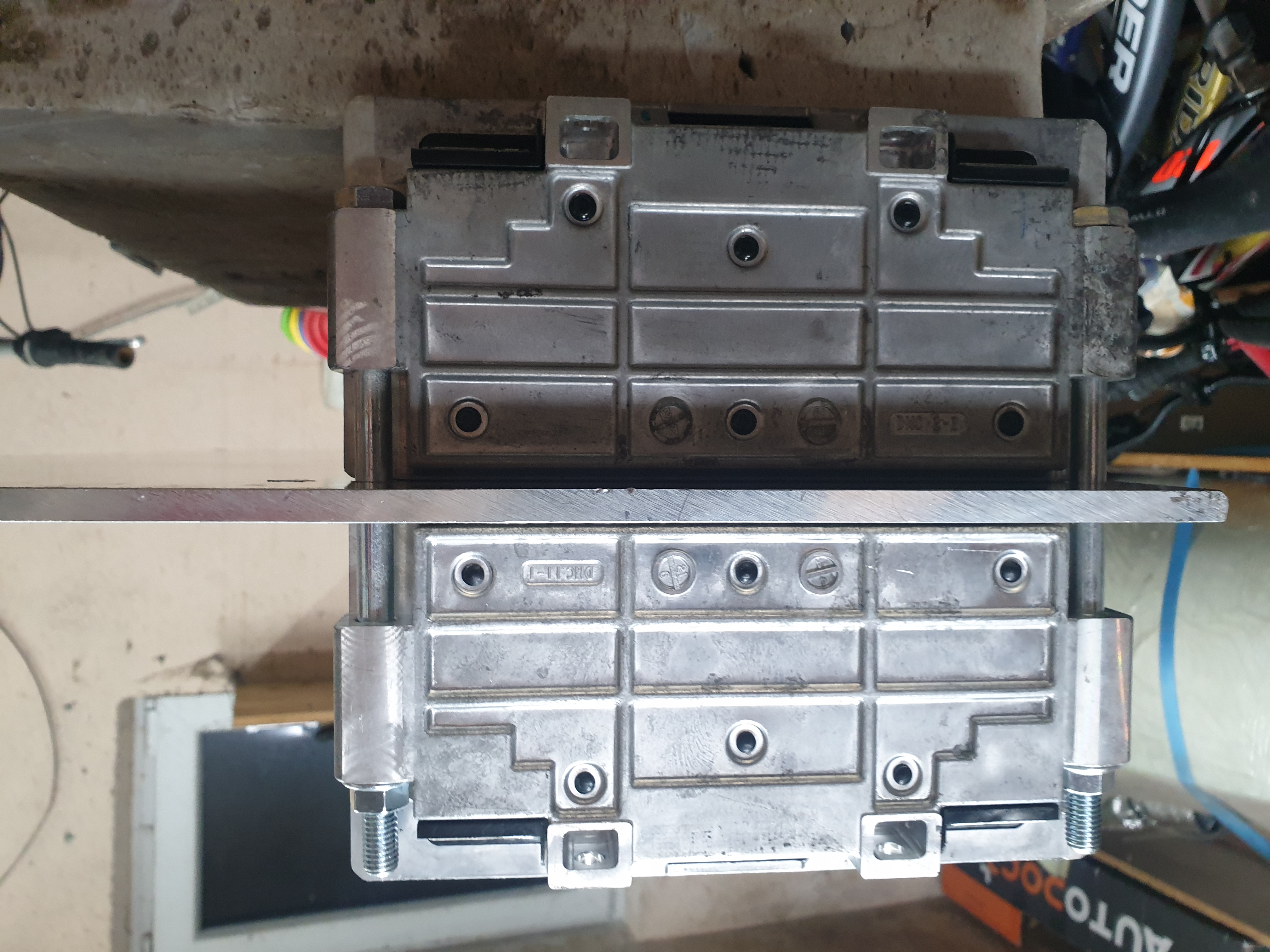

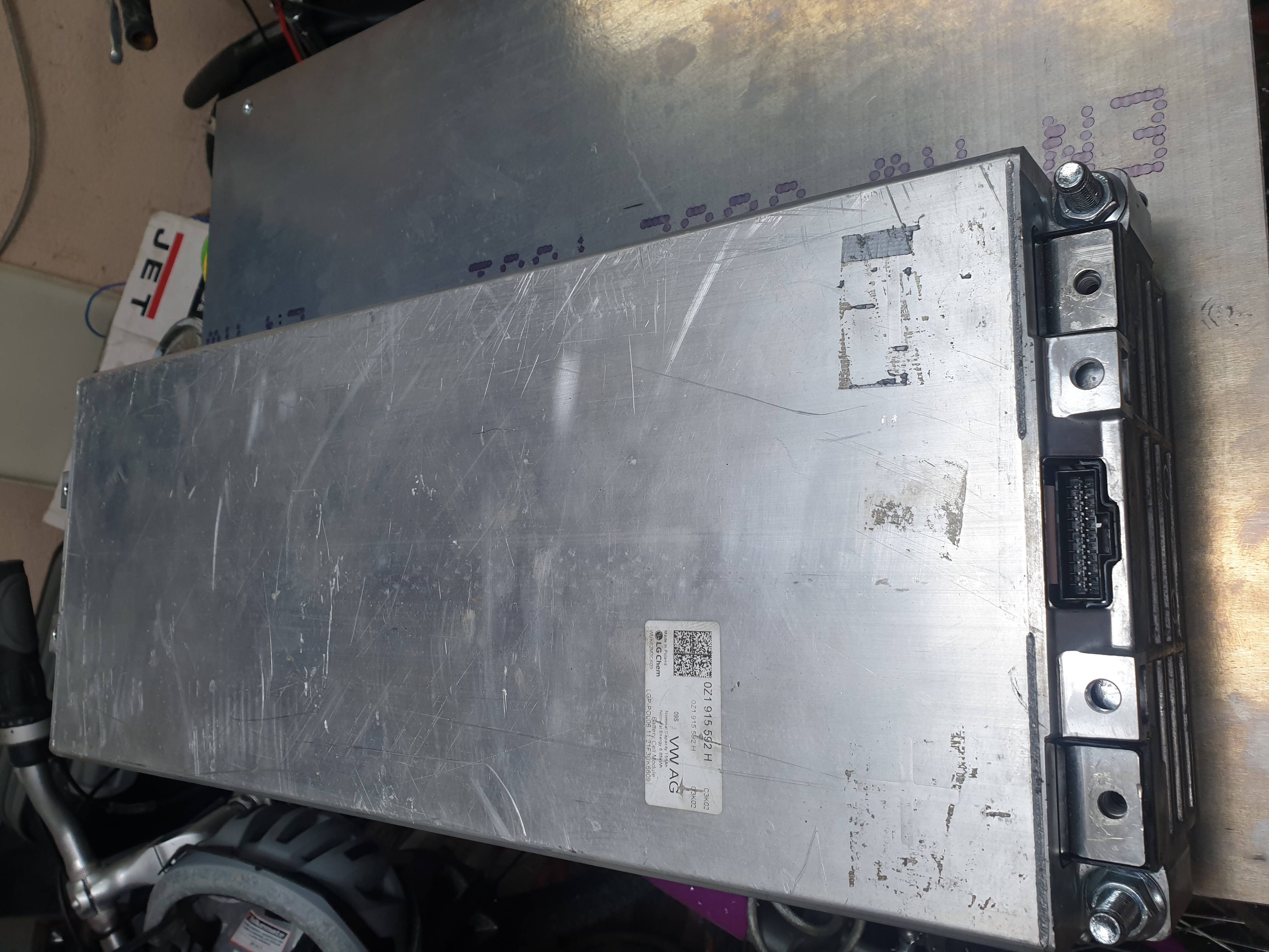

Some photos of Mazda empty space: Motor original position: I will use ID3 modules 6kW8 modules 12S2P in alu boxes. For battery mount i decided to use 3 plate sandwich. I will use two 8mm plates on the outside for stiffness and i will use 5mm plate and cut it simply by jigsaw to a pattern where coolant will flow from one side to the other. Then 5mm plate will be glued between outside plates and bonded by M5 countersunk bolts. I will still have to find a TIG welder to weld two 10mm tubes vertically onto one side of the plate for the coolant to enter the channels.
I currently made two 650mm x 460mm plates and put holes for M10 bolts to fit modules from each side of the plate.

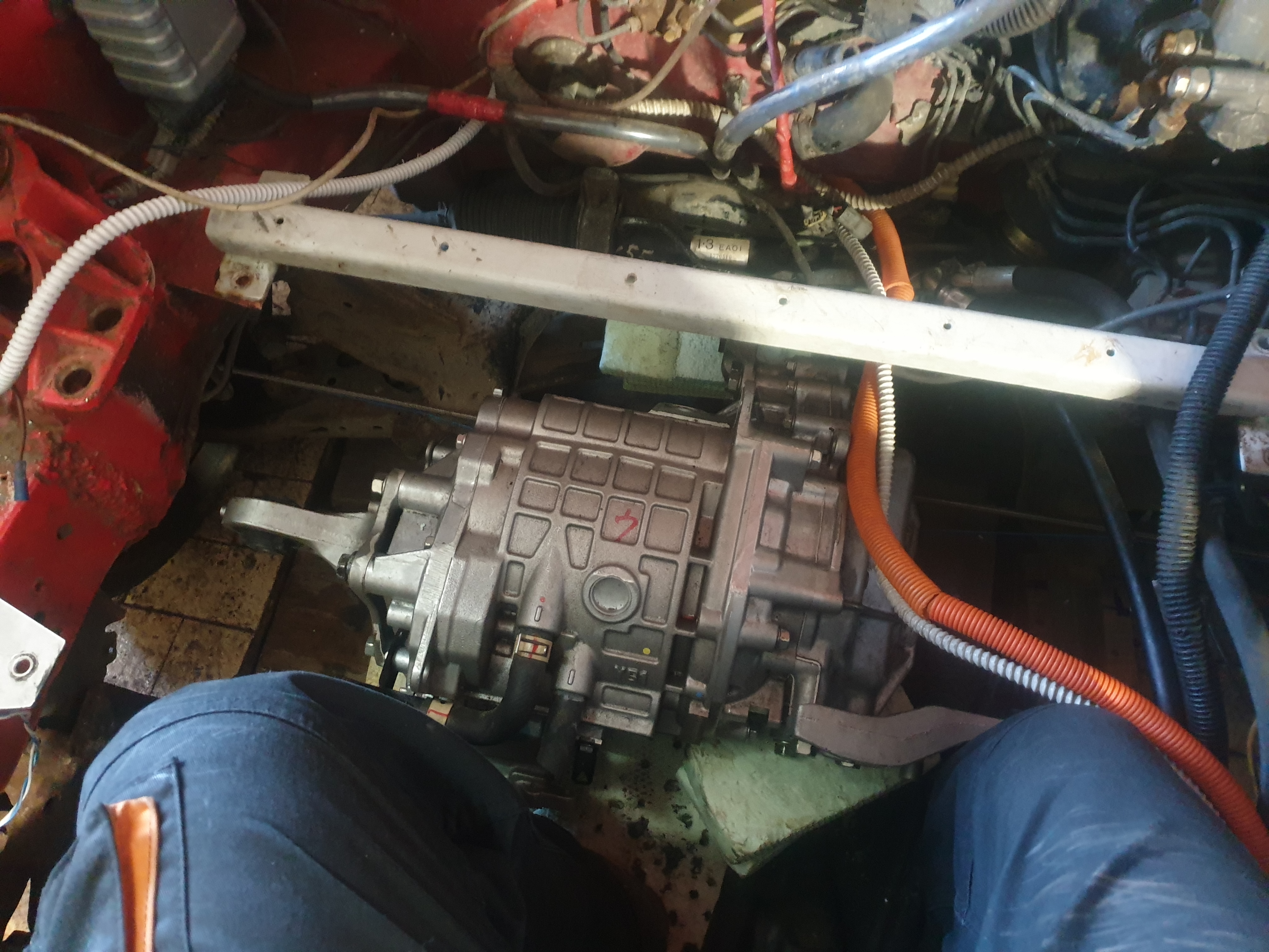

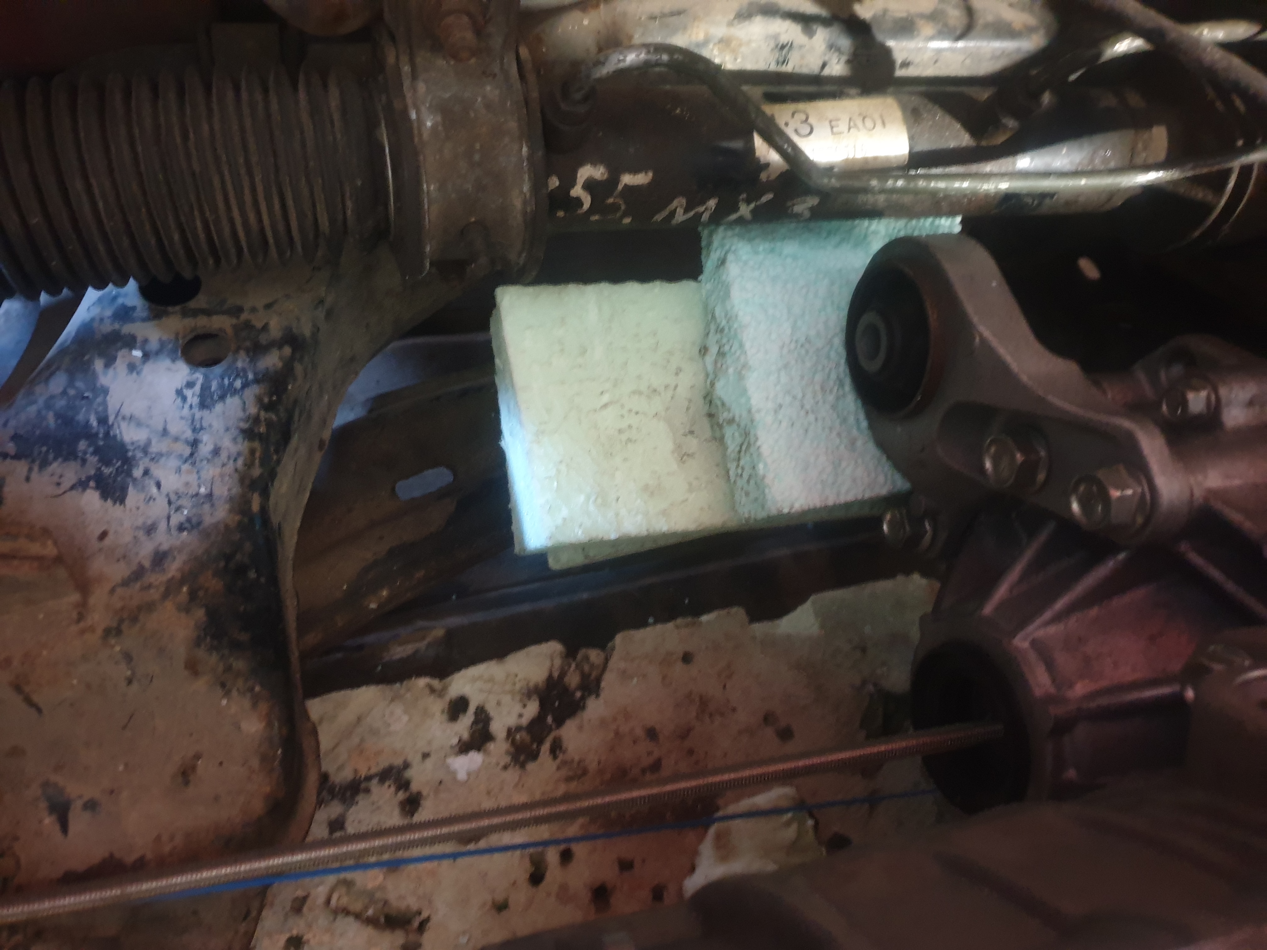

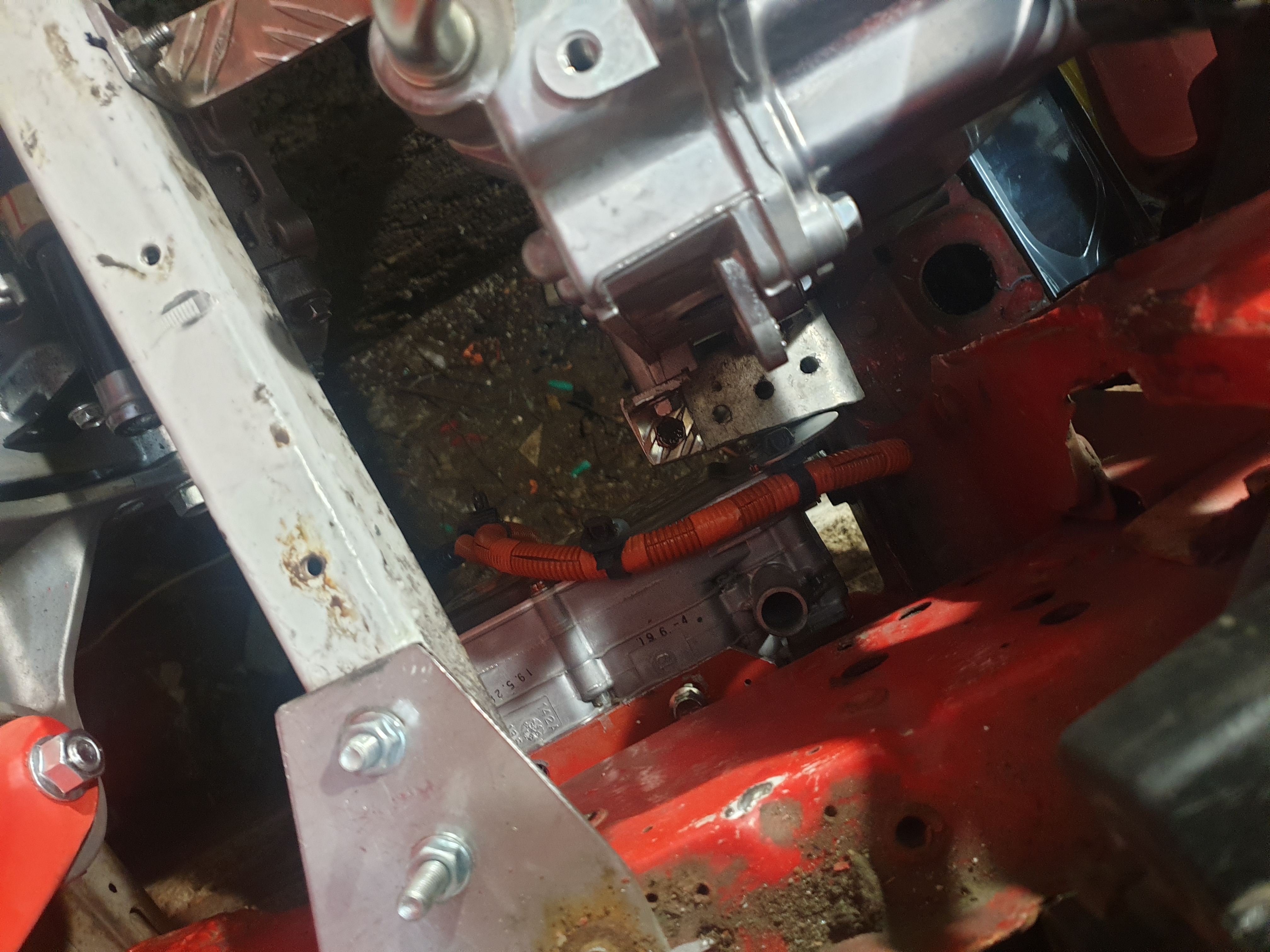

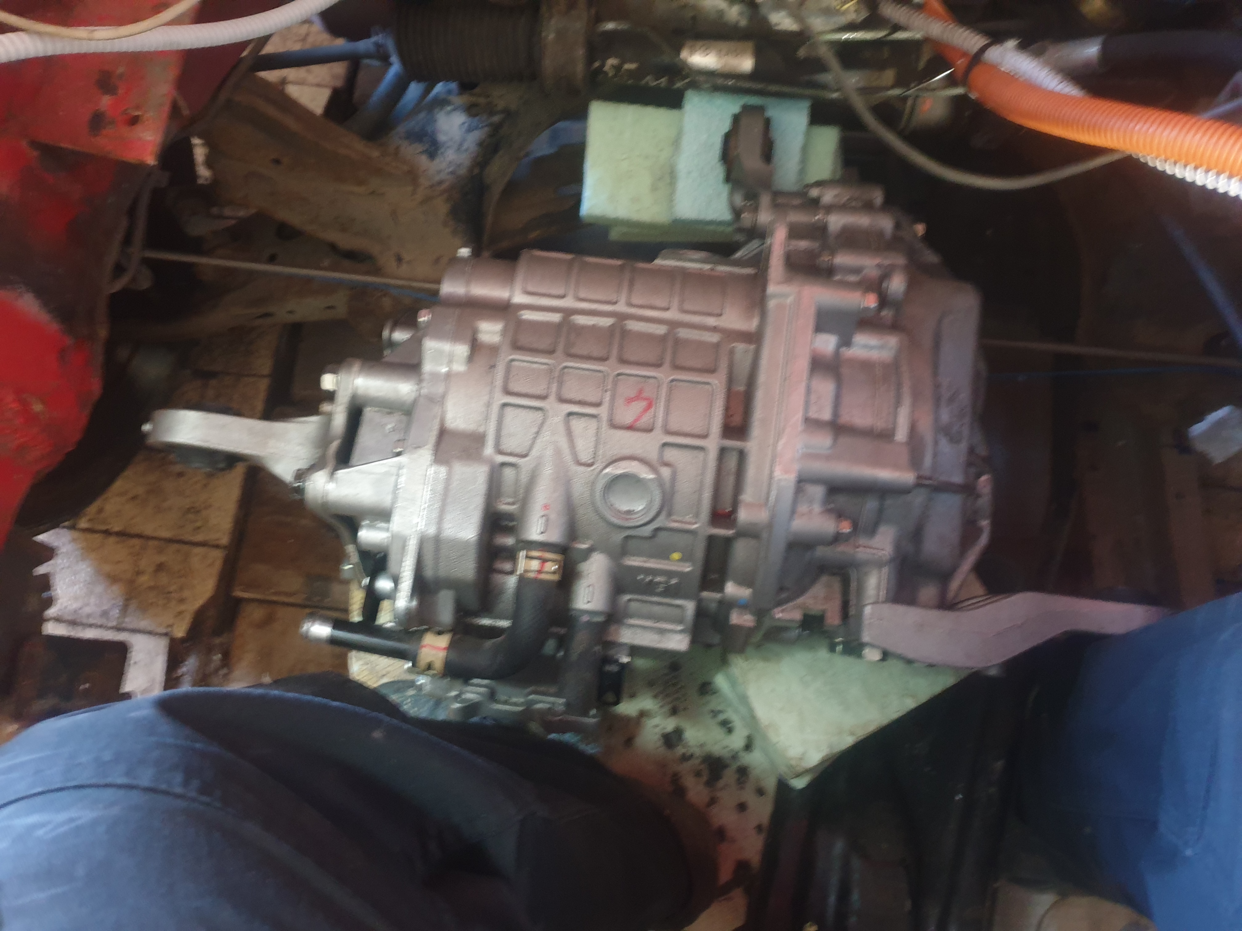

Some more photos of motor positioning. I need to get good level position with driveshaft well clear of the frame when car is on lift!!

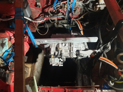

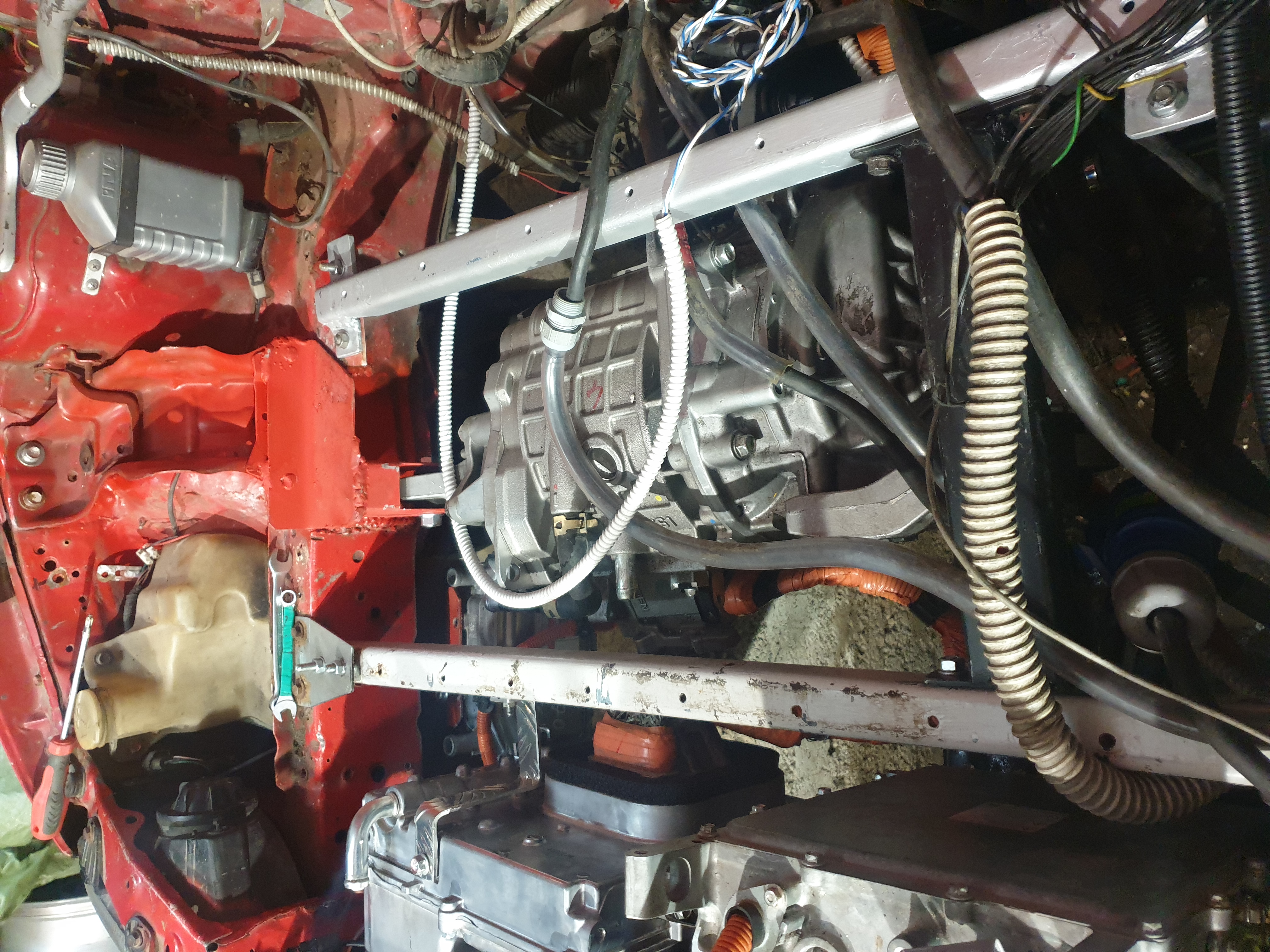

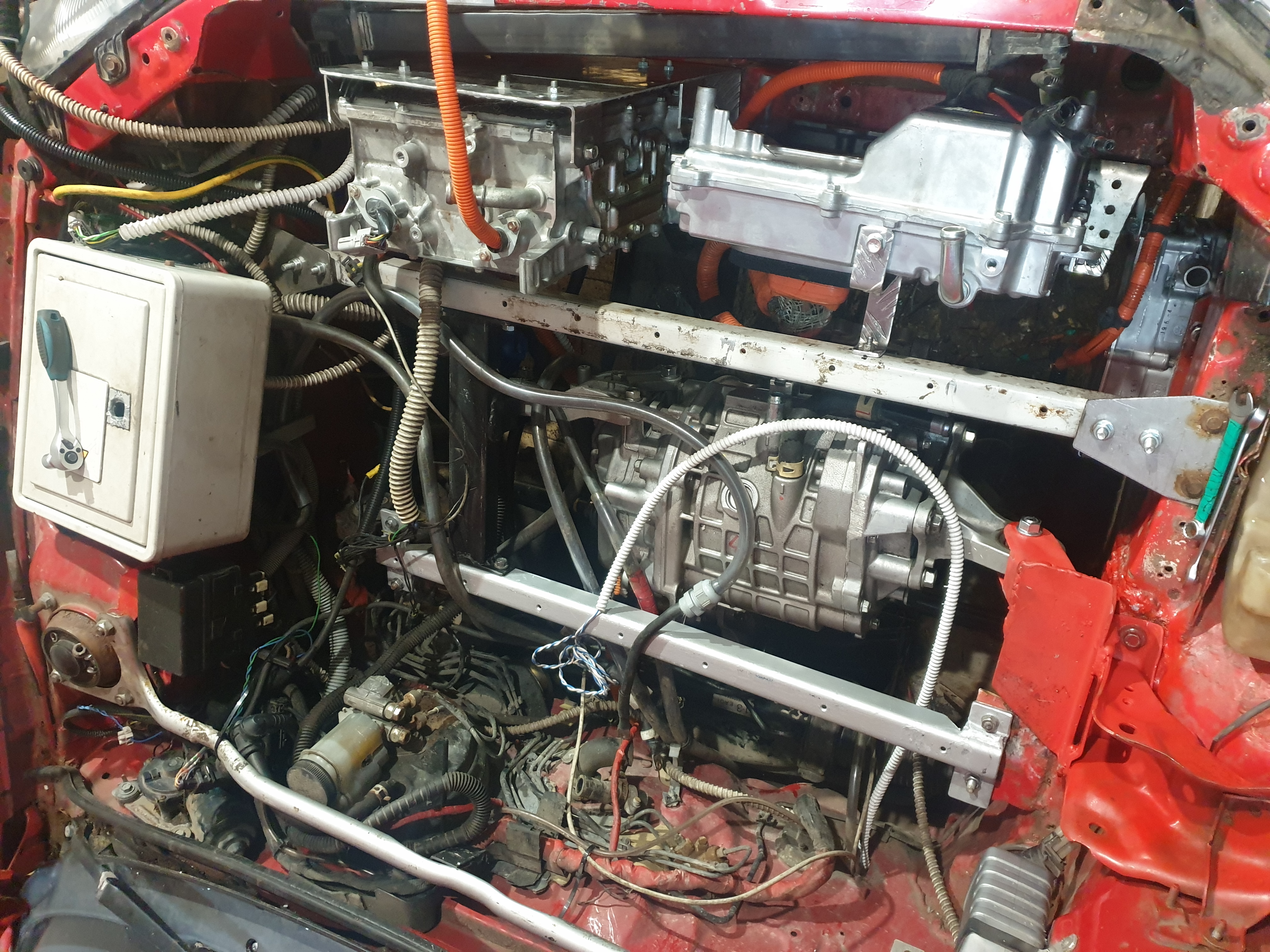

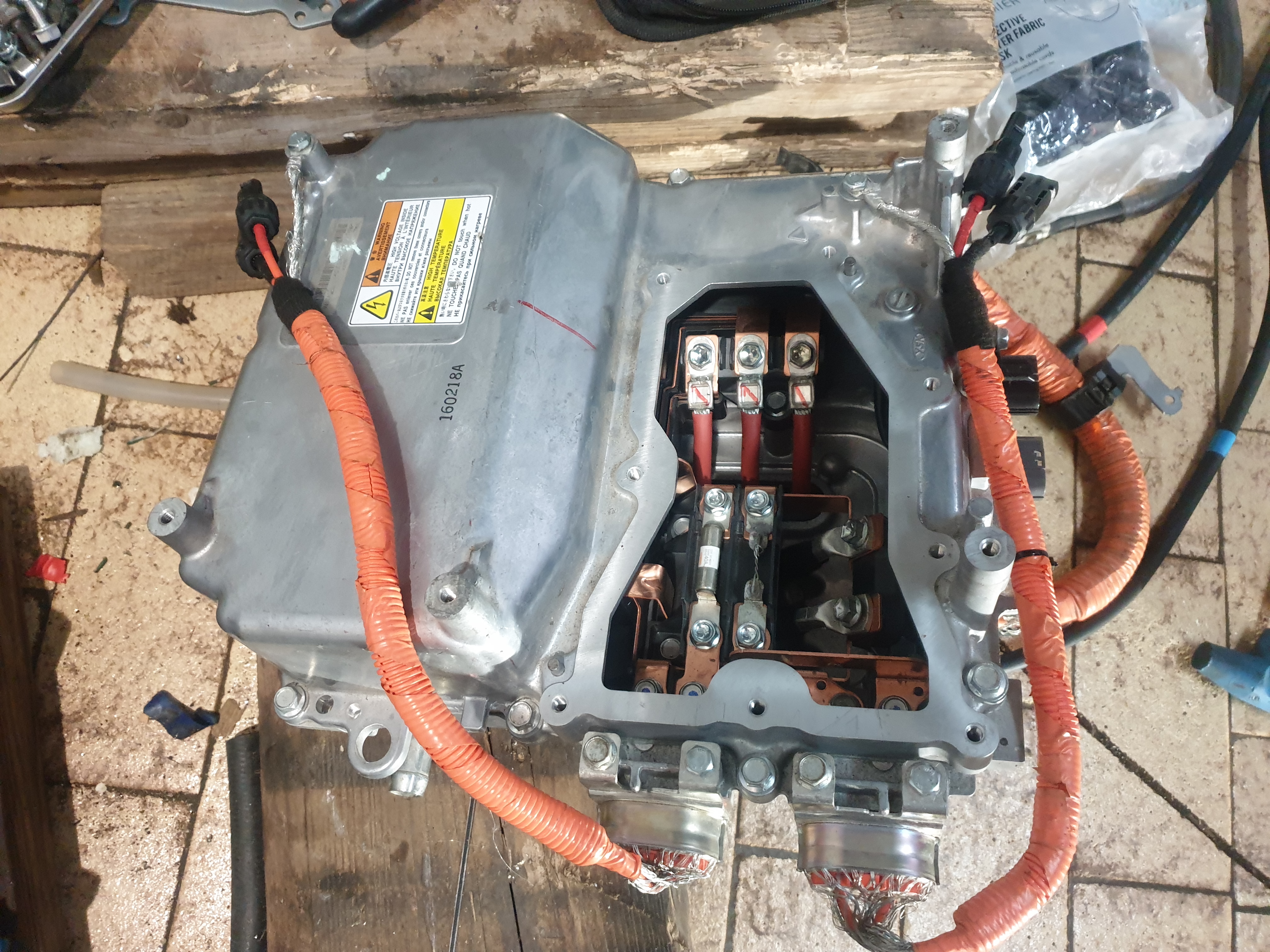

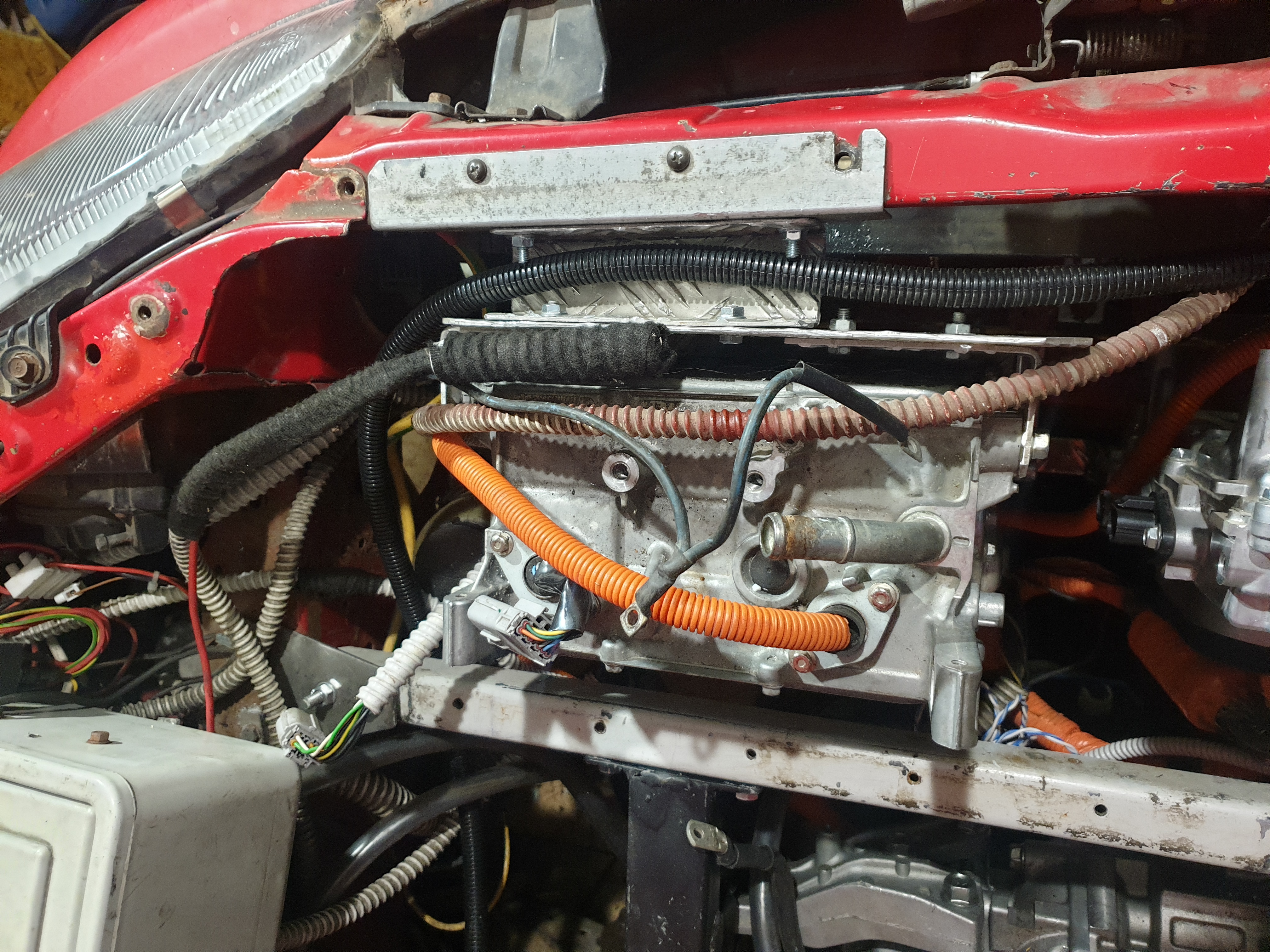

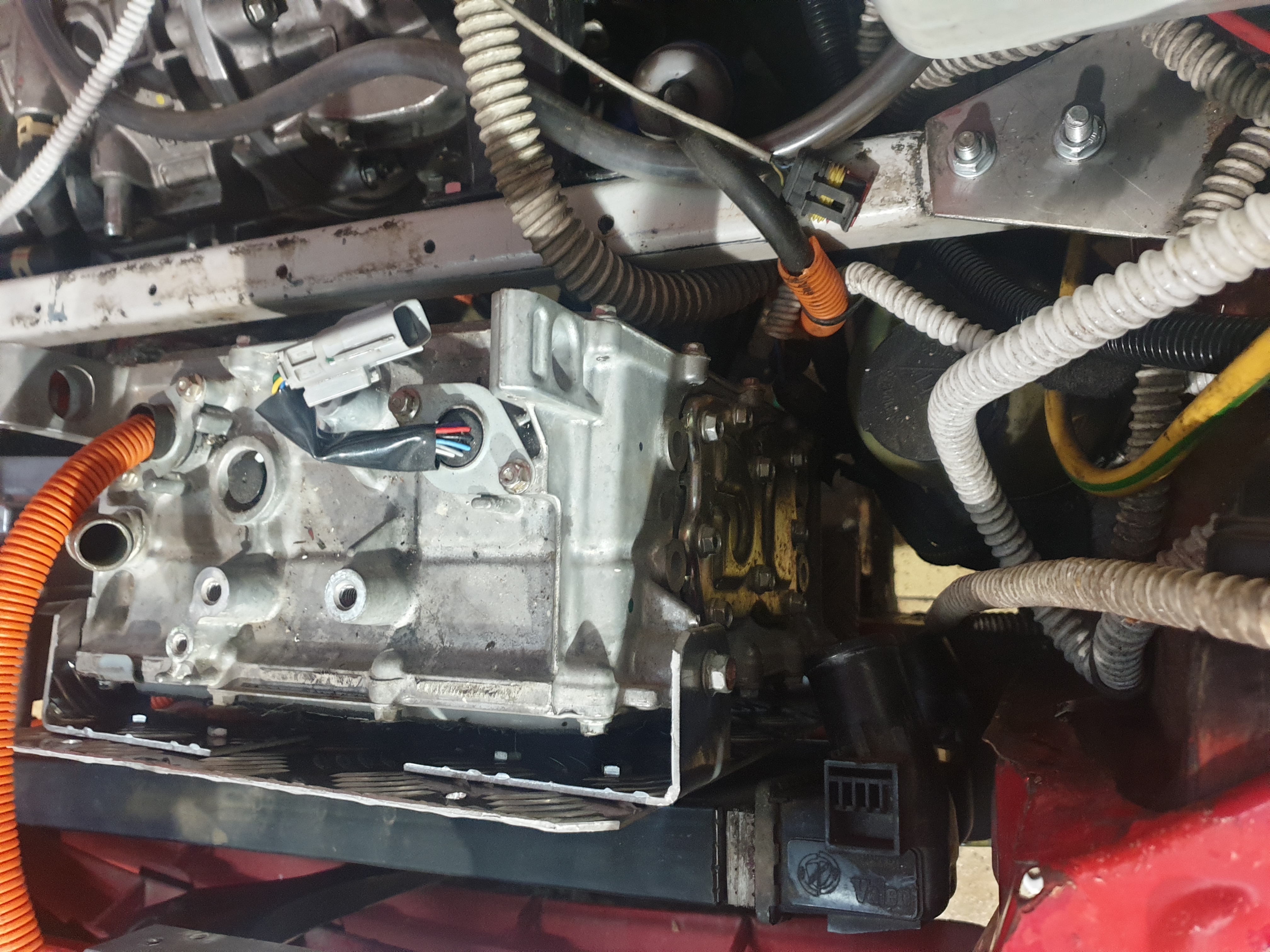

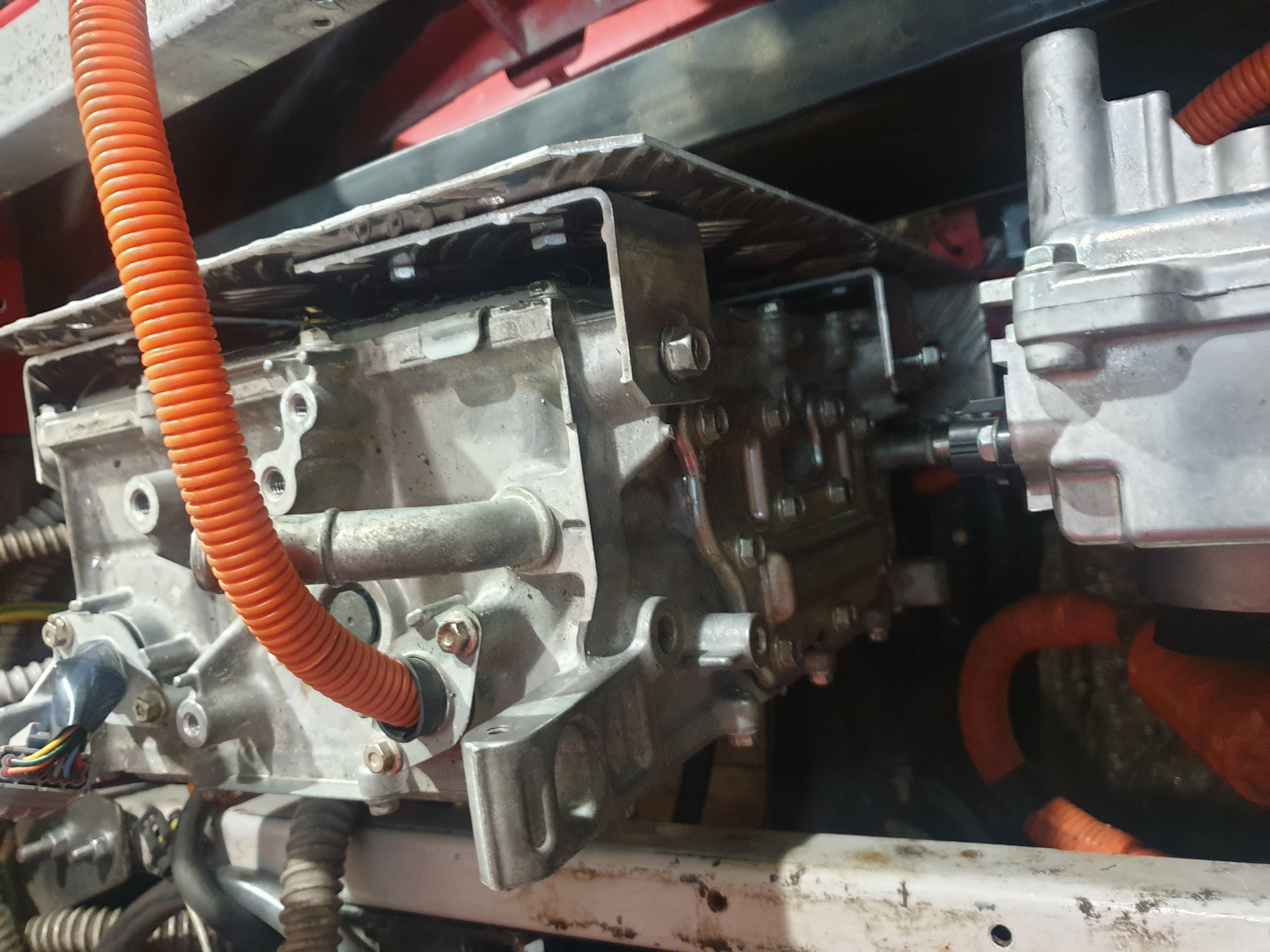

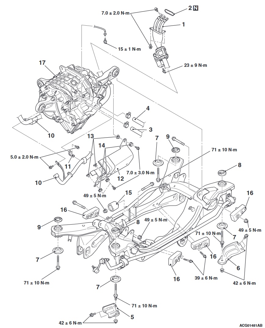

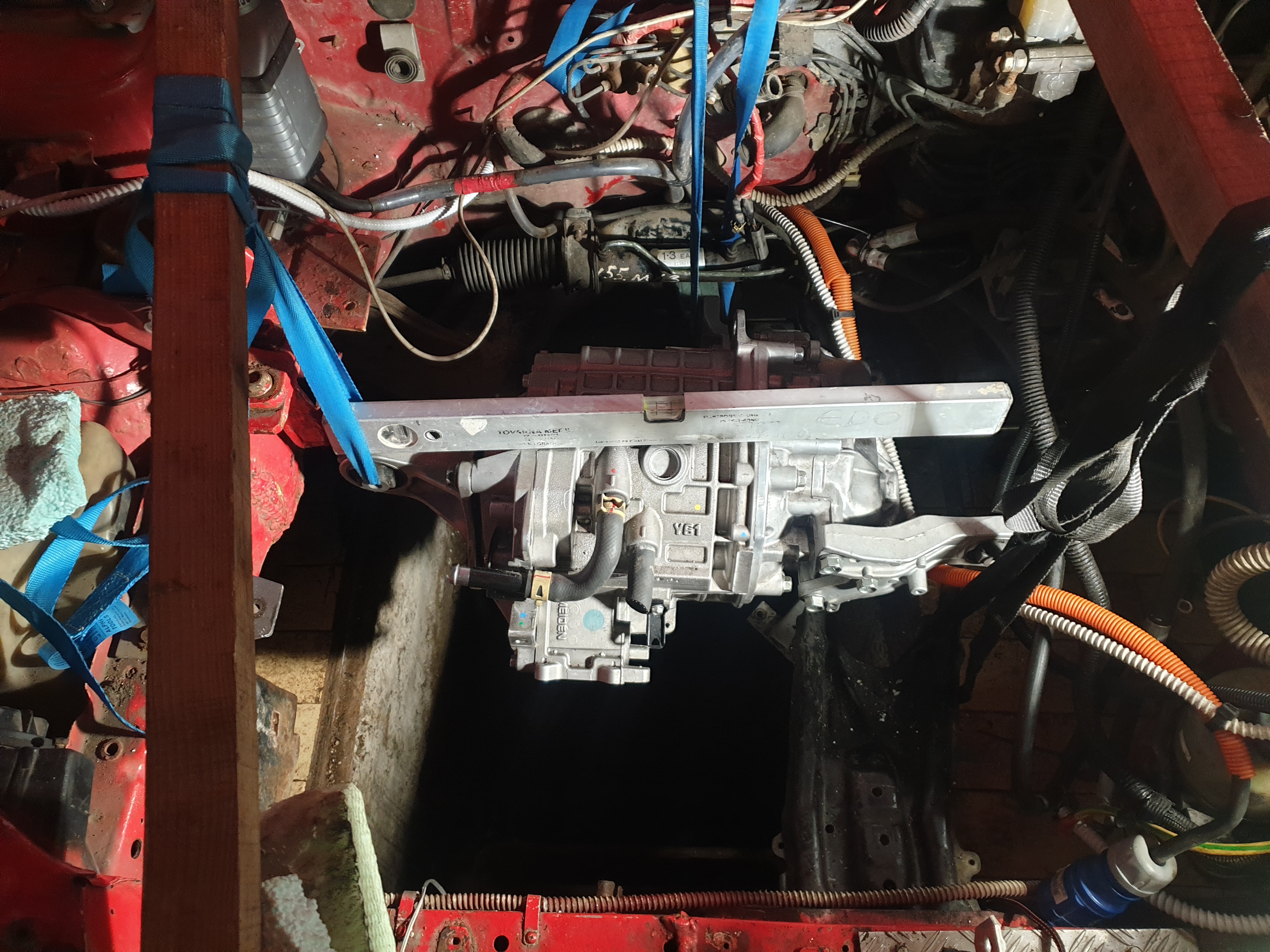

I managed to install Outlander motor. It is a bit offset, to forward axis, like 5deg probably because of my strange bands mounting contraption.
If i dont like it i will correct it by rewelding those forks. Next i started to mount inverter and charger. Well the charger mount was already made. I just repositioned it.
For the inverter i made 5mm alu brackets that mount firmly to the chassis. At least 3 mounts to define position in space. I also put Outlander heater on the side so i can connect and setup hoses. Next i need to fit the front battery box to those transverse beams and make mounts for cell modules inside the rear box.

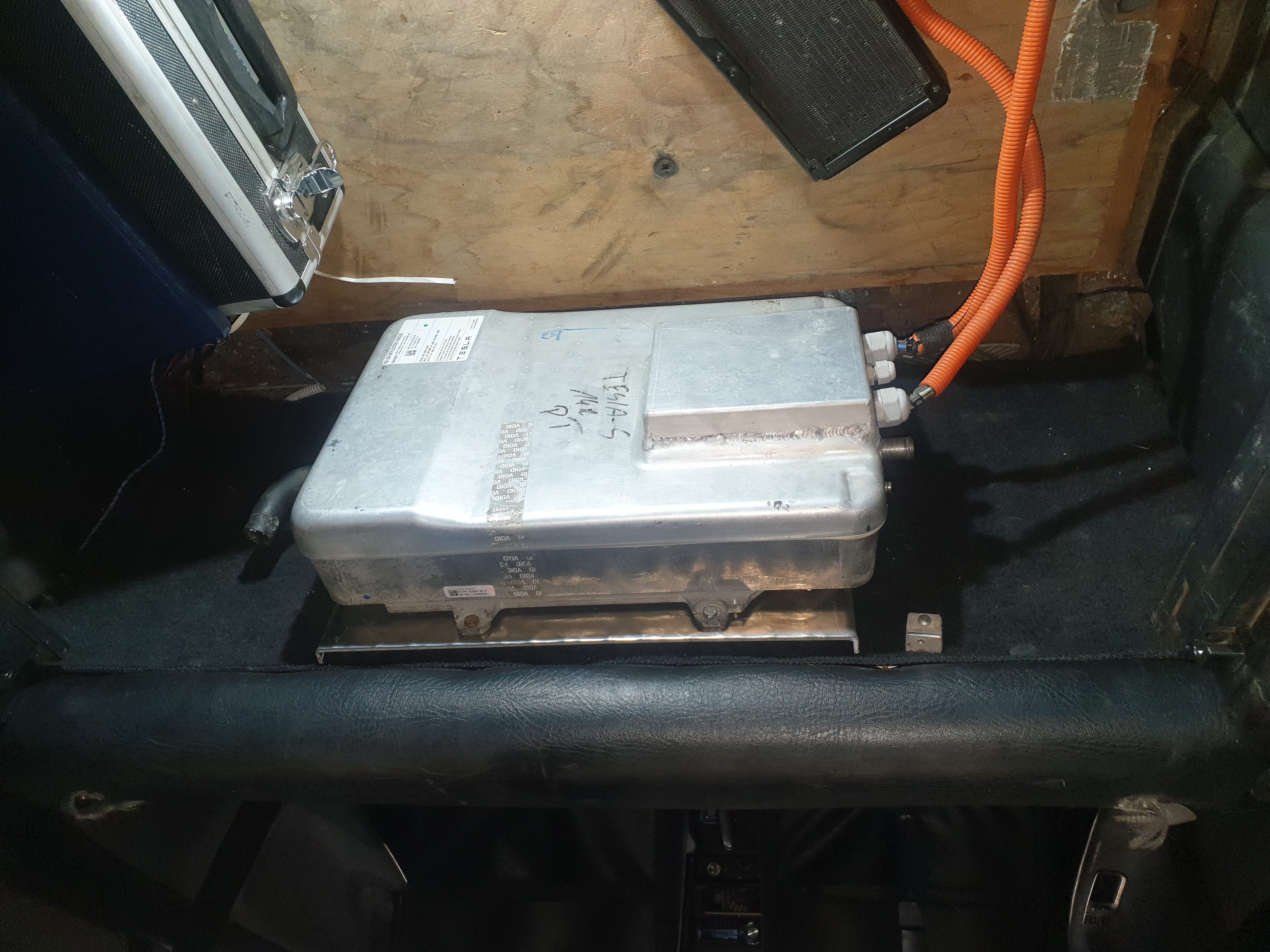

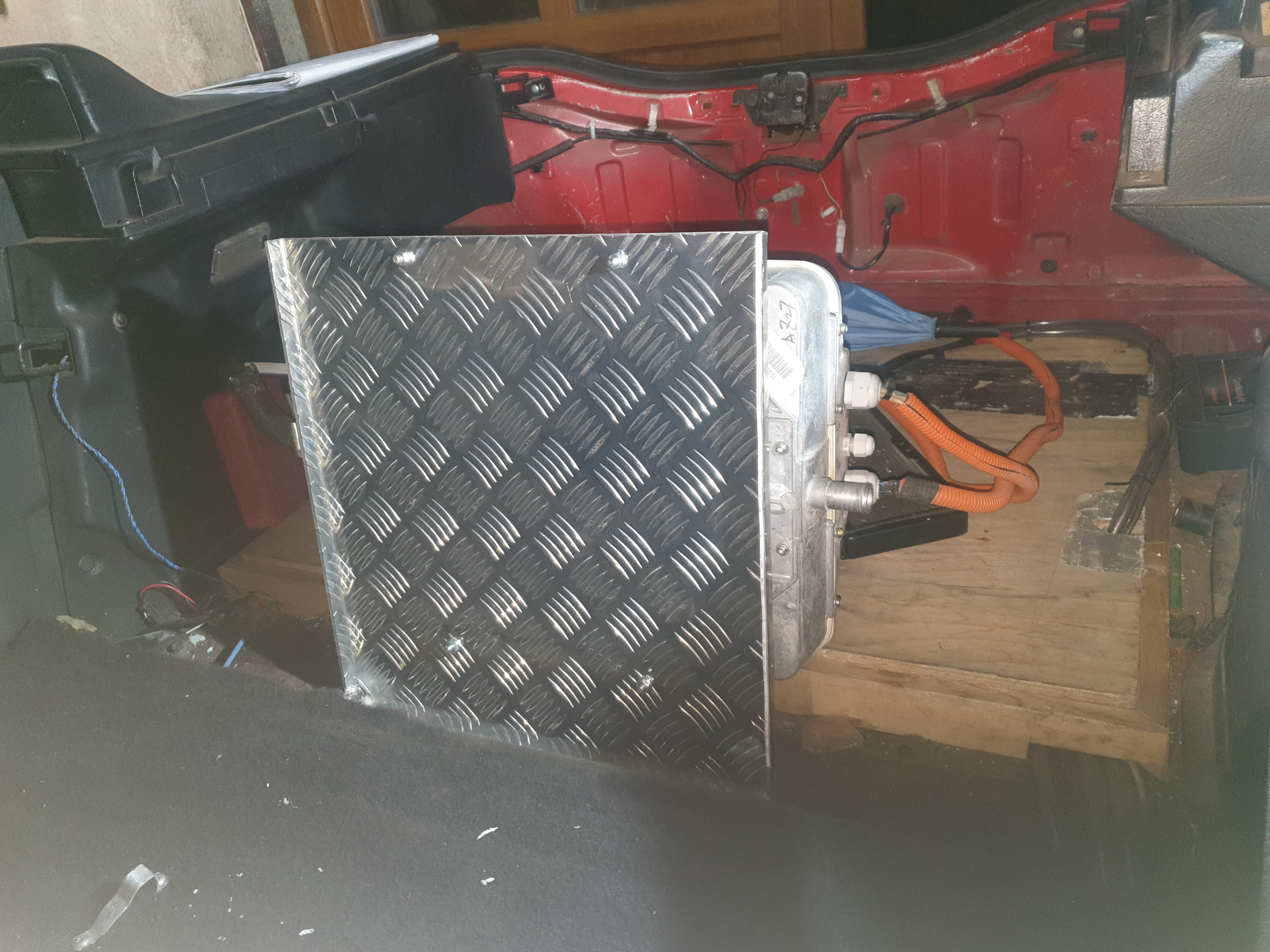

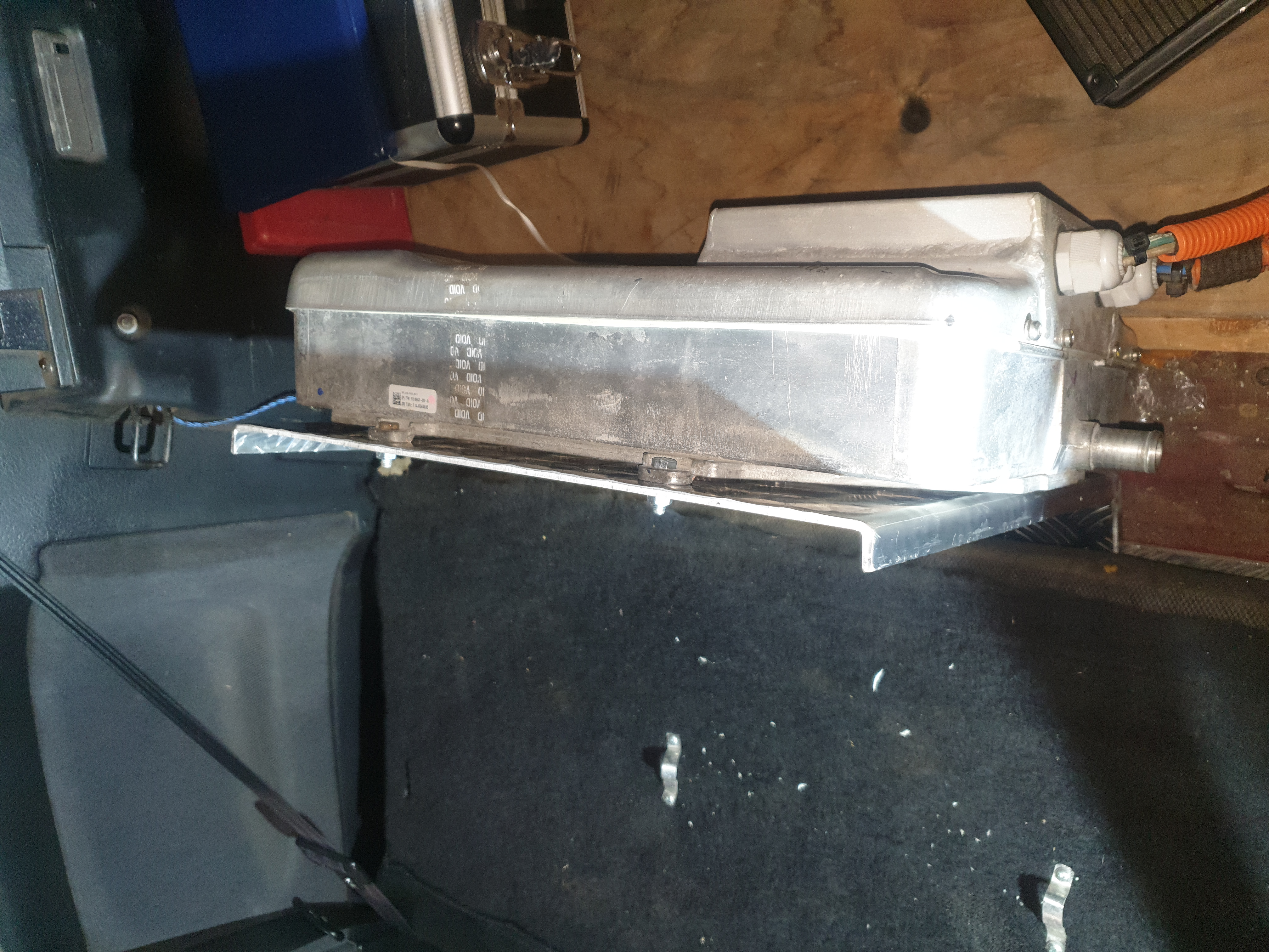

I had to make a fitting to fix the charger in place. I simply made a U channel to keep the distance from the front marker.

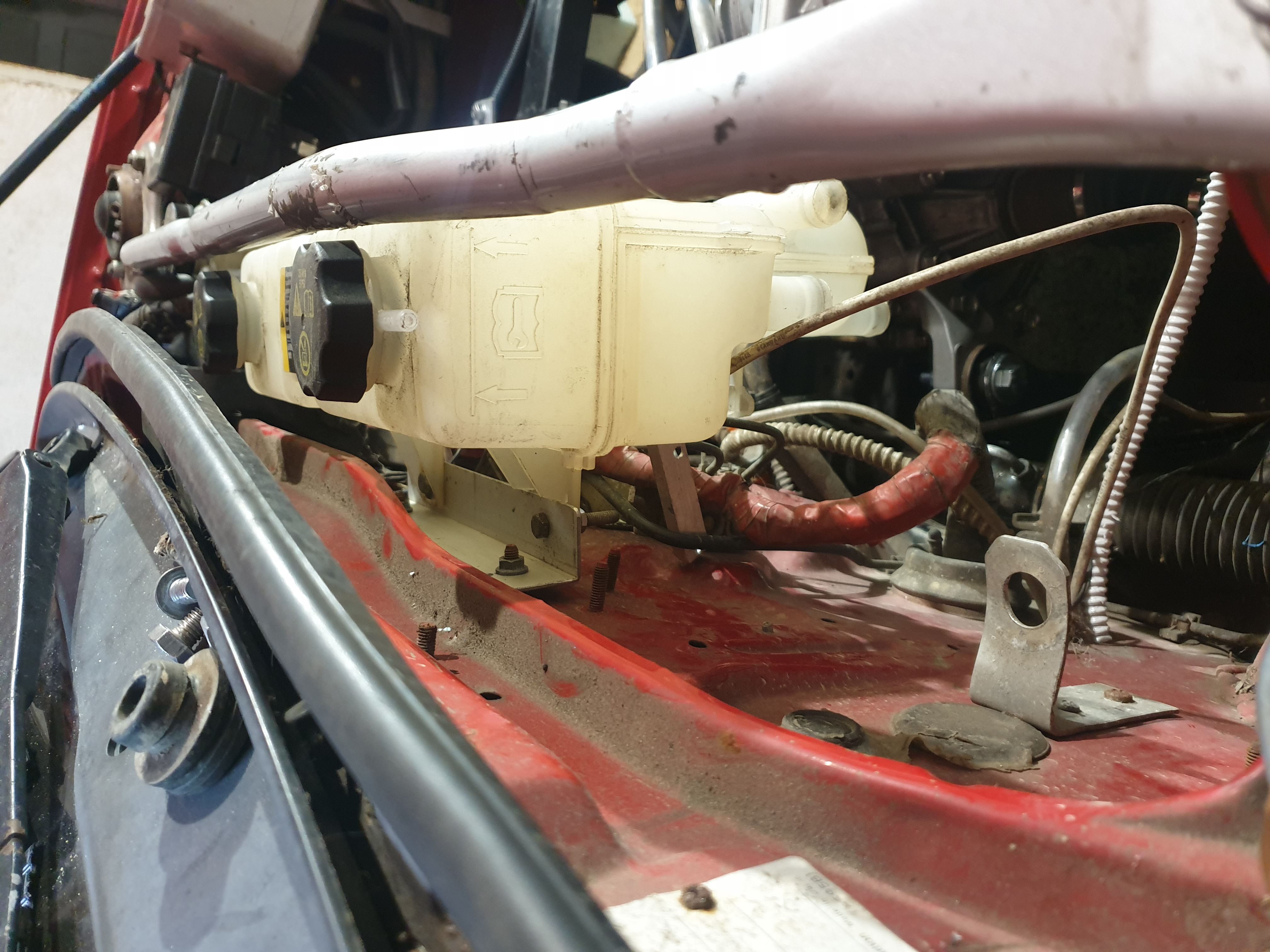

I made a simple angle fitting for the coolant header tanks. On the left will be coolant and on the right i will use liquid for the heater system.
I think of making another simple extension fitting to fix the coolant tanks in place by the 3rd point. I got the front battery box made from inox 1.5mm. Dimensions 470mm x 700mm x 250mmIn. Idea was to fit 4 of ID3 12S modules inside here. In the end i couldnt get the bonnet closed so i had to cut down the last 50mm to taper down the box. This means i wont be able to fit full 4 ID3 modules but only 3 of them. I will be able to fit complete mount of 4 in the back though.

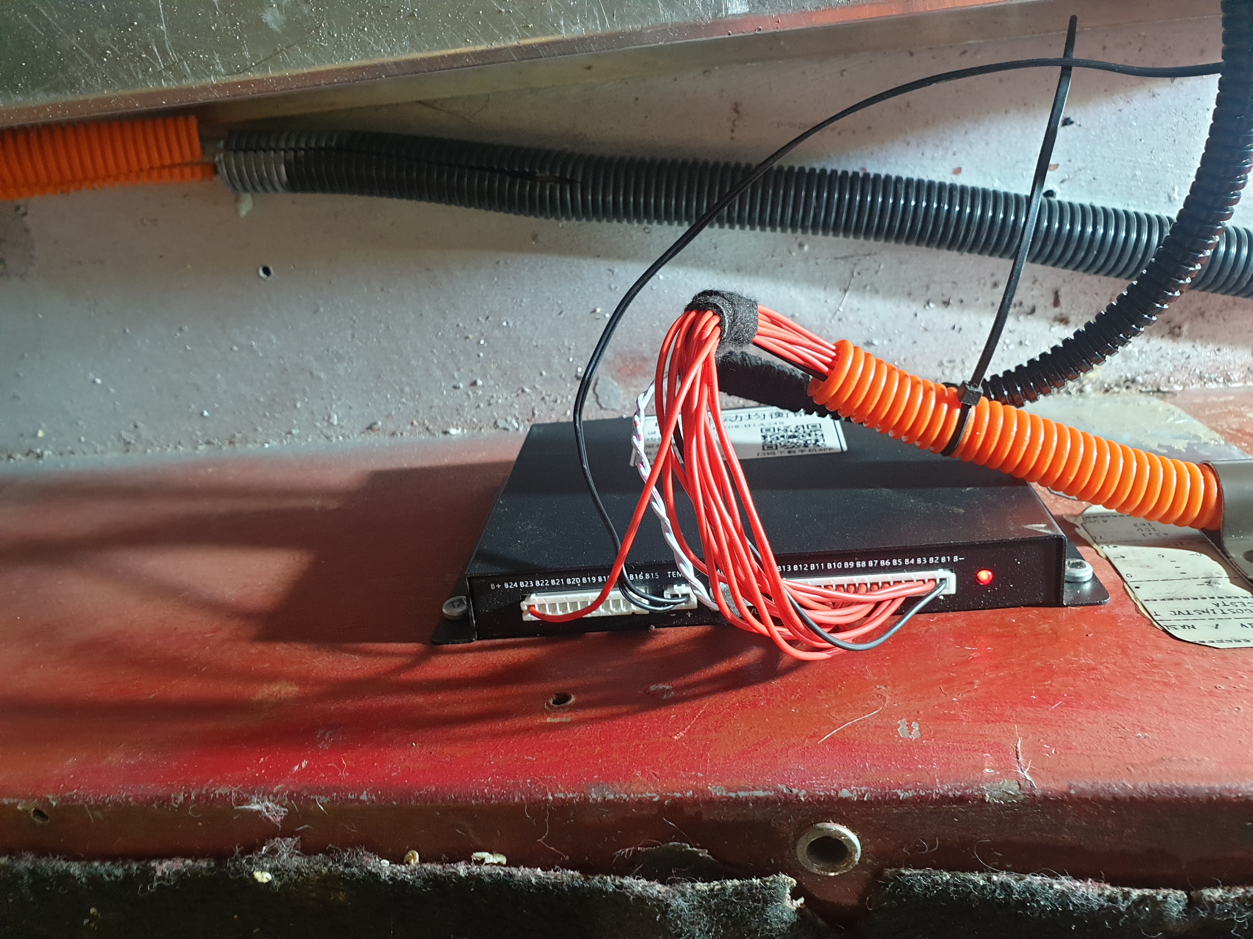

No i dont have any BMS from VW. I will simply use JK BMS and ESP32 VCU as master control. I already wired 3 12S battery modules to 2 BMS modules but i will have to appropriate another 12S module in the 5th BMS module. This means i will have to program my VCU to modules 4x18S and 1x12S.
I still havent decided if i will need liquid cooling or if the ALU plate will be enough of a heat sink...

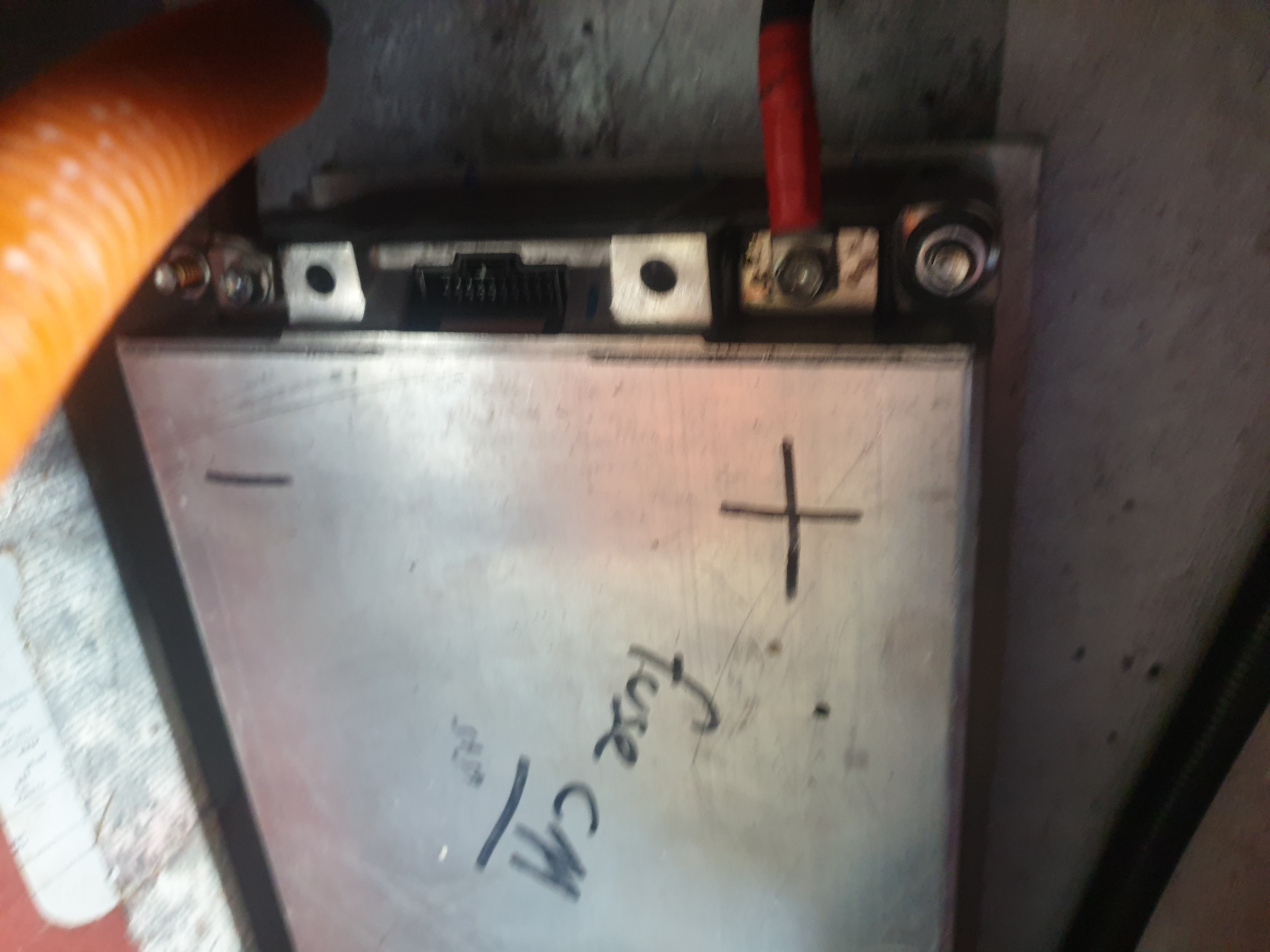

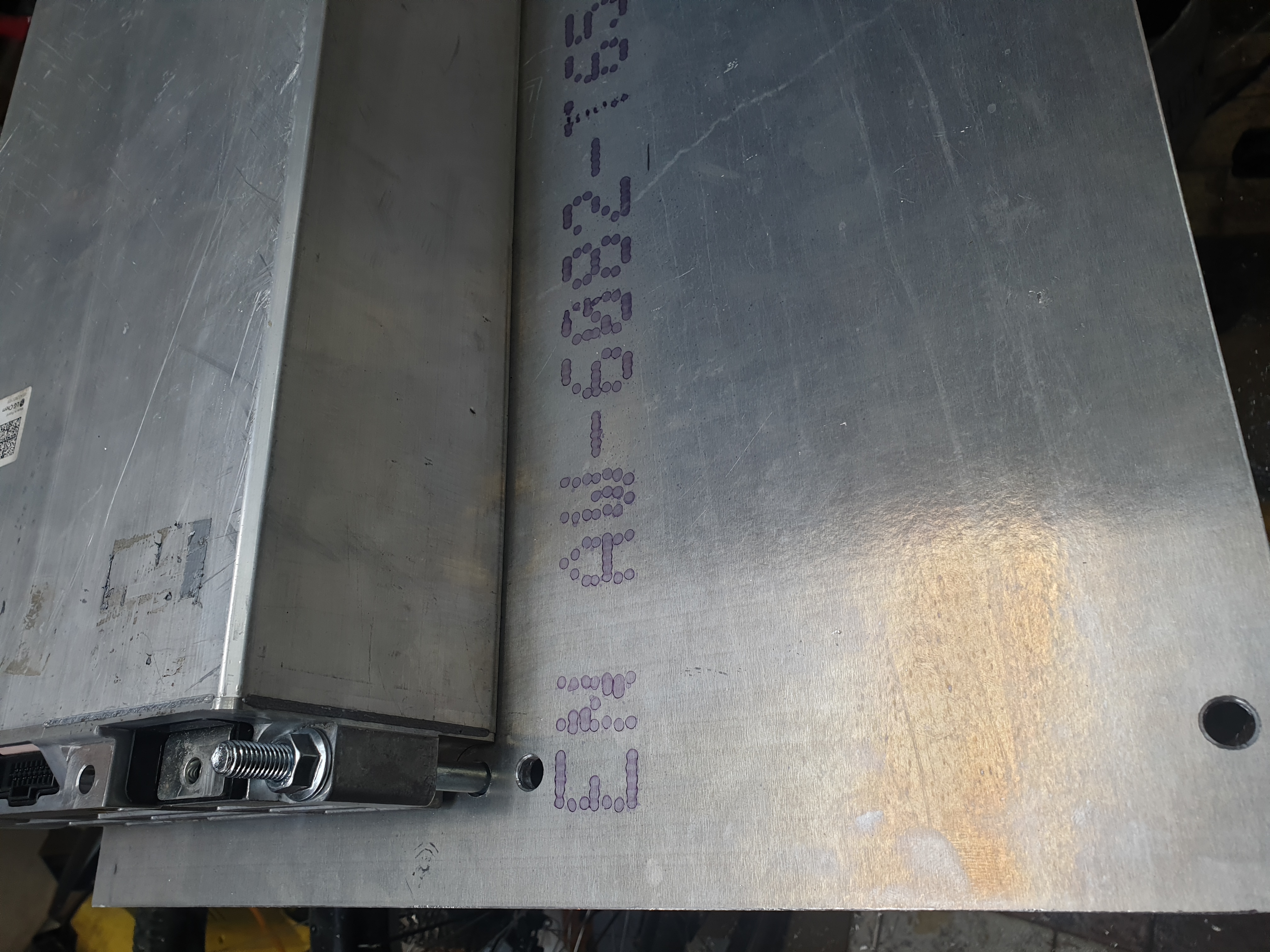

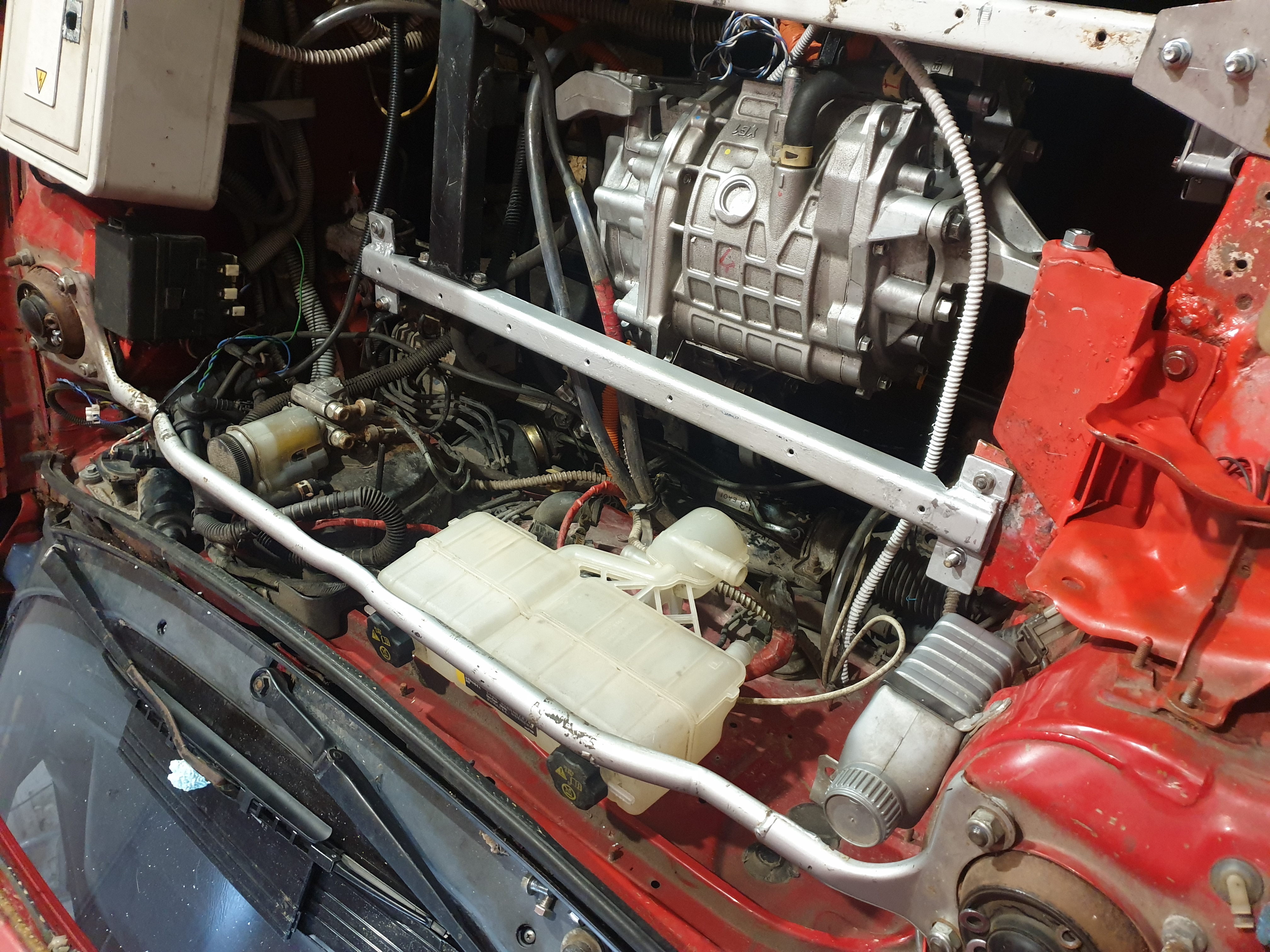

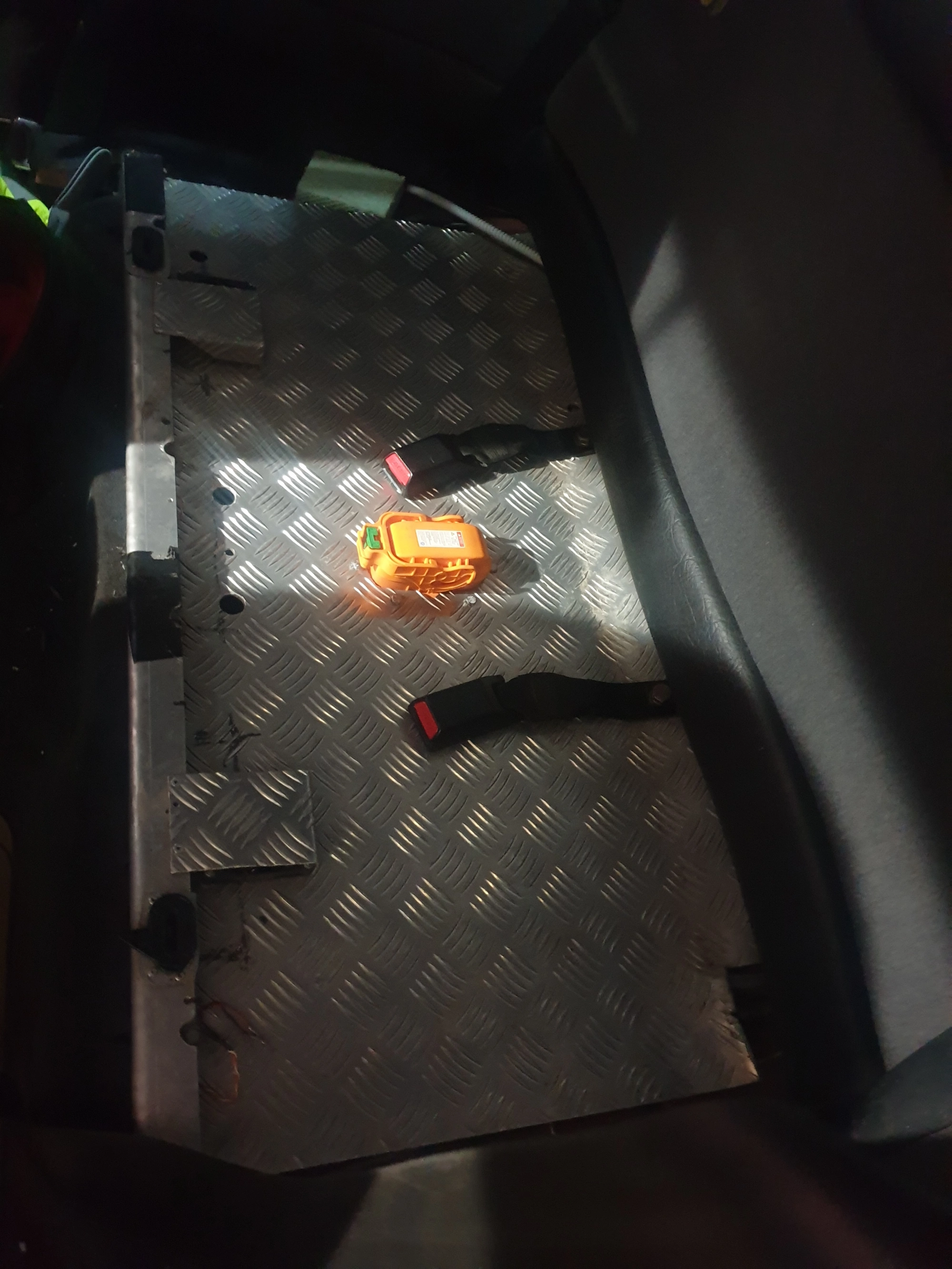

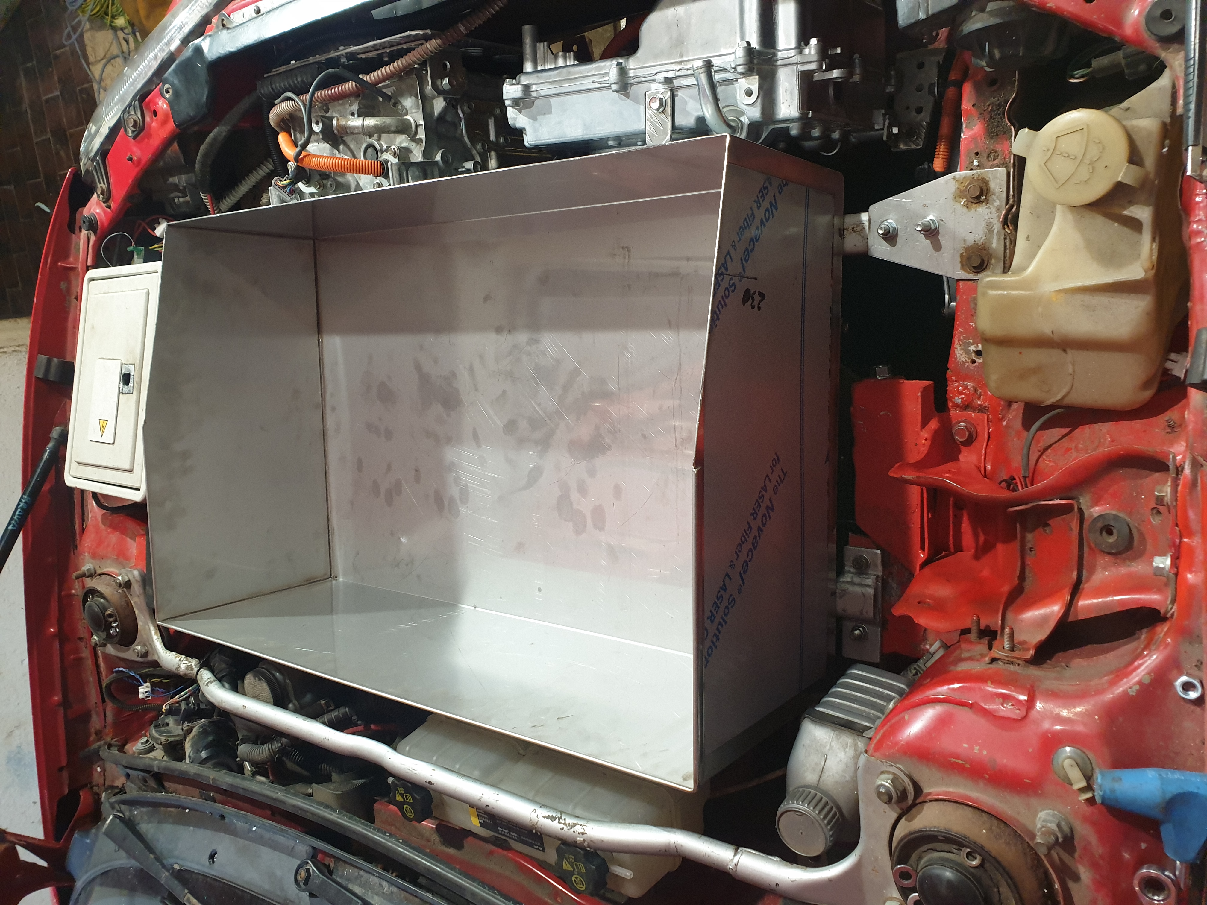

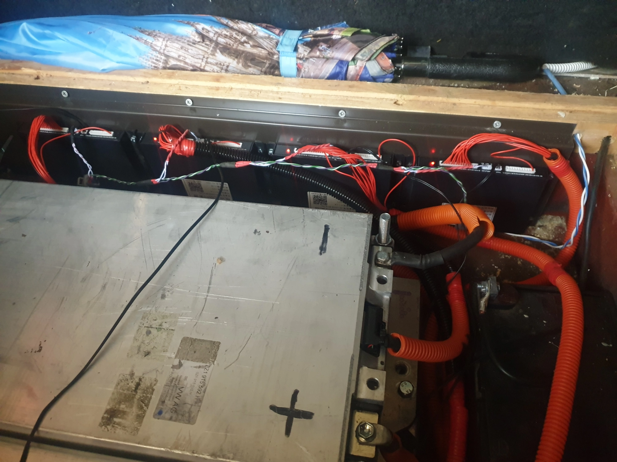

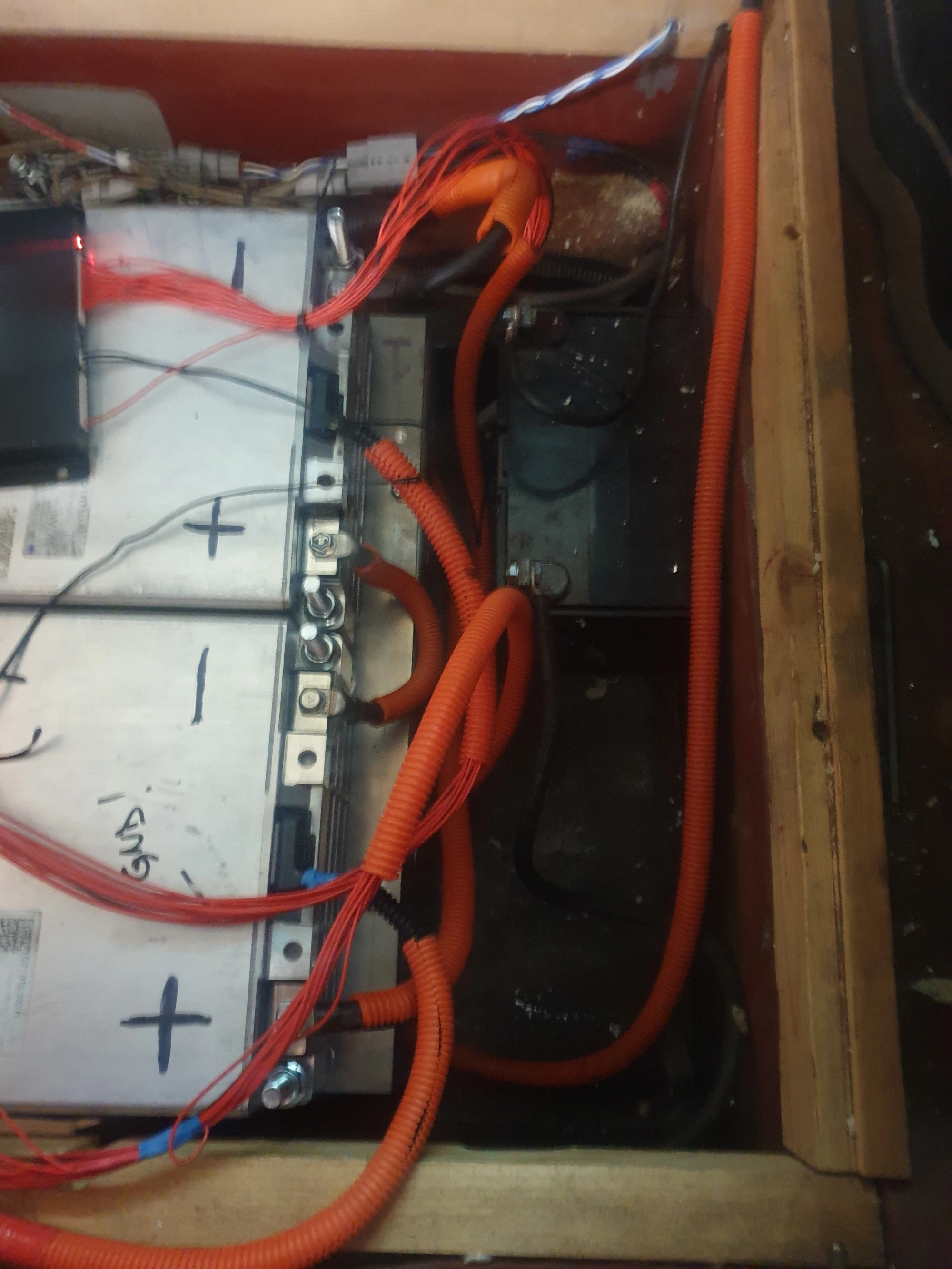

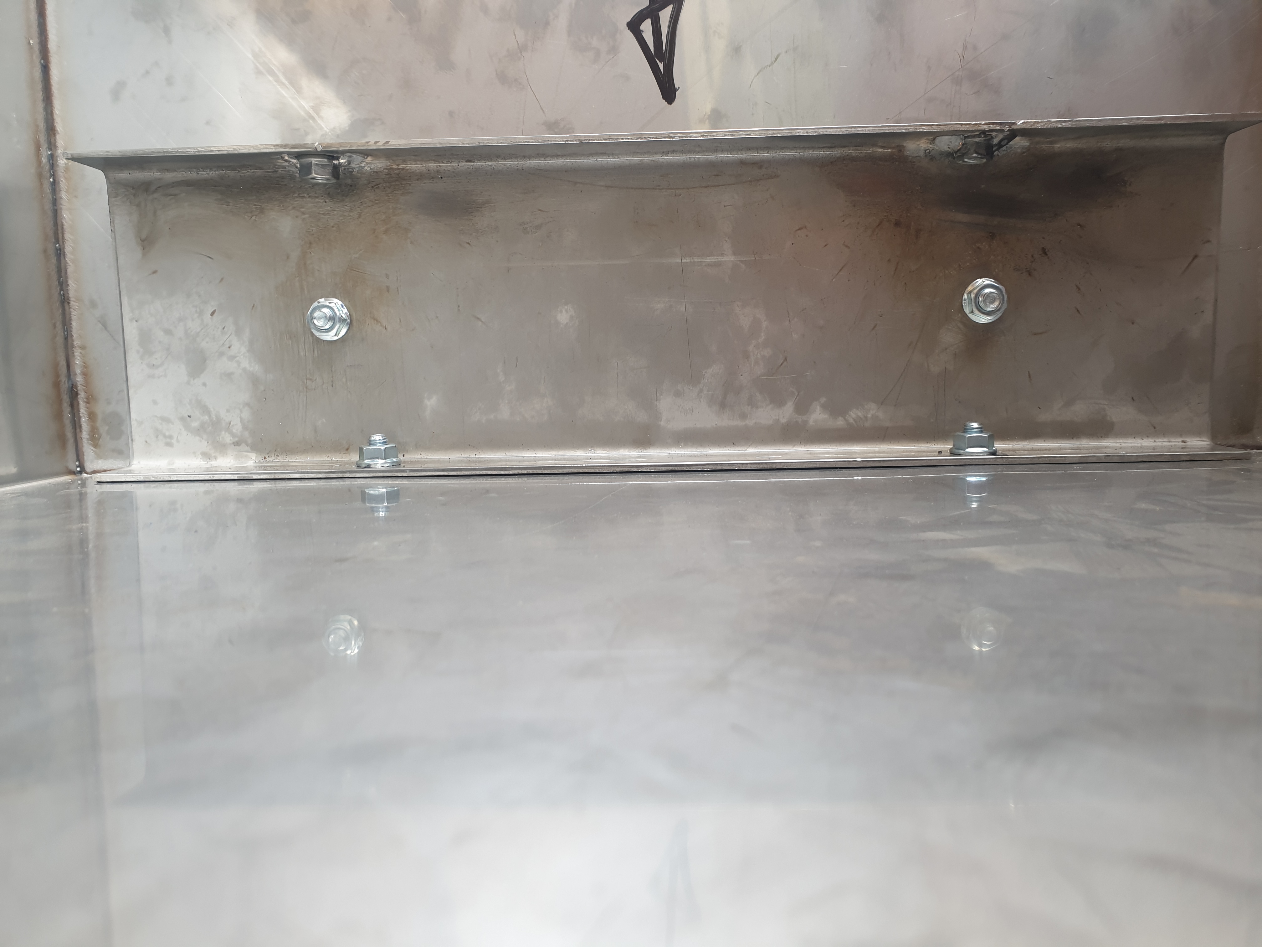

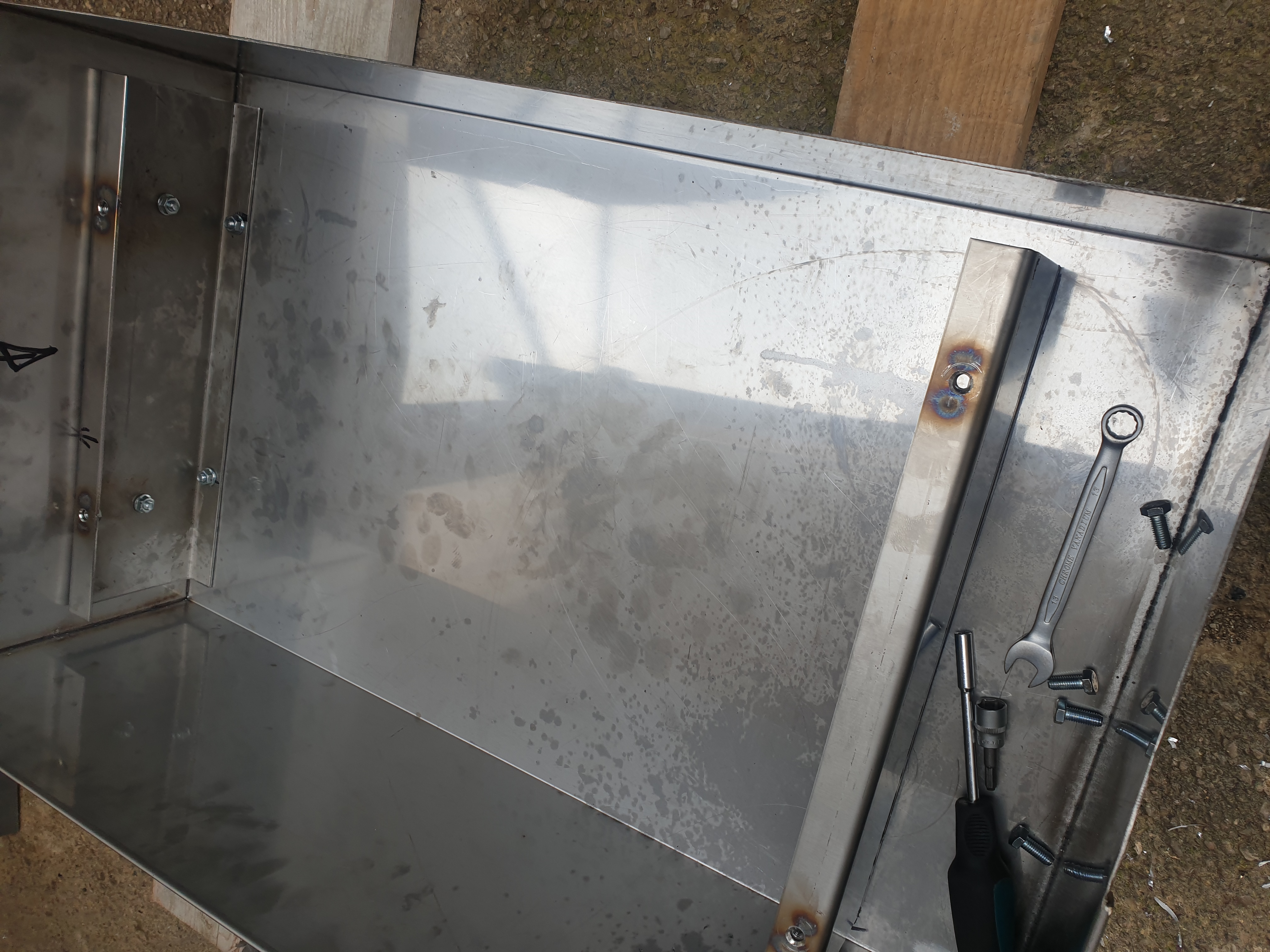

There is a lot of small tasks like make a third mount for coolant headers, cable clamps etc... and i didnt have time to photograph everything.

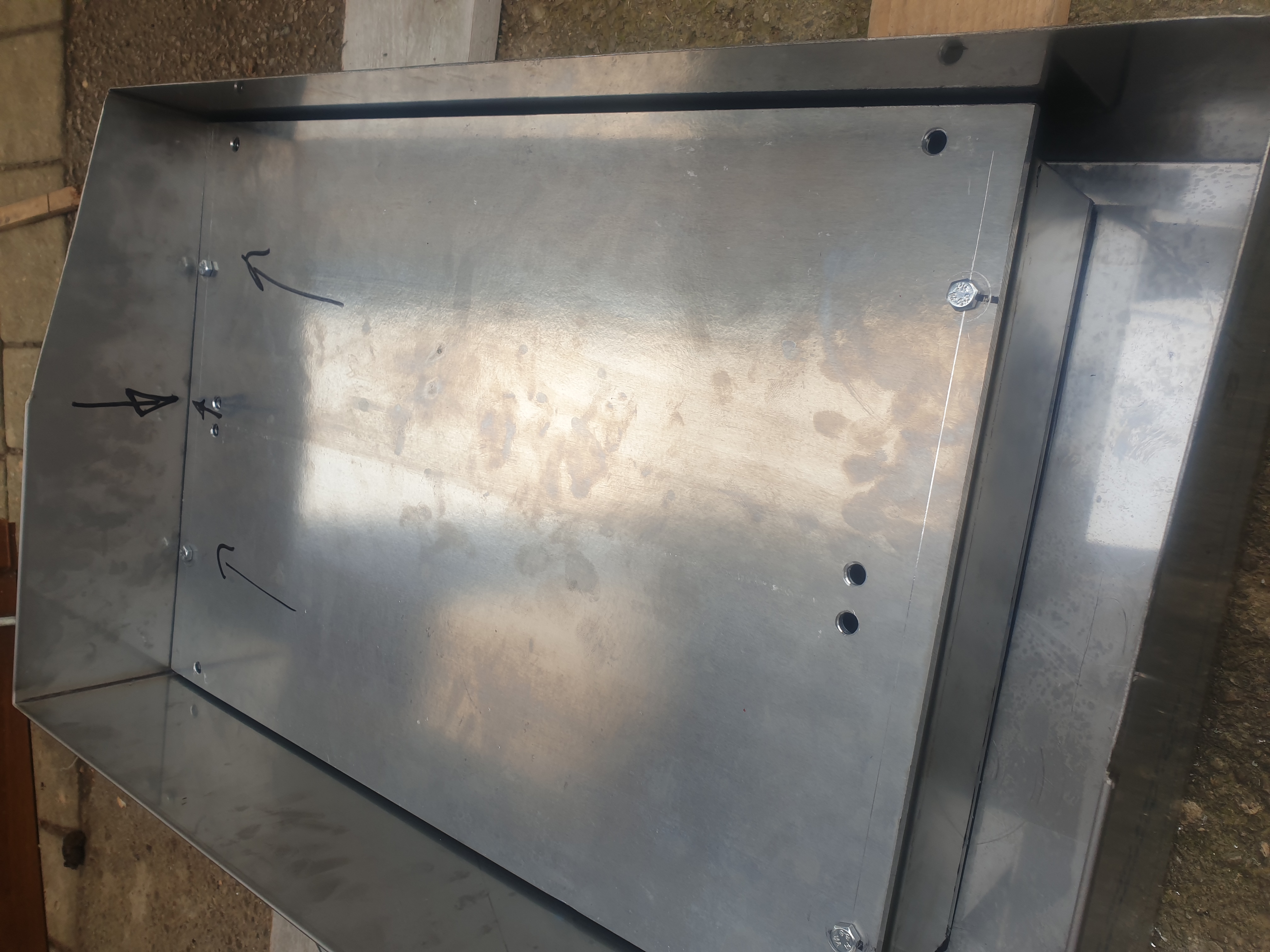

What i did is take photos of battery mounts within front battery box. I had two inox C profiles made and i drilled holes for M8 bolts to mount those profiles inside the box. Later i drilled two moere holes on each side so i can mount the alu plate with battery modules attached. Since i will fit bolts in vertically i needed to weld M8 nuts from the underside of the C profiles. Later i might have to drill large holes in the profile vertical wall to be able to fit cables or sensors... That way i will have nut held from the underside and all that will be required would be to torque the M8 bolt.
The arrows drawn on the plate let me assemble the shelf easily as i allways know the direction.

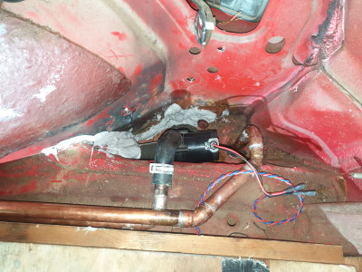

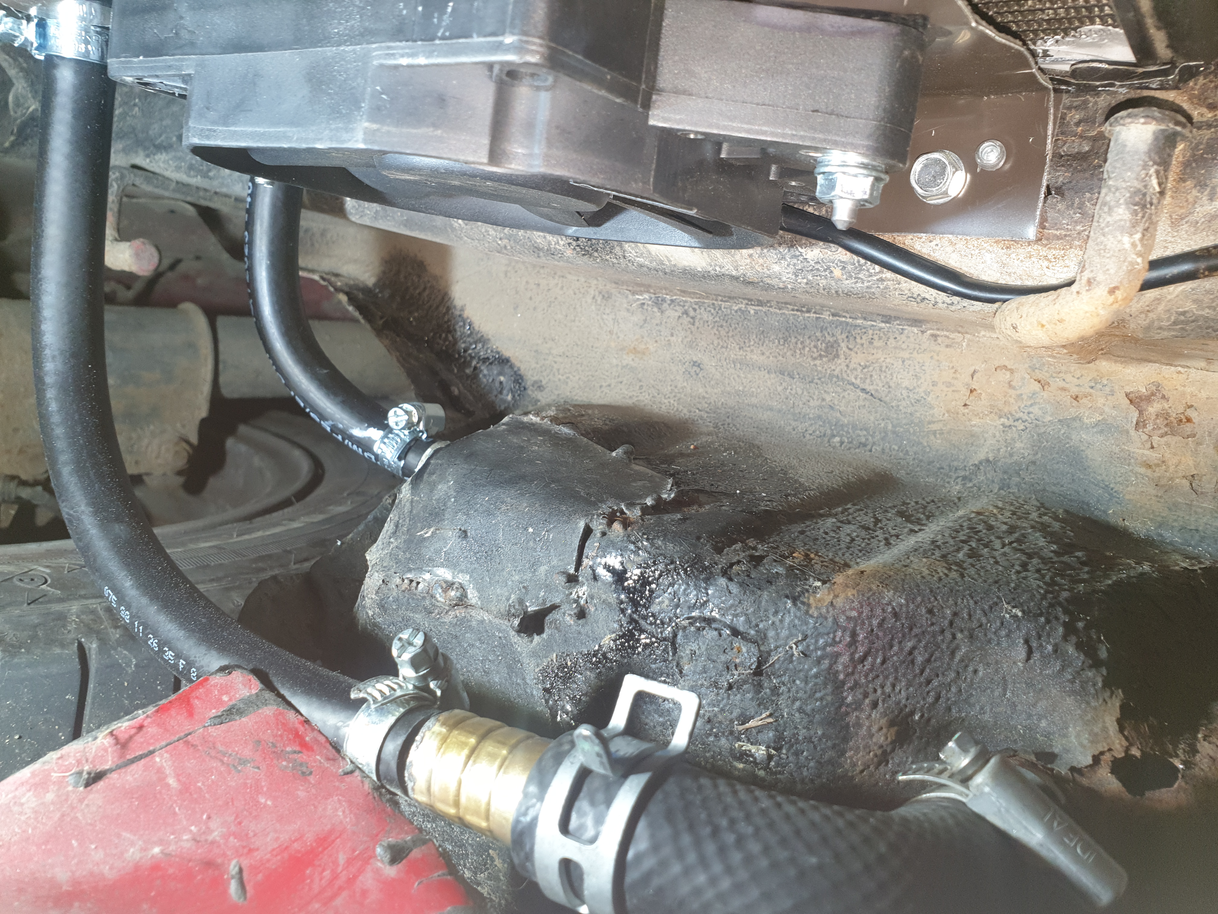

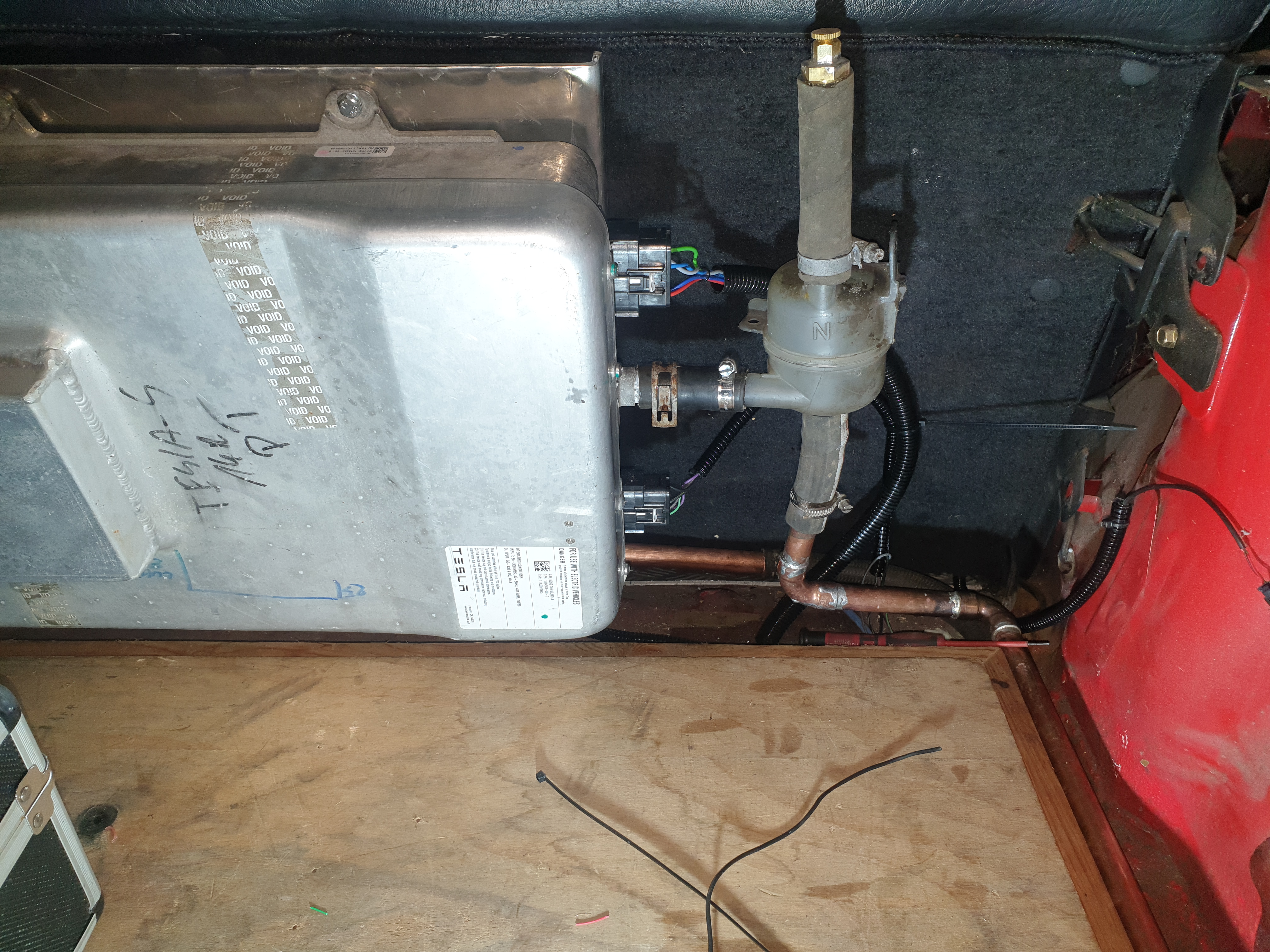

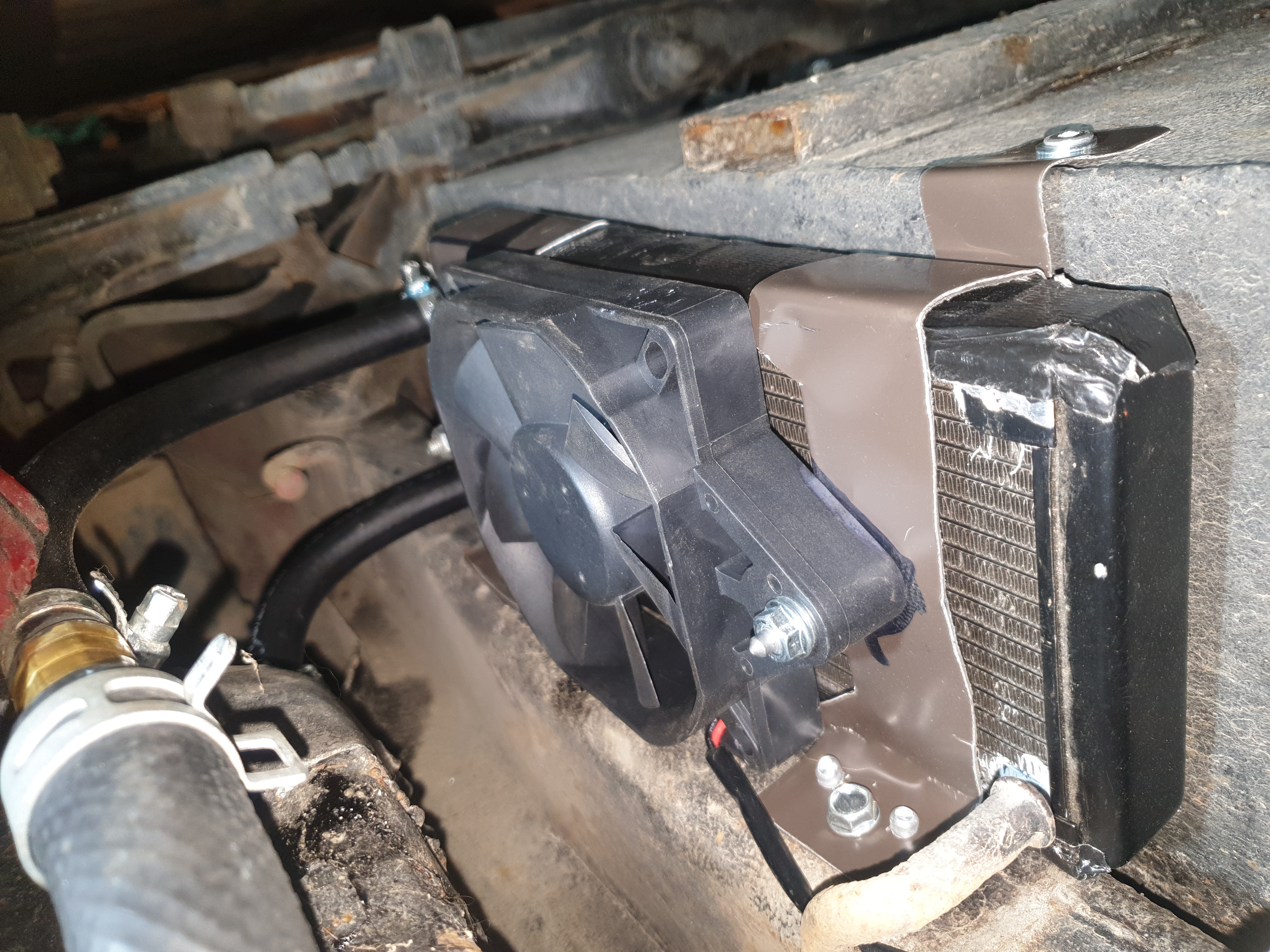

I managed to install coolant and heater piping. The idea is to feed both systems from the same header tank. I used a lot of copper piping as i can solder it easily at home. Just need some plummers paste, thick solder and copper piping.
I also salvaged a compact chiller from old Fiat 500 car and fitted 80W cooling fan by its plastic wraps. I still cant belive those plastic things fit into the chiller so efficiently.
This way i will have more compact (less hoses) system in the front of the vehicle.
I am still thinking of fitting the Tesla Gen2 charger to this car for 3phase charging, but it would significantly lengthen the build. I need this project soon so i will settle for 2phase 6kW charging power. Later on i could add fast charging...

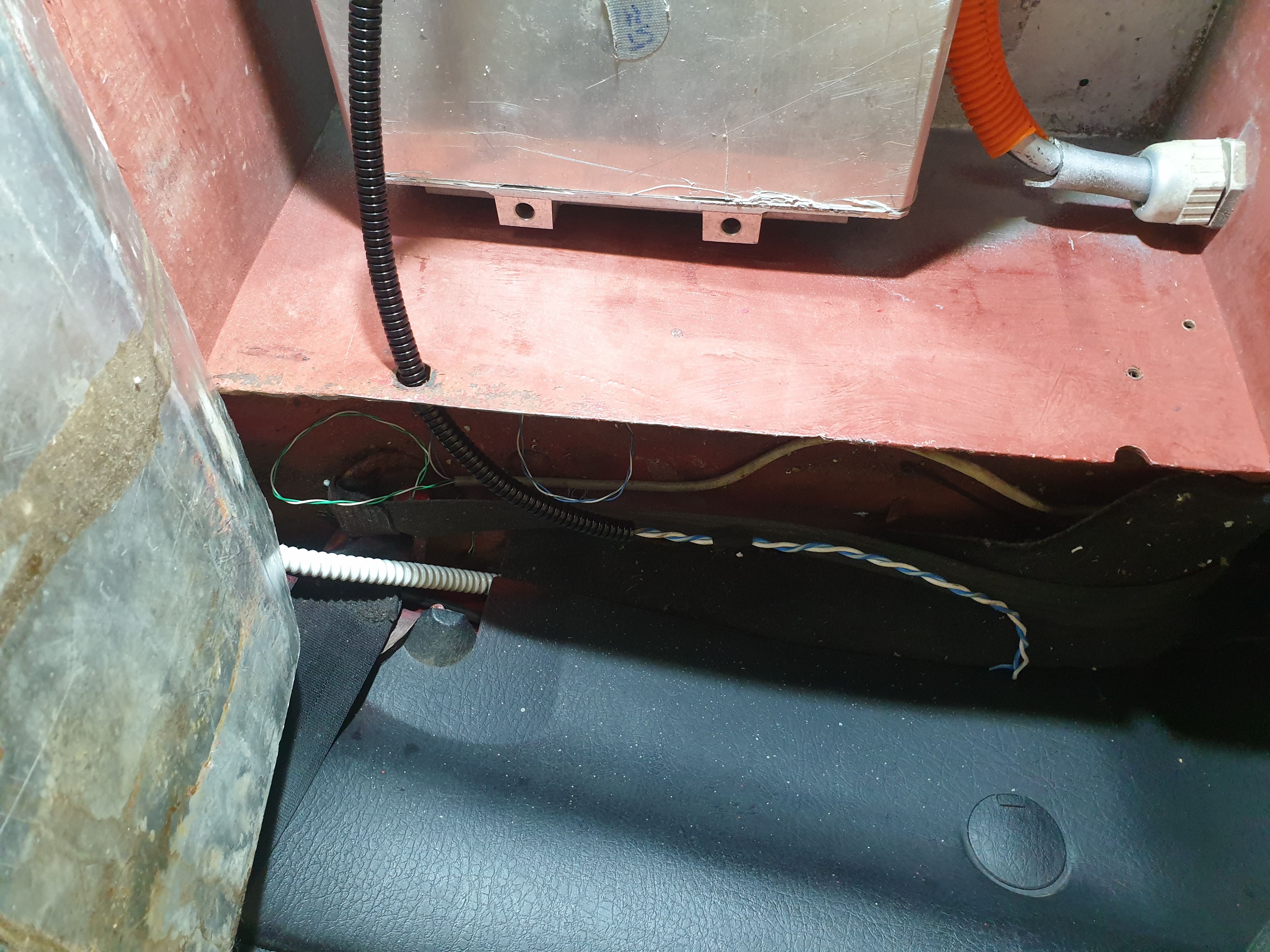

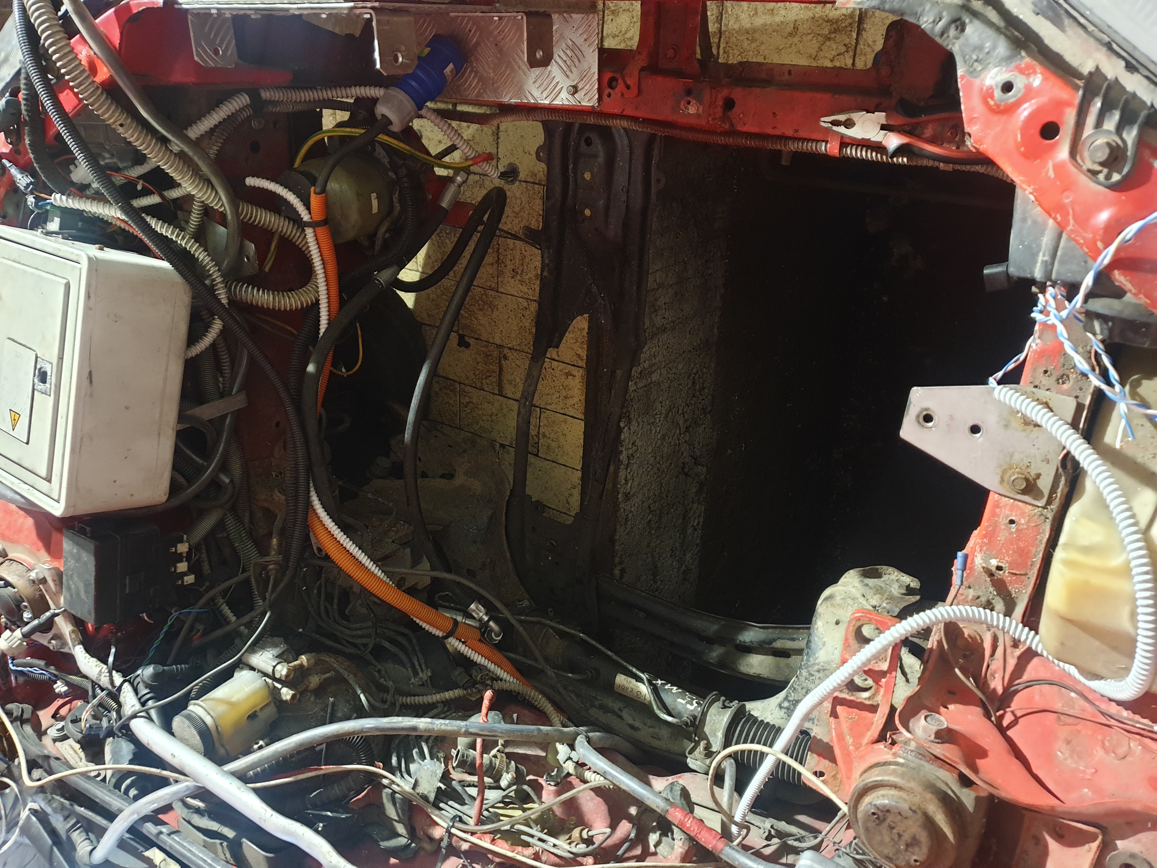

The other thing is the wiring of systems in front. I made a single CAN line for VCU – CHARGER – INVERTER – HEATER – and leave the last connector for CAN bus termination or to add one Volvo Eltek charger in the end. Of course there will be 12V lines and relays for Enable or charging signaling etc..
The idea is nice and compact wiring up front, something that is now called Full Mux where you only have power supply and digital signals to drive your devices. https://mazdamx3ev.wordpress.com/2023/1 ... omponents/
Next i need to test my CAN lines for messages from VCU and devices.

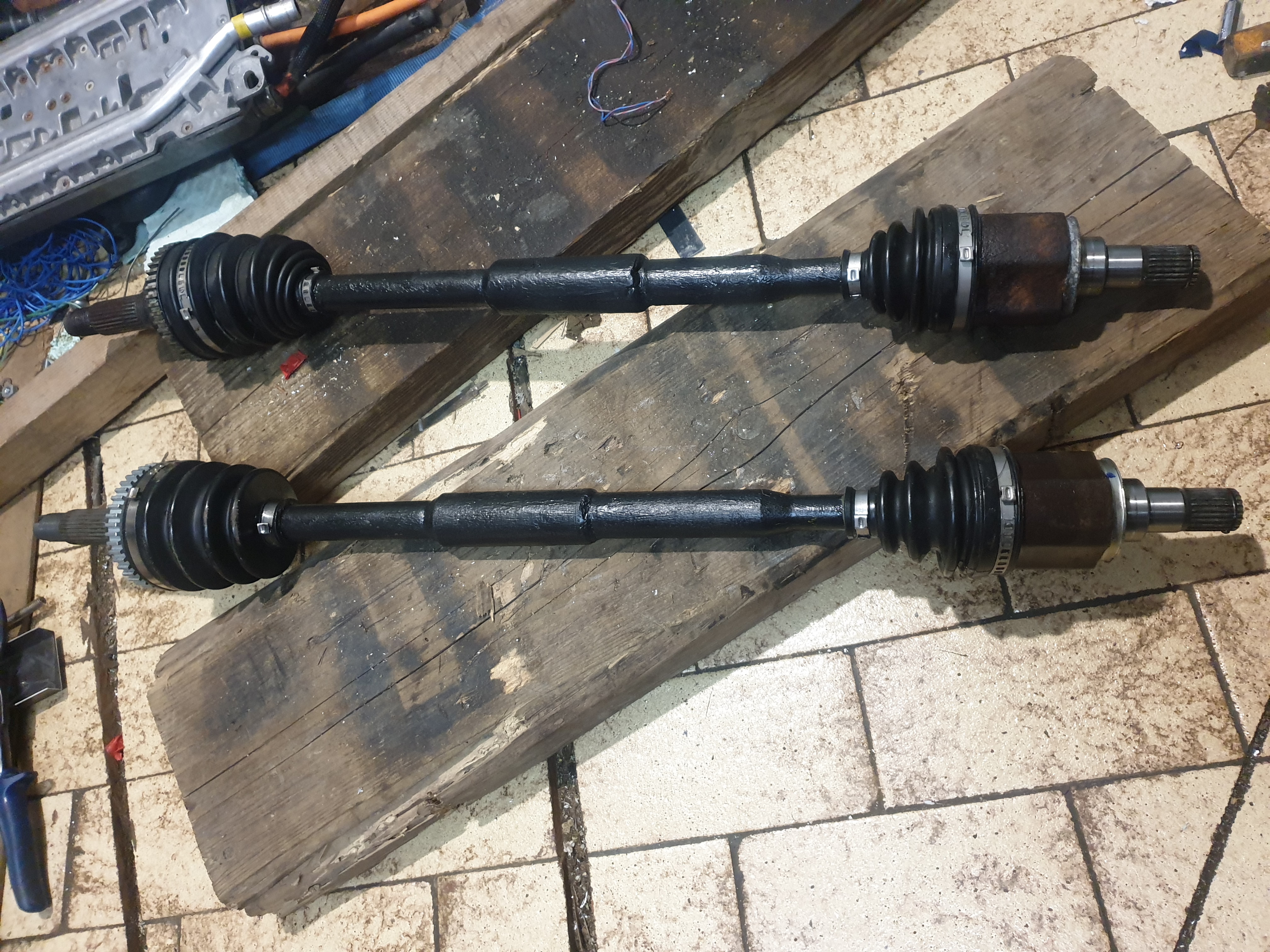

Almost forgot... i cut and welded Mazda and Outlander shafts.
Writeup is here:
https://mazdamx3ev.wordpress.com/2023/1 ... iveshafts/
I will add some photos still...

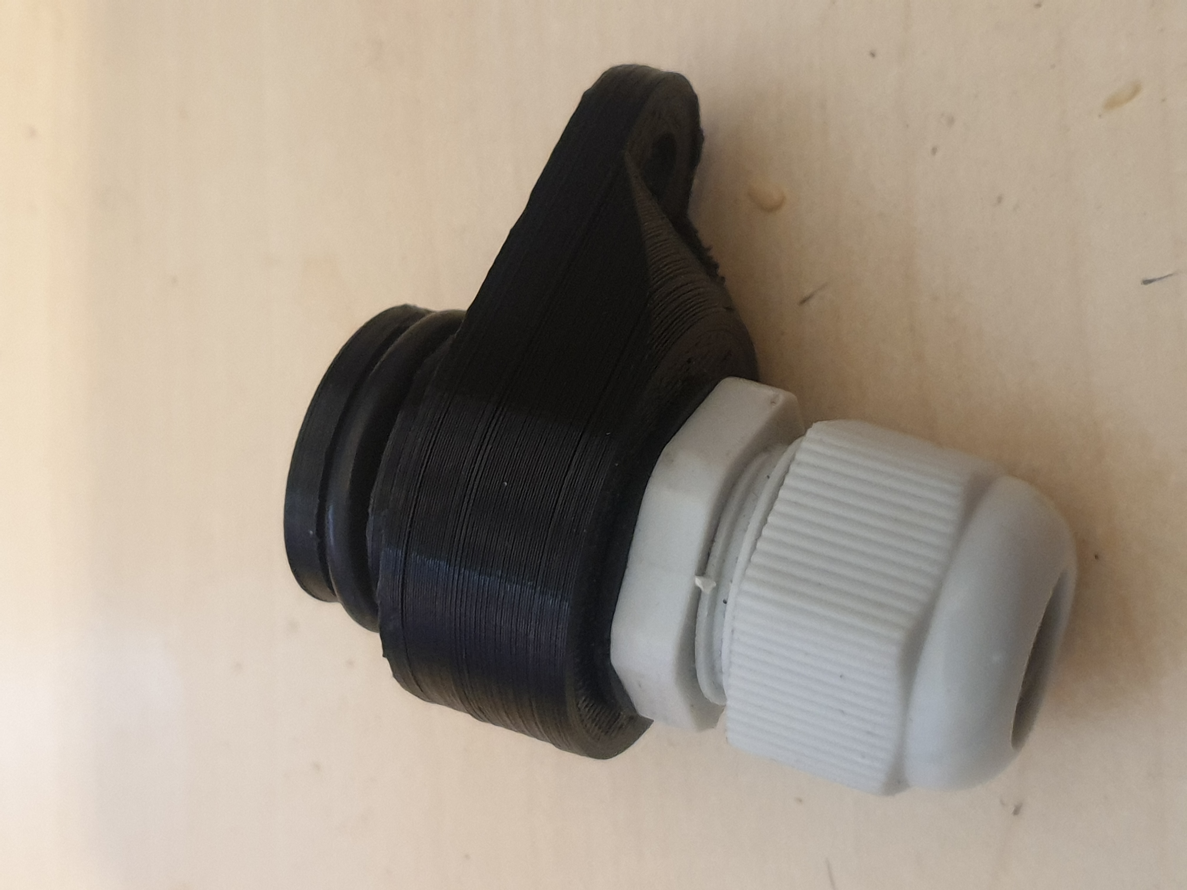

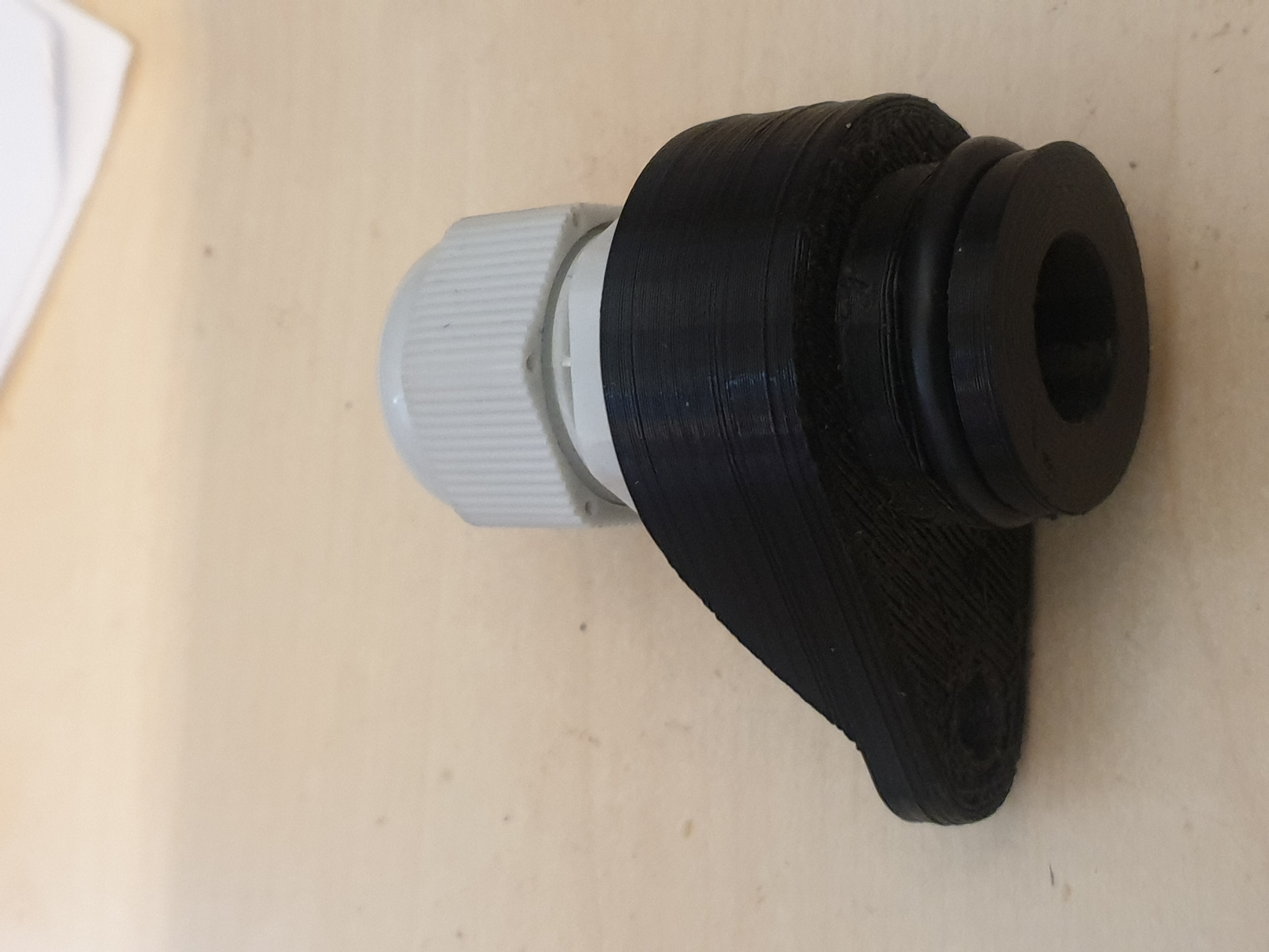

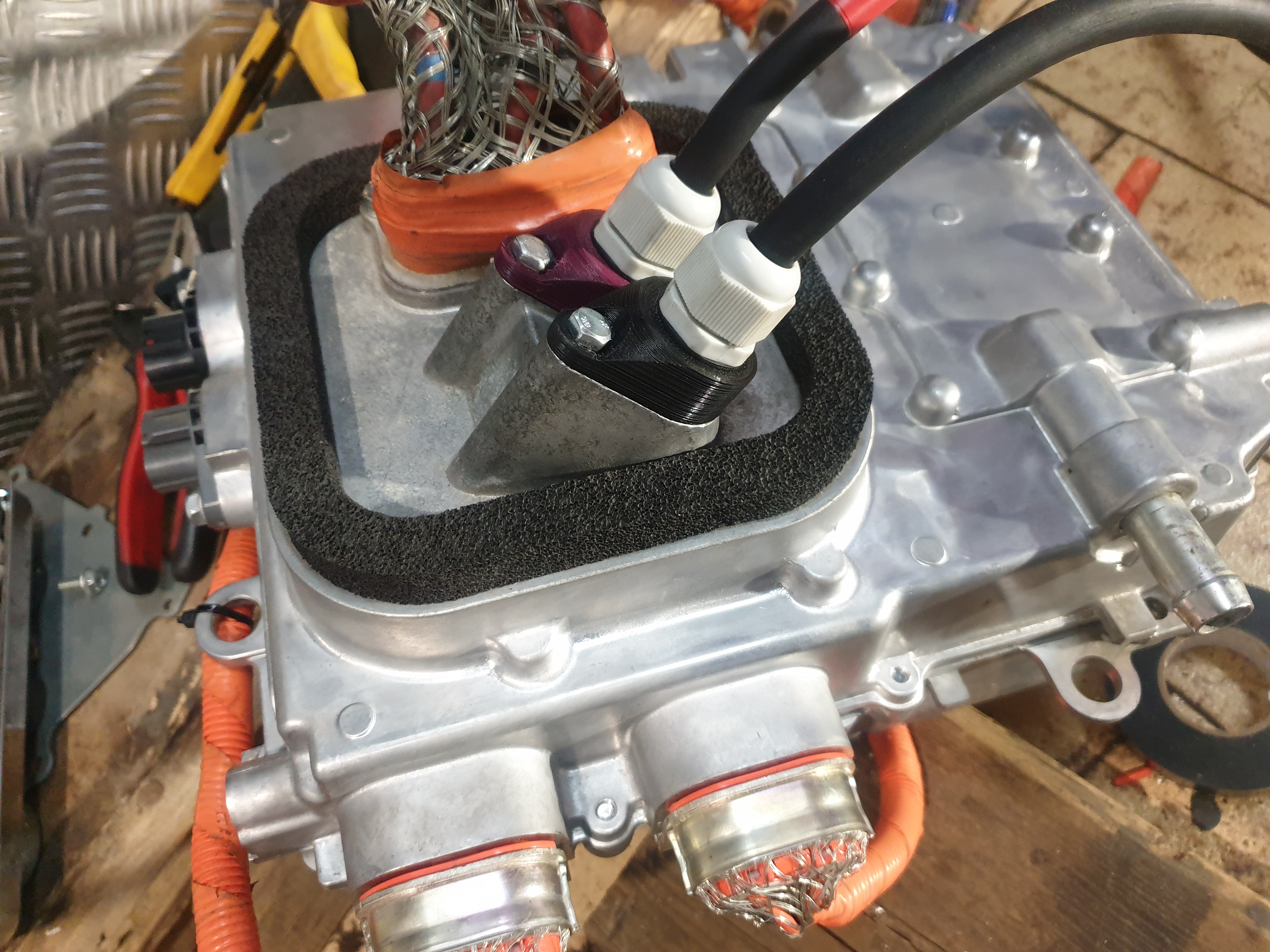

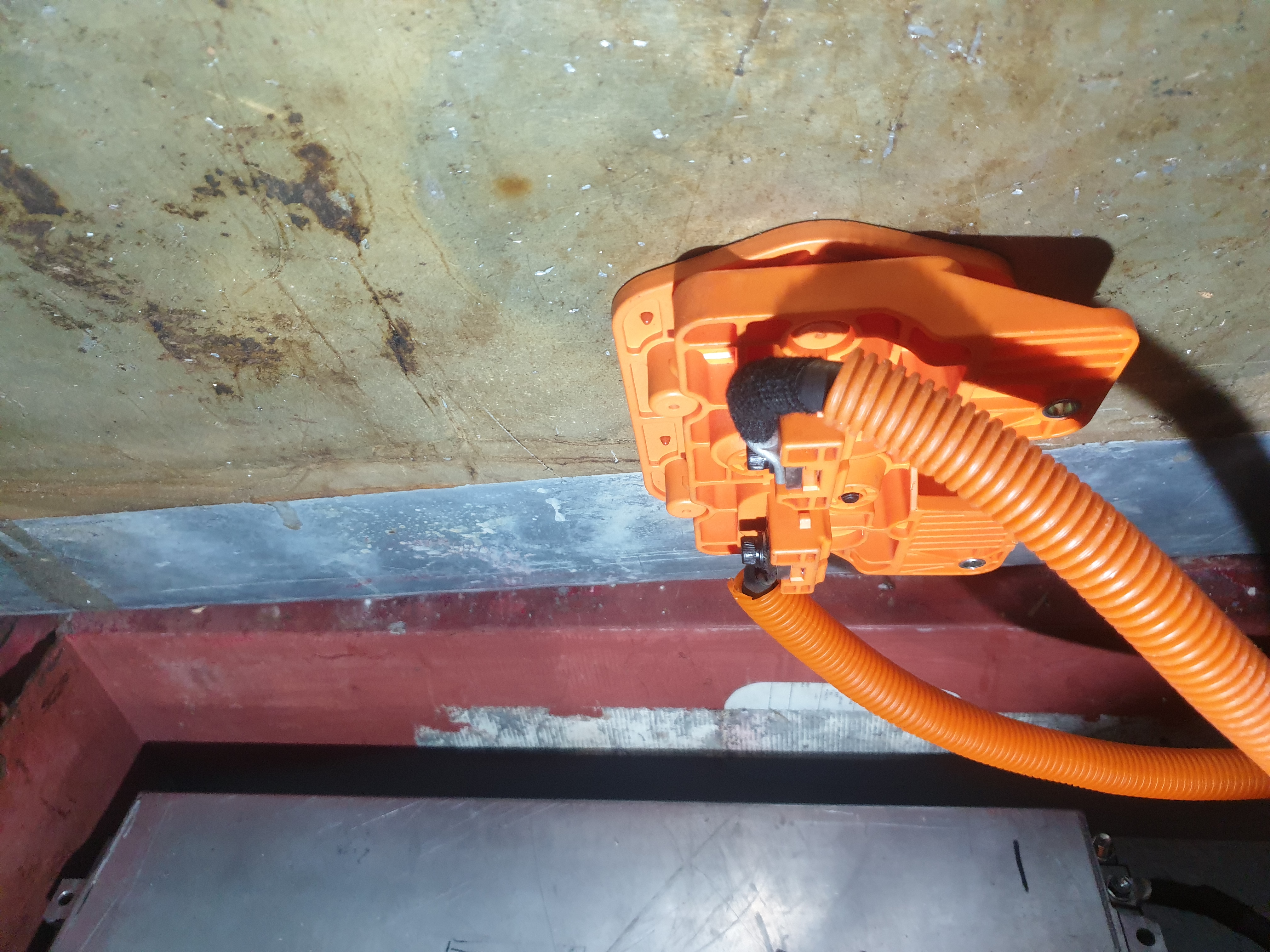

To connect DC to inverter i used 3d printer and made several DC glands designed by crasbe so thank you
I set this up to fill 75% in PETG. I printed one black gland and one violet - its what i had in PETG - to differentiate DC+ and DC-.
I got a couple O rings 18mm by 3mm thickness to seal the opening. It is quite a tight squeeze because O rings are medium hardness and i cant get any softer version. I connected 35mm2 cables in those glands. I connected motor cables, yes i luckily got good motor cables with sealed covers.
On the bottom there are two secondary DC connectors that lead to the heater and charger. I like MC4 connectors so i made those connections removable and connected shield to the casing. Every part will be connected to another by grounding 6mm2 cables.

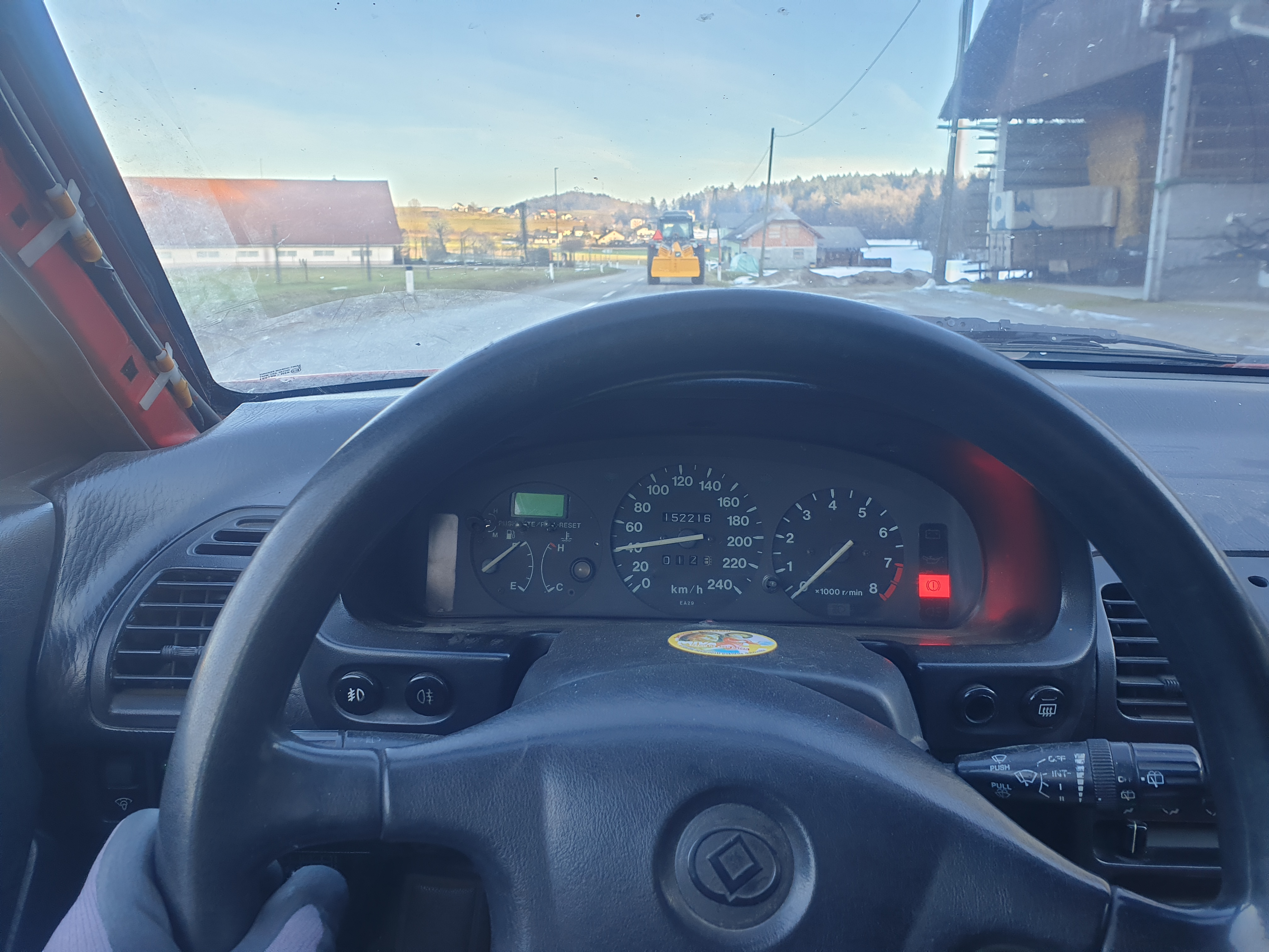

It is alive! I tell you ALIVE!
I managed to drive it up to 100km/h around town. I find acceleration a bit lame up to 20km/h, but then the beast comes out
I need to develop regen effect, but everything else works well. I still have to top up the brake fluid due to messing with clutch lines...

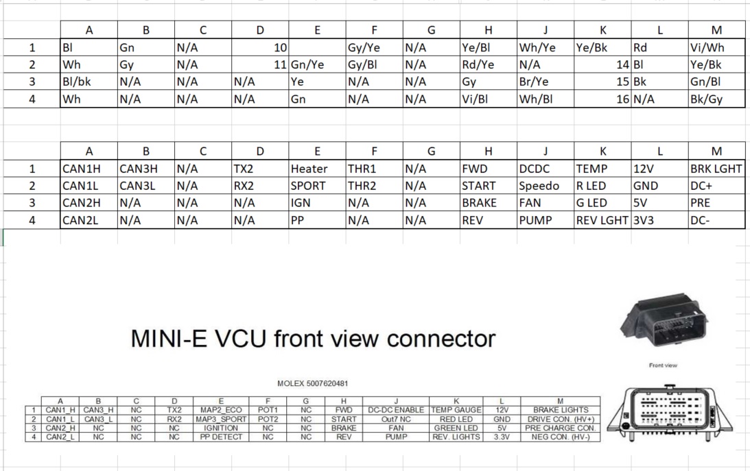

arber333, have you documented your wiring diagrams anywhere? I am currently trying to figure out how to wire up my outlander rear drive unit on the bench and would love to plagiarise it
- Posts: 3795
- Has thanked: 166 times
- Been thanked: 411 times
Re: Mazda MX-3 electric

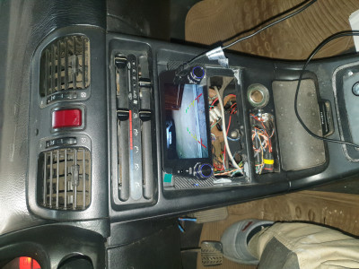

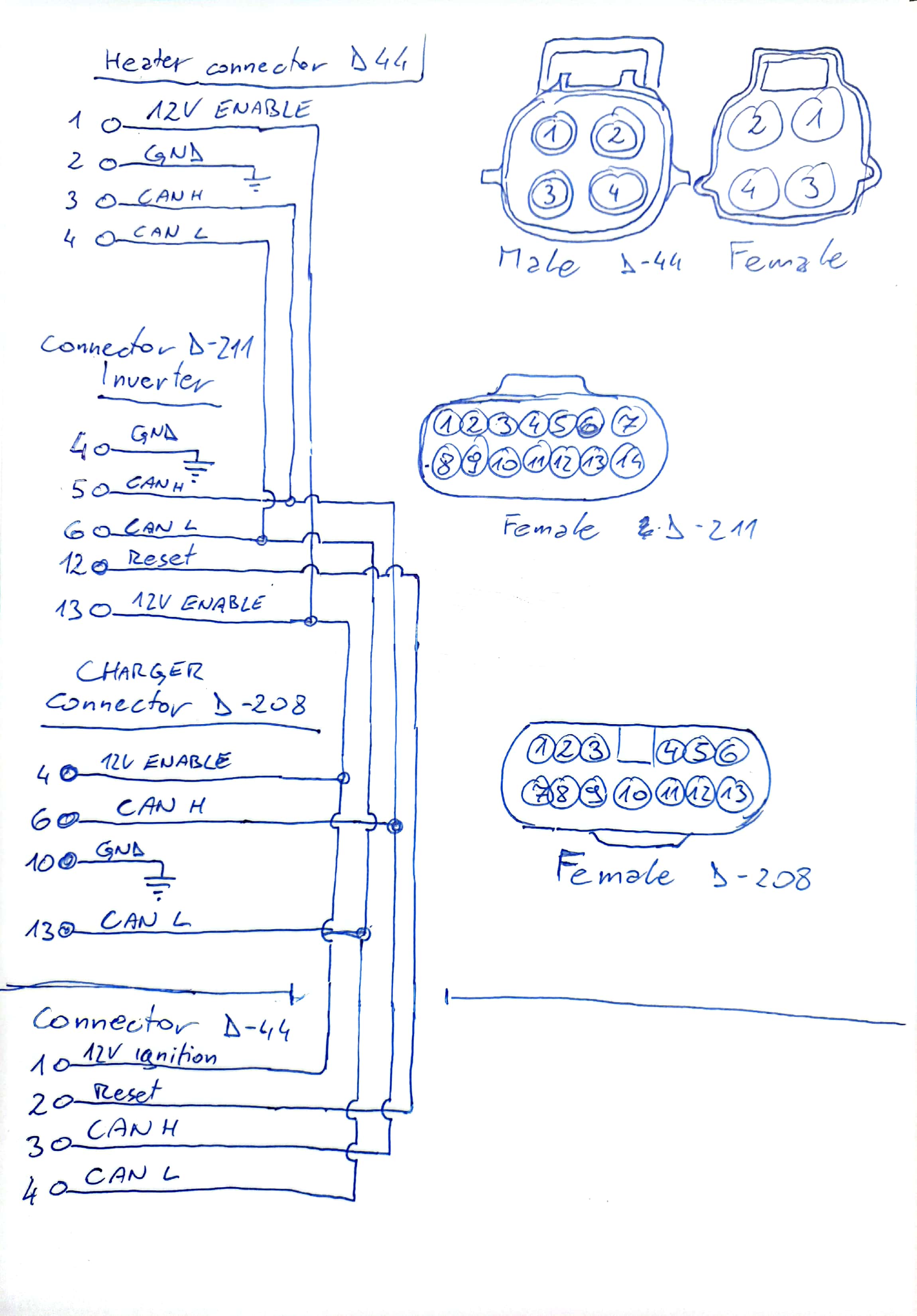

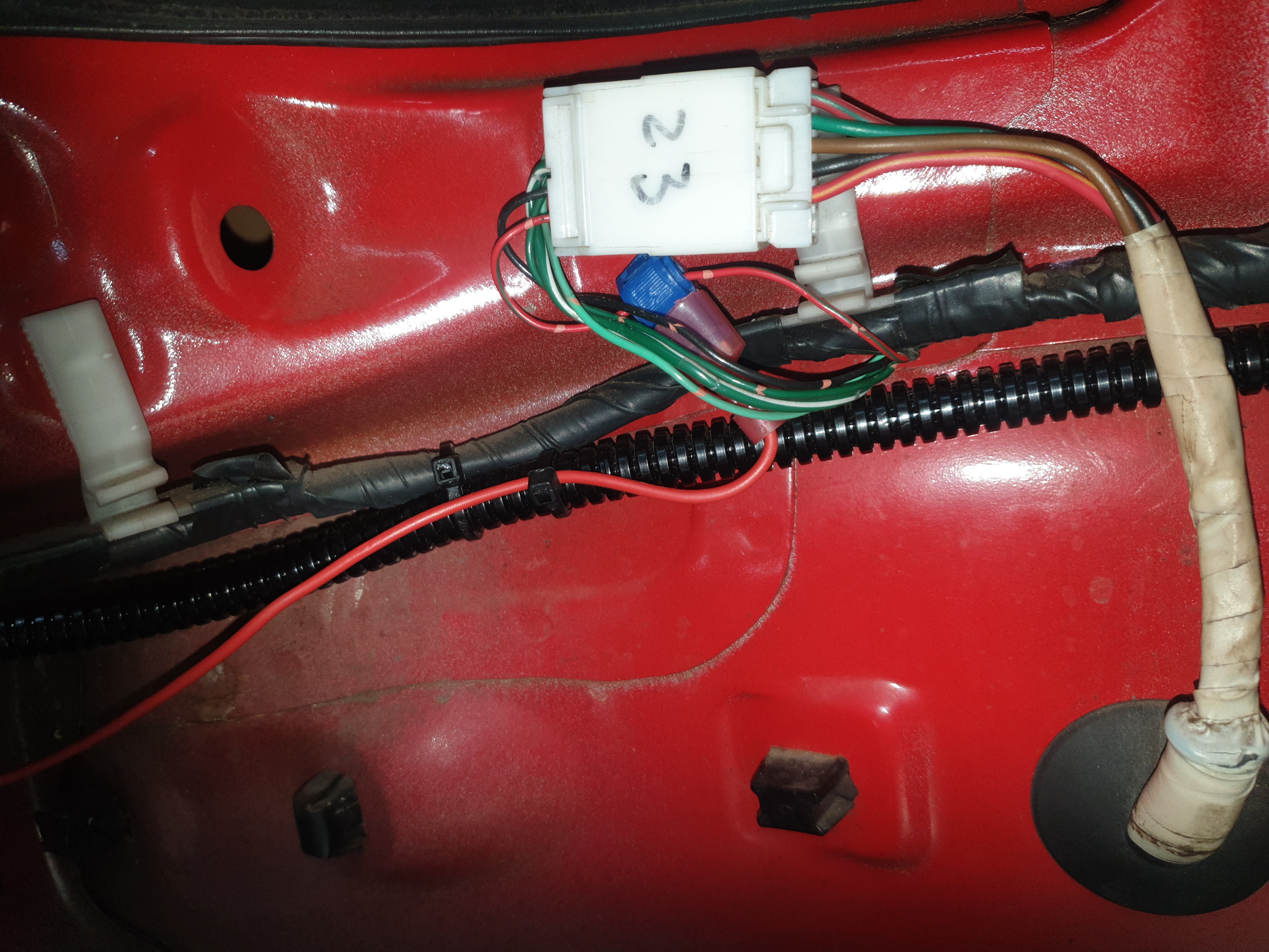

Sure... lets see... i am still writing detail posting about my contact box... any day nowScrappyjoe wrote: ↑Mon Feb 05, 2024 11:13 am arber333, have you documented your wiring diagrams anywhere? I am currently trying to figure out how to wire up my outlander rear drive unit on the bench and would love to plagiarise it![]()
See here my connector schematic if it will help in the meantime. I made a quick schematic of my connections to reflect on...
In the meantime i had to chamge some connections because of the startup logic. I had to start inverter and charger logic BEFORE precharge is complete, but DCDC pin 4 (12V signal) i turn on only after everything is ON. I am missing sense pin 7 (permanent 12V) and charger pin 8 (ignition).
I wired heater start pin so it comes on only when ignition is on, as i also need to power the internal fan. I will capture those in my summary.

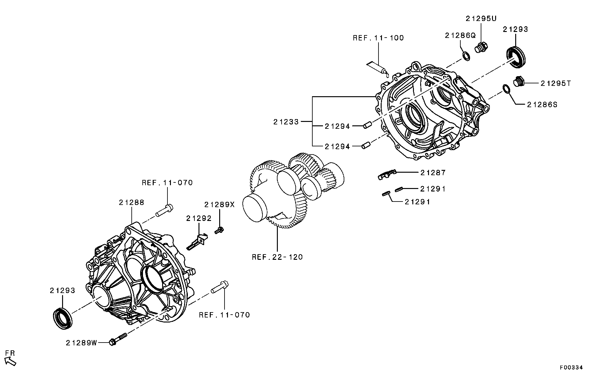

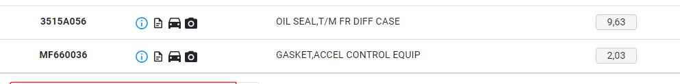

5. I seem to leak gearbox oil from LH driveshaft socket, but that seems to be my bad, probably i damaged the seal on that side, have to investigate...

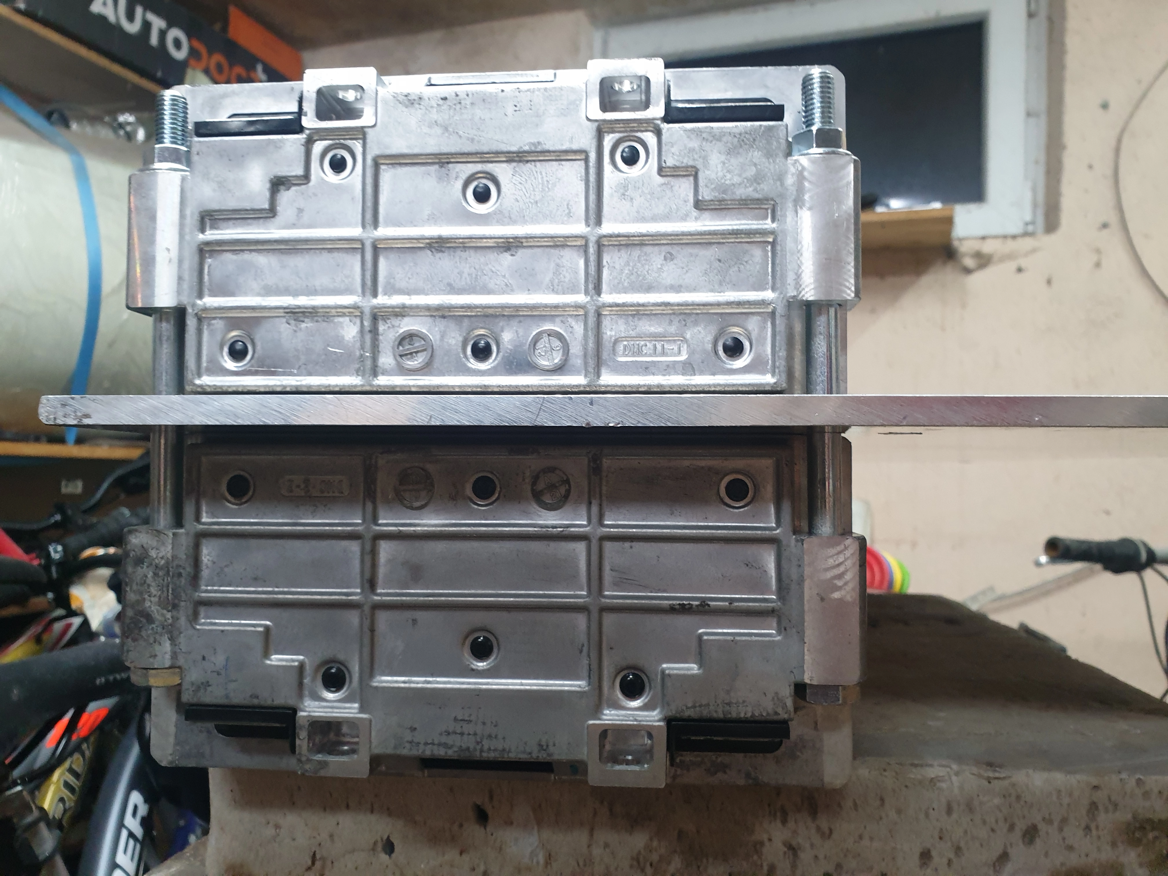

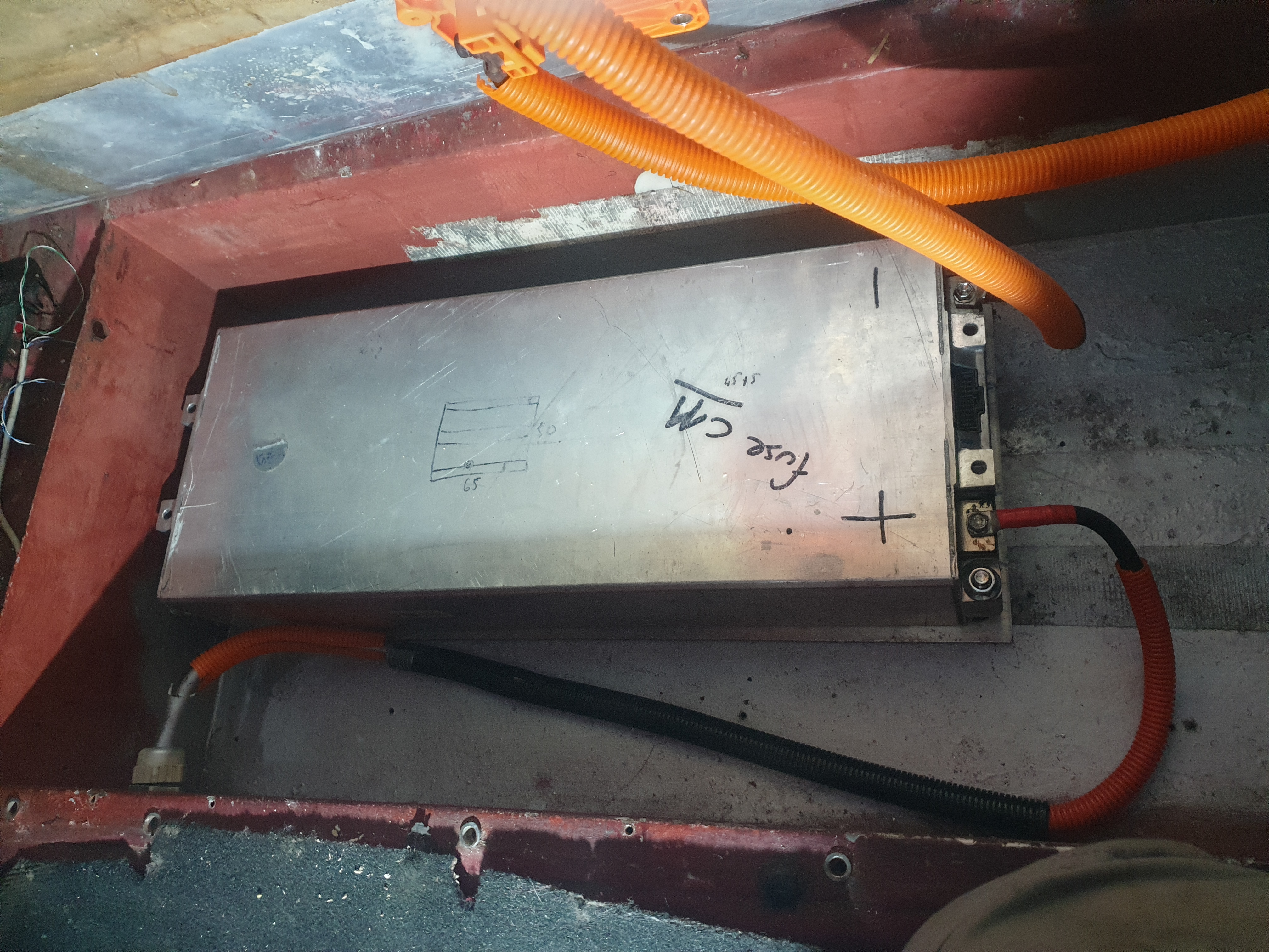

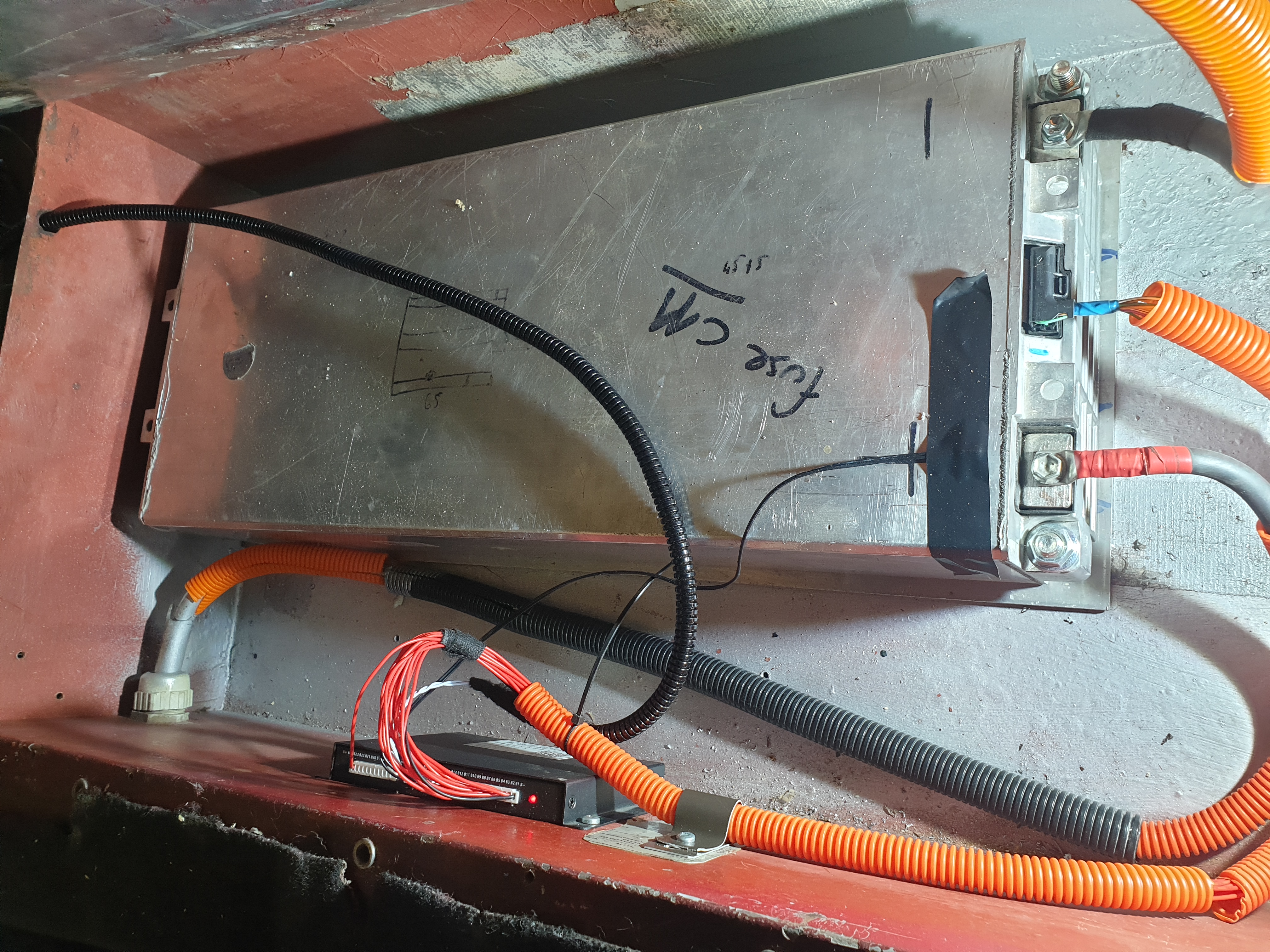

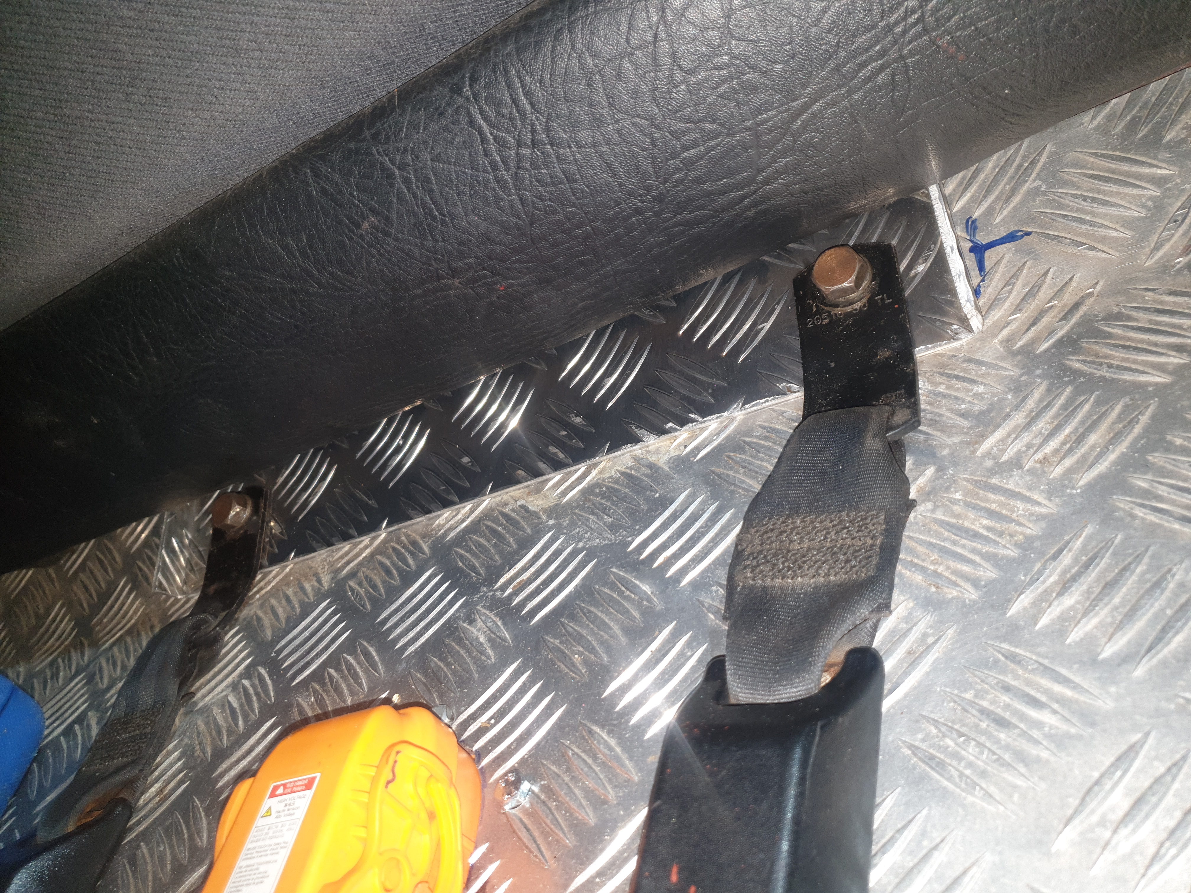

Rear box will remains much the same.
My idea was to fit 4 battery modules in sandwich on 8mm thick Alu sheet. They will be supported by two C inox sections bolted into the box from underside.
Each lower module is bolted to upper module by M10 x 180 bolts. Those bolts incidentally join together complete assembly of Alu plate. Electrical connection is established via cables to and from the modules on the right side where i left space for Pb Aux battery and cable routing.
I made a simple alu sheet metal fixture for individual BMS modules. This will fix modules in place and provide connections to CAN lines. Modules are set by numbers from the most negative terminal towards positive terminal. So Module no. 1 is one which connect to the negative line cable. Module no. 7 is the last one with terminal at the positive most cable.
CAN twisted pair runs from the rear box towards front box and connects all modules onto 250kbaud network,

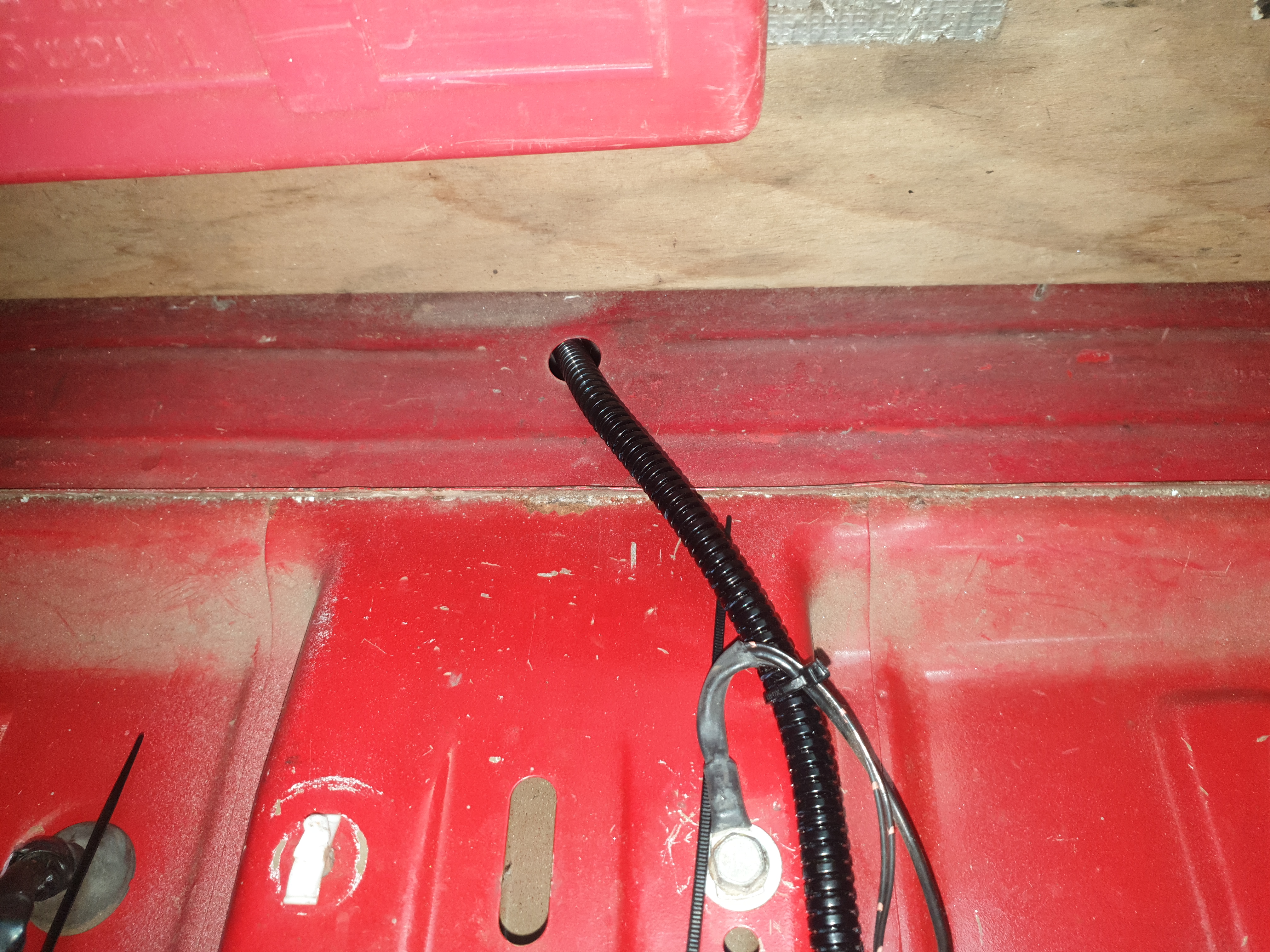

Furthermost + cable exit from the box and under the rear seats into the box that is under the seats. I cut a hole into the alu cover which will house battery service disconnect. If i would need to service the HV system i simply remove the top part of disconnect and i can safely work on the HV system.

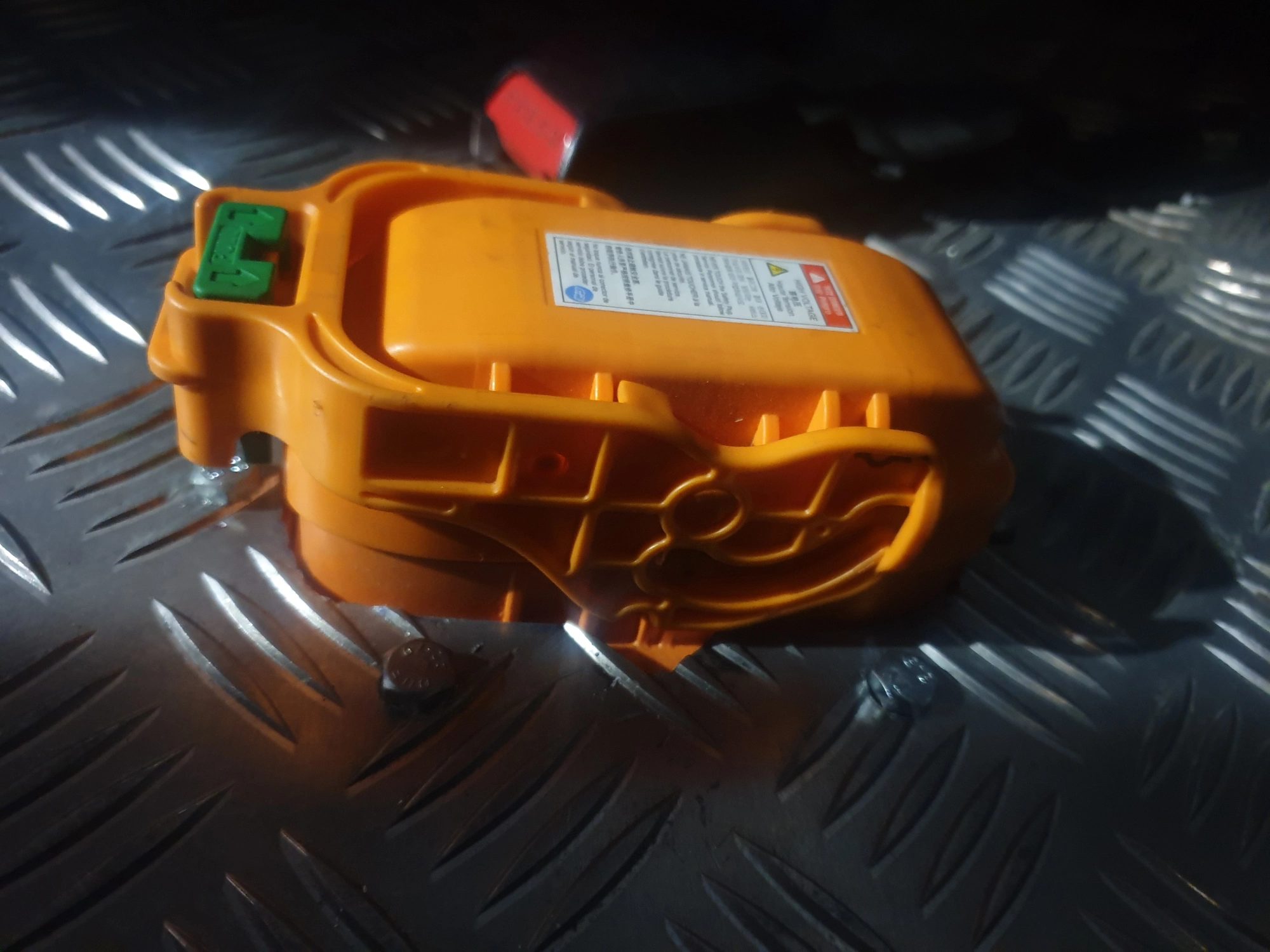

I decide to connect additional 12S module, 8 in total together.
This last module will live under the rear seats. I cut an underside plate from 5mm Alu which will help fix the module in place and dissipate the heat.
To fix it in place i used 100mm M10 bolts that i fit from the underside and carefully torqued not to damage the module.
BMS module is connected directly in 12S connection and i connect CAN wires to the main strain.

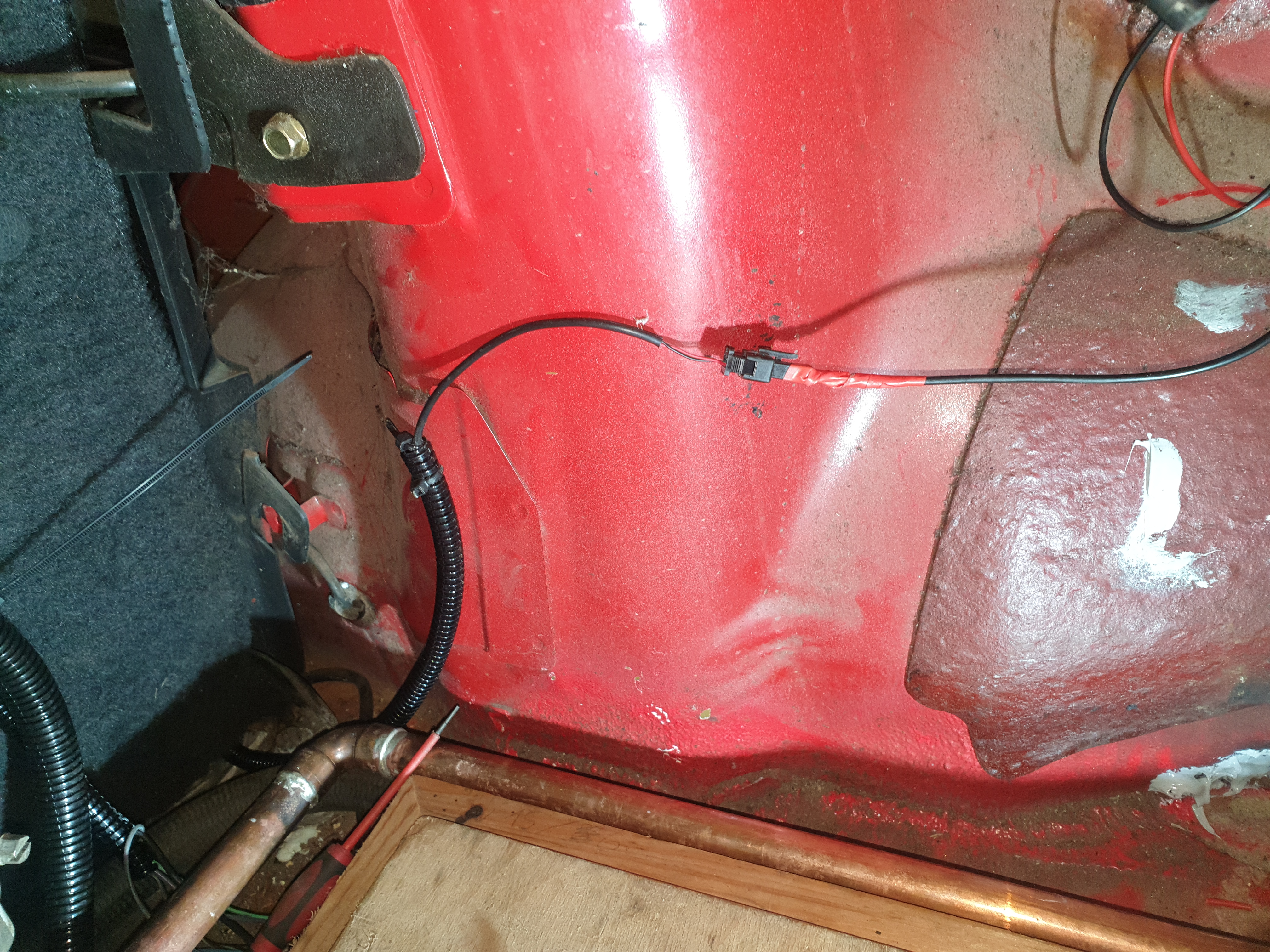

I am now trying to install 3phase Tesla Gen2 charger despite the fact that the last 12S battery module occupies its space under the rear seats now.
I asked my friend to cut and weld me a flat mount where Tesla charger will fit behind the rear seats in the trunk area.
I will use rear seat belt bolts to firmly fix the mount. When thinking on how to route cooling hoses i decided to use 18mm copper tubes. They can be soldered and i tried to form straight lines whenever possible. Small mixing bottle will serve to remove air from the system and i will release it from the top valve. Whenever tube was routed throught car casing - sheet metal i used small piece of coolant hose which i cut in the middle. This middle part would caught on the hole in the metal and form a sort of grommet. This is so that i dont get metal on metal contact...
Underneath the car i mounted a small radiator. I used reducers to bring 18mm tube to 10mm hose which will connect to the computer alu radiator. I hope radiator and one fan will be enough. Now i need to test the system by filling water and circulating the pump. I have that wired so when charger is active it will automaticaly power the pump and the fan.

My daughter asked me if i could mount a rear camera to Mazda. I thought what to use best and i decided to buy a radio with 3.2in LCD display.
That display has a connection to plug in vide input from camera. I bought a small 8 LED camera and mounted it above the licence plate. I routed the cable from the dash under the carpet to the rear. Then i connected the power to the rear light and used an old hole to the bumper side. Now when i switch to RWD i get a good shot of the rear on the radio!

I toraly forgot!
Back in June i noticed Outlander gearbox was leaking oil. I must have nicked the shaft oil seal when assembling the gearbox and driveshafts together.
Of course the seal can be removed simply on the car, but the problem was i didnt know what kind of seal i need.
So i did some research and i found Mitsubishi P/N 21286Q
I ordered it for 10€ from OEM dealer Mitsubishi. Replacement took like 10min if you consider i simply recaptured most of the ATF oil and fed it back after seal replacement.

I see you have your gen2 charger mounted vertically more or less. have you found any issues with it being in non-standard orientation? I have seen some recommendations that it be mounted flat and level, but was curious if that's more of a "that's how tesla installed it" versus "this is what it needs to work" type thing.
- Posts: 3795
Sorry i missed the question. I since removed the charger because of complexity of second liquid cooling loop. It was also a pain to deair.ScythianNite wrote: ↑Sun Aug 11, 2024 3:10 pm I see you have your gen2 charger mounted vertically more or less. have you found any issues with it being in non-standard orientation? I have seen some recommendations that it be mounted flat and level, but was curious if that's more of a "that's how tesla installed it" versus "this is what it needs to work" type thing.
Yes i noticed the upper module ran a little bit warmer than other two. It didnt mean a thing for performance at the time i used it.
I would imagine this could mean more strain on the upper module over long time. I would also recommend to mount it level if possible.
ScythianNite
- Posts: 35
- Joined: Mon Feb 03, 2020 3:36 pm
- Location: Pennsylvania, USA
- Has thanked: 97 times
- Been thanked: 11 times
thanks for the heads up!arber333 wrote: ↑Fri Sep 13, 2024 8:21 am Sorry i missed the question. I since removed the charger because of complexity of second liquid cooling loop. It was also a pain to deair.

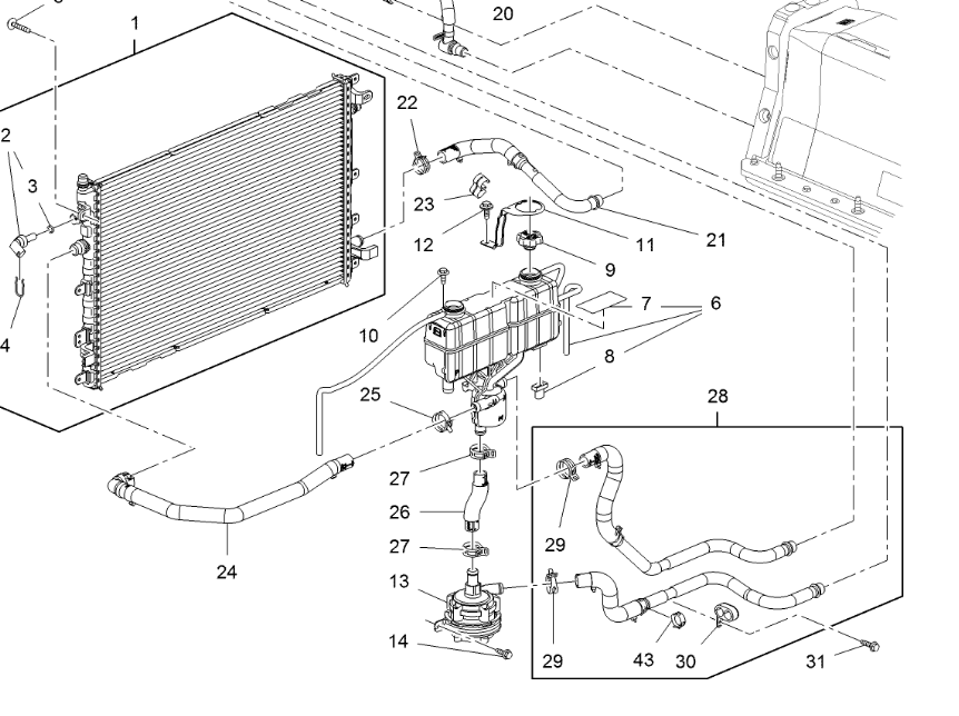

What that small mixing bottle is from? I'm looking for a small coolant bottle but I'm struggling to find something that small. And which valve you used? Thanks
- Posts: 3795
I had some trouble to deair cooling loop and i had this Opel Ampera coolant bulb handy. It is made so the coolant from 3 sides enters this bottle and the air is trickled out while mixing. Great stuff! I wanted to use this with cooling/heating system for battery modules. I expected a ton of problems with air bubbles there... https://rrr.lt/en/used-part/air24690-20 ... NjU0NzkwNQ..
I also go a small header tank from Mercedes Benz cars and was considering of using it...
https://rrr.lt/en/used-part/zeb11792-a2 ... -reservoir
There is also Ampera coolant tank meant to keep battery coolant and it is great for suplying two separate systems. It has the same bulb installed. This tank sits upfront under the hood. Great for mixing fluid for two systems. download/file.php?id=27005&mode=view

Something like this?
https://roettele-racing.de/motortechnik ... number=679
The seller is a friend of mine. If you need something, let me know...
