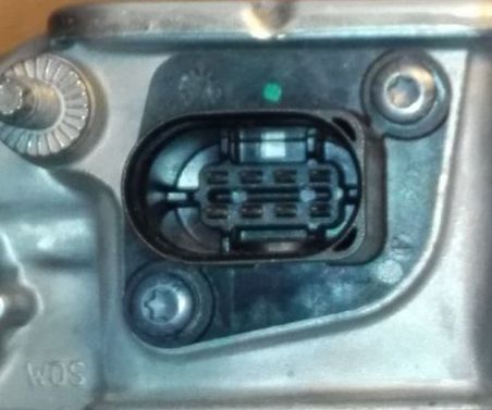

I purchased the WEBASTO heater and have the connectors and am ready to do my own testing.
Silly question to some, but on the LV connector on the heater side (picture below), which is PIN 1, so I can build from there for testing?
Top RIGHT
Top LEFT
Bottom RIGHT
Bottom LEFT
Thanks everyone and an early Merry Christmas to all of you!
jsimon
Top RIGHT
Top LEFT
Bottom RIGHT
Bottom LEFT
jsimon

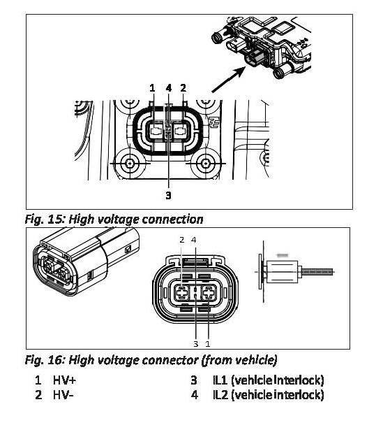

Re: Webasto HVH50
Excellent. I was looking in the wrong PDF. Thanks for the quick response!
Now that I am reviewing page 11, I want to make sure I am not mixing up the HV+ and HV-. The wiki page says: "The right pin (with tab facing upwards) is HV+, the left one HV-"
BUT page 11 of the PDF seems to indicate that HV+ is on the LEFT side of the connector (ATTACHED TO THE VEHICLE).
I get that this might be one of those times where one person is talking about the connector coming from the power source (FIG 16) and one person is talking about the connector attached to the actual heater (FIG 15), SO . . . just to be safe, can someone confirm if the LEFT SIDE of the connector attached to the heater (FIG 15) is HV+ or HV-? That is what it appears to say in the manual.
THANKS AGAIN!

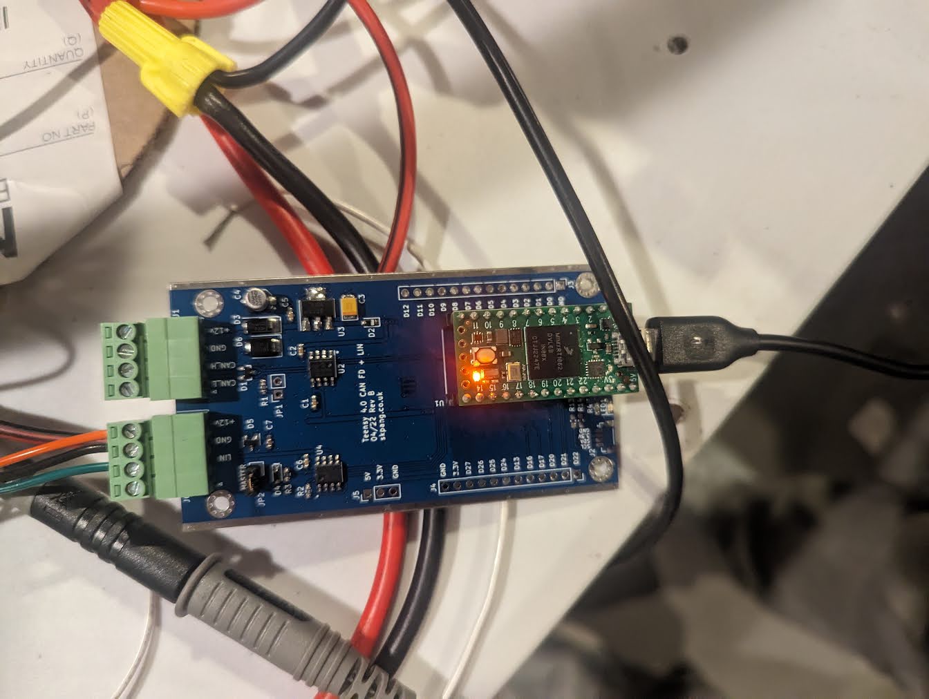

I wanted to keep everyone up to date on my progress. Thanks to royhen99, who has taken the time to convert the code created by Johan into a form acceptable to Arduino. MUCH APPRECIATED!!!! We have been tweaking it, but I am not getting hot water. I am trying both the 9600 and 19200 baud rate.
Below is the code as it stands in case anyone sees anything that stands out to them.
Here is the included lin_bus.h file that is relied upon for the program:
This schematic helped us confirm the lin_cs pin:
Here is the Teensy 4.0
My messy work space!!!!
Thanks!

When I initially wrote the code I did not know what hardware you were using. The skpang board uses serial 3 for lin so initialisation should be
LIN l(&Serial3, 19200);

Thanks guys. I updated the code to LIN l(&Serial3, 19200) and LIN l(&Serial3, 9600) and neither seemed to engage the heating of the water.
Johan, I am not sure what changes need to be made to the communication parameters as you mention above. Maybe royhen99 can help with that.
I assume my settings on heat and power are correct with the offsets. I do get the following warnings when compiling the code which I am told is caused by conversion of power which is 16 bit number to lin data which is 8 bit:
warning: narrowing conversion of '(int)(((short unsigned int)((int)Power)) / 40)' from 'int' to 'uint8_t' {aka 'unsigned char'} [-Wnarrowing]
71 | uint8_t lindata[] = {(Power/40), (Temperature+40), 0, 8};
warning: narrowing conversion of '(((int)Temperature) + 40)' from 'int' to 'uint8_t' {aka 'unsigned char'} [-Wnarrowing]
I also have another heater I can swap in at any point to rule out a faulty heater.
The hardest part is I am not able to see any feedback to know if anything is happening. Operating on faith that the 12V to the heater is actually turning it on and the LIN signal is being received . . . I am happy to keep troubleshooting with any assistance.
Thanks!

Re: Webasto HVH50
I think you should make sure to get those feedback signals before attempting to run. Are you reading the console that outputs the various messages?
At least tmpheater should yield something valid and perhaps udcheater if you've got high voltage connected.
I'll hand off to Roy from here

Re: Webasto HVH50
I have added the ids for both 9600 and 19200 baud. Swap to commented out lines to change baud rate.
Also fixed compiler warning.

Re: Webasto HVH50
Thanks guys. I will give this new version a try this evening.
I do not think I have anything to read the output messages. Not sure if that is something I can access in the IDE program or need something else.
Thanks!
Thanks!

Re: Webasto HVH50
This may seem basic, but just to make sure, if I choose LIN l(&Serial3, 19200), then should everything below it also use the 19200 options and likewise if LIN l(&Serial3, 9600) is selected, everything below it also use the 9600 options? I assume so, but from the above posts, I could not tell if the baud rate has to be the same across everything.
Also, I am not sure if the serial plotter in IDE should be yielding feedback to me. It is not showing anything, but I am not sure if I need to change any of the above programming for the serial plotter to actively show me this feedback. When I try to select a baud, it shows "baud" but no choices for 19200 or 9600.
Thanks!
Thanks!

Re: Webasto HVH50
Either use to code for 9600 or 19200. Uncomment lines with /// Change to this for 19200 ///// at end and comment out the line for 9600.
The baud rate on the serial monitor does not matter as it is using USB connection. You should see "Sending power and temperature" on the serial monitor from start-up. If there is nothing showing then either the Teensy is not programed or the USB cable is faulty.

Re: Webasto HVH50
Thanks for the explanation of about the baud rate.
I am seeing the "Sending power and temperature" on the serial monitor from start-up, so that is good.
I am still not getting hot water, but will try different combinations again. I was hoping to come up with a way to see feedback from the heater to confirm it is ON and receiving HV and the LIN commands. At the moment, I am operating blind other than seeing power is coming across on the Multi-Meter and Lin wire is showing 11V.
Re: Webasto HVH50
Part of what I like about EV-Olution's design is that there are status LEDs (and a start - stop button!) simply using MPU I/O pins
I am confused by the nomenclature on the schematic, I see LIN_TXD and LIN_RXD on the MPC2004, which I think would be connected to TX1 and RX1 of the MPU, but those pins are labeled CRX2 and CTX2?
Also, what is the CAN doing?
Thanks!
Thanks!
