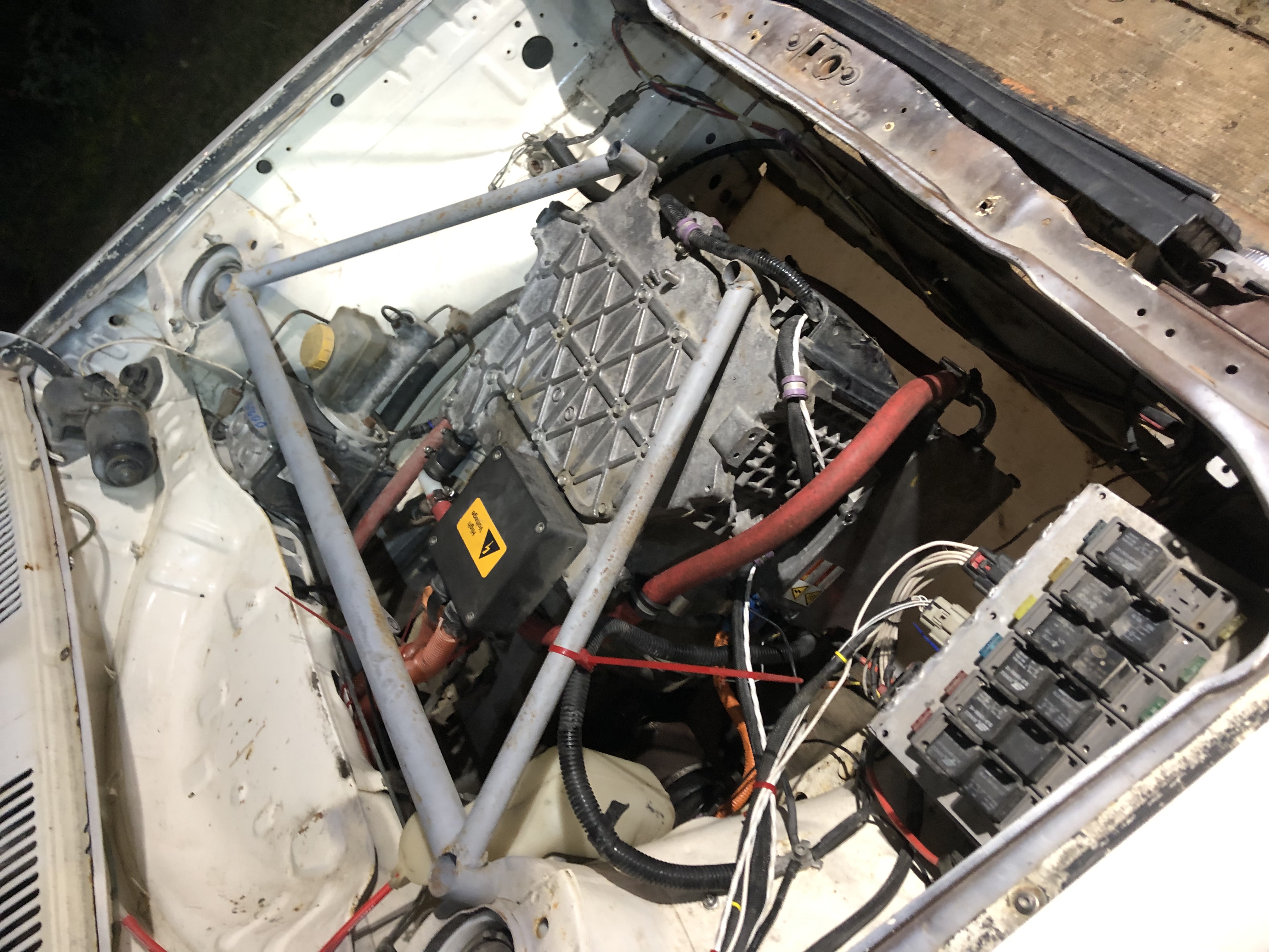

installed a model s dcdc, mounted on the side of the leaf motor. cleans up the engine bay nicely, and shaves some weight. but now i have noise(?) jittery throttle. and overcurrent errors often. in start and stop traffic overcurrent's all the time.
i put a ground strap from the dcdc to the resolver ground screw, didnt really seem to help much. maybe i have a loose hv connection?

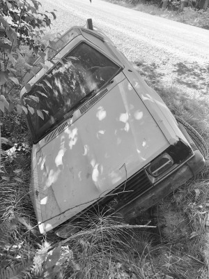

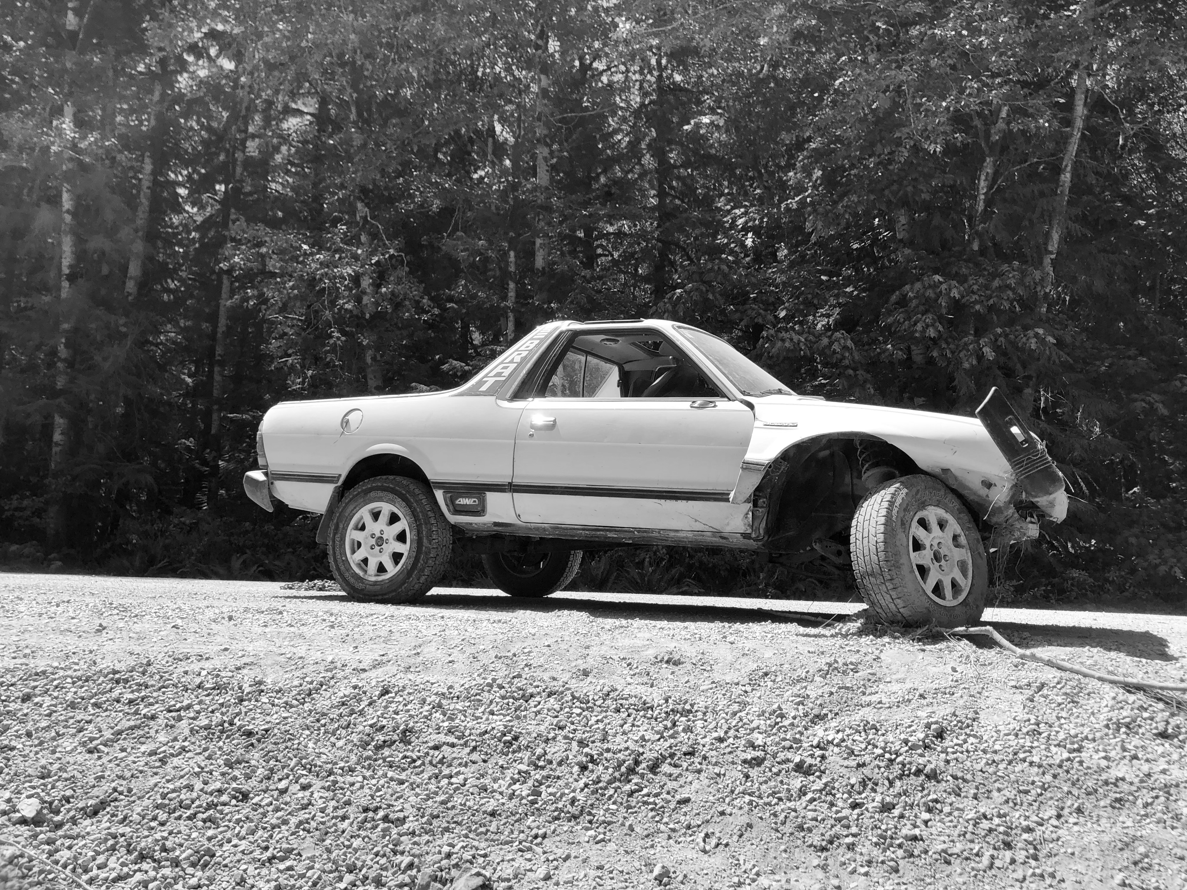

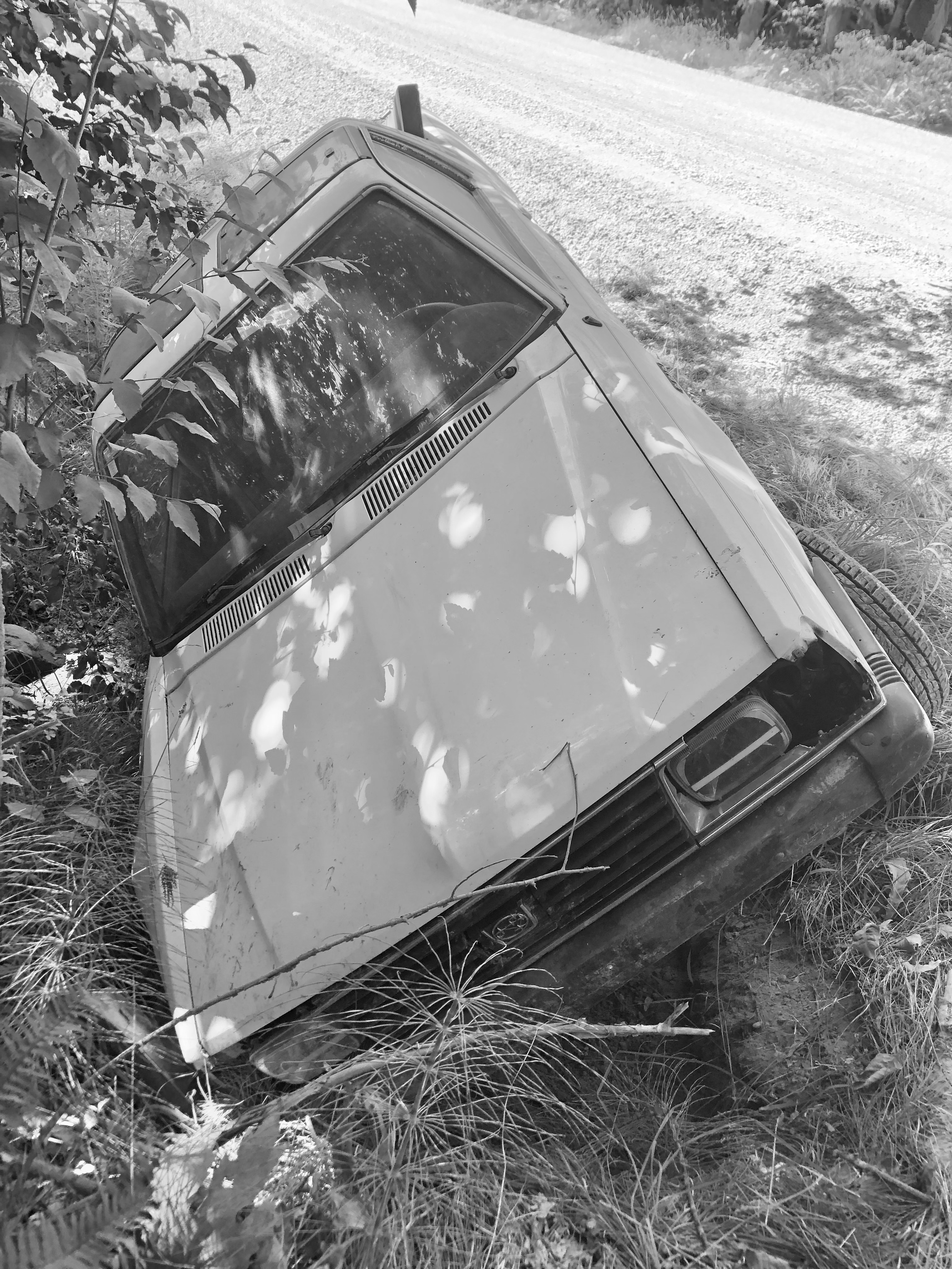

i crashed the brat. but driving again and back on the road a day later....
taking a back road detour on the island. before i set off, i was looking at the logging road maps, and it looked like there might be a short cut through a mountain pass that would cut out 40km, but there was 1km of a deactivated road. i gave it a shot...the 1km was washed out and impassable so turned around and charged up again to take the normal rout. by this time it was 1:30 in the morning....next thing i know im driving in a ditch and hit a culvert.... blowing out the front suspension. through friends of friends, budy from a remote town on this side of the coast towed me out and we rebuilt the suspension. back to hooning a day later.

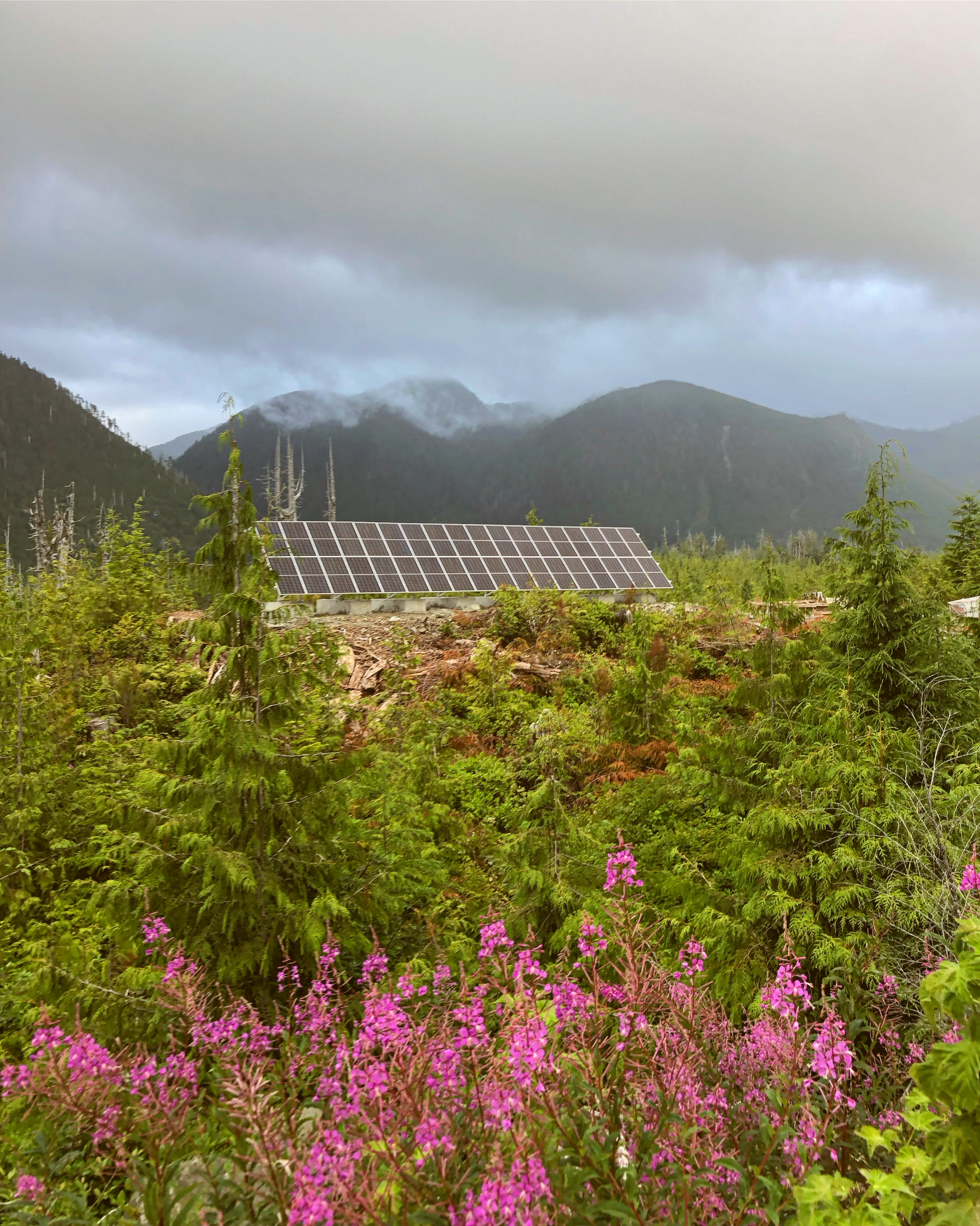

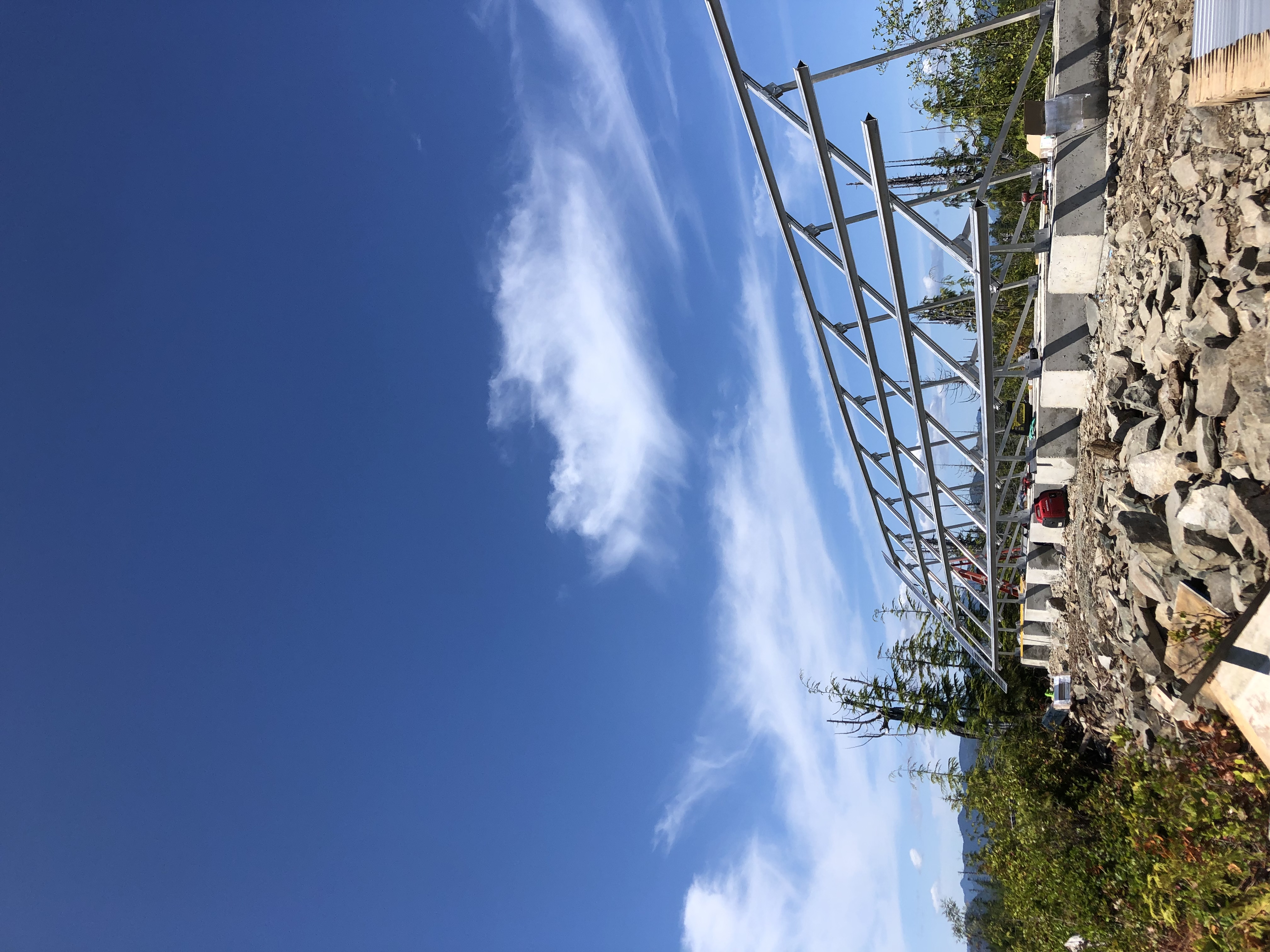

soon after that i got a call to help with a massive off grid solar system. so 300km drive up the island! no rest for the wicked...

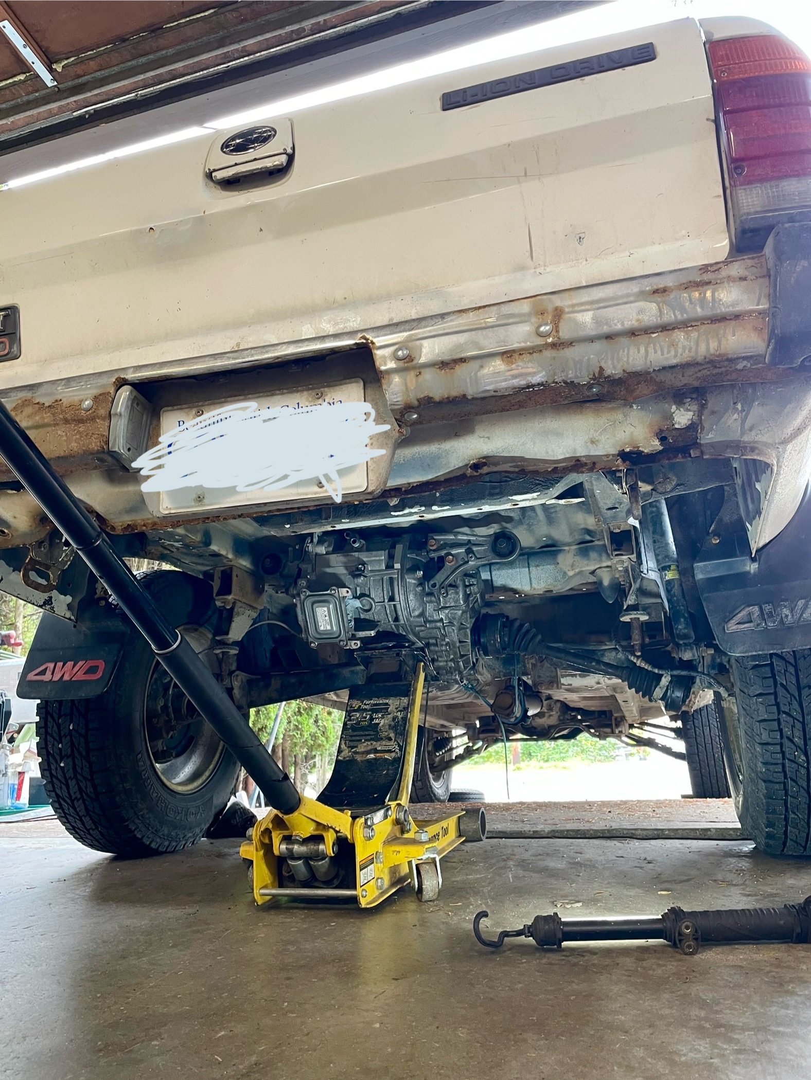

while doing some maintenance in the rear, I took the time to see how a outlander drive unit would fit. fits perfectly! some very minimal bracketry needed to hold it in place.
I’ll be slowly switching that brat over to dual outlander units. as this is my daily driver I’ll do it in parts.
First get the outlander motor mounted (no car mods must be bolt in!) and the zombieverter wired up and running.
This way I can swap in and out the outlander and subie rear diff easily. Can also just drive in fwd with no rear end. So I can still pickup supplies
Once outlander du is moving the brat, the leaf motor and e rest of the Subaru drivetrain(transmission) will be pulled.
then can start fitting a outlander du in the front.

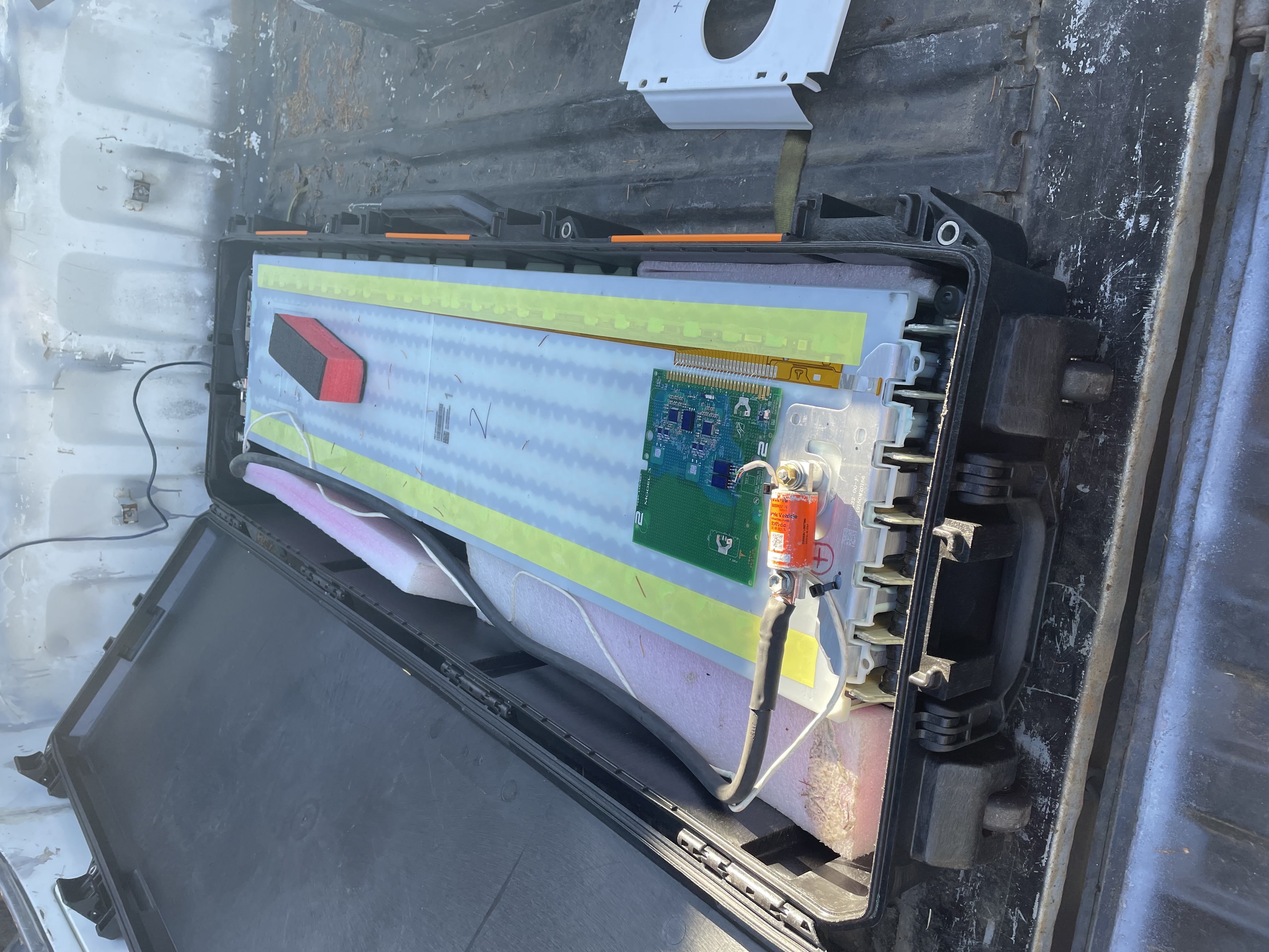

Sudo temporary battery install:
4th model 3 module mounted in a rifle case strapped in the bed.
Now running full 96s 400v
Drive over 200km At 85km/h pretty happy upgrade!

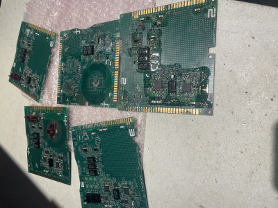

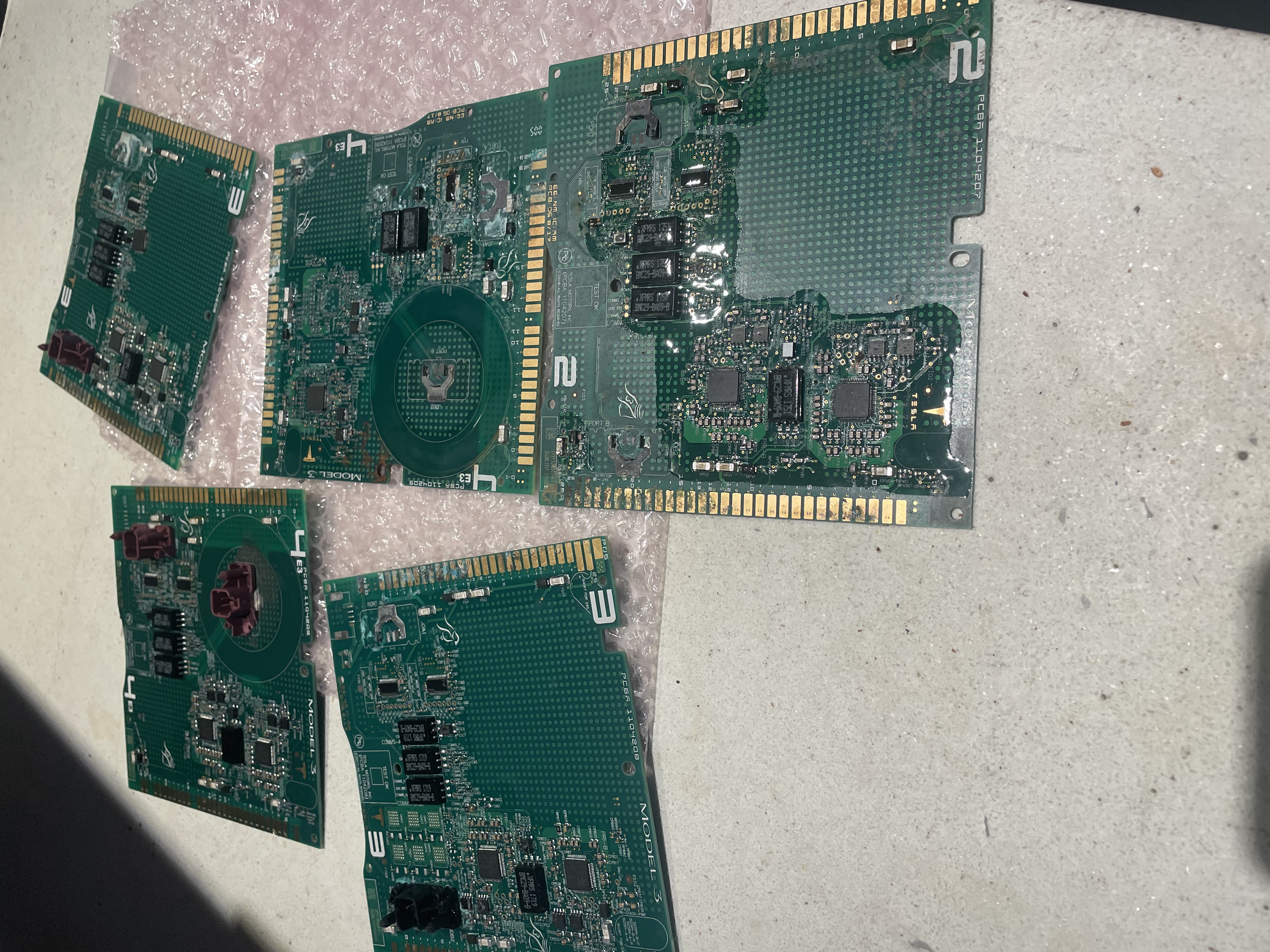

Picked up a few model3 bmb boards and salvaged as many bat man’s as I could. Will be testing out Damien’s latest update on m3 bms controller, and will have Batman chips available for sale aswell

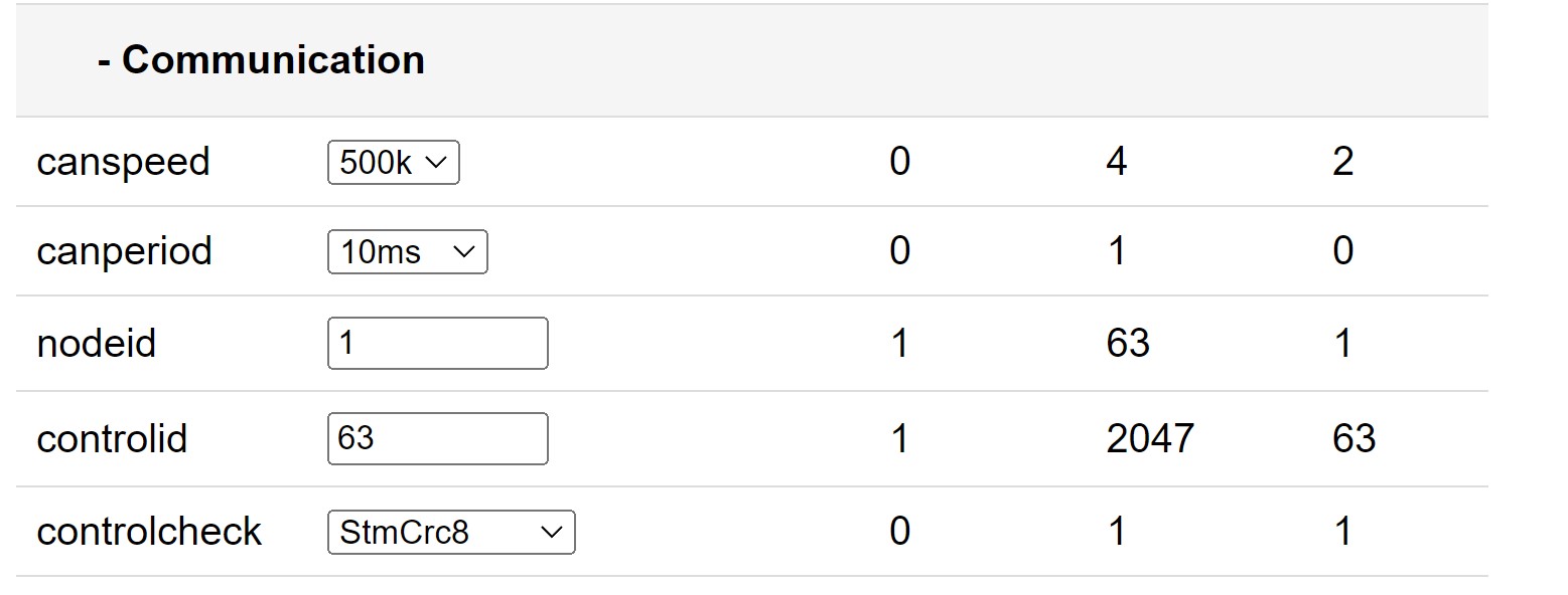

OI board setting:
- Throttle
potmode
CANDual
- Communication
canspeed
500k
canperiod
10ms
nodeid
1
controlid
63
controlcheck
StmCrc8
ZOMBIE settings:

Is the inverter seeing the direction command from the Zombie?
Re: [DRIVING] leaf powered 1983 Subaru BRAT (dual outlander WIP)
Are you running the new OI code which expects the CAN counters and checksumming?
Does Zombie generate the can counters/checksums that the OI board wants?

okay so if i powerup the inverter (oi board):P.S.Mangelsdorf wrote: ↑Thu Feb 29, 2024 7:08 pm is the OI board responding to any of the Zombie's CAN instructions? Have you logged to confirm the Zombie is sending over CAN? Any chance it's some small mistake like CAN speed mismatch or termination issues?
lasterr: PRECHARGE
status: UdcbelowUdcsw|BrakeCheack
then when i power up the zombie, the inverter:
lasterr: CANCOUNTER
satus: UdcbelowUdcsw|brakeCheak
then do ign and start on the zombie
the inverter:
lasterr: CANCOUNTER
status: BrakeCheck.
from my understanding the zombie can speed is 500k?
if i change the can speed to anything else (from 500k) in the oi interface the CANCOUNTER error is gone.

yup, thats it. progress.P.S.Mangelsdorf wrote: ↑Thu Feb 29, 2024 8:32 pm Zombie-don't-kill-people code requires the brake pedal be applied at start up to verify that it is getting brake signal
inverter side pulled brake to 12v, then start to 12v now in run mode on the inverter.
selecting drive via zombie sends forward/rev to inverter. and ill hear the inverter wine, but no movement. now getting throttle2 error. okay progress!
okay so ill need to set up the can throttle on the inverter the same as the zombie. right as its just mapping the throttle vaules, not torque requests i assume.
we have a driver!
mapped the throttle (pot min/max) on the inverter.
selected drive via zombie,
pressed throttle via zombie,
motor spin!
wiring is kind of funky then, should i wire the inverter start input to the zombie "inverter power" output?
as zombie will take care of the start up sequence.
motor spin!
