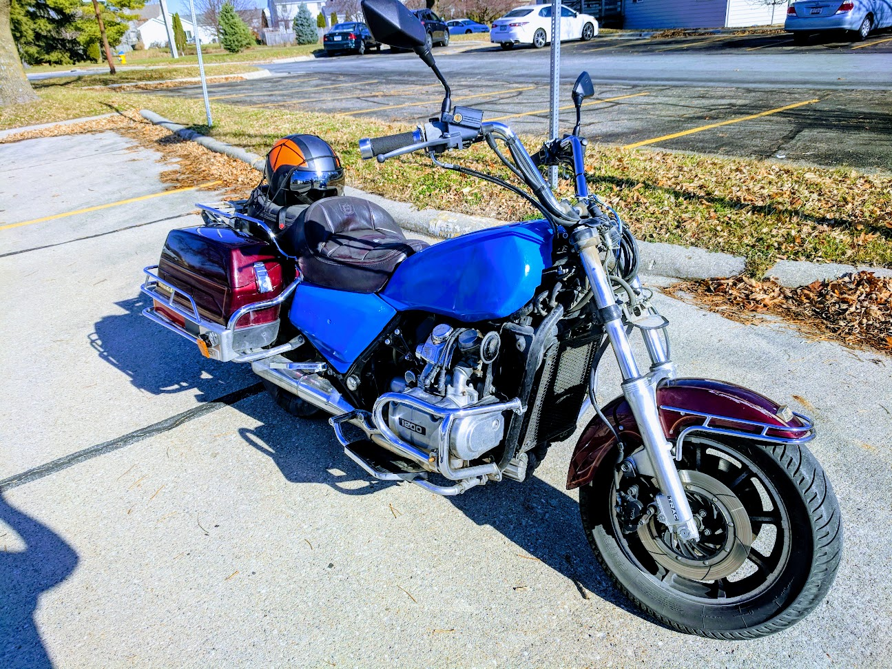

I am in the planning stage of my EV conversion project. Doing an EV conversion has always been a dream project of mine. I recently got a new job which will give me time and funds to accomplish this finally! I am an Electrical Engineer with a significant amount of embedded experience and my previous job was working on UPS systems that could power entire buildings. I am used to working on 540V 600A DC power systems. I think all of this gives me a good background to accomplish this task.
I think a motorcycle EV conversion would be a good (relatively easy) way to start working on this topic.
I have a much loved 1985 GL1200 Honda Goldwing in my garage that has not ran in the last two years.
I was going to wait till I had something to show for my project before I posted on here but I had a moment of (wife driven) paranoia about the parts I am selecting. There seems to be less information on here for motorcycle conversion so I am kinda in the dark.
I found an EM61 Nissan Leaf motor a handful of hours away for $600. Is this a crazy choice for a motorcycle? I assume I can run at a lower speed/power and if it is wildly bad choice I can shelve it for my eventual small car EV conversion project when I have a bit more space and experience. However, there will be more hesitancy from the wife to buy the next motor if this one proves inappropriate.

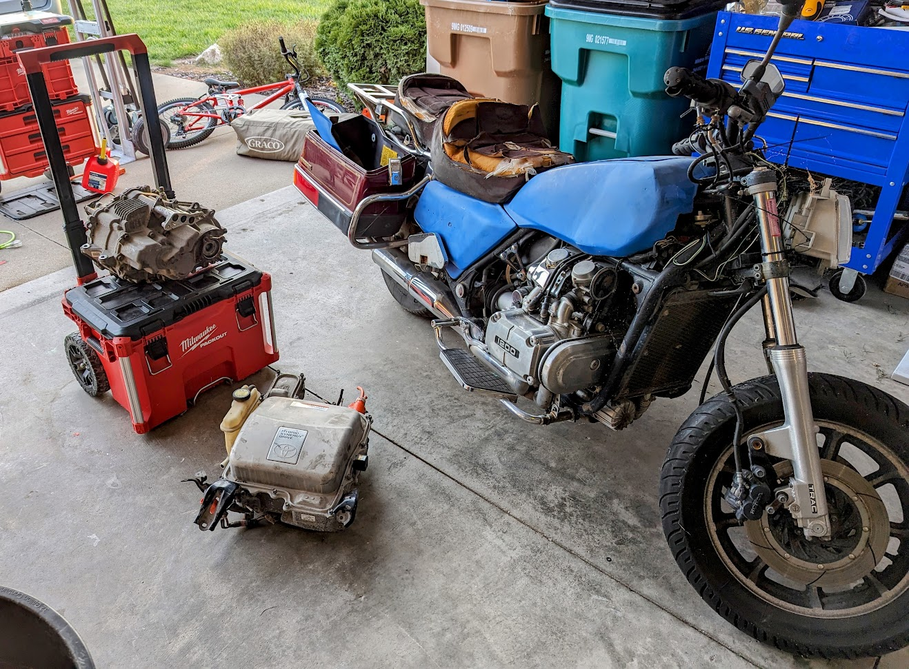

Re: Project: The 'In leiu of a carb rebuild' 1985 Honda GL1200 EV conversion
I think my next step is to pull all the parts I can pull from the motorcycle to start seeing what space I have to work with.
Starting with the batteries is good advice. I'm currently doing some research on LiFePo4 18650 cells since I would need at least 100 of them to hit the voltage range I'm looking for. As I type this out its occurring to me that I really need to do more research on battery pack design.
I managed to pick up a MGR 2FM motor and a Prius inverter last Friday. Here they are next to the bike they will eventually go into. Does anyone else hear Tetris music playing off in the distance?
Does anyone have any detail on doing a custom inverter? I would love to have more detail on this setup from a Youtube short: https://youtube.com/shorts/sq-ghHm946M? ... ICvLUPpYHF
Sadly, I spent the rest of the weekend cleaning the garage enough to be able to use the space to work on this. Hopefully, I'll find some time this week but its a bit unlikely.
