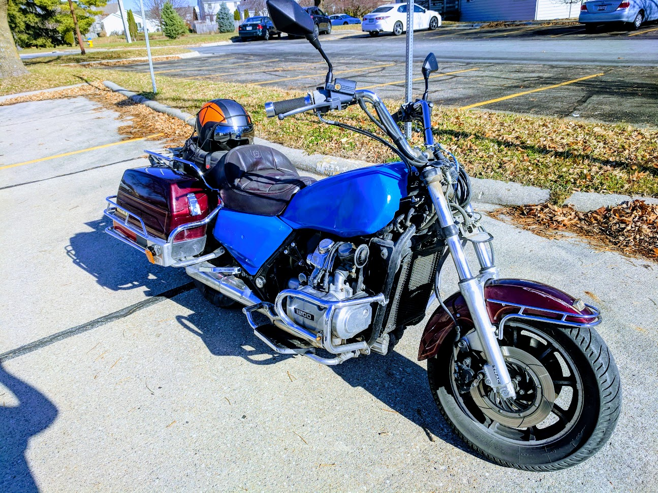

I have a much loved 1985 GL1200 Honda Goldwing in my garage that has not ran in the last two years.

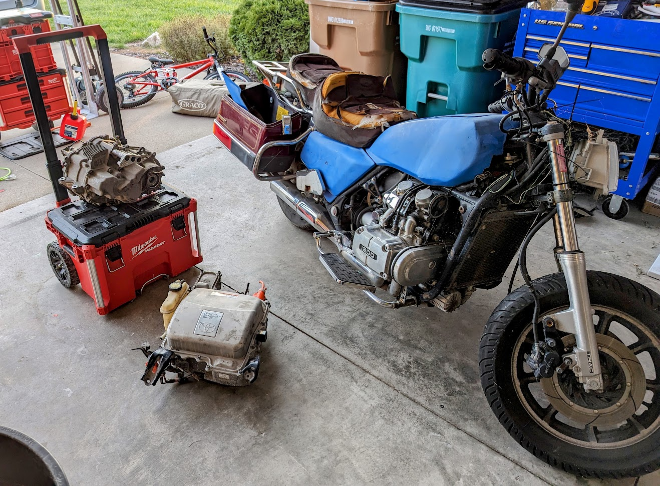

Re: Project: The 'In leiu of a carb rebuild' 1985 Honda GL1200 EV conversion
I think my next step is to pull all the parts I can pull from the motorcycle to start seeing what space I have to work with.
Starting with the batteries is good advice. I'm currently doing some research on LiFePo4 18650 cells since I would need at least 100 of them to hit the voltage range I'm looking for. As I type this out its occurring to me that I really need to do more research on battery pack design.
I managed to pick up a MGR 2FM motor and a Prius inverter last Friday. Here they are next to the bike they will eventually go into. Does anyone else hear Tetris music playing off in the distance?
