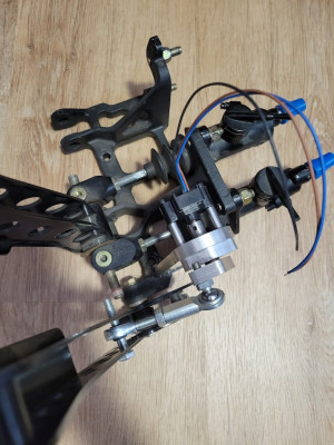

Finished my accelerator pedal position sensor (APPS) mount.. And yeah, I will be adding some lightness to that big bracket later on. For now, I wanted it reversible so I could play around with bearing offsets, and might still add a bolt hole somewhere for a safety return spring. Happy to share the files if anyone else wants to take a look. In hindsight I think I would do a couple things differently, but this should work just fine.
I mentioned my friend CNC'd the parts for me, and his sense of humour being what it is, he added a little surprise for me..

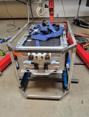

Hm, the ones I had in mind did have cooling, but I later learned they never made it to North America. D'oh!
It's kind of looking like I am stuck waiting for either a BMW or Pacifica battery, can't really find any other options in the ~12-16 kWh range. The BMW battery is appealing because of the slightly lower weight, the Pacifica battery because it already comes with water cooling plates. Maybe I could try running water through the BMW refrigerant lines and see how well that works?
I don't really want consider the older 9kWh BMW packs though, bit worried about range and how they'd cope with me trying to draw 140kW out of them.
I did already buy a Dilithium BMS setup, so with either of those options I'd likely just repin the connectors to work with the satellites I already have.

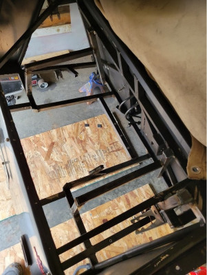

Re: [WIP] Homebuilt Locost 7 - from Motorcycle engine to Leaf power!

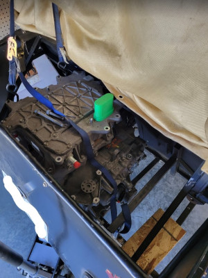

Okay, frame welding finished and motor is in! I don't have all the spacers ready but I did toss part of the suspension together on one side just as a test. So far so good.

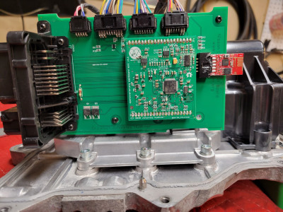

Also remembered right at the last minute to check my OI board for the missing slew resistor on the can transceiver. Was missing, so added a 4k7.
Uh, this is the correct orientation, right? Seemed like it from the diagram, but the fact that JP1 on the mainboard goes to J2 on the adapter and vice versa gave me pause.

It's correct. Silly naming, will change it on the next run

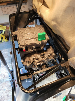

Time for another update. First spin completed! The wiring took a long time and there are still some odds and ends to tidy up, but I got it to a point where I can start testing things. Also got the charger mounted and cooling system plumbed up. I ended up making the twisted pairs I needed for things like CANBUS and the throttle pots and then did multiple pulls of wire off all my spools at once, while taping up each pull and labeling both ends of the bundle. Then I could run the bundles through the car in a single conduit and as I was terminating wires, I could mark down what went where. Eg. pull 1, white wire is the contactor signal, and so on.
I've also worked out the axle lengths I need and am going to take them to a local shop and ask them to make me a new set. Decided I just don't trust myself to weld them, and I don't really have the right equipment anyway, so making new axles is the best option. FYI the shafts also don't have enough meat on them that I could cut new splines on the existing shafts, so that's a non-starter.
For testing I'm using about 60 volts (three cordless tool batteries). When I press the accelerator the motor will spin, but releasing the accelerator does not stop the motor, and I have to put it in neutral to get it to stop. Is that expected behaviour? At first I wondered if it was a regen setting, but now I'm not sure.
Here's a video:
Here's a video:

Congrats on first spin.
In my Gen1 Nissan Leaf I had to put a load on the motor to make it stop spinning. Connecting it to the gearbox was just about enough to make it slow down so yours may be doing the same.

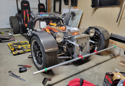

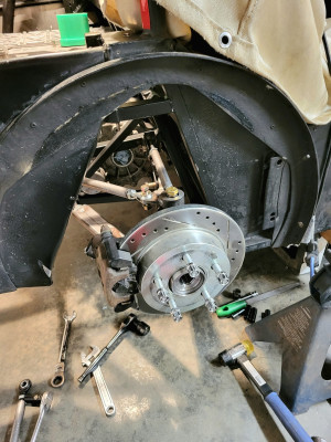

As for recent progress, I got the suspension assembled to the point where I was confident taking measurements for new axles. One needed to be shortened only slightly, the other needed a good few inches taken off. Unfortunately shortening the axle only a little bit is not possible due to how the diameter is reduced near the ends. So, I had one shortened and one made completely new. This one also didn't have the same diameter reduction machined in, which I suppose is okay because it will help to limit the torsional deflection and hopefully prevent any noticeable torque steer issues (Yes I know it's RWD but Caterham actually had a bit of a torque steer issue on their cars before they were able to center the rear diff.... allegedly).
I have also been working on ensuring the car is compliant with the new SCCA rules, which necessitated getting an insulation monitoring device. Found an ISO165c-1 in new condition on eBay, so that's somewhere in the mail now, along with about $100 worth of connectors, indicator lights, resistors etc to hook it all up.

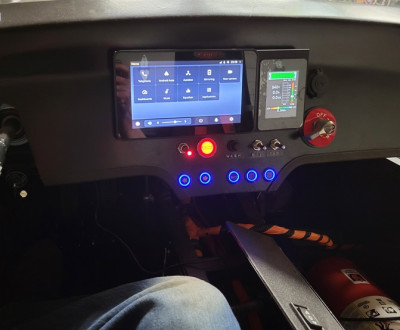

And I figured what the hell, adding a rasyberry pi to the dash with Android Auto and a browser for OI. Still working on that.

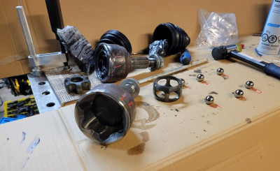

Axles: Cleaned and re-greased all CV joints plus new boots all around: Also took the time to figure out a way to cover up the giant hole in my hood from where the ICE air intake sat: Axles in: Motor wired up: J1772:

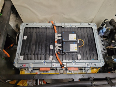

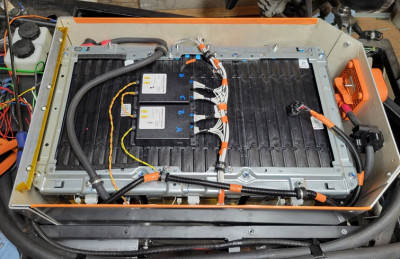

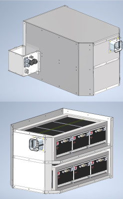

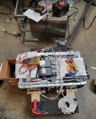

Finally got the new battery enclosure finished. Funny enough my current job involves a fair bit of sheet metal design, so I was able to model something up and have it laser cut and CNC bent at Send Cut Send. They also installed PEM nuts which I wanted to use rather than rivnuts so as to avoid leaving a raised surface on the mating side of the sheet. Now since I was farming this work out I tried to be as cost effective as possible, making some parts identical for quantity discounts and then modifying them later. Very impressed with the quality of what came back, even the zero clearance holes I drew lined up perfectly, even around corners. I also made some of the brackets and the top plate myself, to save a bit of money. In some cases I did use rivnuts, but I counterbored the holes on my mill to get them to sit flush.
This was the basic design. Contactor box with 3d printed parts. (And once it was installed, but only partially wired). First group of cells in place. The liner is Nomex 410 paper and Kapton tape. A requirement in the SCCA rulebook. Mid tray (same part as the base tray but I cut the front off and bent it downward for rigidity). Top group of cells in place and most of the wiring done. And done! I'll have to pull the lid off again later to check for leaks once I refill the coolant, though. I also decided to change up my accelerator pedal situation, so I removed the single channel hall sensor and modified a Prius pedal. Basically I cut the pedal part off, then mounted it upside down behind the Wilwood pedal box and connected it with a linkage. I also ran a nicer shielded wire, just in case. And then I forgot to take a picture. oops. Oh, and I discovered a small problem with myself while testing the feel of the pedal. I was checking to see how it felt to roll on and off (linearity, overall resistance, etc) and caught myself making engine noises as I did it.
Lastly, I have been working on the computer. The one on the left is a Raspberry Pi running Open Auto Pro, powered by a CarPiHat. It can communicate with the inverter over wifi, and the BMS/MCU via USB. Eventually I want to get it onto the CAN network for datalogging too. Possibly add a camera feed and run it with TrackAddict. The screen on the right is the Dilithium display for power usage, SOC, cell balance etc. The shroud I printed for the back was a tad too tall so the dash is sitting a bit high in this picture. Will have to print a new one asap. There's also a speedometer that will be mounted below the blue buttons but I can't mount that until I reinstall the cover for the transmission tunnel.

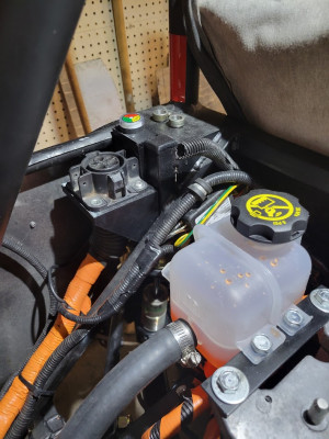

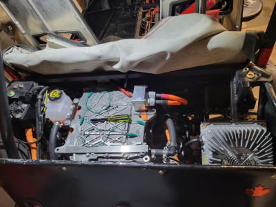

Tested the charger and DC/DC converter today. Using the gen 1 Volt DC/DC with the MCU is pretty cool because I can just set the output voltage via command line. Verified with my multimeter as I adjusted it up and down.
And after a little messing around, the charger works! I have two portable level 1 EVSEs and one L2 EVSE mounted on a wall. The L2 cord won't reach the car right now so I just tested with the L1 units. One is an OEM BMW which did NOT work, and the other is a "Zencar" brand that I got for cheap. Unfortunately I don't have another vehicle to test with the BMW EVSE, so I have no idea if it's defective or what. Upon plugging in it seemed to communicate with the charge controller, but did not close its contacts and did not display an error. So, here's the Zencar one working.
Anyway, I think I'm getting close to a test drive. Next on my todo list is to clean up the 12v wiring now that I have tested everything, get the car back on the ground and do a string wheel alignment since the entire rear suspension is new. I can take my time there, since it's snowed something like 20cm in the last few days...

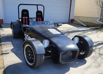

Did my first (very short) drive today! The weather was nice this weekend, and I managed to get things sorted out enough to go for a couple laps around the block. During my efforts to configure my Thunderstruck MCU I had an issue with the 'fanontemp' and 'fanofftemp' variables not working, which was later fixed with a firmware update. You have to request the firmware straight from Thunderstruck, which was a little irritating since I had no way of knowing how far out of date my firmware was until I emailed them to ask.
I also tried to calibrate my Syncofs but even after going up to 150 amps I was not getting motion from the motor. I think it may just have been pretty close to the ideal number though. I used Johu's settings as a starting point, and I can't imagine the difference from one EM57 to another is terribly massive. I also had the wheels on, so there'd be more inertia too. I have since watched Damien's tutorial where he changes the syncofs incrementally and once the battery is charged back up I will give it another shot.
The wheel alignment was a challenge but I think I got it close enough for now. Measuring and adjusting caster was quite a challenge, next time I might invest in some turn plates or at least a slip plate with angles marked on it. For now I have settled on 1 degree of static camber all around, and about 4.5 degrees of caster. Unfortunately my dash cam seems not to have recorded the drive, though it probably wouldn't have been very interesting anyway. After my second lap around the block a car enthusiast neighbour walked over, seeming confused, and said "it's so much quieter than it was, it almost sounds electric!"
So in lieu of any video, here's a still shot. I used to absolutely hate backing the car up the driveway, because I had to rev the snot out of the motorcycle engine to get over the sidewalk curb. Not anymore! At extremely slow creeping speeds it has a bit of judder but I expect that's normal. Funny enough, that was my first time ever driving or even riding in an EV. Next steps are to charge the battery, try again to tune the syncofs and prepare for a longer shakedown drive next weekend. I've also designed and ordered some new front shock mounting brackets from SendCutSend. The angle of the front shocks is really too horizontal for best practices, and now that I have more weight in the front it probably couldn't hurt to have a slightly higher wheel rate. So, these new brackets will stand the shocks up a bit and add some stiffness.

That's great
150A and no motion is pretty good, wouldn't even bother to get closer

Construction garbage bags folded up and under each tire will work very similar to a slip plate. Just be careful, it's easy to knock the vehicle off whatever scales / stands you have it on with these. You can add soap between the layers if you need it even more slippery but it can get very messy.The wheel alignment was a challenge but I think I got it close enough for now. Measuring and adjusting caster was quite a challenge, next time I might invest in some turn plates or at least a slip plate..
As for the caster, if you're making your own uprights it definitely helps this area a bunch if you add a parallel to the kingpin line face/ edge to measure off of.
Some oems have pin holes that a bracket pops into in the upright to give a reference edge to measure from. I don't recall which way you went on this, just some ideas for you that might help, might be useless.
*Edit you might be able to 3D print a fixture that pops over your uprights to measure off of
Re: [First Drive] Homebuilt Locost 7 - from Motorcycle engine to Leaf power!
Ooh, that's a great idea! I don't think I ever mentioned it, but the front uprights are from a 2000 Ford Mustang. That was a strut car, and I had to add a bolt-on adapter for the upper control arm, as well as an extended lower ball joint. Not a terribly elegant solution, and it's on my list of things to change eventually. After designing my own rear uprights, I think I'm confident enough to do the same for the front. When l do, I'll definitely add a means of measuring the caster directly. Thanks for the idea!

Went for a longer (25km according to Google, 28km according to the odometer) drive today. WOW this thing pulls! I didn't have a safe place to try a full throttle pull (and it was only 10 degrees C) but the part throttle acceleration is quite impressive, at least to me. The BMS says I used 4.4kWh (of 16kWh) and cell voltage went from ~3.9v to ~3.6v.
During the two short bits of highway driving I did notice a bit of what I fear may have been unintended acceleration. I was going down a slight hill, though I wouldn't have thought it was steep enough to make the car want to accelerate? The weird part is that I was riding the brake at one point and the BMS was reporting that I was still pulling around 50 amps while doing about 100 kph. I have no frame of reference but would have expected the current to drop to zero off throttle. Once I got below about 70-80 kph it didn't feel like that anymore, but at that point I was braking for an exit ramp. Really not sure what to make of that. I'll check my syncadv and maybe try again to verify my syncofs is right..
I also noticed it seemed to top out at about 110 kph. While on that stretch of highway I let it accelerate me to 110 and then noticed it didn't go any faster. In fact pressing the pedal all the way didn't do anything at that point. Looking at my parameters, I have fmax set to 500Hz. By my calcs the motor would have been doing about 8000 rpm at that point (small tires). It's a bit hard to decipher but from what I can tell the EM57 has 4 pole pairs (so 8 poles), and the equation I found for calculating speed from frequency is RPM = 120f/p where f is Hz and p is poles. Assuming that formula does indeed refer to poles and not pole pairs, then the fmax would equate to 7500 rpm. Planning to bump fmax to 650Hz before my next drive.
Dashcam worked this time, but clearly I need to mount it higher on the roll bar. Also it was a pretty windy day, so tons of wind noise, sorry. This is the most interesting (er, least boring, but only by a little) 1 minute segment just because it involved accelerating at about half throttle from one light and stopping at another.
Re: [Driving] Homebuilt Locost 7 - from Motorcycle engine to Leaf power!
Small update in case anyone finds the above post and is having a similar issue. I verified that yes the 500Hz equates to a 7 500 rpm redline. Bumped it to 650 for my next drive. I also tried the syncofs calibration again and this time I got a completely different number. 17 000 instead of 1 000. I did not try changing the number appreciably last time because I thought I was already really close. Best guess is something was binding, maybe? Seems like the syncofs being that far off could have caused it to feel like it wanted to accelerate at higher speeds there. Hoping to get some more driving in over the next few days.
