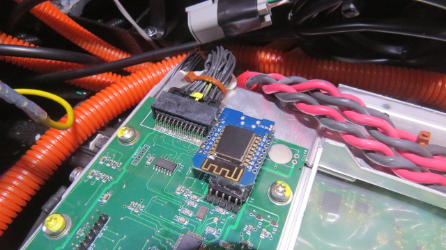

To upgrade to the commercial firmware in my Gen 2 charger V5 I ended up using a Wemos D1. Tried to program the stock 8266 with no luck. The D1 took the first time. I've uploaded a couple pics to show how I installed it as it has a bigger footprint. I used 2, 5 wide connectors and plugged them into the board with some glue between to bond them together. The header pins are staggered on the board so this way I knew there were plugged in all the way. Then I removed them once bonded and hot glued it to the D1 board. Used 4 short wires to do the connections. Plugged the board in and tested it. After testing a put a spot of hot glue on the one corner next to the black connector on the board to make so it would not vibrate loose. I also added a piece of electrical tape to the top of the D1 board because it was close to the aluminum cover, I don't think it touches but better save than sorry. Worked great.

IIRC, Brattitude was producing a board that converted Wemos D1 Minis to the Olimex. Little adapter thingy.
Been thanked: 1914 times
Re: Olimex MOD-WIFI-ESP8266 alternatives
Very neat. I think the actual Olimex board isn't the problem but the choice of connector. Maybe they switched to a different supplier lately
