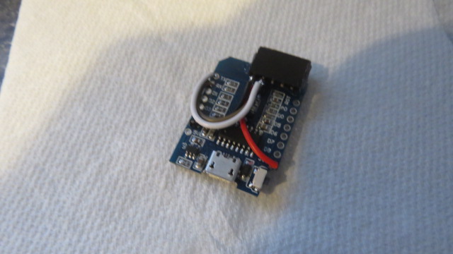

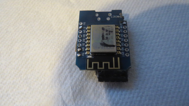

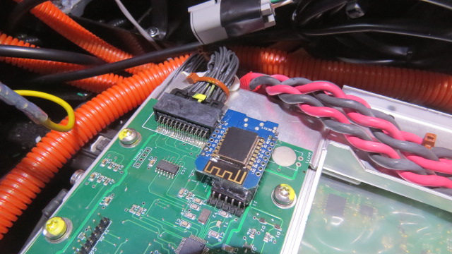

To upgrade to the commercial firmware in my Gen 2 charger V5 I ended up using a Wemos D1. Tried to program the stock 8266 with no luck. The D1 took the first time. I've uploaded a couple pics to show how I installed it as it has a bigger footprint. I used 2, 5 wide connectors and plugged them into the board with some glue between to bond them together. The header pins are staggered on the board so this way I knew there were plugged in all the way. Then I removed them once bonded and hot glued it to the D1 board. Used 4 short wires to do the connections. Plugged the board in and tested it. After testing a put a spot of hot glue on the one corner next to the black connector on the board to make so it would not vibrate loose. I also added a piece of electrical tape to the top of the D1 board because it was close to the aluminum cover, I don't think it touches but better save than sorry. Worked great.

Re: Olimex MOD-WIFI-ESP8266 alternatives
Very neat. I think the actual Olimex board isn't the problem but the choice of connector. Maybe they switched to a different supplier lately

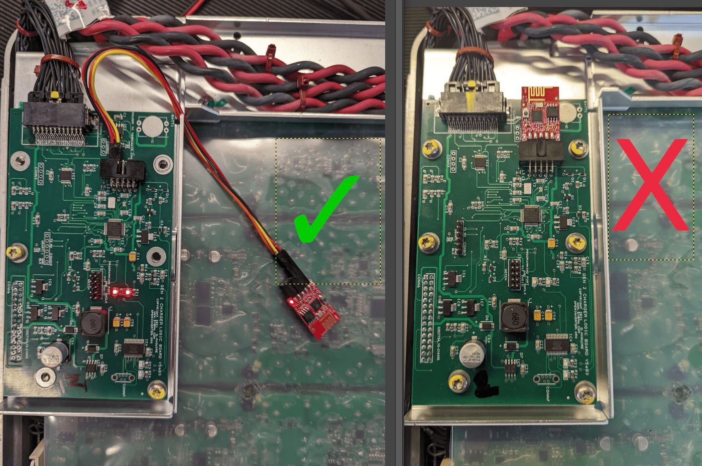

Just a quick note. I had endless connectivity problems with the MOD-Wifi, pulled the drivetrain twice because of it I think over the last months, and today finally realised that the combination of connector on my Tesla Logic board & Olimex connector is to be blamed! Need to replace the connector.
Without DuPont wire:
time curl http://192.168.4.1/index.js | md5sum -
returns different results from failed page loads, ESP8266 struggles to connect to the STM32 (sometimes only every 3rd time or less)
With DuPont wire:
HTTP requests always successful, params from STM32 load first time
Leaving this here in case it helps someone. Couldn't believe it. Went back and forth a few times, definitely the plug & connector combo. Added it here: https://openinverter.org/wiki/Olimex_MO ... mon_Issues

janosch wrote: Fri Apr 29, 2022 11:21 amWith DuPont wire:
I've been having the exact opposite problem. The Duponts are twitchy and inconsistent, and wiggle loose. I was going to make an adapter like shown earlier in the thread.
But now seeing that you've had troubles that way too, I'm tempted to say, for as often as you'd ever replace the wifi... just solder the damned board up directly and be done with it.

MattsAwesomeStuff wrote: Fri Apr 29, 2022 7:38 pm ...
Makes sense, I removed the biased red cross and green tick from the wiki, and just leaving a note telling people to try varying things: https://openinverter.org/wiki/Olimex_MO ... mon_Issues

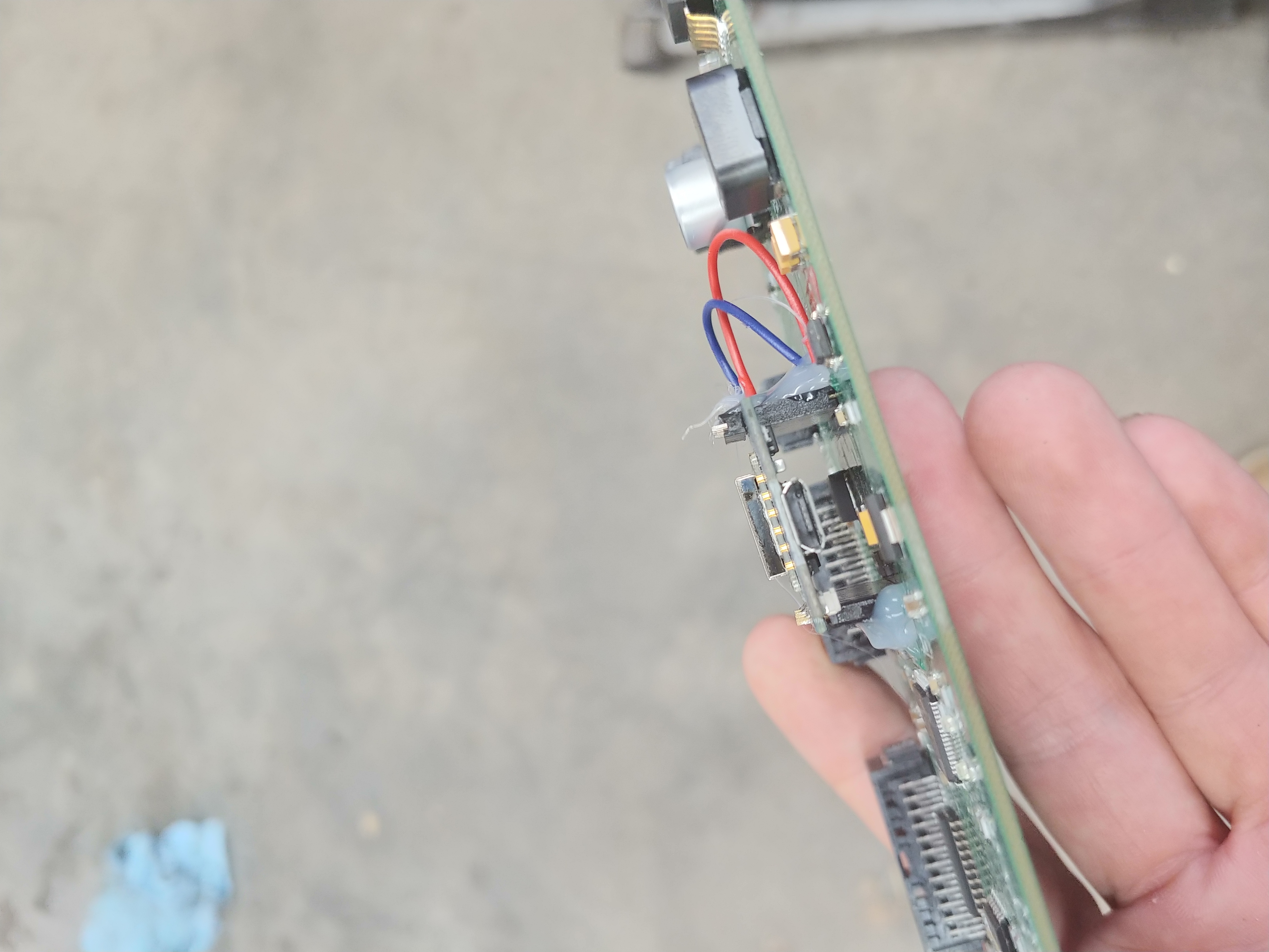

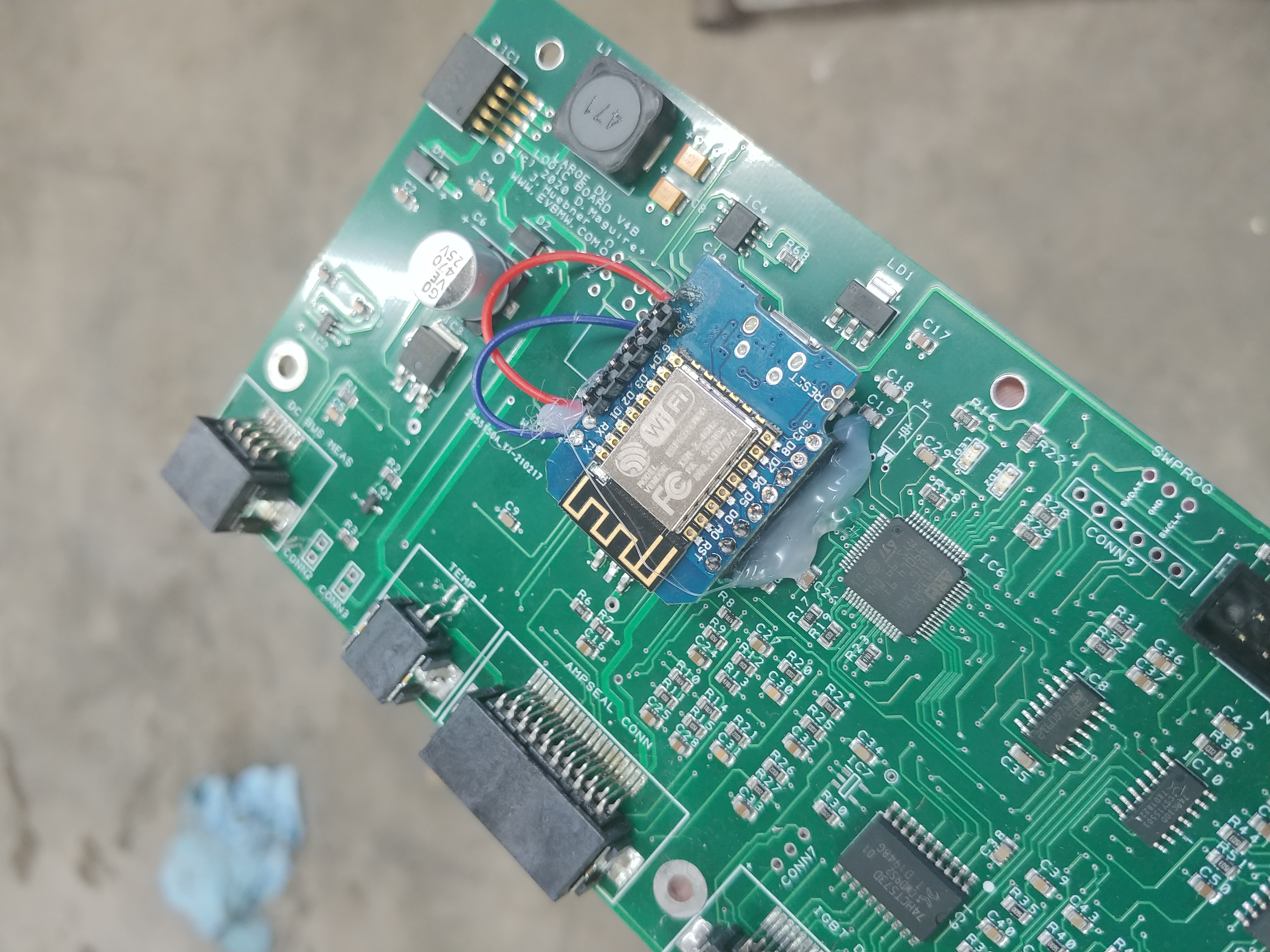

I replaced the olimex on my motor board with a D1. It was so much easier to program and setup. Anecdotal, but it seems like it connects faster and has slightly better range.
I'm a little concerned about motor vibrations but I'll just keep an eye on it and worse case have to pull it out and try something else.
