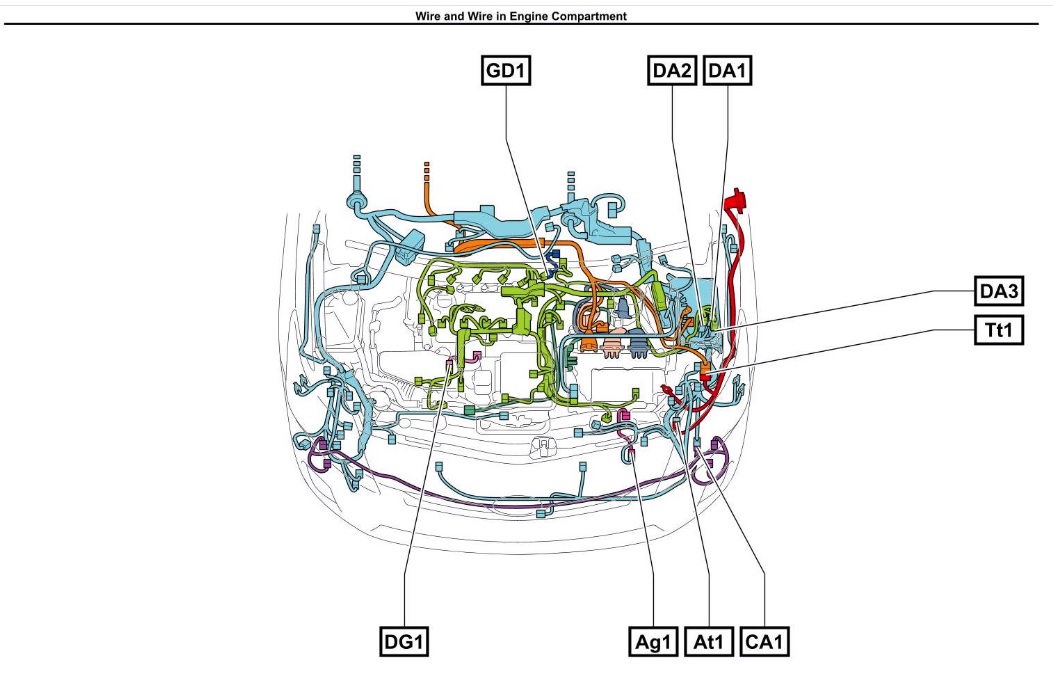

as I take on my Toyota Prius Gen 3 EV Conversion I would like to share some dumbed down wiring diagrams that my pea sized brain can wrap itself around
I have subscribed to ALLData.com so that you wouldn't have to for the 2010 Prius diagrams and schematics, and I must admit it aint the greatest, I will share all that I can
for example here is the extent of their Engine Compartment - Wire Routing, I kid you not that's as detailed as it gets as far as diagrams (not actual wiring schematics)
