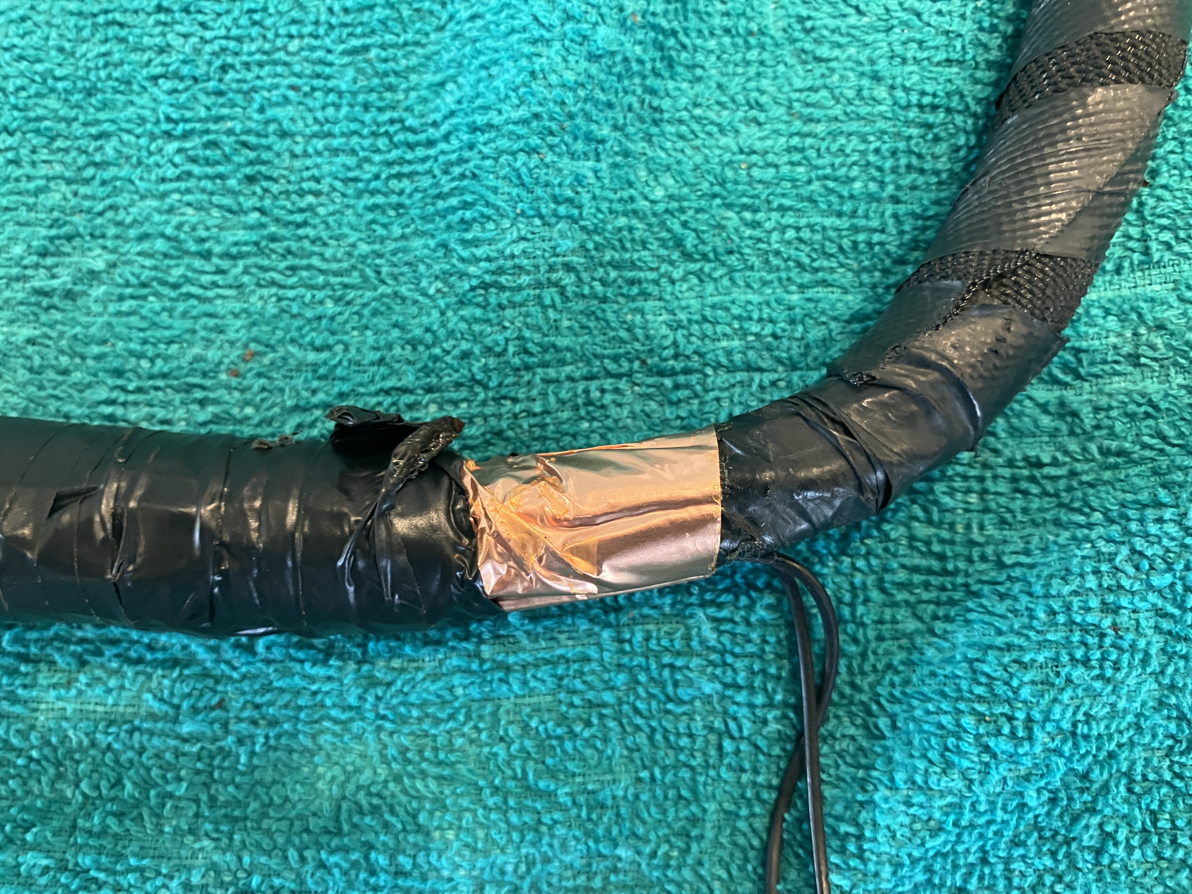

I found this shielding very interesting on the Inverter harness which I also went out and bought

Re: Prius Gen 3 Inverter Connector Pin Out Dumbed Down
someone smarter than me can explain what this is for, I'm guessing some sort of interference
Had seen that this part if the loom , transgresses over MG1 and MG2 phase connections quite closely...
There is shielding screen on the phase wires also, so is belts and braces good practice I guess.
Very informative post here, will be great resource for Prius related vehicles..Well done. That is all real Smart..
