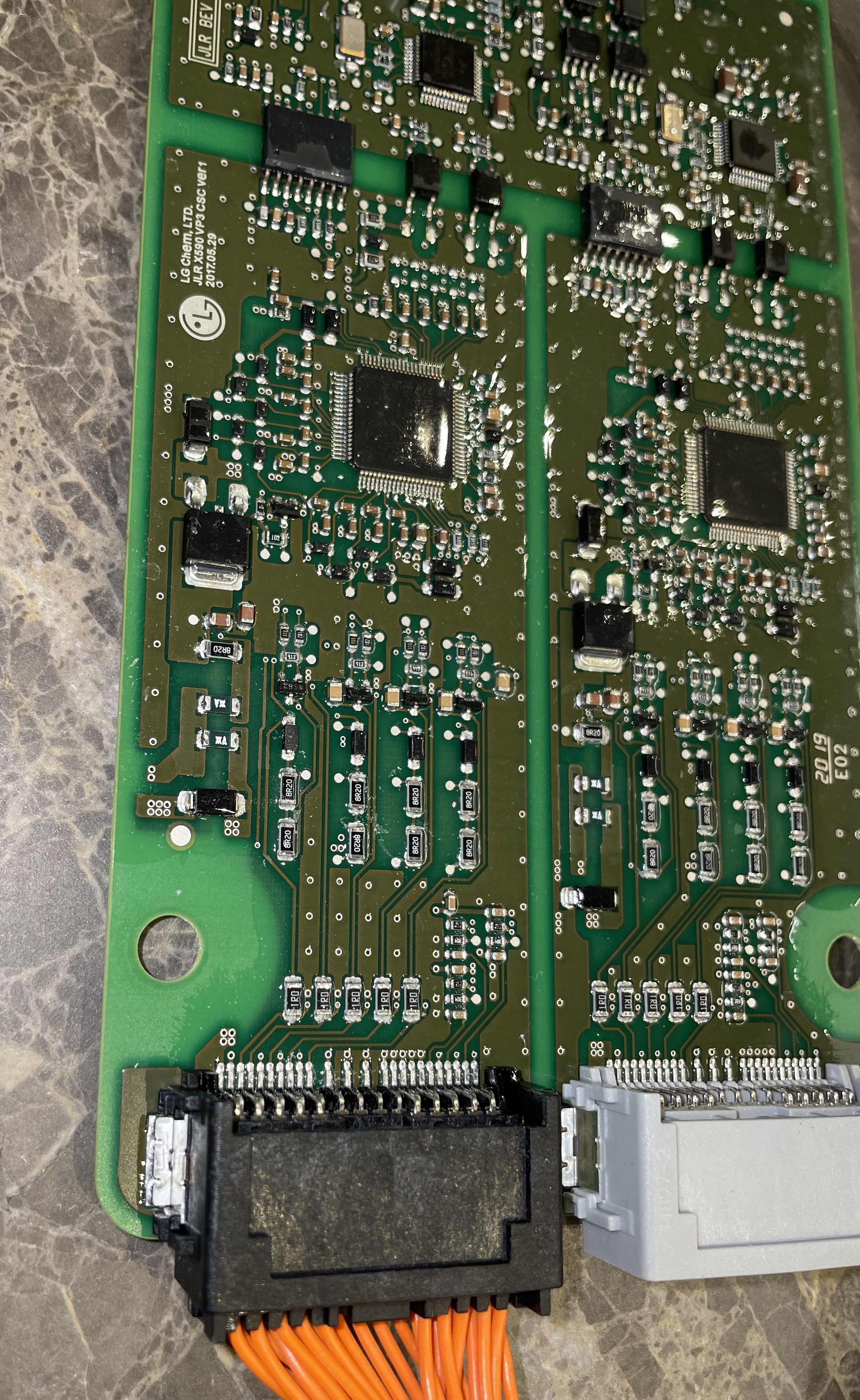

I have reverse engineerd the cell balancing hardware. My finding are these:
The balancing is passive with resistors, starting from the negative, there is a 1 ohm resister inseries with 2 resistors of 8.2ohm a diode, a mosfet, then a 1 ohm resistor leading to the positive lead of the cell, so the total resistance is 1+8.2+8.2+diode+1= 18.4 ohm’ the max voltage for balancing is normaly 4.2V, this gives a current of (4.2-0.6)/18.2=197mA as a max balancing current.

Some photo’s of the balancing board:

I'm in the same boat, having an i-pace battery (disassembled) for the ESS project. I want to reuse the BMS and start gathering information about it.
What I found so far:
* The configuration of the BMS is one master and six slave modules, and communication between them is CAN-based.
* Each slave module has two sections (seen in the pictures above). Each is based on TI 76PL455ATQ (cell monitoring) and NXP processor for communication. So there are 12 CAN nodes, each monitoring 9S cells (3 blocks x 3S)
* I have found schematics that give me some information for a starting point. I also identified most of the connector types used in the BMS.
* I have ordered some needed connectors for BMS hacking and will start experiments soon. I am still planning a strategy. It will probably be best to wire again the whole battery, but now I don't have enough space for that.
