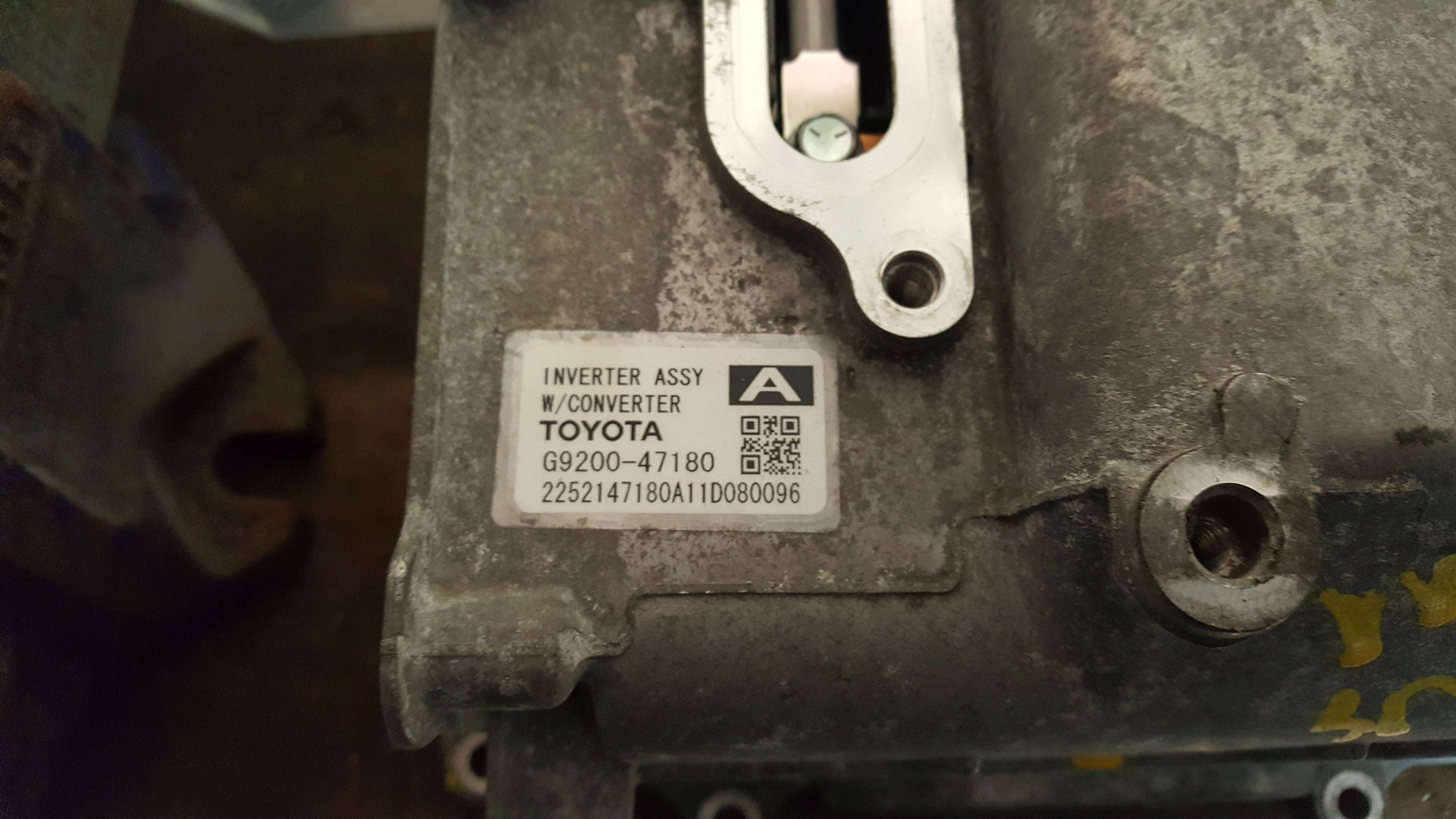

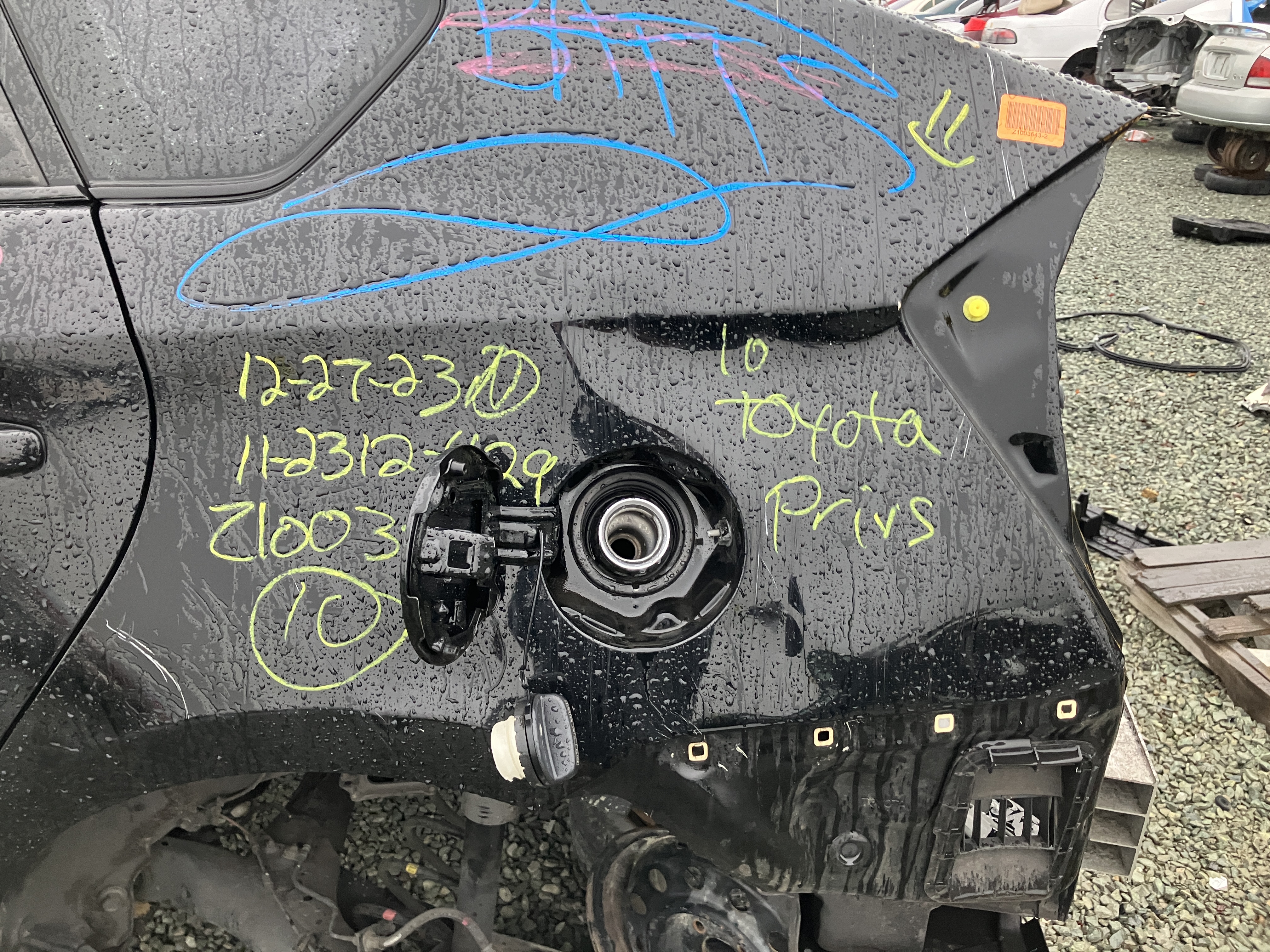

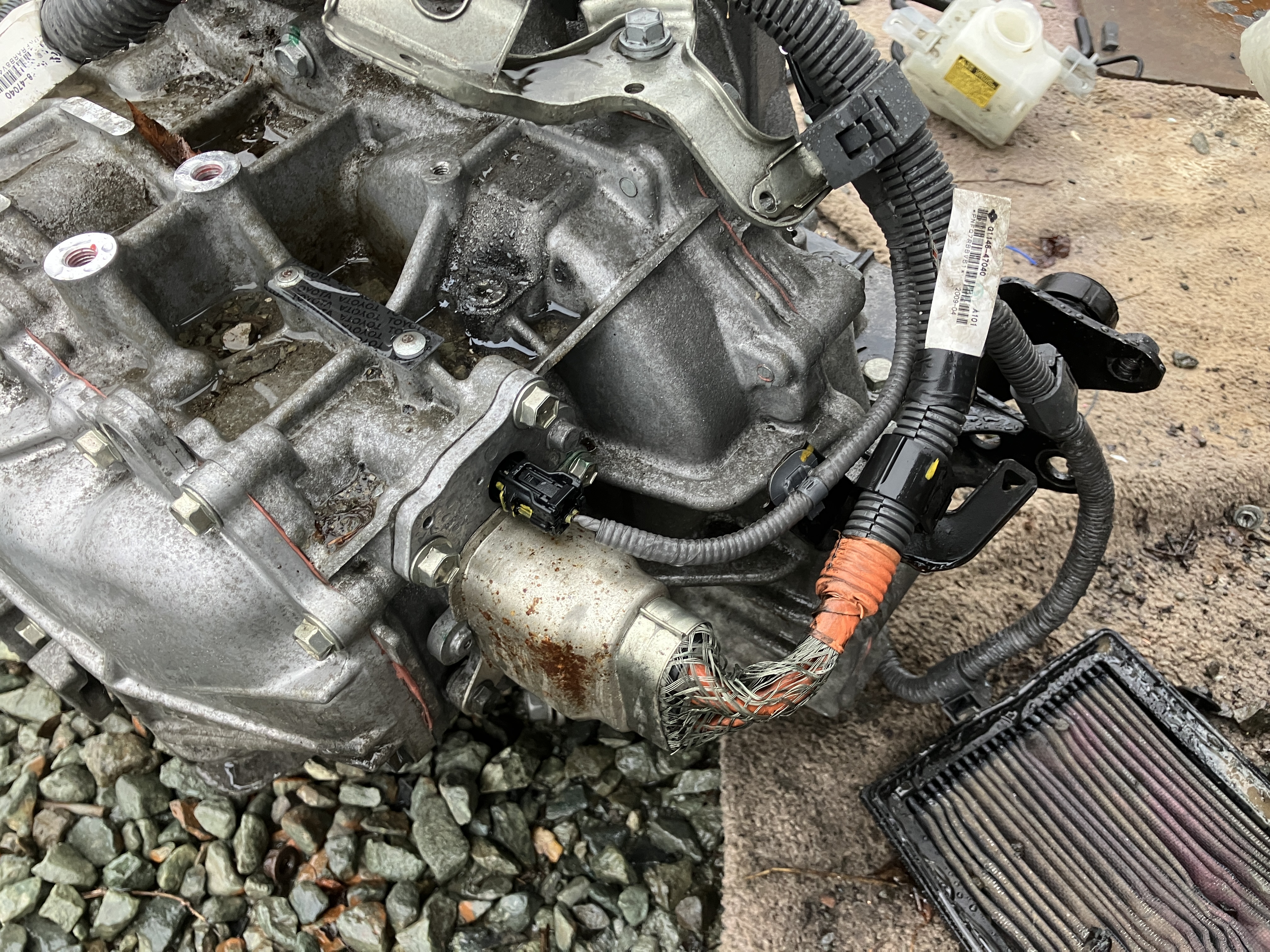

So just some pics from the junkyard where I got the "free range" TransMotor and inverter from a 2010 Toyota Prius aka Third Gen
2010 Toyota Prius Gen 3, Inverter Part # G9200-47140

well done greg, getting the bits with the leftover bit of harnesses will save you quite a bit, its surprising how quickly the cost of those damn little plugs start to add up, plus the time taken for trying to find the Chinese knockoffs.
For the shielded HV cables for the motors, if don't get luckly grabbing one from the junk yard at reasonable cost, you can buy welding cable and put braid around it and then put heat shrink wrap over it (and finally orangish conduit).. got some pics from mine here

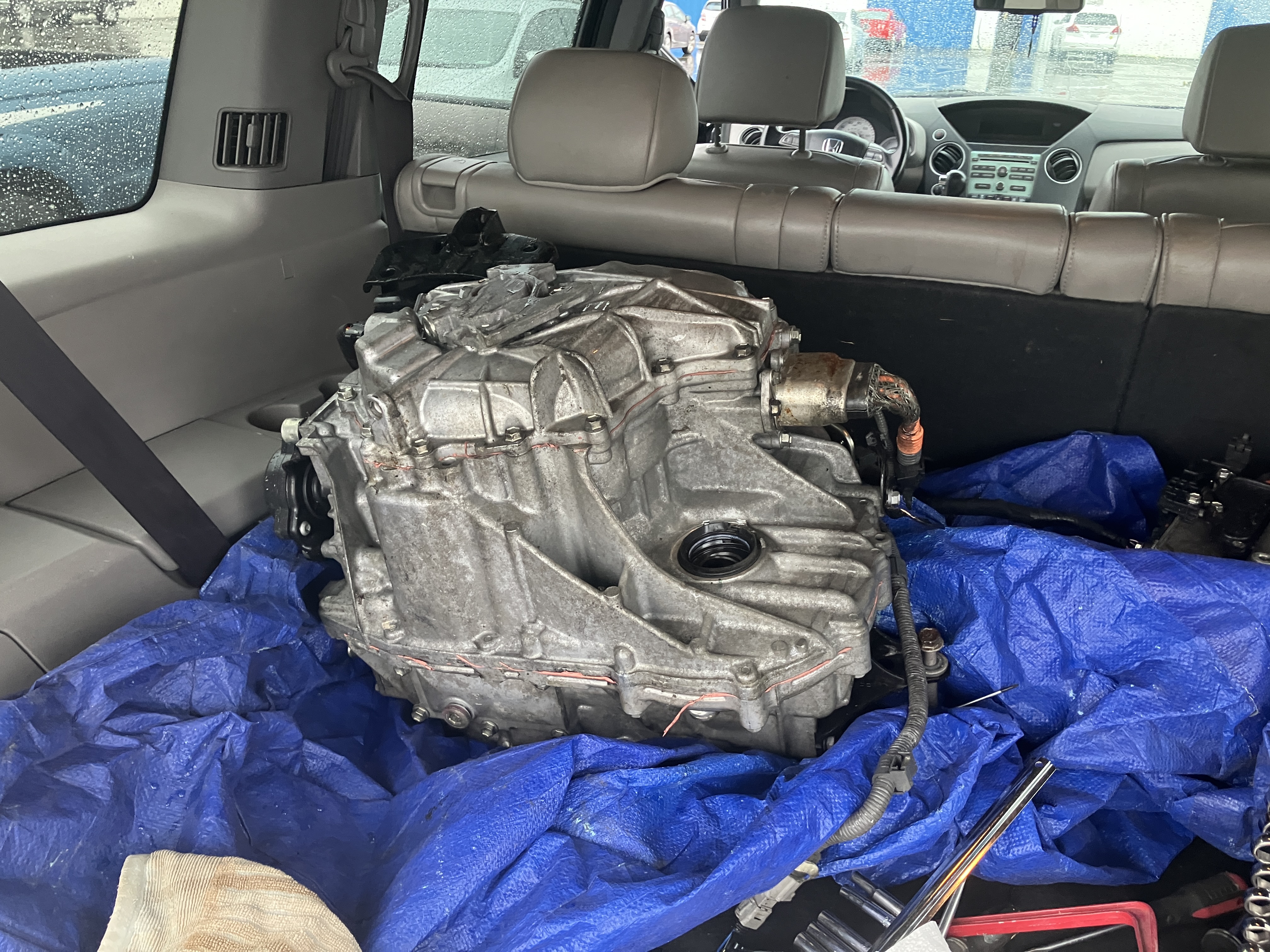

I wanted to transport these wet and dirty bits in my electric GMC pickup truck, but the wife insisted I use her recently detailed 2010 Honda Pilot:
The Transmission Transporter 3000

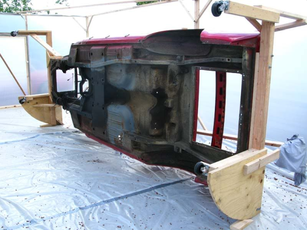

Mini Update: Star Roof, Floors, Headliner, and more Rust

Re: 1984 Voltswagen Rabbit Prius Gen 3
Sacred Rule:
Never do a restoration and a conversion at the same time.
Source: Everyone who warned me 5 years ago.
Source2: Me, 5 years into a "summer project"
Aww jeez. Holes in the floor are okay. Holes in the roof, or borderline not having a roof, a lot harder.
With pitting that bad, I'm sure you're going to find that that the amount of holes that are ACTUALLY there but hidden by structural rust is 10x the amount you currently see.
Just brainstorming:
Option 1 - Replace the whole roof. Not actually that difficult if you can find one. It's only connected at the pillars.
Option 2 - Cut out rusted section and replace. A lot more welding and it'll always look shitty.
Option 3 - Lie to yourself that you can fix this without fixing it. Cheapo rust converter that will do nothing, or splurge on POR15 ("Paint Over Rust") to encapsulate it in a ceramic coating thinking that you spend extra on a bad solution it makes it an okay solution. Bondo from the top after. Repaint it. Wait a few months and discover it's all falling apart and paint is flaking because you lied to yourself that you can fix it without fixing it.

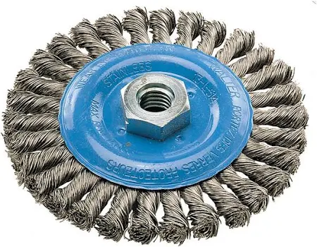

Option 4 - You gotta get that rust off there and find out what it's actually got first. Aggressive wirewheeling, not that makeup remover you've got on there now.
Or ideally sandblasting. Upside down. That sounds like fun. But at least it's possible without flipping the car.
Once you actually get all the rust out, maybe POR15 (or skip it if it looks like you really did get it all) and bondo from under and paint from top.
Option 5 - Flip the car over, saran wrap the outside roof and hold it there with magnets, dump EvapoRust on it and like green fly maggots it'll only eat the rotten flesh. You should have a gallon of Evaporust anyways, you can re-use it almost endlessly. You might get away with using the gel and not flipping the car, but, gravity really needs to be your friend.
I wouldn't be too intimidated by replacing the floors. Your welding can suck, no one will see it. It'll be hidden by carpets.
Just brainstorming:
