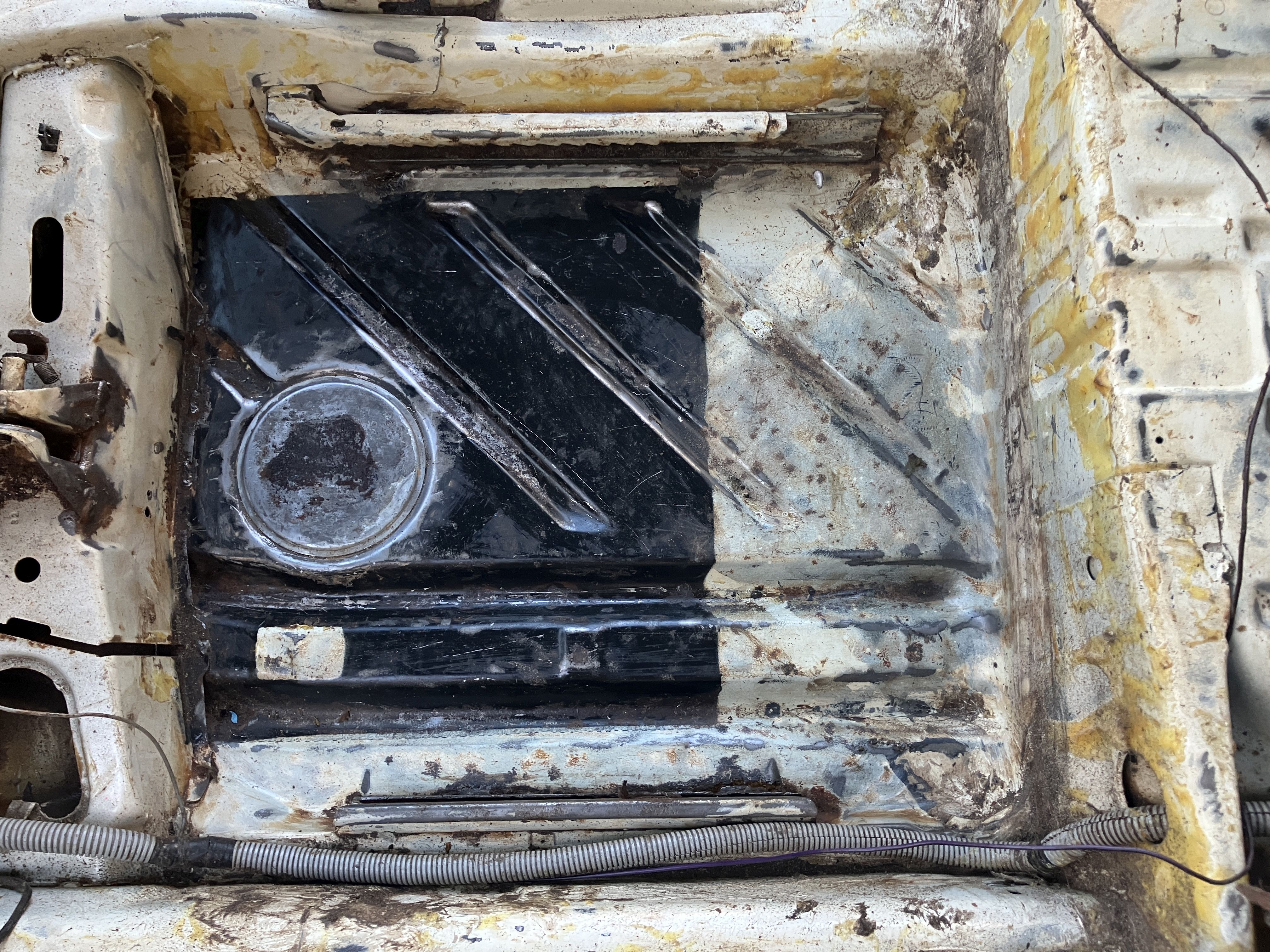

Re: 1984 Voltswagen Rabbit Prius Gen 3
Post by Gregski »

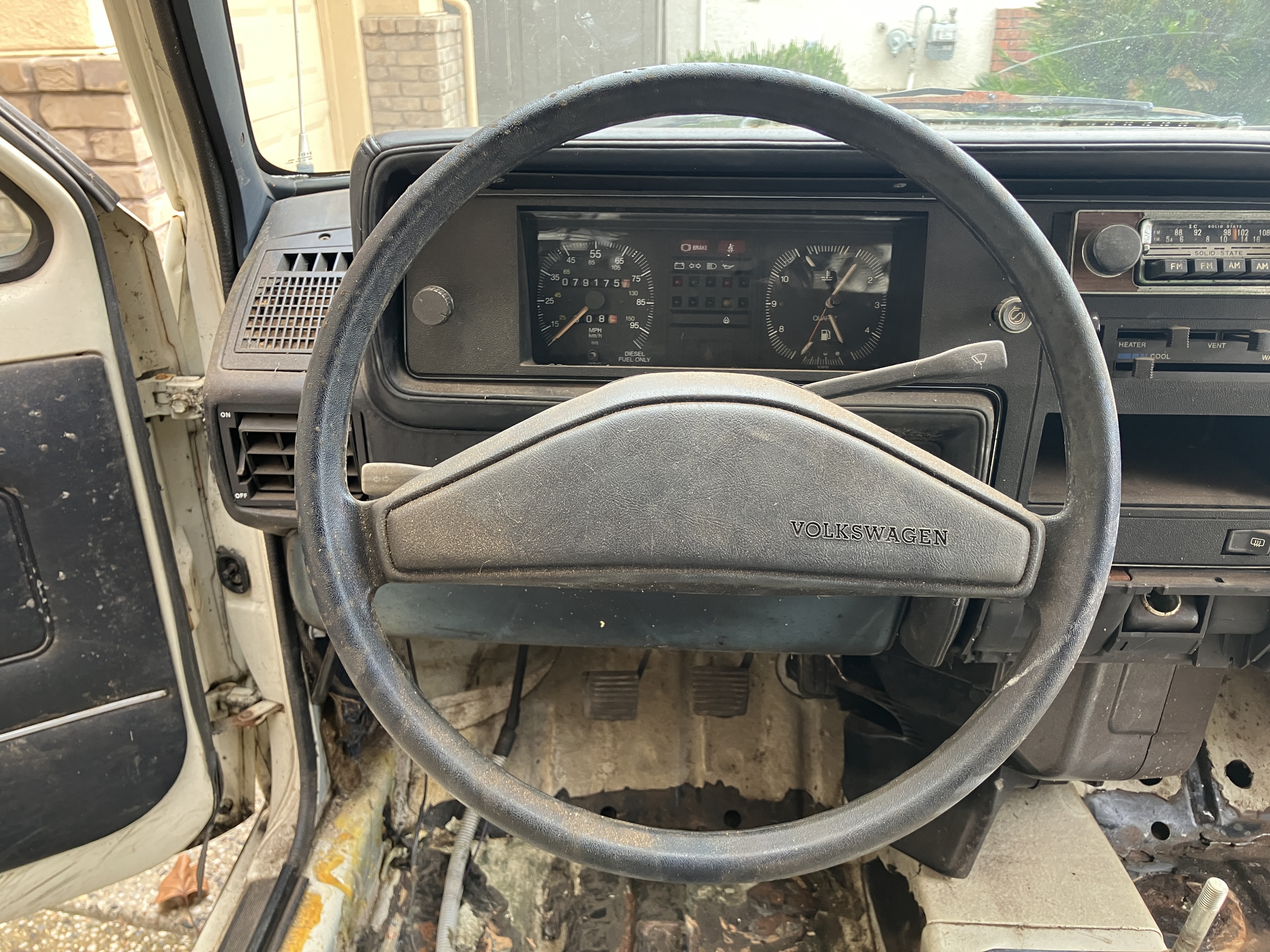

so managed to get the pie crust off of the good side, the passenger floor behind the driver (US edition)
BEFOREski
AFTERski

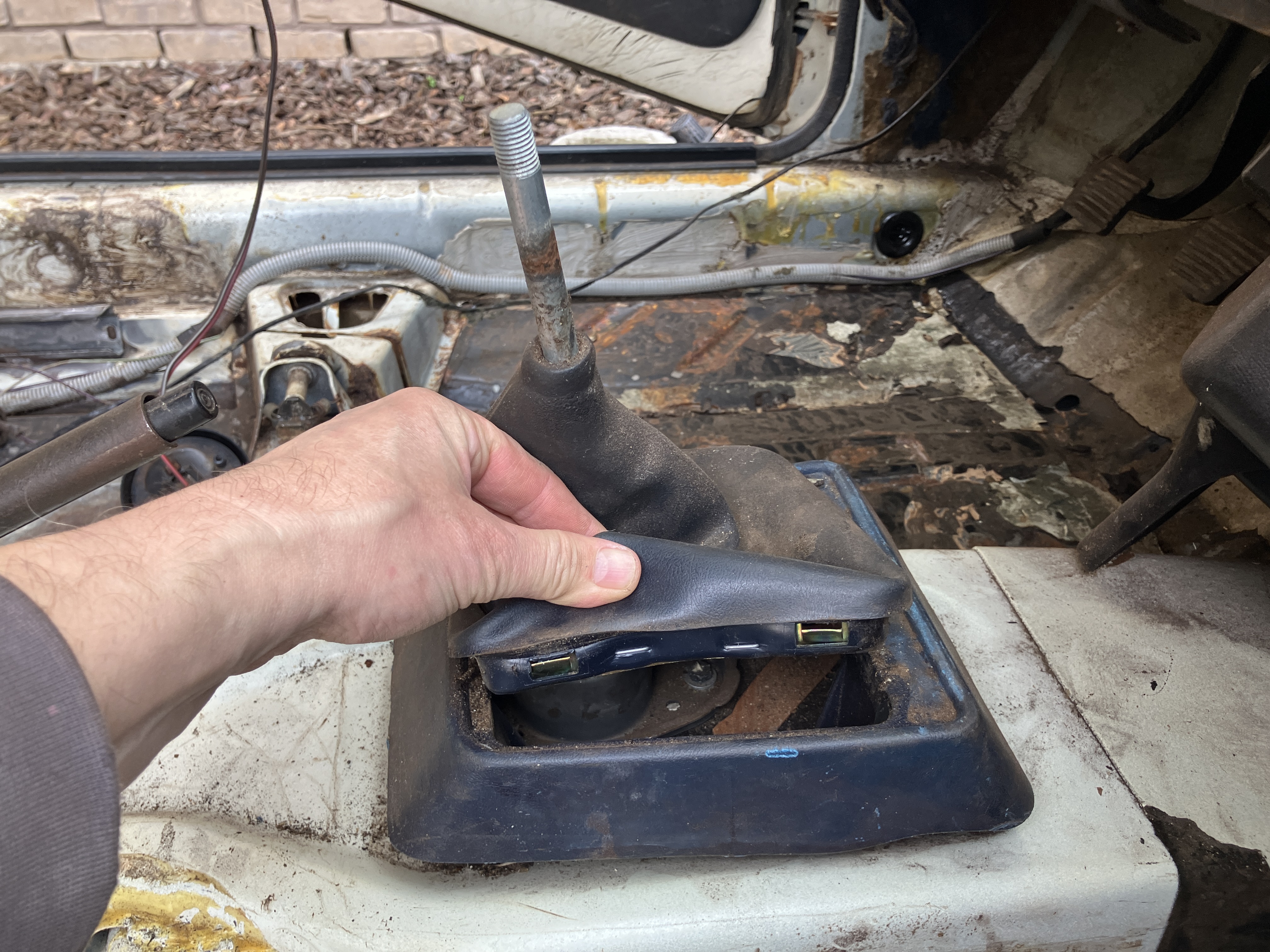

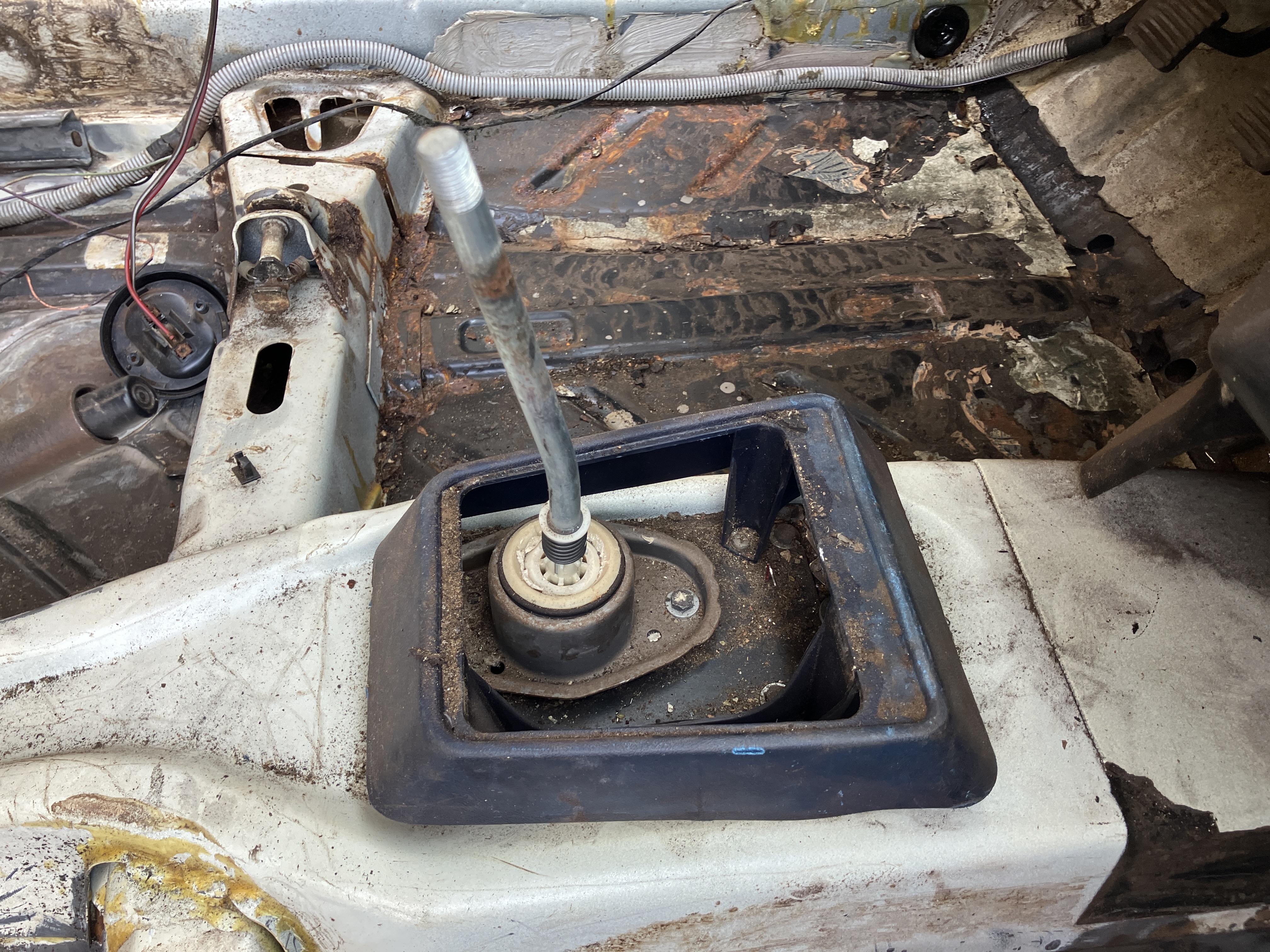

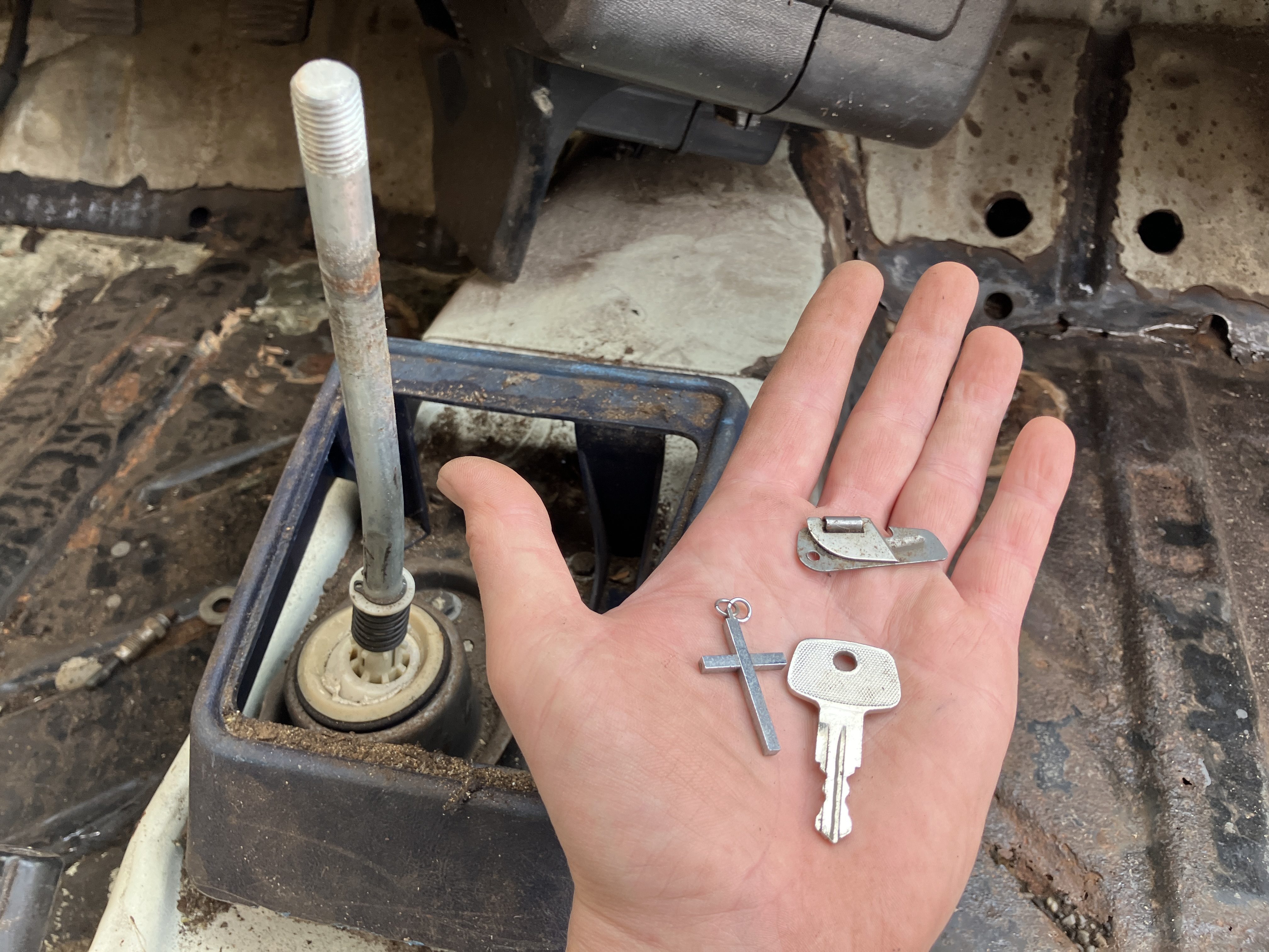

getting the shifter boot off [if you don't know what you are doing, is the equivalent of a German Rubik cube] naturally this needs to be deleted since the 3rd Gen Prius does not use a wiggler for changing gears! So how the hell are we gonna shift from Drive to Reverse and what not?

$38 bucks to the first person to tell me what that thing on top of the cross and key is?
uhi22
Posts: 1244
Location: Ingolstadt/Germany
Has thanked: 245 times
Been thanked: 684 times
Post by uhi22 »
A can opener. No, not CANopen. The things with the beans.

uhi22 wrote: Mon Jan 29, 2024 5:52 pm A can opener. No, not CANopen. The things with the beans.
ha ha, maybe OpenCAN, I luv that, and yes it is a can opener, but what is it actually called ?

Hm, if it would have been flying around in the boot of a German VW, it just would be a Dosenöffner. But in your case, no clue :-)
Posts: 1083
Has thanked: 479 times
Been thanked: 311 times
Post by MattsAwesomeStuff »
Gregski wrote: Mon Jan 29, 2024 7:53 pm ha ha, maybe OpenCAN, I luv that, and yes it is a can opener, but what is it actually called ?
It's a P-38.
(Oh, LOL, hence the hint that $38 to the person who identifies the P-38).

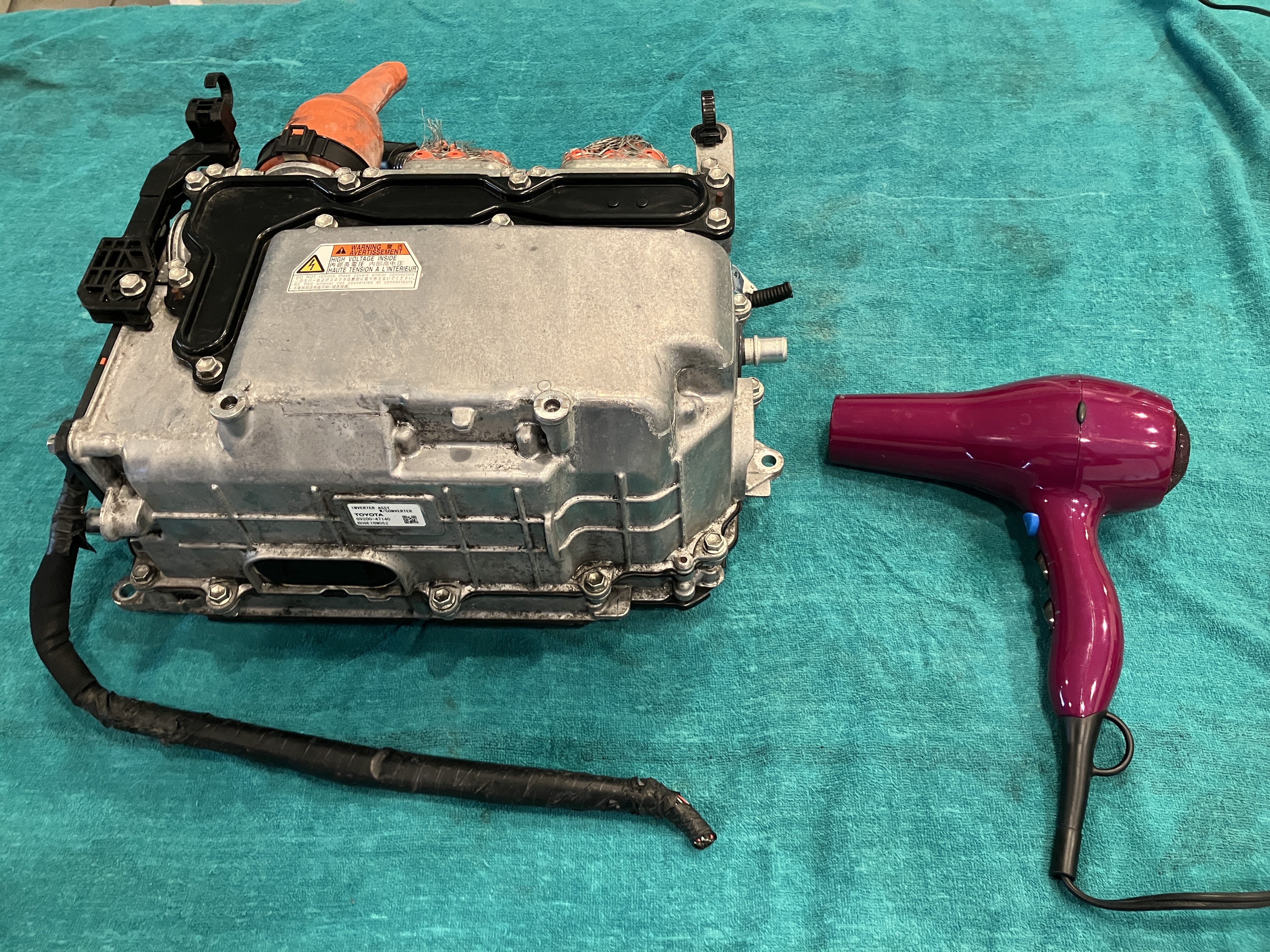

Post by Gregski »
just sum fun pics from the Inverter cook out video

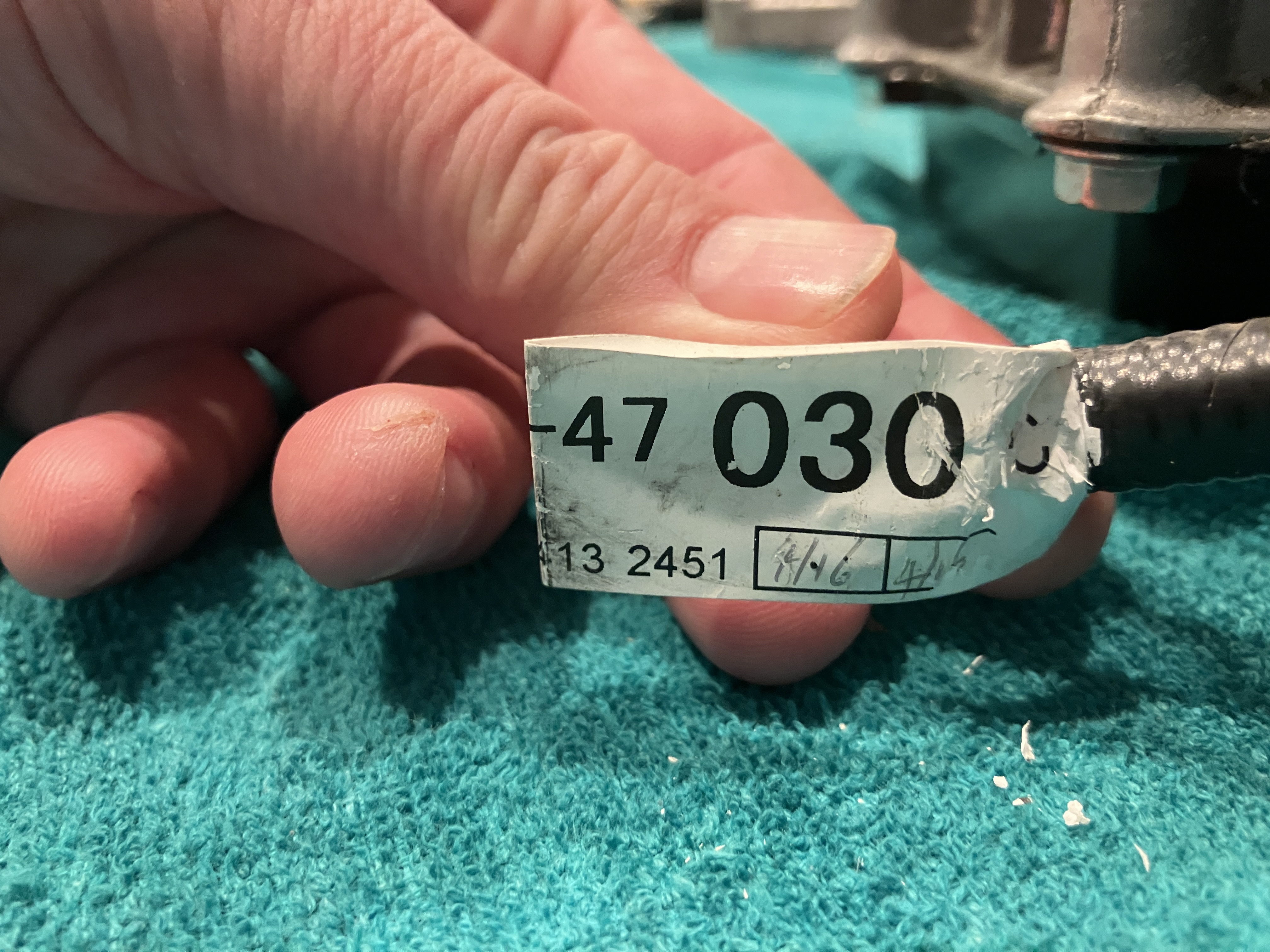

Well, let's learn something:
it appears the stubby DC-DC Converter to fuse block wire/cable has a part number on it: 82112-47 030
well that's super helpful, they are calling it "WIRE, ENGINE ROOM, N. WIRING." sure, ok

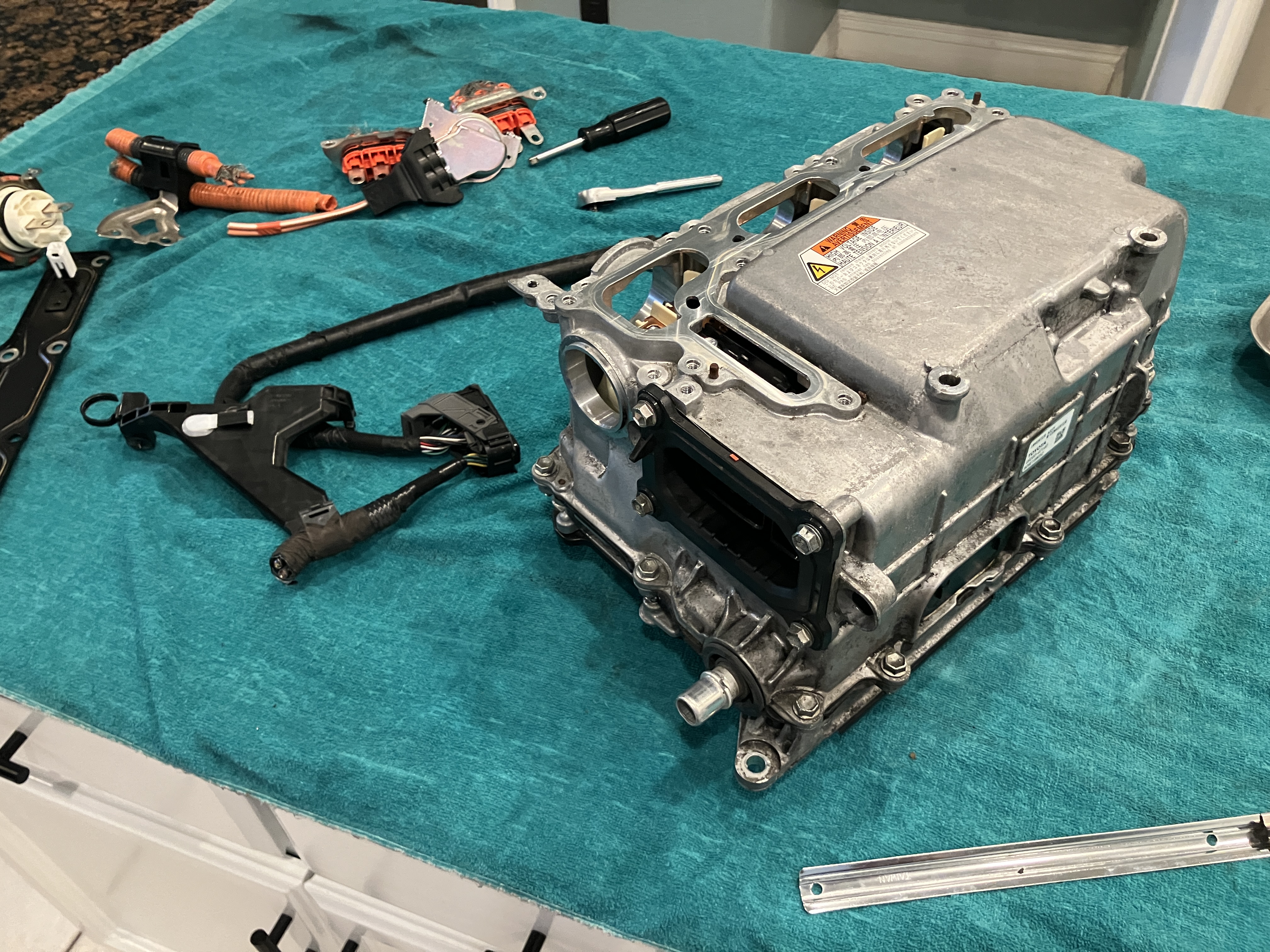

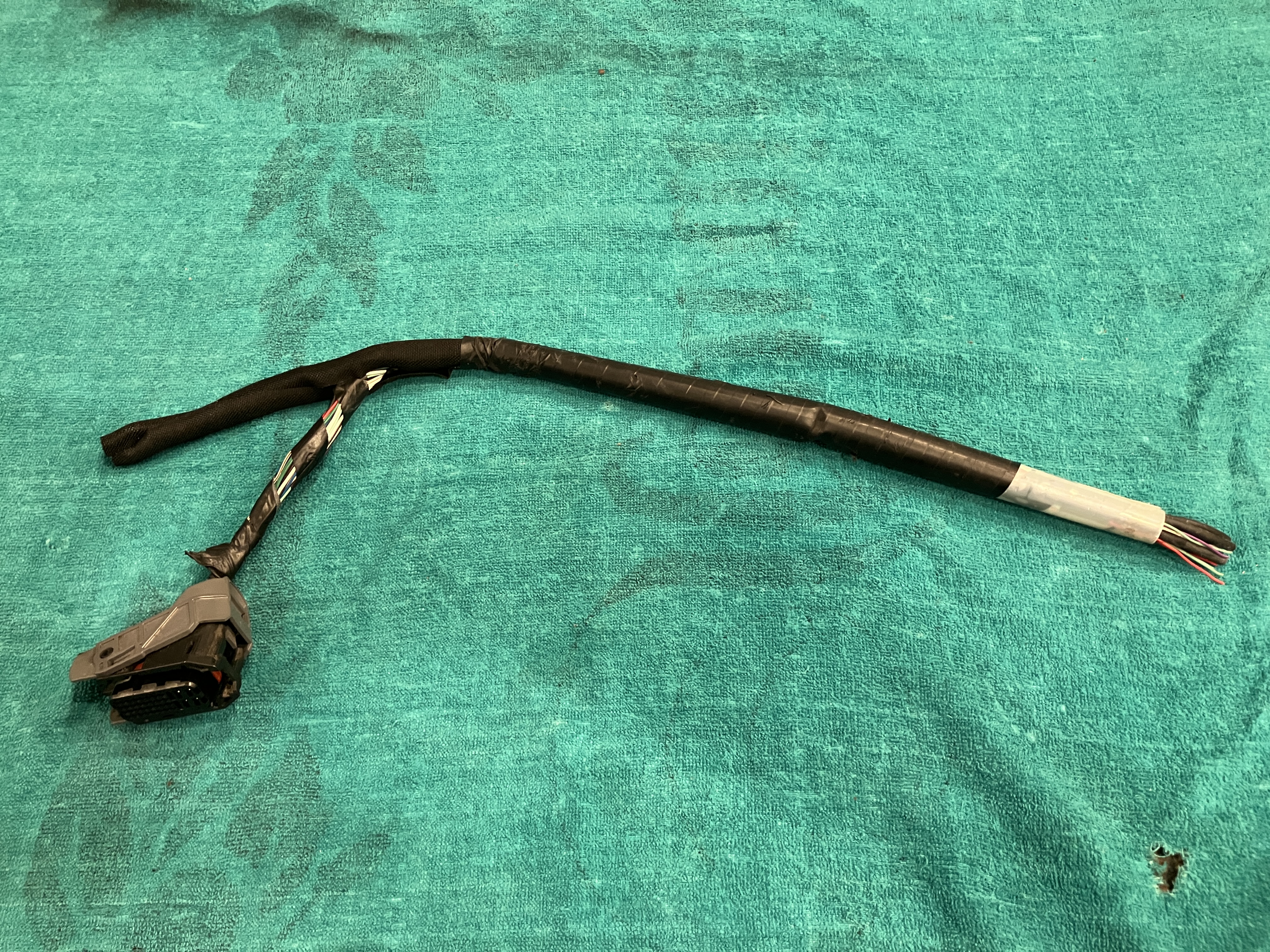

so then I went after the still to be identified "Inverter Wire Harness" the rectangular plug appears to have two separate plugs in it
