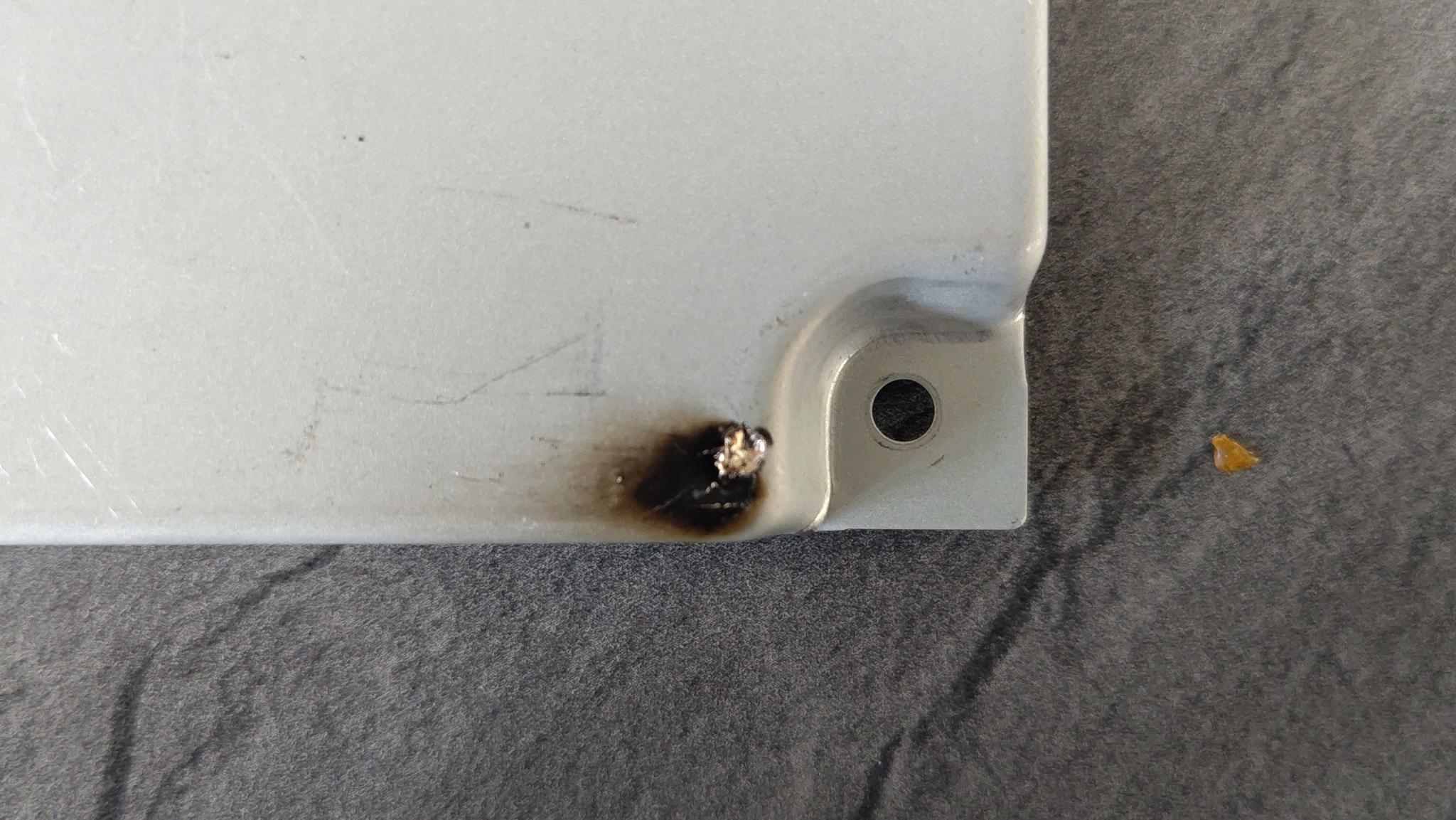

I visited Thomas yesterday and we worked on the various issues.
The most pressing one was GFCI or breaker trips when charging. Turned out the metal casing of the BMS made intermittent contact with one of the battery poles! Very noticeable burn marks. We swapped the metal LBC cover for the plastic one and added more layers of duct tape.
Thomas made a little ESP gadget that displays some data:
He also had power cutouts in the past, we will have to see if that is also fixed now. We did a 100 km test drive and all was fine.
Posts: 6735
Has thanked: 379 times
Been thanked: 1560 times
Re: [DRIVING] Audi A2 /w Prius Gen2 Transaxle & Inverter
And here are the burn marks
