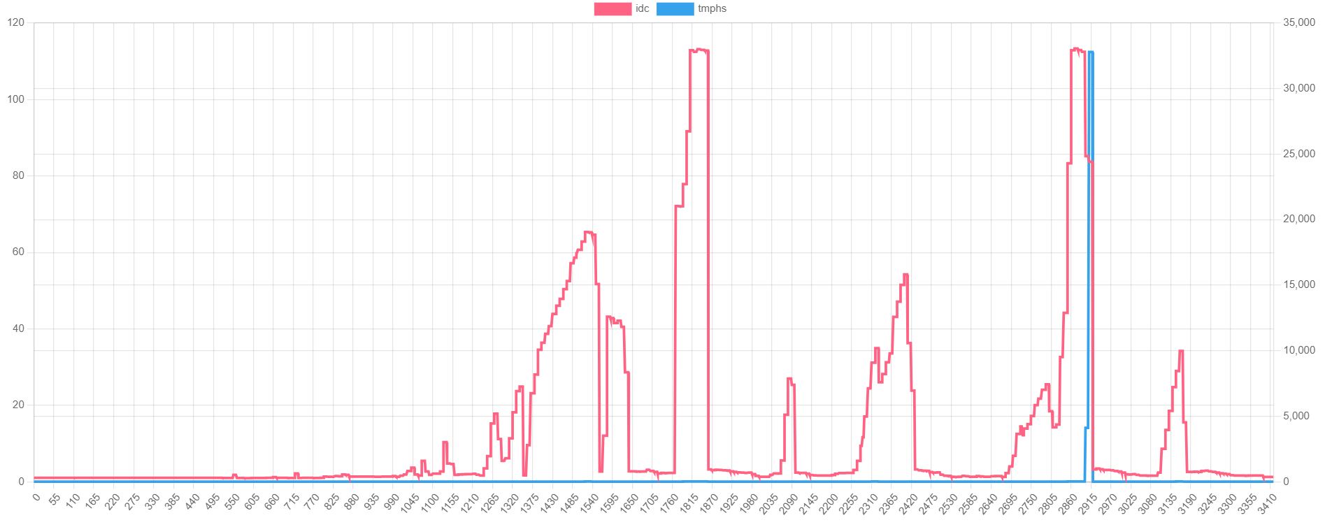

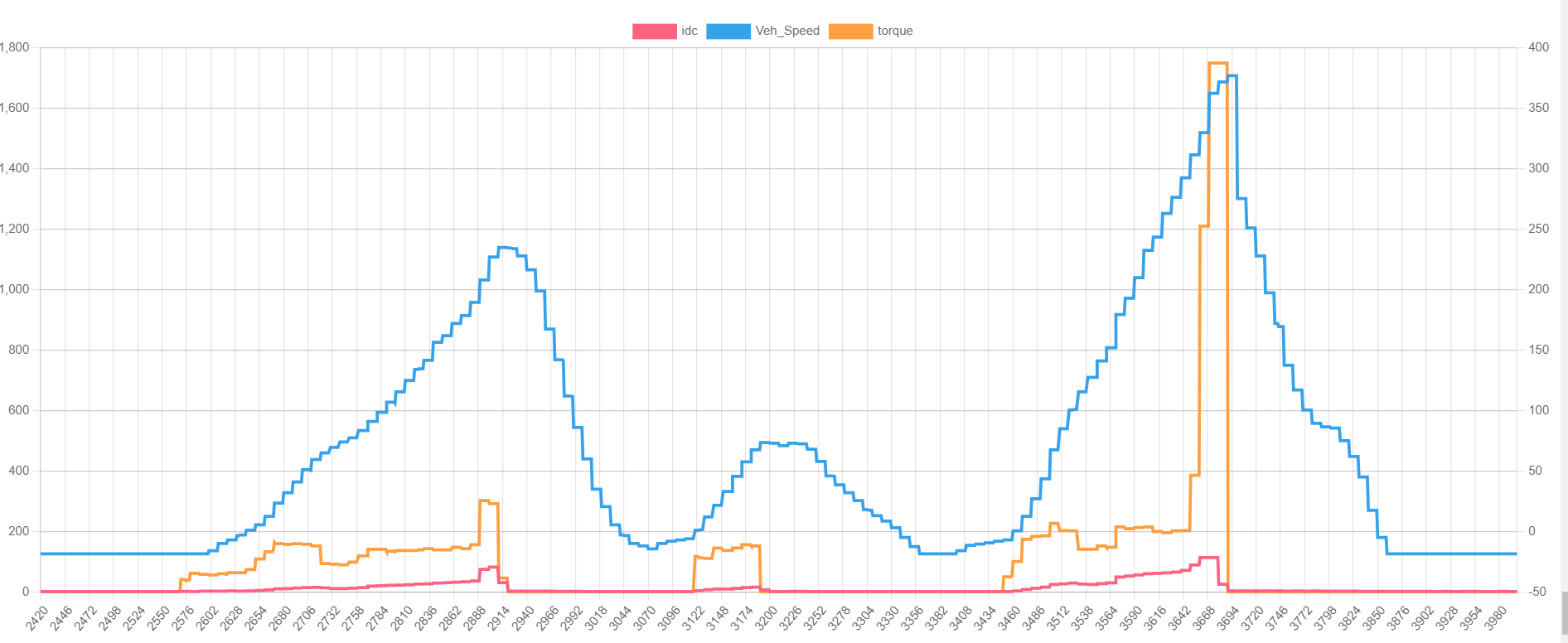

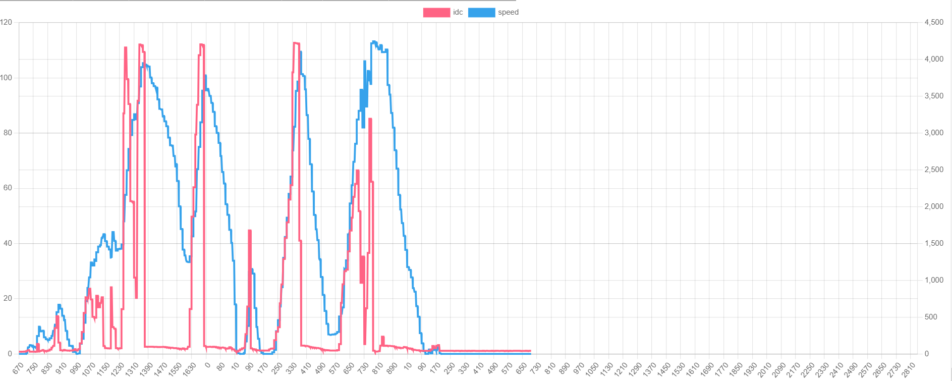

It stopped raining for about an hour so I installed the new Bin from Jamie and ..........it's exactly the same except no hi temp fault
I have also noticed that power cuts (it comes in like an old school rev limiter really hard) more often than the temperature spikes and idc tops out at just over 110 Amps which ties in with the cutouts so maybe this is an internal cutout in the inverter hardware.
The first graph is from a few days ago and you can see the Current never exceeds 110A

Re: [WIP] BMW Z3
The gaffa on discord says "he needs to plot torque also to see if its zom or the inverter commanding the cut
and see what his revlim is set to"

Re: [WIP] BMW Z3
I did plot it against torque but didnt save it as the scaling I had made it too small so deleted it and didn't try again as it was pissing down
I can always do it tomorrow

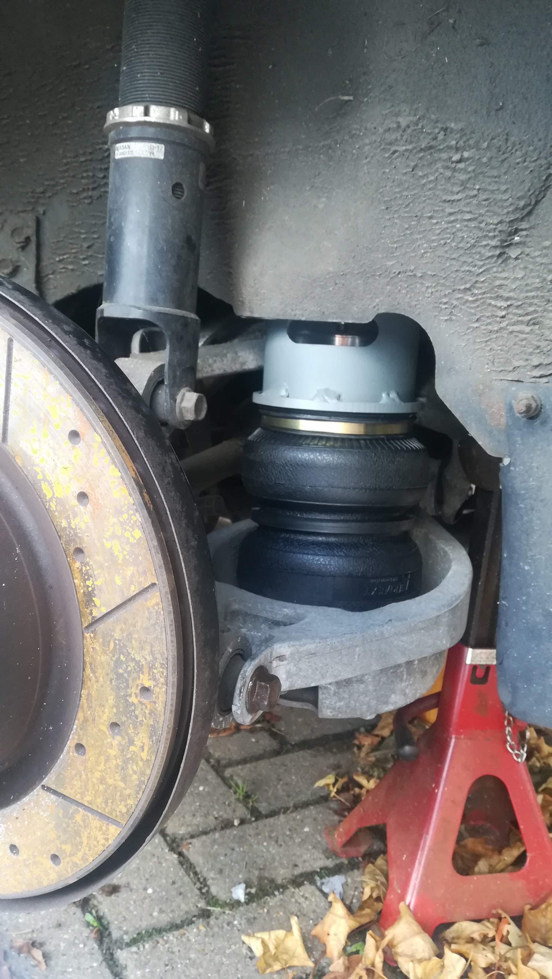

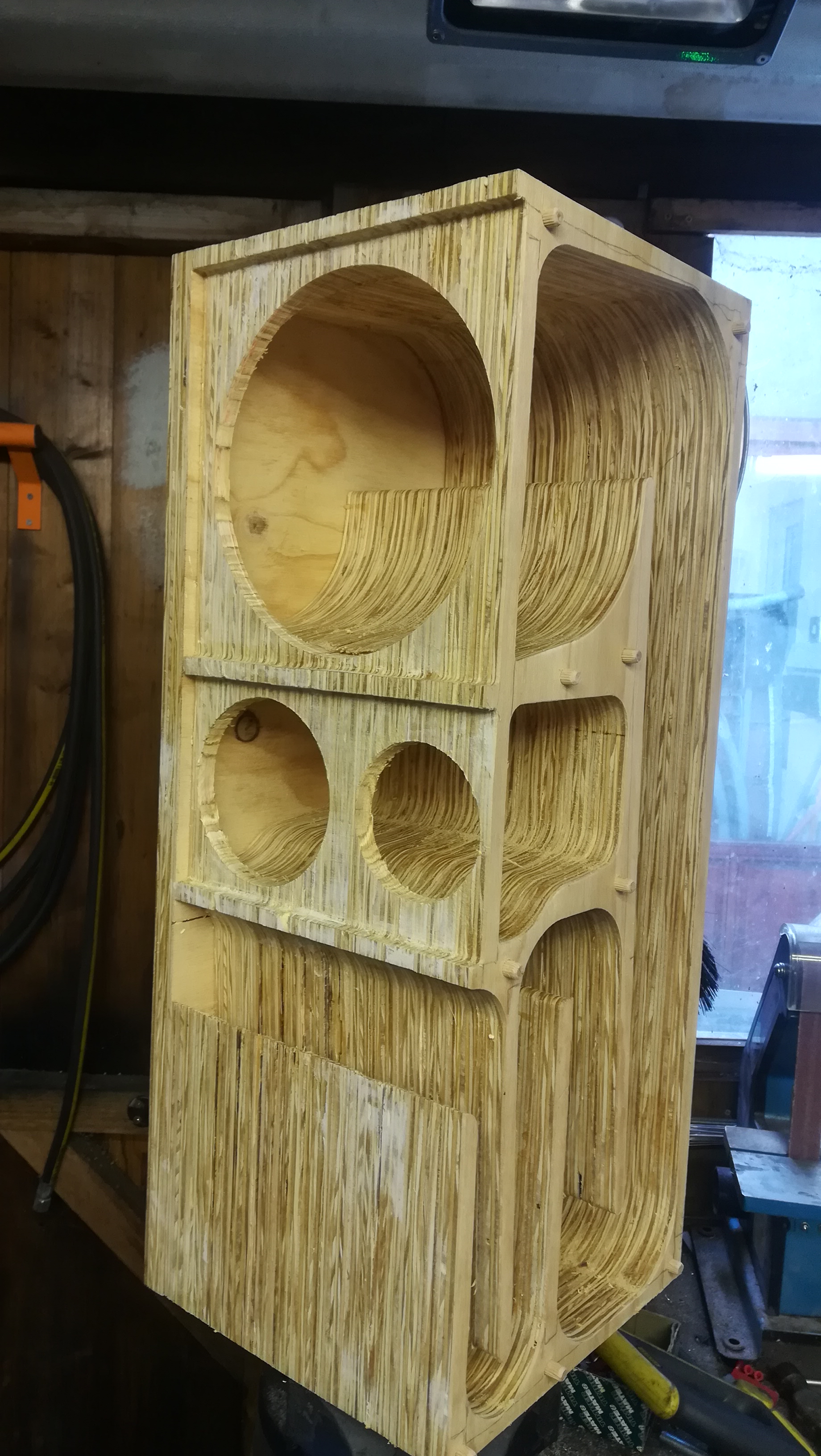

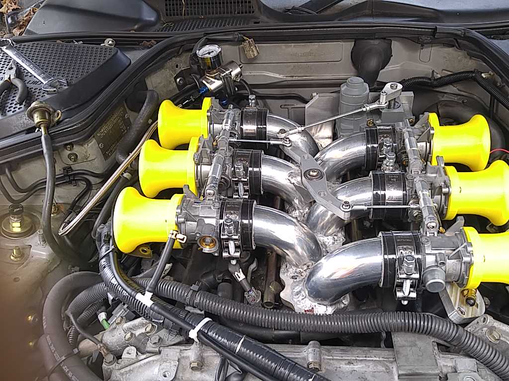

So I just wanted to clear a few things up around my understanding of things in general I was always taking things apart as a kid, I got an electronics kit in the 70's and have done various electrical/electronic maintenance/repair jobs but never any formal qualification as having dysgraphia was not recognised in schools in the 70's and 80's one teacher actually told my parents that I was just a bit thick so all self taught and so I have many gaps in my understanding.
my programming journey started with programming basic on a zx80 in 1980 and probably stopped mid 80's when I got heavily into cars and only started again when I decided to build an air ride setup on my 350Z in 2018 and got into arduino's to make that happen and programming within the arduino IDE is all I know so please bear with me.
The mechanical and fabrication side is also self taught or comes from my Dad who was a mechanical engineer and fabricator, my 20 years in the wastewater industry and 10 years weapons testing has given me a good understanding of how to build things to withstand extreme mechanical stresses
my interests are eclectic to say the least but generally involve making things from scratch here's a little preview
my first engine conversion Rover V8 into Ford Capri 350Z air ride Top mounting started off as a fire extinguisher in fact I was accused of ghetto rigging Individual throttle bodies on my 350Z rearmount turbo 350Z it's not all car stuff
cnc cut speaker enclosure sounded amazing So anyway my point is I'm a jack of all trades and pretty good at some of them but definitely master of none so if I do stuff that seems to be strange or an odd way to go about doing something it's because I'm winging it and making it up as I go along.

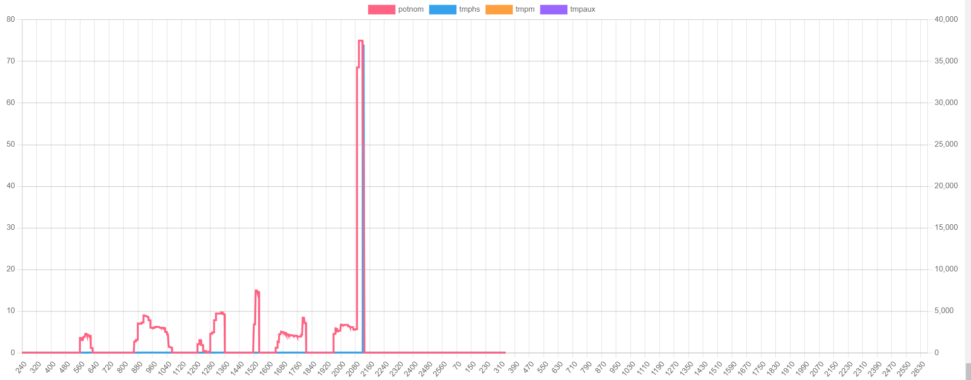

Re: [WIP] BMW Z3
So that's Zombie cutting, now to workout why.
*EDIT*
ok so the only things that can command a torque cut are : motor rpm, hs temp, motor temp, battery undervoltage, idcmax
Plot these to see if they're sane, and post your params?
Gaffa says he's happy to have a phonecall with you to debug if it'll help.
*EDIT*

Re: [WIP] BMW Z3
I know idc max is set at 300 and it hasn't gone over 120 and I've had the motor speed at only 1600rpm during one cut but I will check the other stuff tomorrowBigpie wrote: ↑Thu Feb 15, 2024 3:09 pm So that's Zombie cutting, now to workout why.
*EDIT*
as for the phone call with the Gaffa I'll exhaust other possibilities first I don't want to slow down his work but if it would aid him in his own projects I'm more than willing to be a test bed and supply any data he may need

Re: [WIP] BMW Z3
Can you please post the Zombieverter settings .json you currently are running?
As the GS450/IS300h code should be scaling the PotNom to 3500 it seems to not be scaling it alot for some reason.
