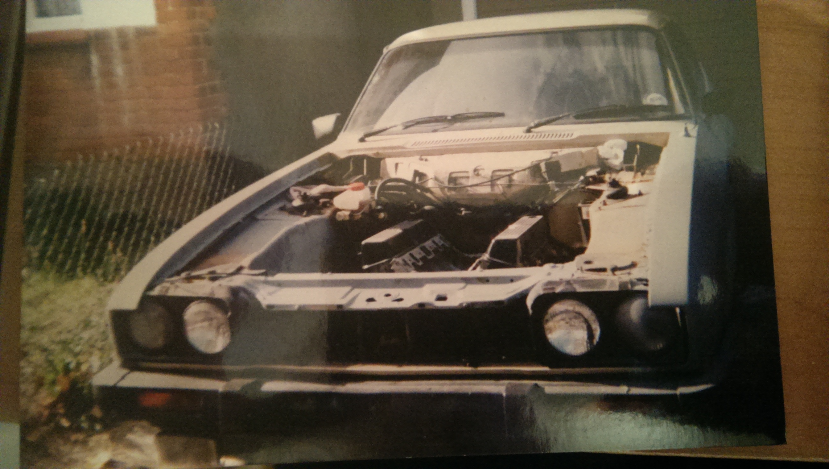

So I just wanted to clear a few things up around my understanding of things in general I was always taking things apart as a kid, I got an electronics kit in the 70's and have done various electrical/electronic maintenance/repair jobs but never any formal qualification as having dysgraphia was not recognised in schools in the 70's and 80's one teacher actually told my parents that I was just a bit thick so all self taught and so I have many gaps in my understanding.
my programming journey started with programming basic on a zx80 in 1980 and probably stopped mid 80's when I got heavily into cars and only started again when I decided to build an air ride setup on my 350Z in 2018 and got into arduino's to make that happen and programming within the arduino IDE is all I know so please bear with me.
The mechanical and fabrication side is also self taught or comes from my Dad who was a mechanical engineer and fabricator, my 20 years in the wastewater industry and 10 years weapons testing has given me a good understanding of how to build things to withstand extreme mechanical stresses
my interests are eclectic to say the least but generally involve making things from scratch here's a little preview
my first engine conversion Rover V8 into Ford Capri
350Z air ride
Top mounting started off as a fire extinguisher in fact I was accused of ghetto rigging
Individual throttle bodies on my 350Z
rearmount turbo 350Z
it's not all car stuff
cnc cut speaker enclosure sounded amazing
So anyway my point is I'm a jack of all trades and pretty good at some of them but definitely master of none so if I do stuff that seems to be strange or an odd way to go about doing something it's because I'm winging it and making it up as I go along.
:lol:
