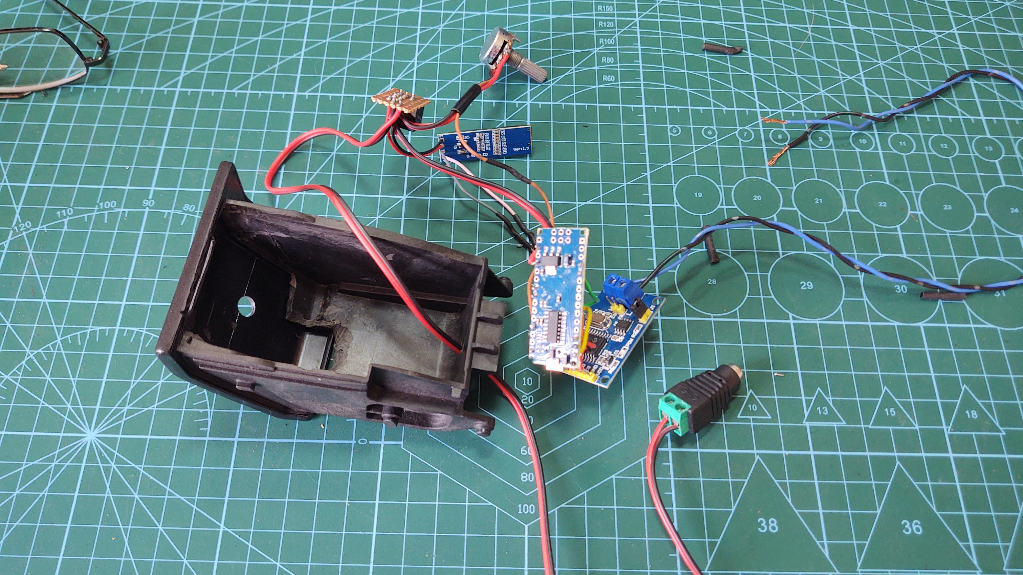

Thanks for this as it tidies things up nicely but to be honest I like the idea of seeing the temp requested and current temp in the display, plus having a pot to adjust the temperature seems like a good idea, even if it is only until I figure out what the ideal temperature is.
I received a couple of displays in the post today and managed to hook one up.
To my amazement I managed to do it right first time and it just works. :D
BTW the green cable is just shorting out the pins in the MCP2515 to enable the CAN network termination. Even with only a single 120R terminating resistor it works fine but I'll ensure both are connected in the final installation.

Alibro
Posts: 986
Location: Northern Ireland
Has thanked: 370 times
Been thanked: 221 times
Re: Mitsubishi Outlander PHEV heater
Post by Alibro »
I used some vero board to make this a bit more robust.
I also added a buck converter to lower the voltage to around 6V as I wasn't sure the Nano would be happy with 14.4V. What are your thoughts on this guys and should I do the same for the Due and Uno in the low voltage junction box?
I'll probably have to cut and splice some of the wiring when installing but wanted to test I hadn't cocked something up first.
marcexec
Posts: 182
Location: Dublin, Ireland
Has thanked: 771 times
Been thanked: 73 times
Post by marcexec »
I'd measure the difference in power draw between buck converter vs direct. In general lower consumption would mean less heat, so more reliable. OTHO you're introducing another point of failure, if it fails open that is.
My Suzuki RF400 build @ES
Honda IMA & Lebowski howto
crasbe
Posts: 296
Location: Germany
Has thanked: 47 times
Been thanked: 150 times
Post by crasbe »
You could simply set the Buck converter to 5V and connect it's output to the +5V pin of the Arduino Nano instead of the VIN pin.
That bypasses the internal LDO completely.
That would be the better strategy anyway, because 6V is right on the edge of the permissible input voltage. The dropout voltage of the LM1117IMPX-5.0 is greater than 1.0V at room temperature.
And no, the LDO wouldn't really love 14.4V input voltage. Even though it might not explode immediately, the tiny package of the LDO on the Arduino Nano is not able to dissipate much heat.
A word of caution in regards to the LM2596 buck converter you have used: They usually come with a faked chip which has a lower efficiency (not really relevant for your case) due to a lower switching frequency. The catch is that sometimes (not always, because you can't predict what the Chinese put on there) the boards come with mismatched capacitors and inductors, resulting in a higher-than-usual output noise. That in turn can lead to unreliable operation, which is less than desirable in an automotive application.
My recommendation are these cute, integrated step-down converters from TRACO (and many other suppliers) like this one: https://www.mouser.de/ProductDetail/TRA ... oeVA%3D%3D
The Mouser link is just an example, idk where to buy stuff in the UK.
Alibro
Posts: 986
Post by Alibro »
Sorry guys I somehow managed to unsubscribe from the topic and missed your replies.
So the consensus is Arduino's don't like 14.4V and cheap Chinese buck converters may not be reliable. I'm not surprised at the answers so will follow your advice and come up with a better solution.

Here is a quick update of the heater situation now I have it installed.
It works! :D
The longer version includes a minor disaster and a change in design.
While testing I managed to drop some solder on the board while it was running. This caused the operation to be somewhat sub-optimal so after first replacing the MCP2515 I then had to replace the Arduino and of course it was no longer soldered to the vero board.
Originally I had planned to mount the board under the bonnet and feed wires through to the dash but while staring at the new pile of wires I had an idea.
OK so neat it isn't but this was more a proof of concept than a final installation. In order to tweak the code I will need to remove the Arduino as I didn't give myself enough room to plug in a cable but that can wait a bit. I have plenty of other things to work at in the meantime.
Jamie/TurboPete's code works great however in my application I might need to adjust the temperature difference before the heater switches to half power. It looks like it switches to half power while around 10°C below requested temp. This means if I request 55°C it only gets to around 50°C which is not quite enough. I find myself turning it up to 61 or 62°C to get the desired 55°C.
I assume this will change as we get into late Spring so for now I am keeping the adjustment and code as is. I have a second ash tray that I can use if I decide to use Arber333's code without a POT.
