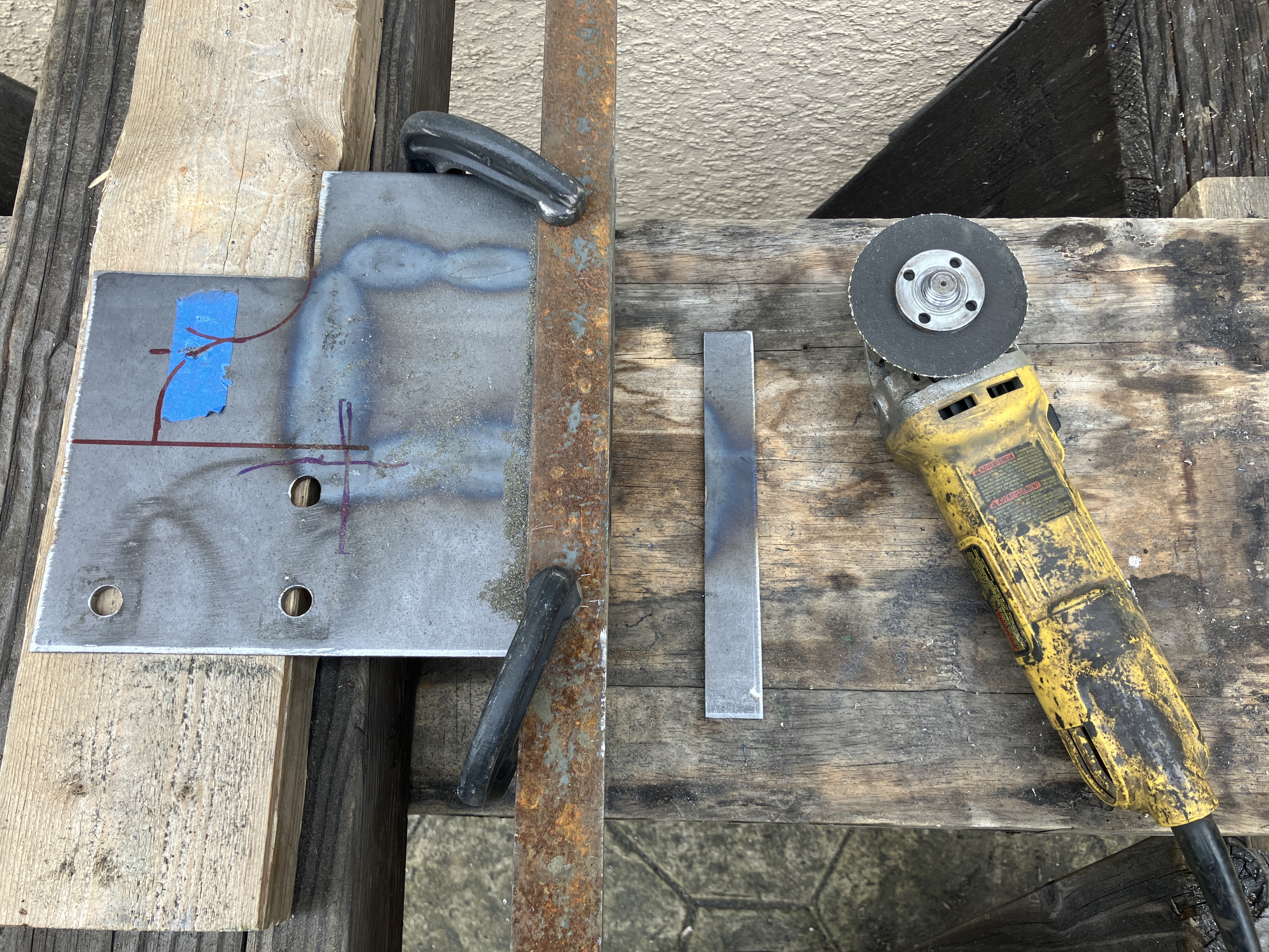

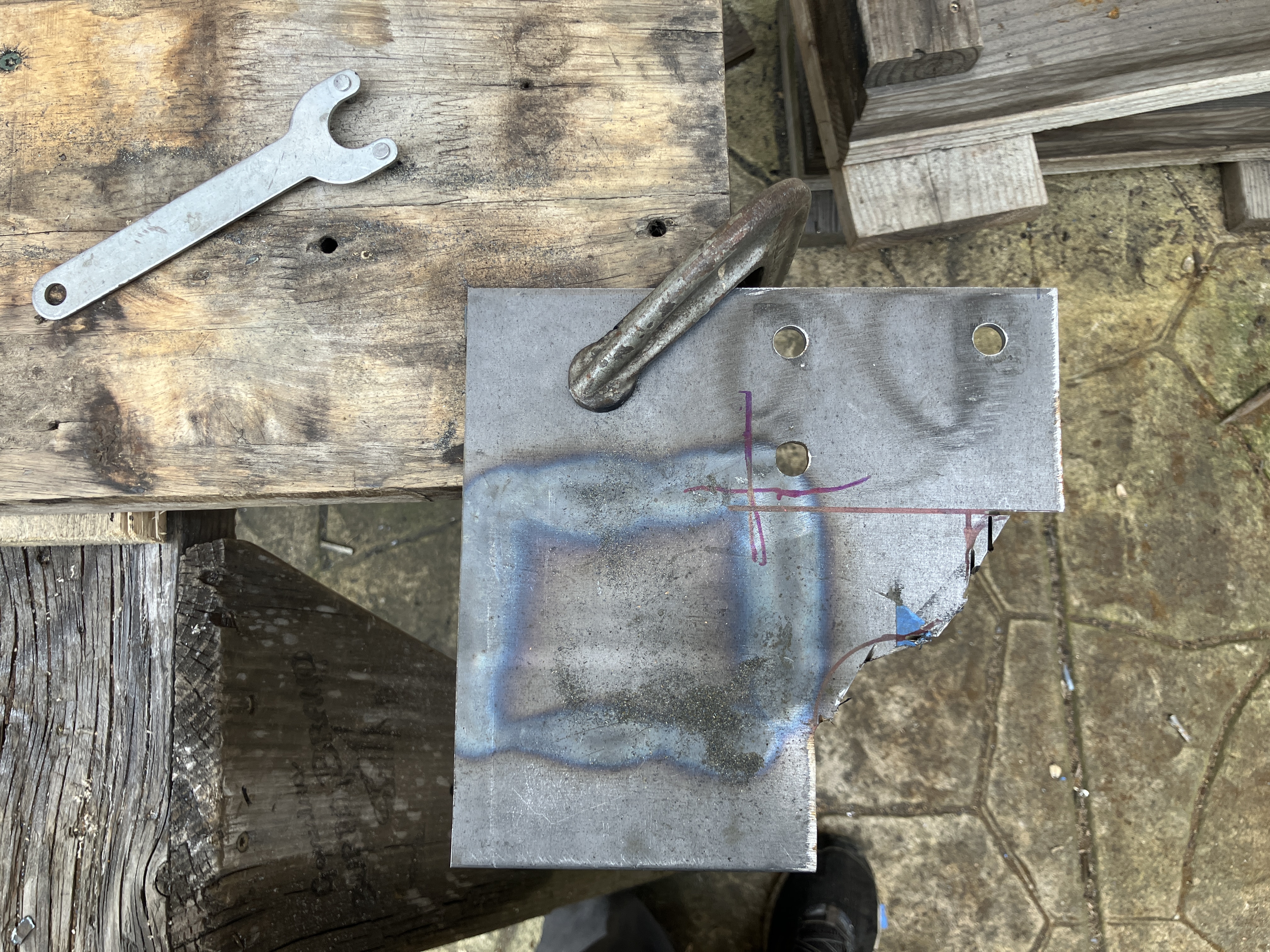

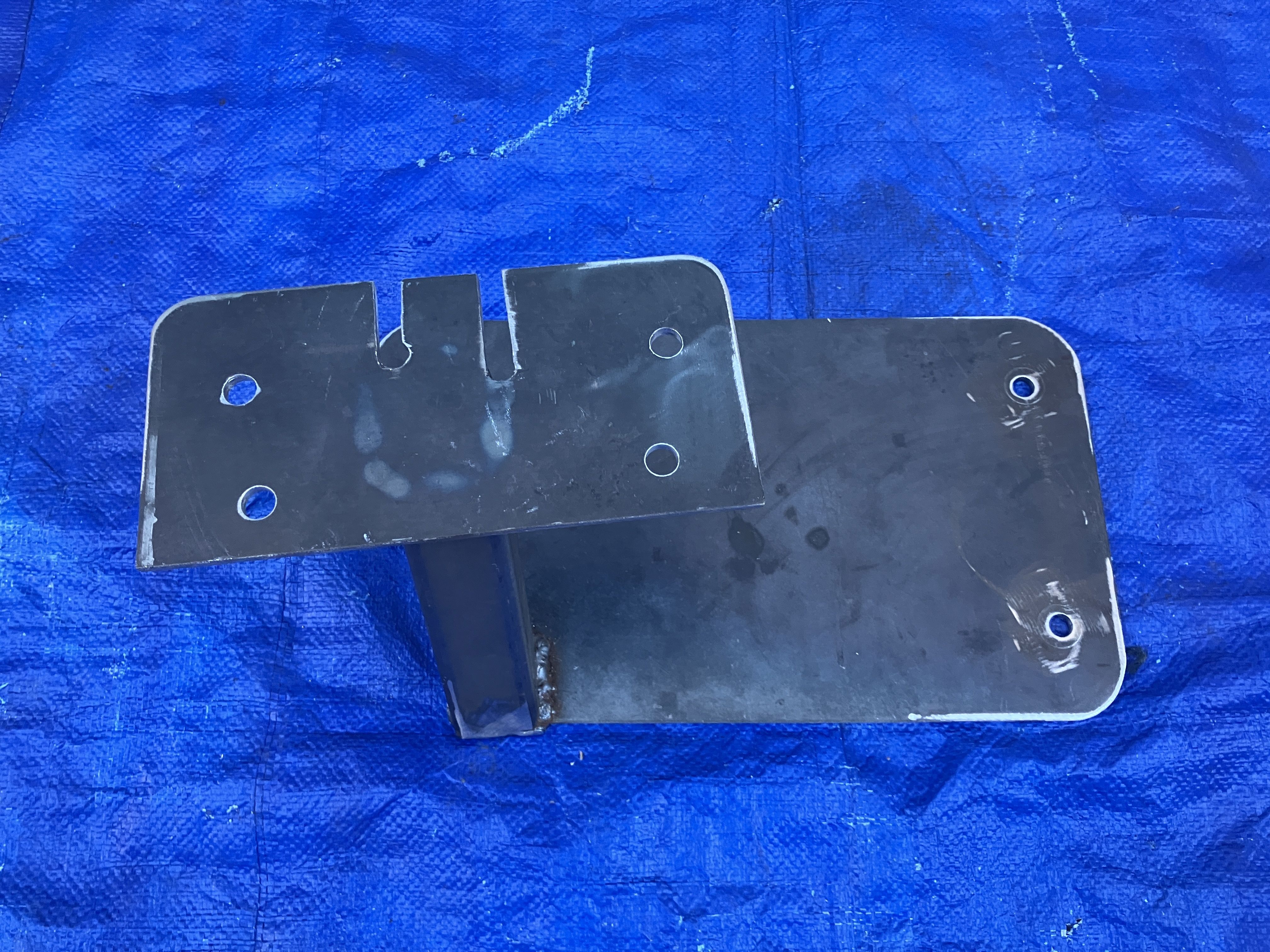

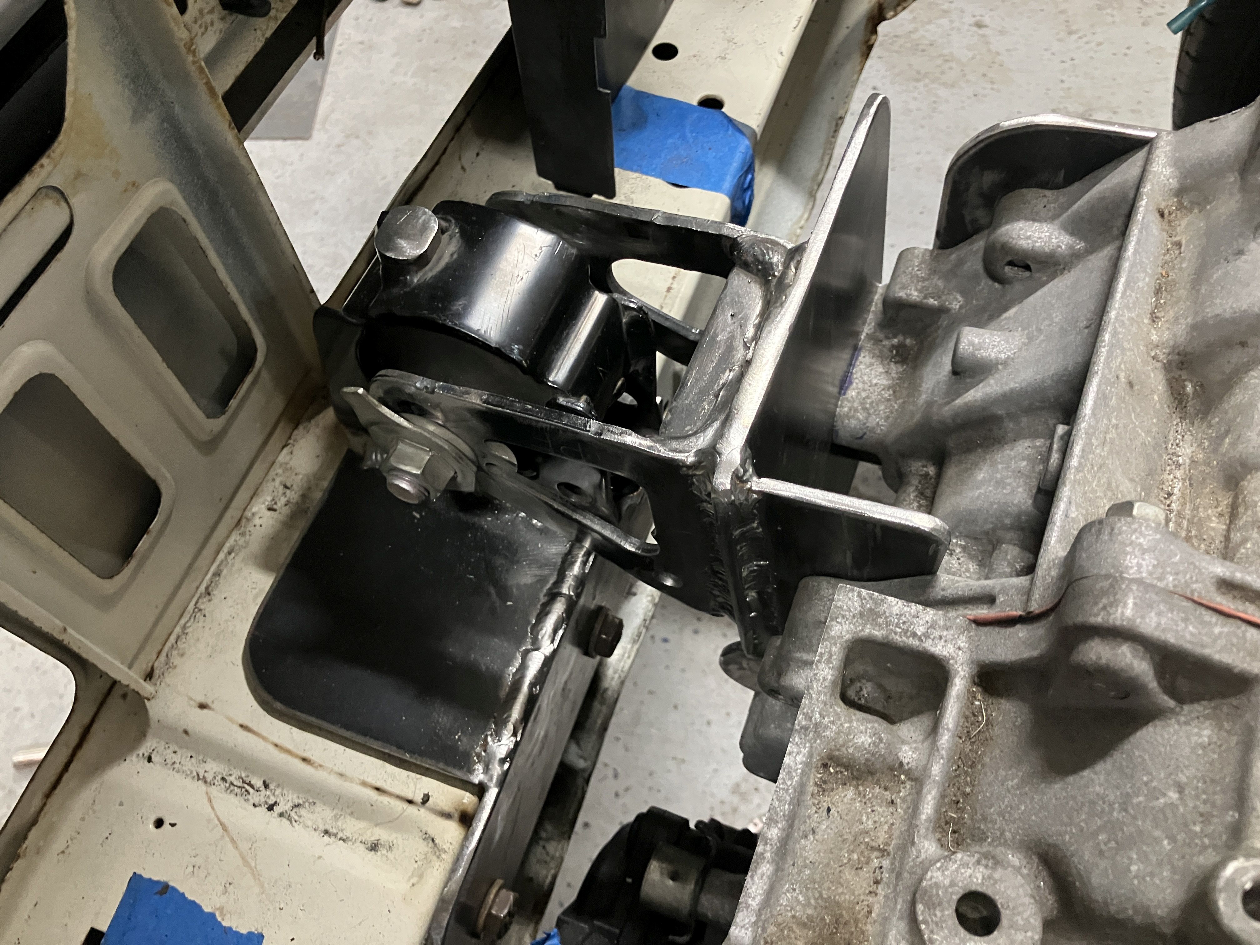

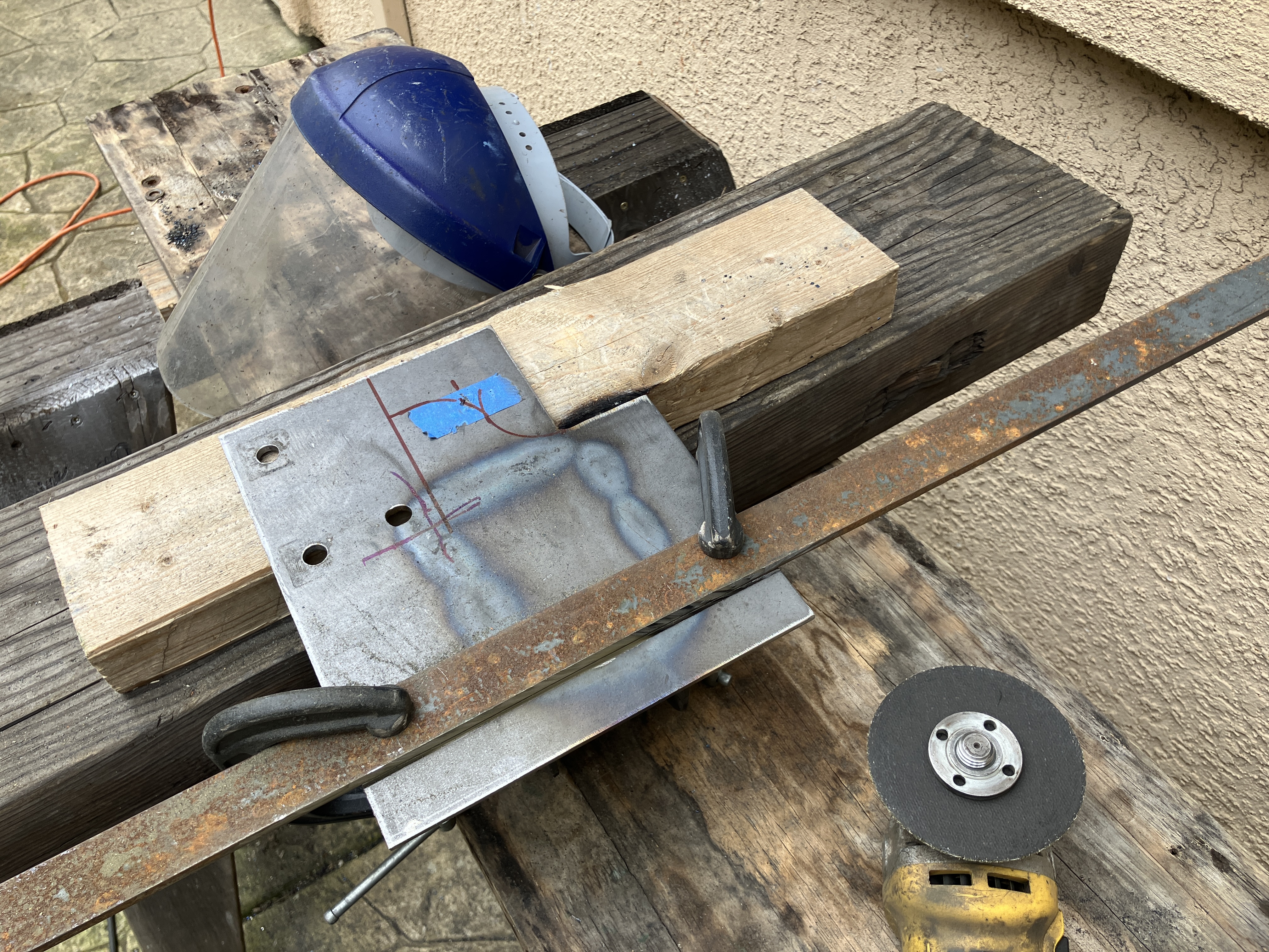

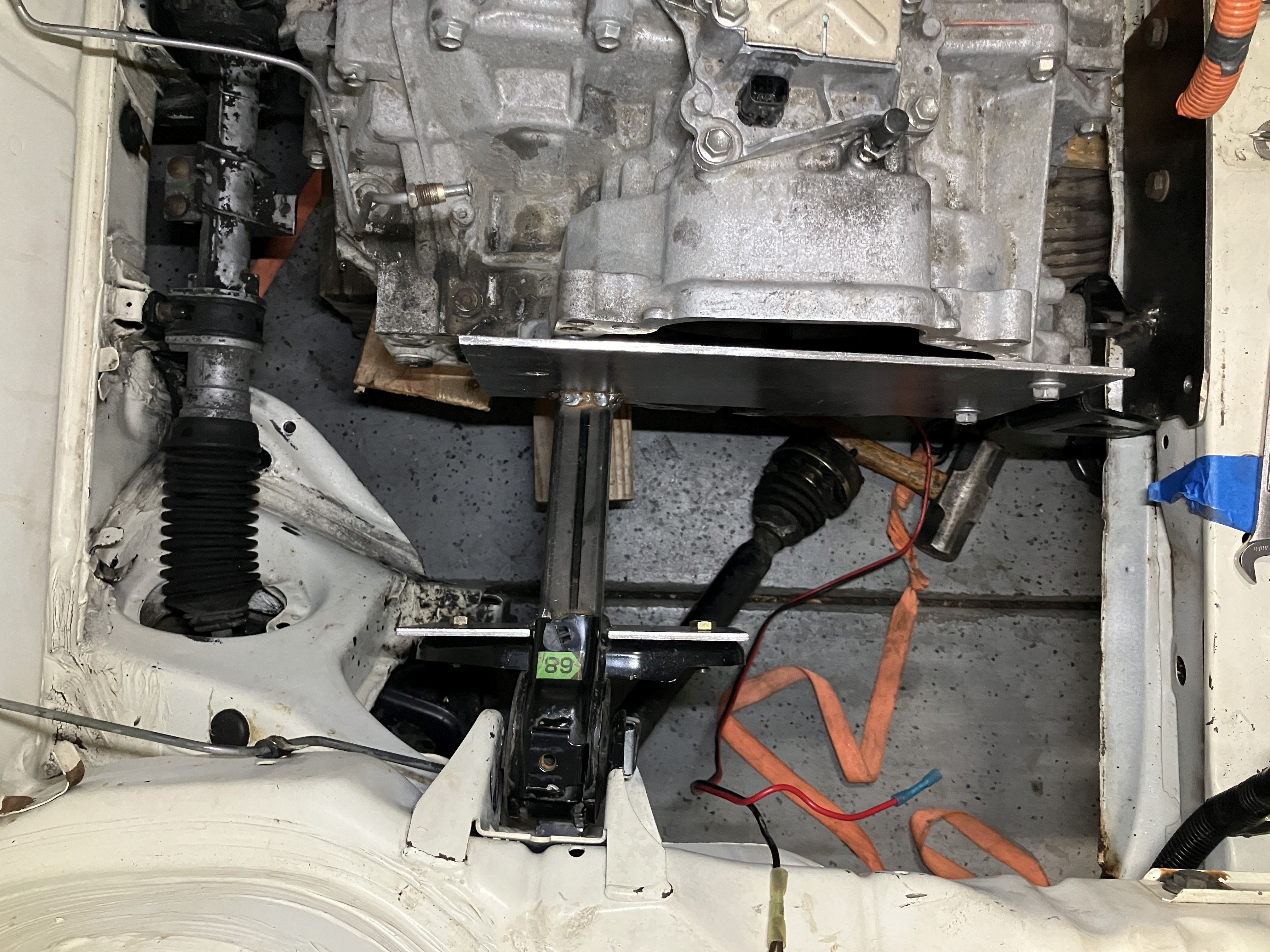

let's take a look at some pics of the "bell housing" rubber mount and the temporary rigid radiator core support bracket
yes I am a sh!ety fabricator but also everything is cattywampus on this car

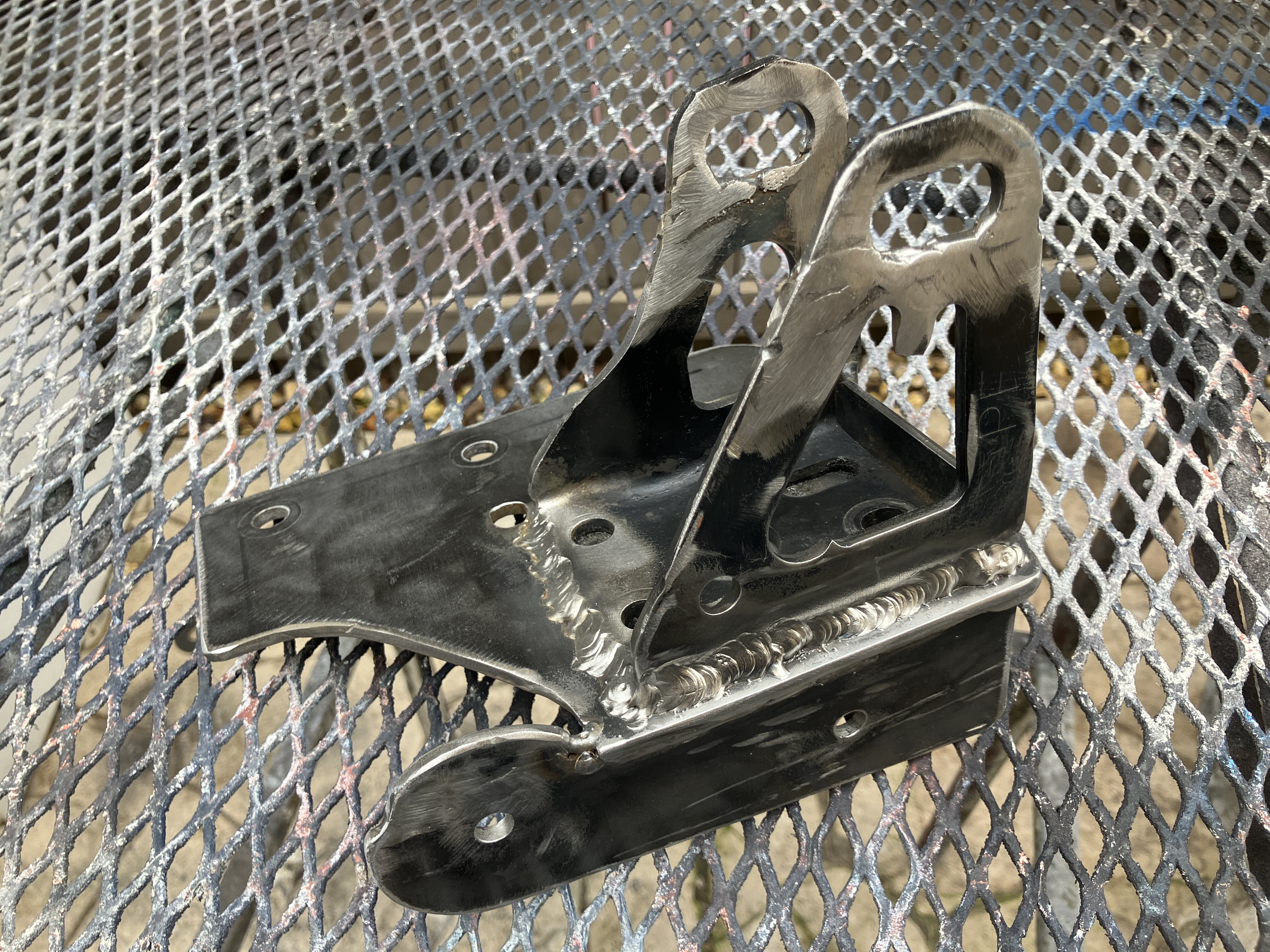

I later remade the one below:

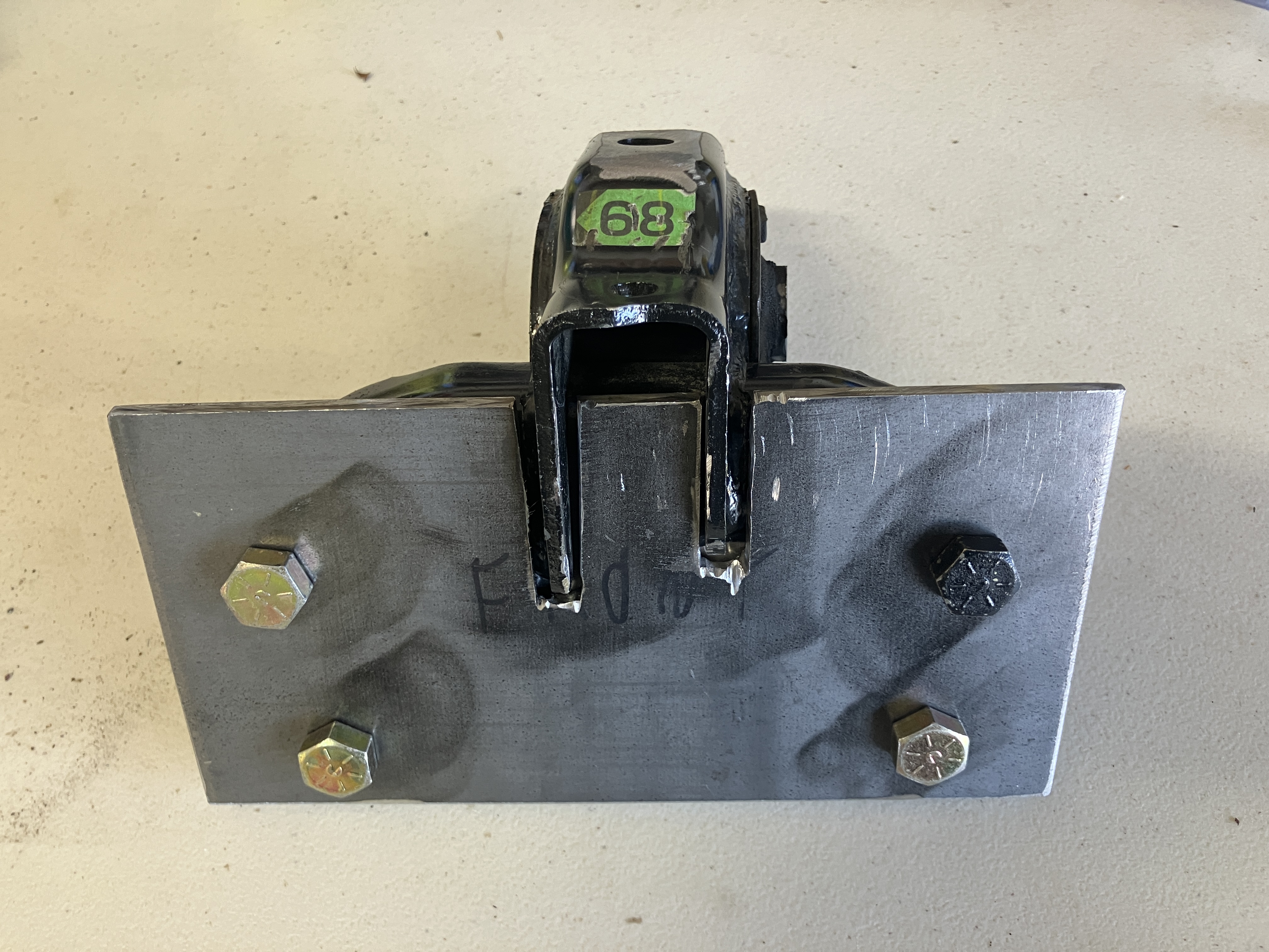

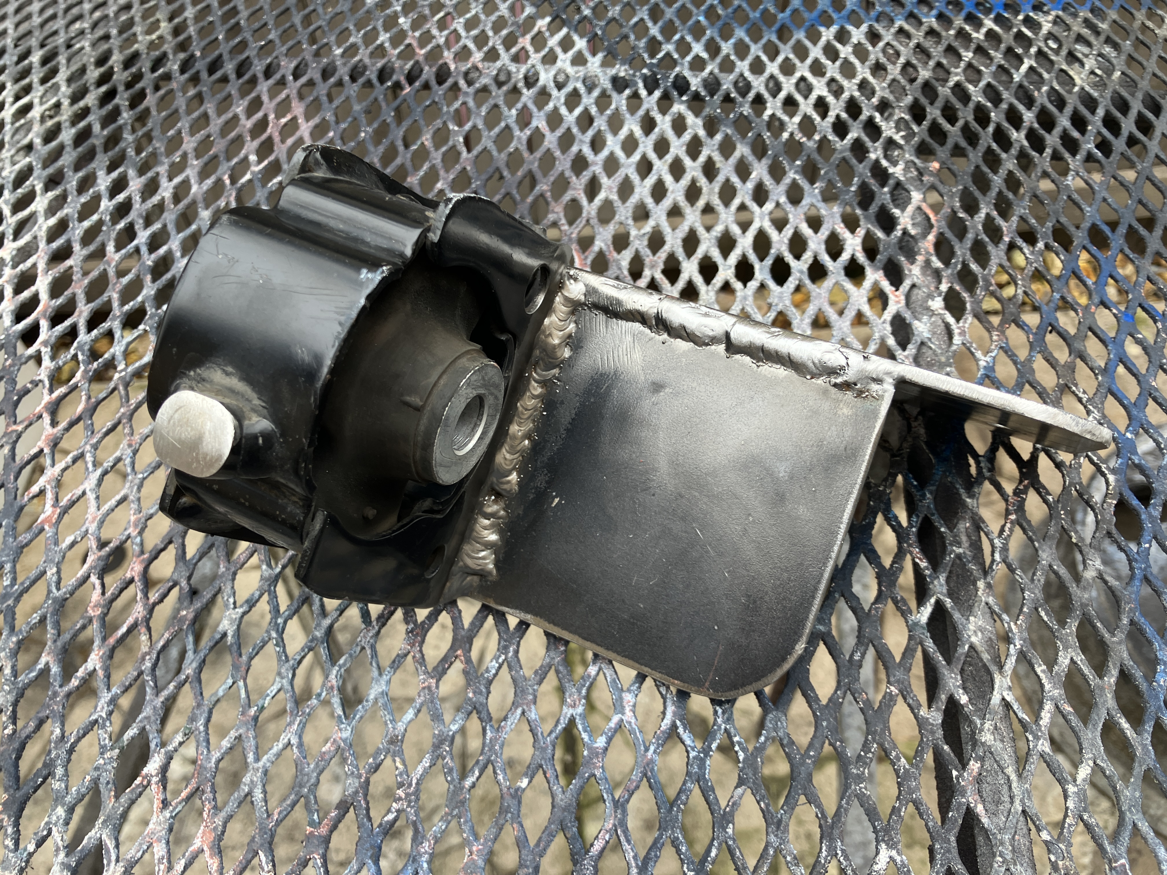

Some people cut corners, I like to round all my corners 🥁
this is the same "Bell Housing" bracket, it's where originally the engine would mate with the transmission, I think if I ever re make it, I will cut the big plate to be the exact profile of the bell housing clam shell
had to cut out an opening for the CV axle obviously, and had Ray Charles weld that up for me, [ahem] with his feet !

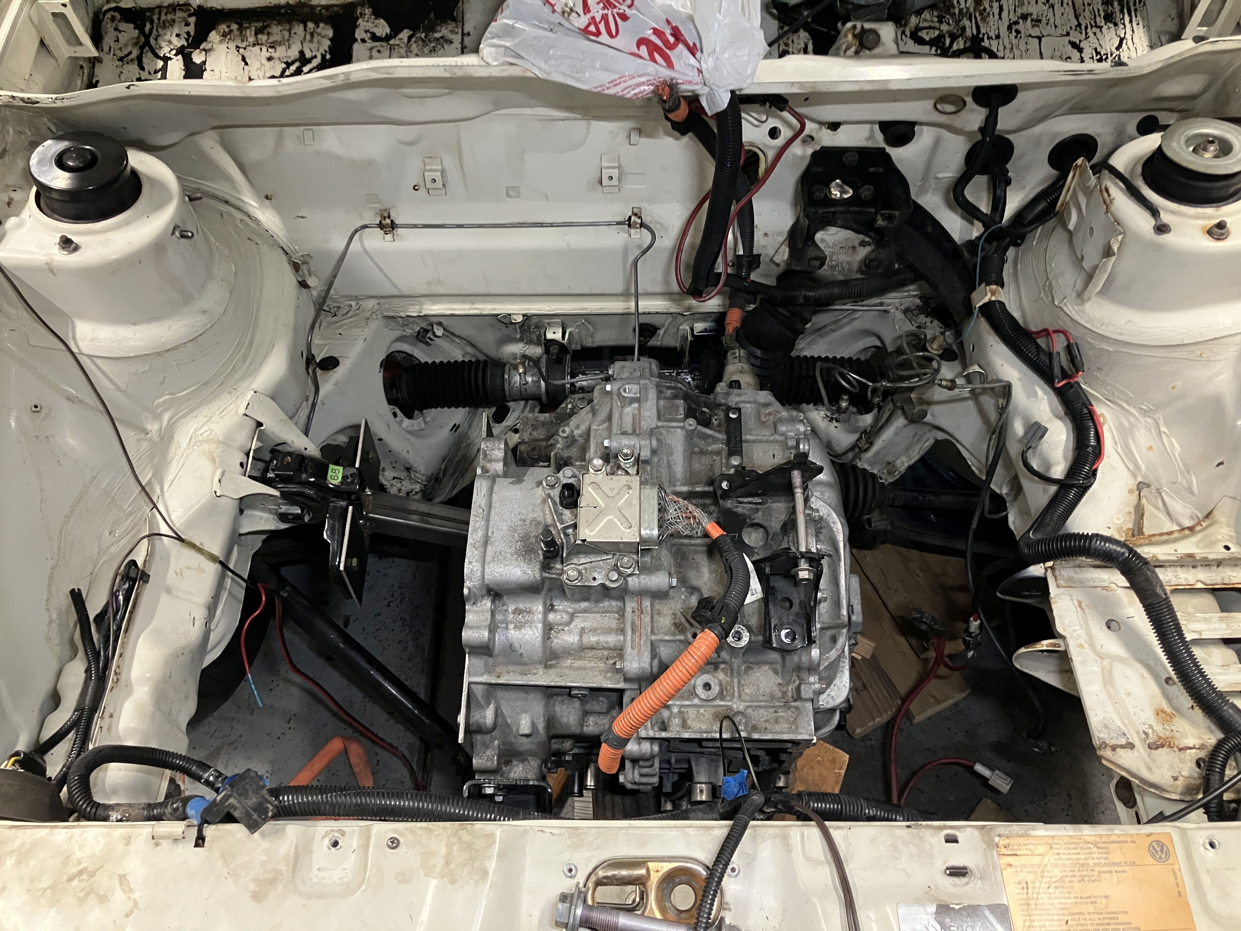

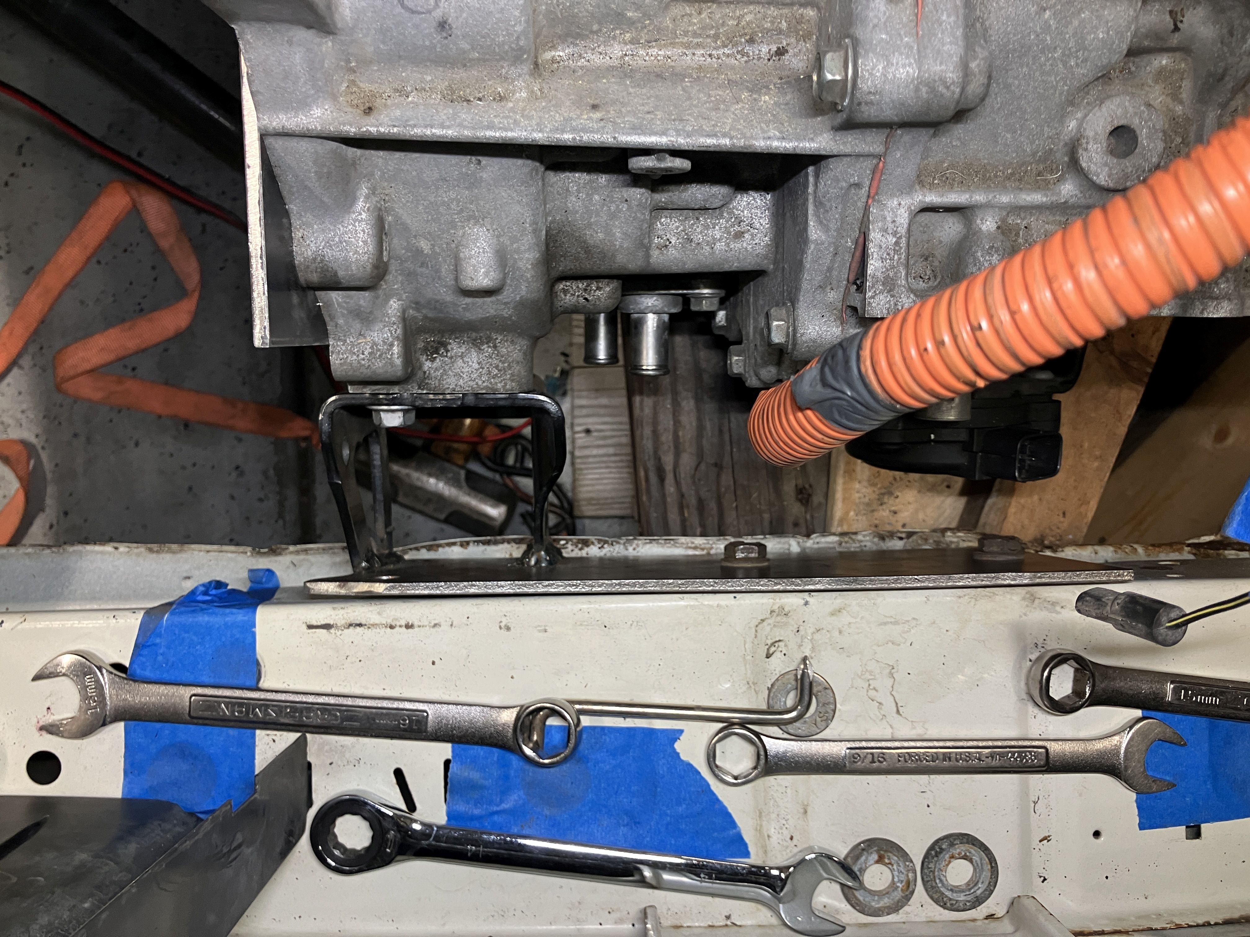

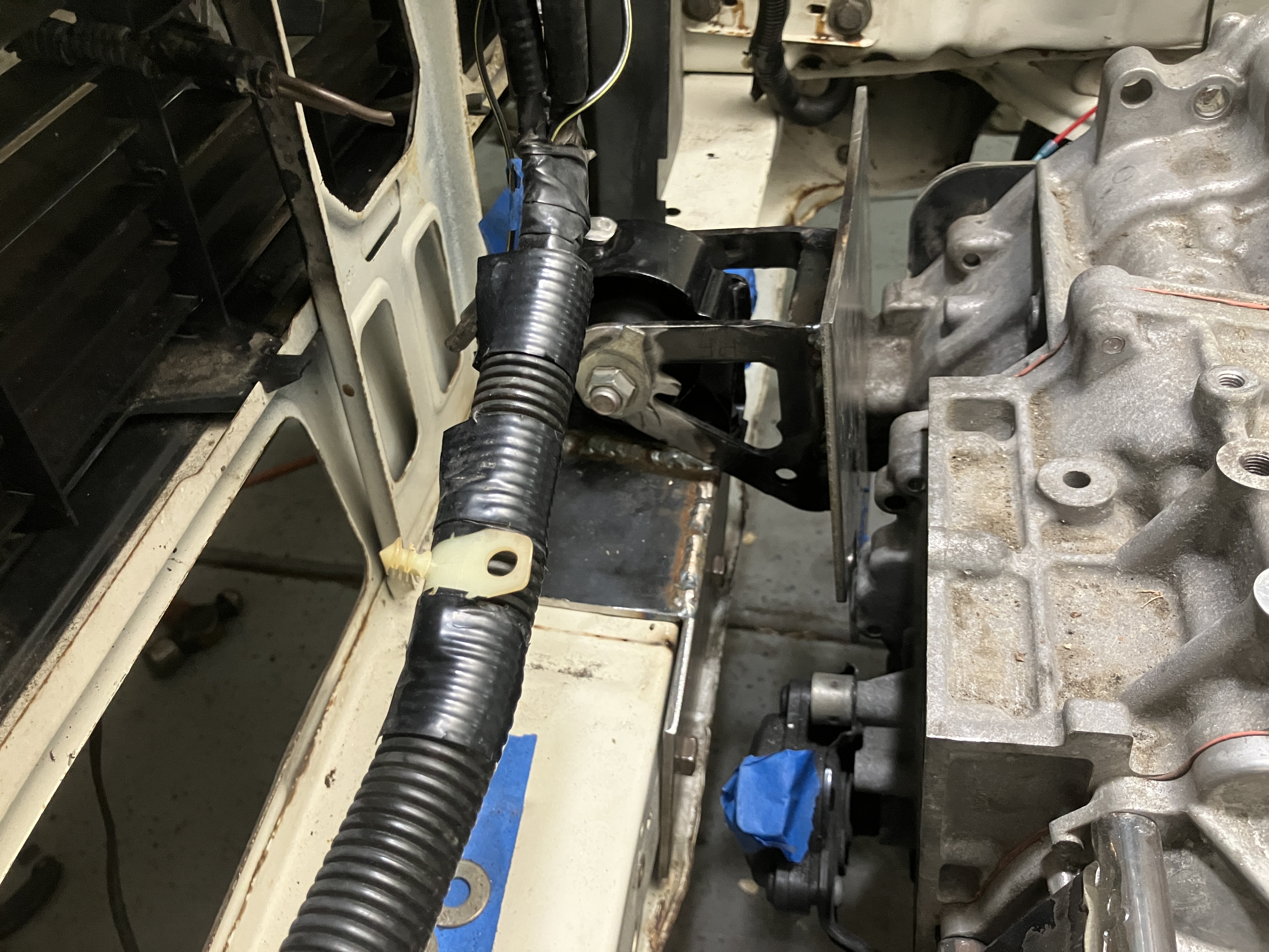

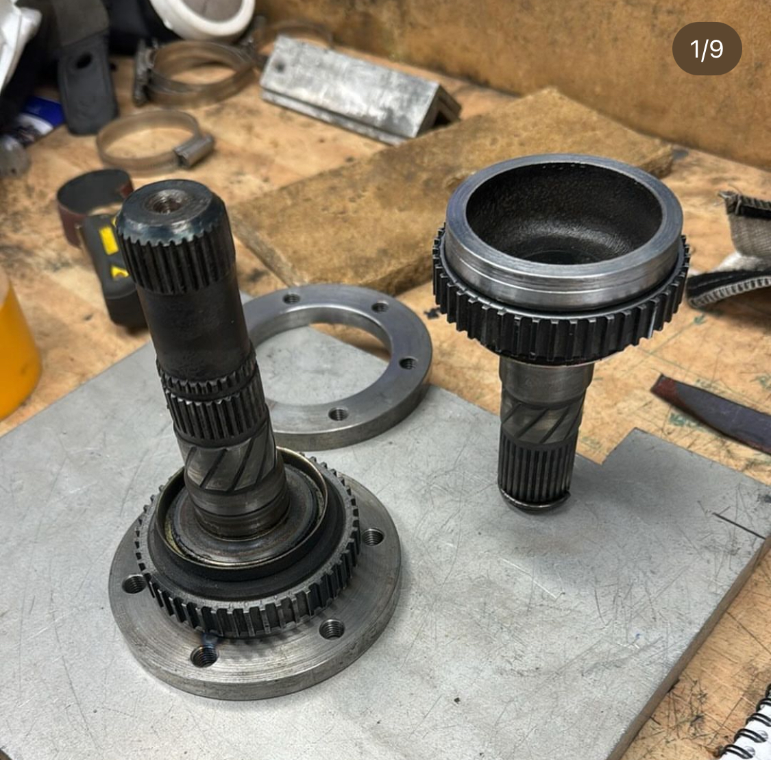

It’s in! It looks like you centred the drive unit. I would but the vw axles back in and set the diff between them, then no custome length axles. Then you can take the Toyota cv joints and make flanges like so

Bratitude wrote: Sun Feb 18, 2024 4:48 pm It’s in! It looks like you centred the drive unit. I would but the vw axles back in and set the diff between them, then no custome length axles. Then you can take the Toyota cv joints and make flanges like soIMG_2135.jpeg
do you have more info on this please ? a linky link perhaps
Ev8
Posts: 818
Has thanked: 43 times
Been thanked: 163 times
Re: 1984 Voltswagen Rabbit Prius Gen 3
Post by Ev8 »

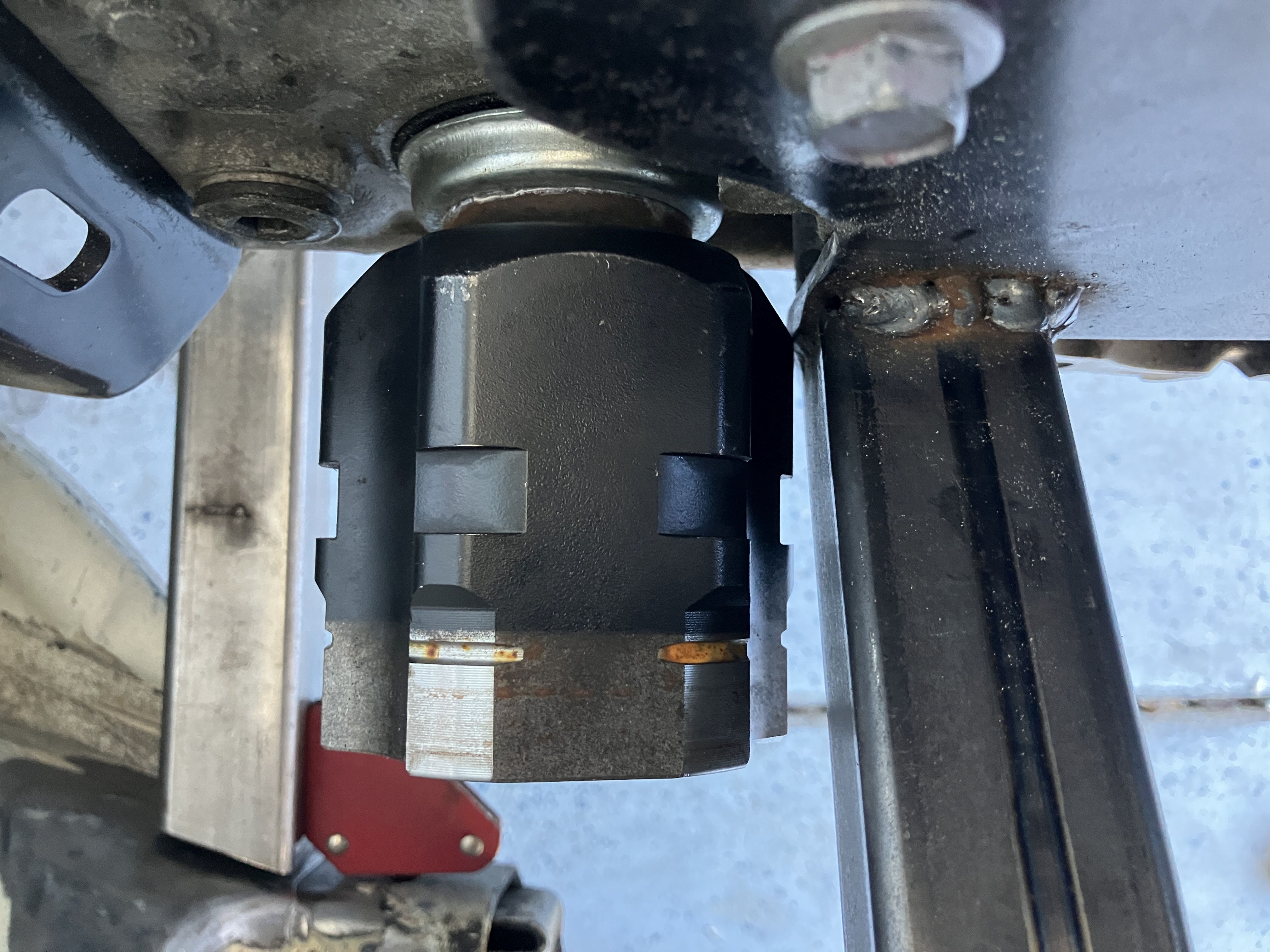

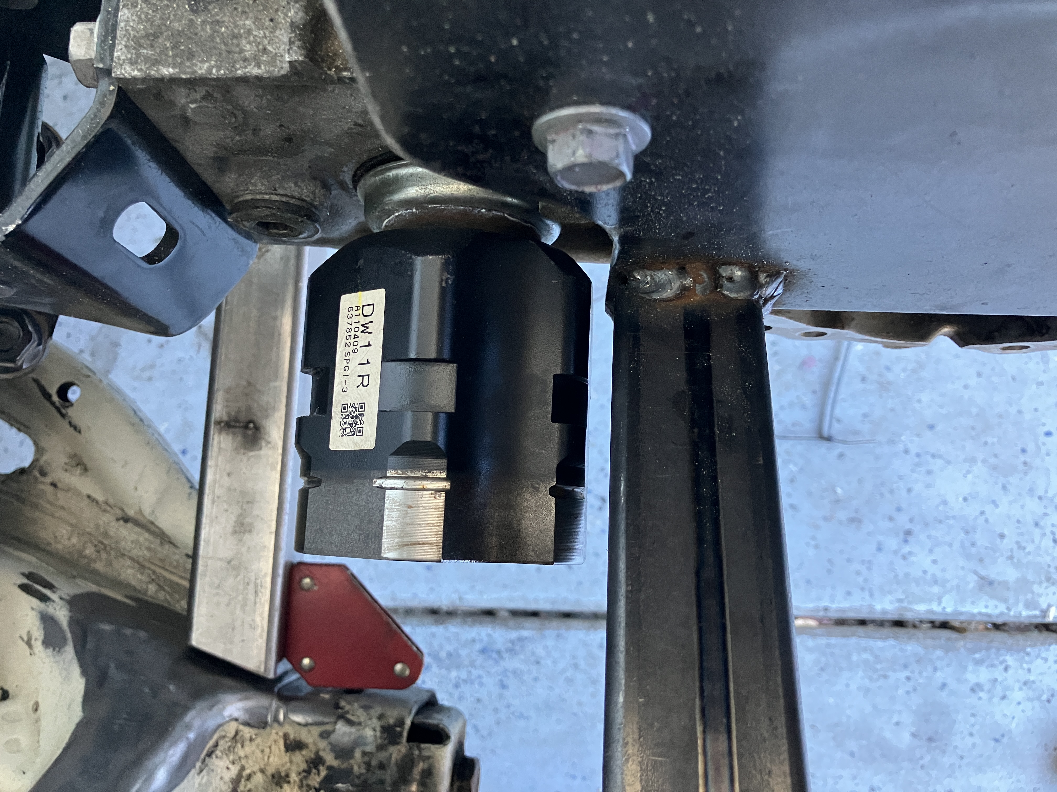

Is that square tube clear of the inner c/v?
Gregski
Posts: 2753
Has thanked: 505 times
Been thanked: 957 times
Post by Gregski »
Ev8 wrote: Sun Feb 18, 2024 5:55 pm Is that square tube clear of the inner c/v?
as my old co worker used to say: "Few problems, nothing minor!"
that thing aint supposed to spin, is it? ;)
Posts: 1011
Has thanked: 180 times
Been thanked: 374 times
Gregski wrote: Sun Feb 18, 2024 4:53 pm do you have more info on this please ? a linky link perhaps
Just some simple machining and welding.
you take the Toyota cv joint/stub and cut it down, turn it round on the lathe. then make a flange with the 100mm bolt pattern that the vw cv joints have, and press that on to the turned down Toyota stub. Then get it tig welded.
Heck you could use the old flanges off the vw trans axle, as you already have them!
now you have a stub flange with the Toyota splines and the vw cv joint bolt pattern.
Now your stock vw cv axles bolt up to the Prius trans axle.

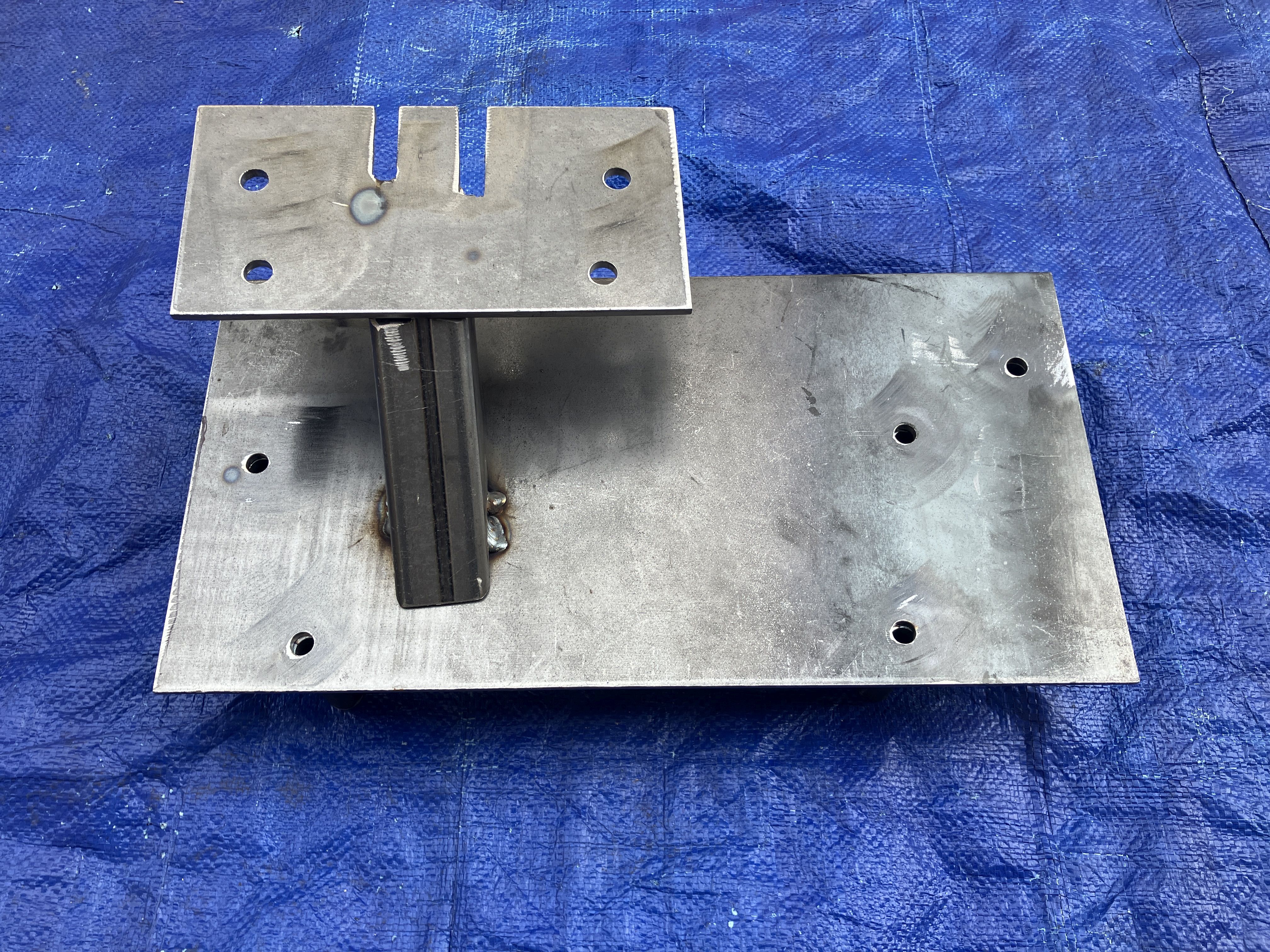

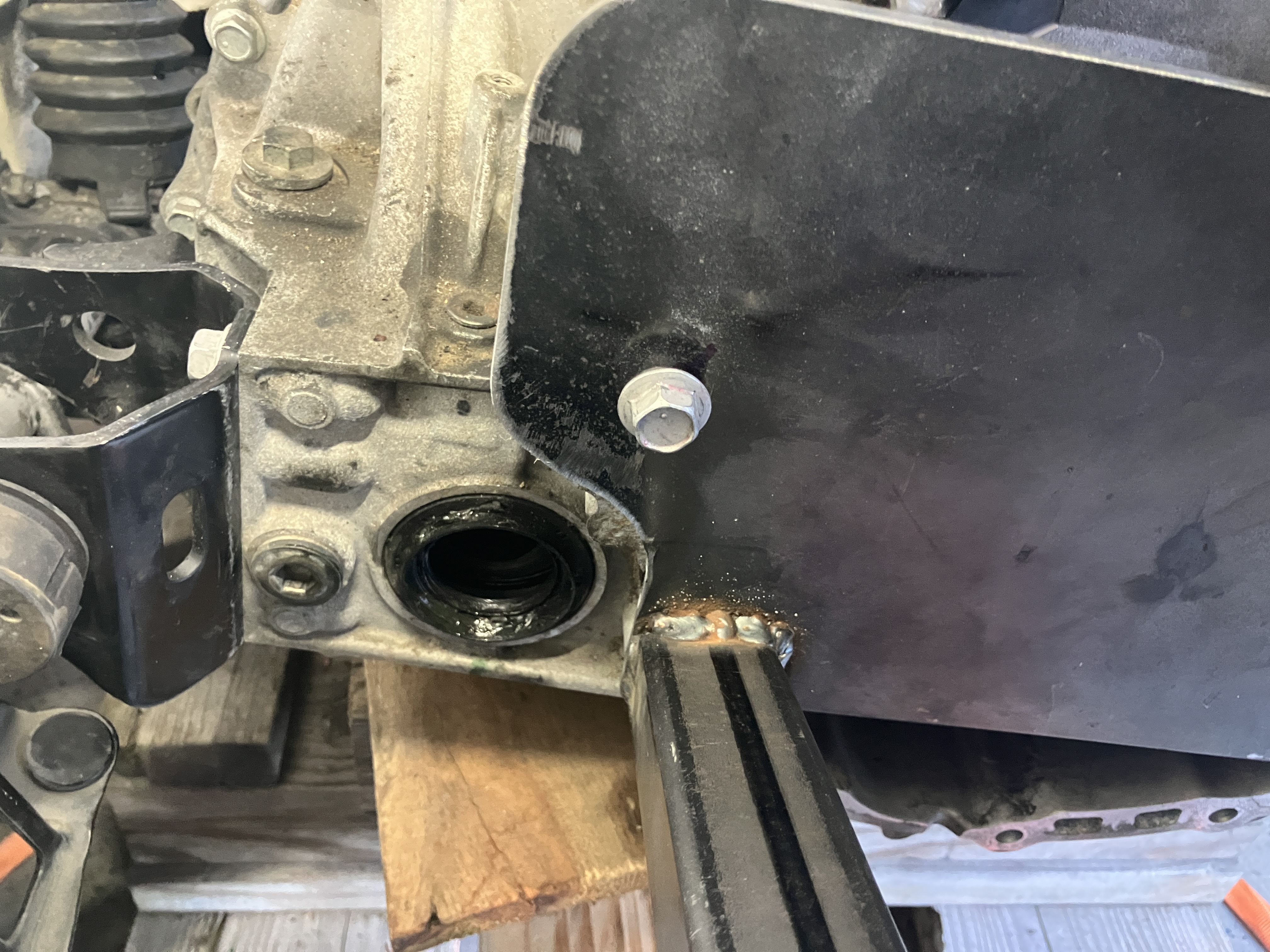

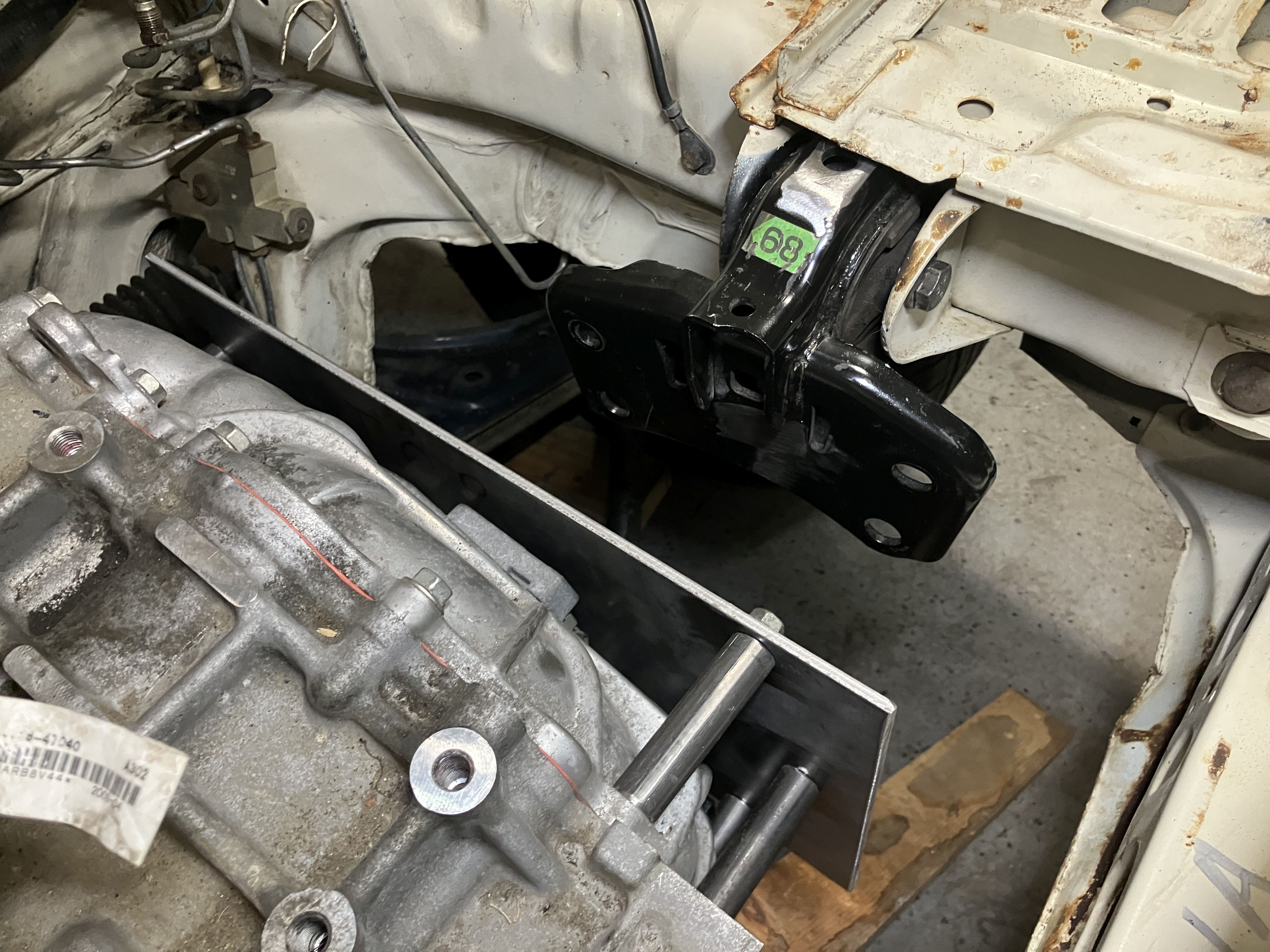

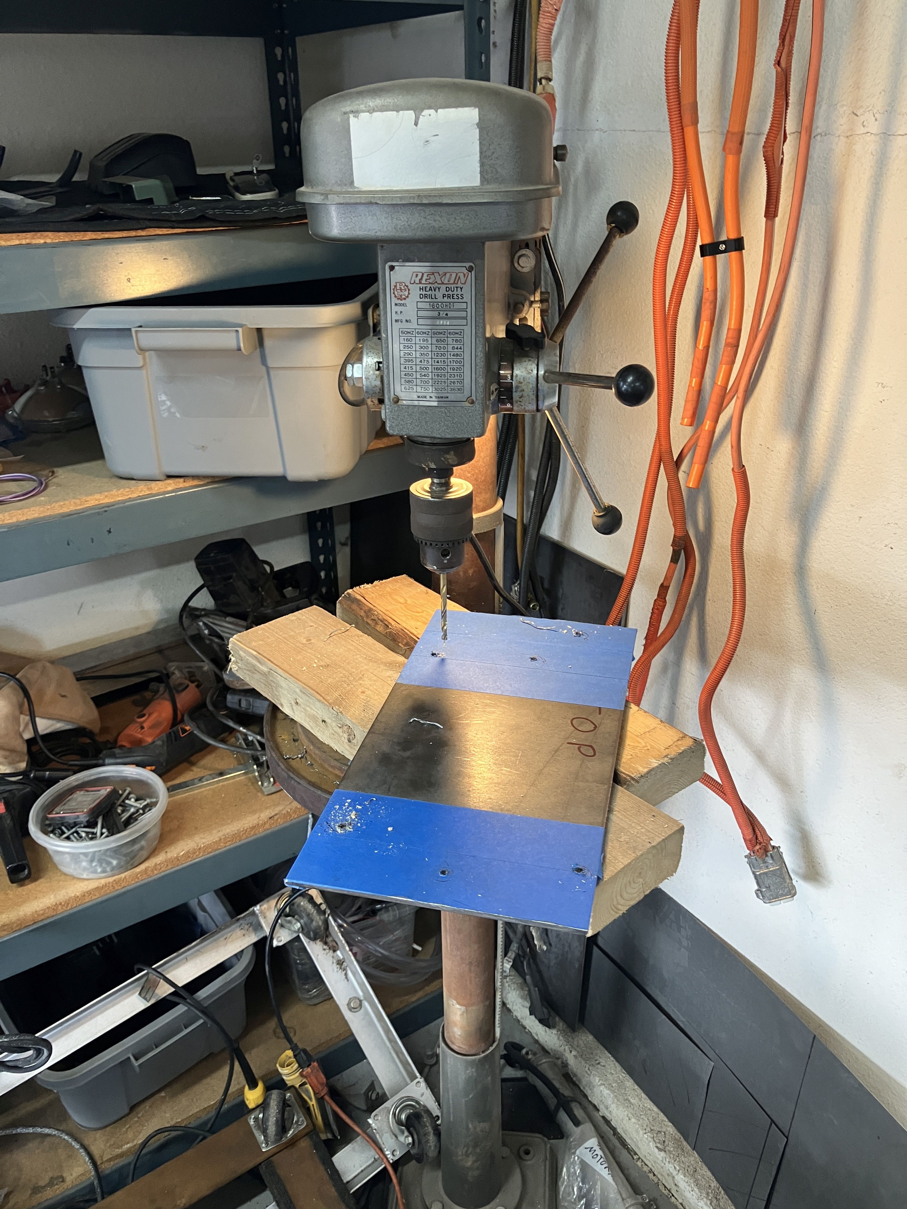

The tension mounts at Good Enuff Garage, will The Greg get the motor mounted before some randomly set arbitrary deadline, or will he loose the shop ???
we (my son and I) used the blue tape to indent the head bolts into it to give us a point of reference for drilling the holes
the plate had to be set back far enuff to clear the mechanical oil pump which sticks out, out of the transaxles butt

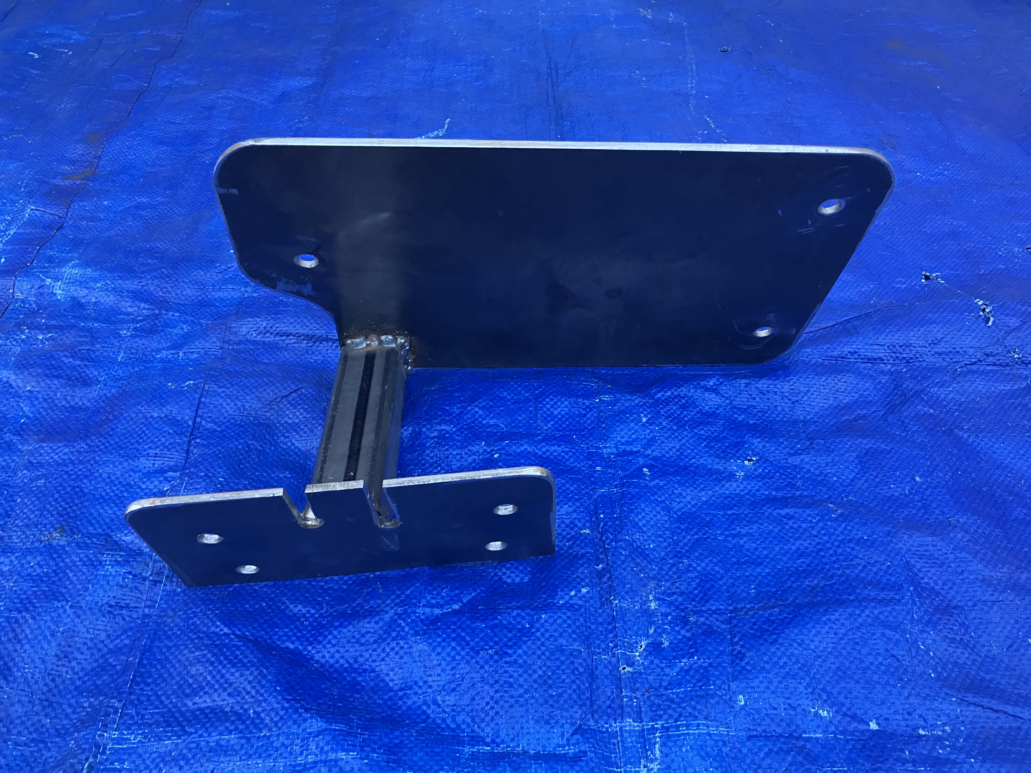

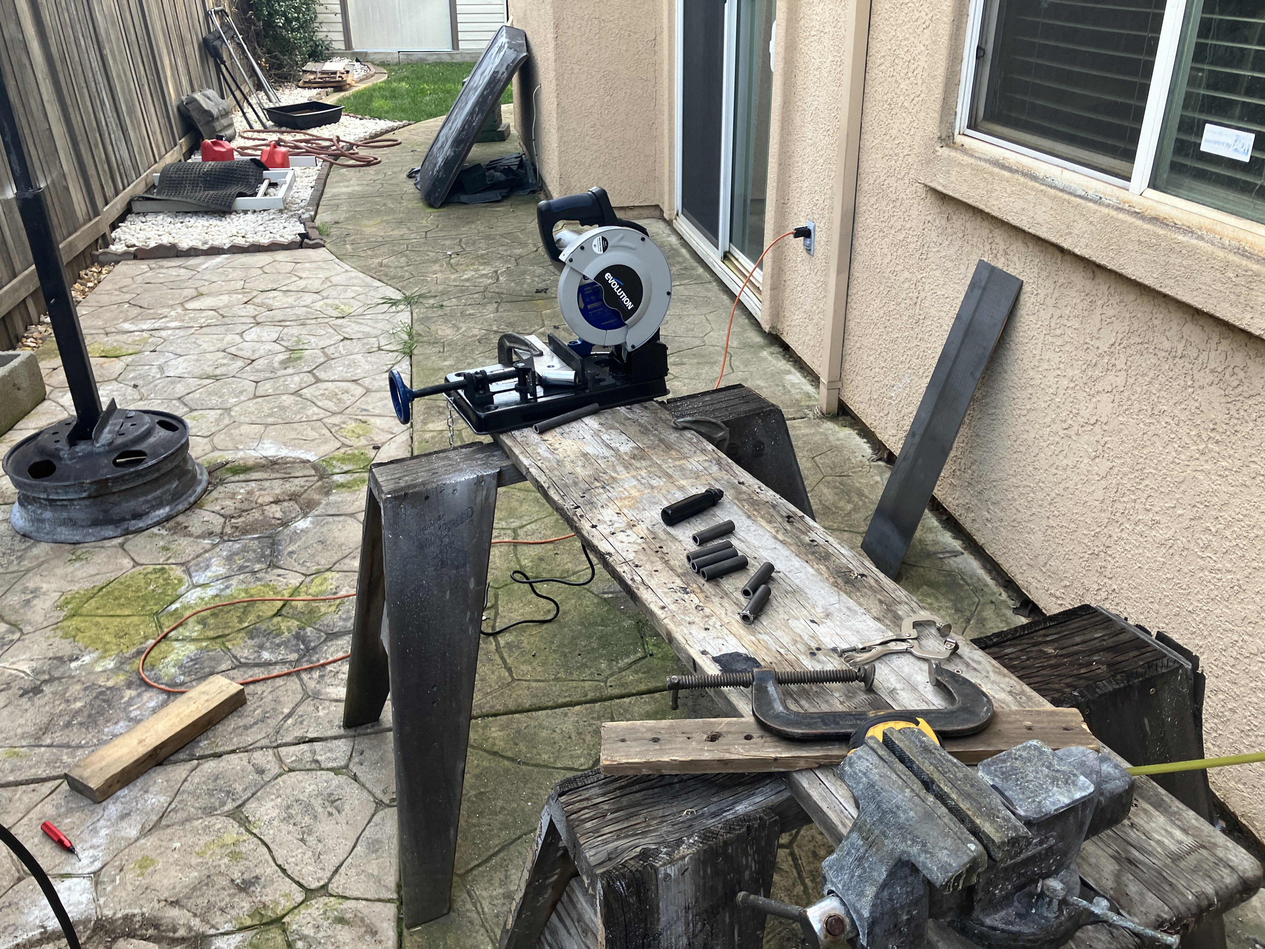

after seeing how much steel spacers actually cost I decided to cut my own, (so I went out and bought a $200 dollar chop saw - I'll show them)
here's a look at the spacers, spacering:
tack welded into place

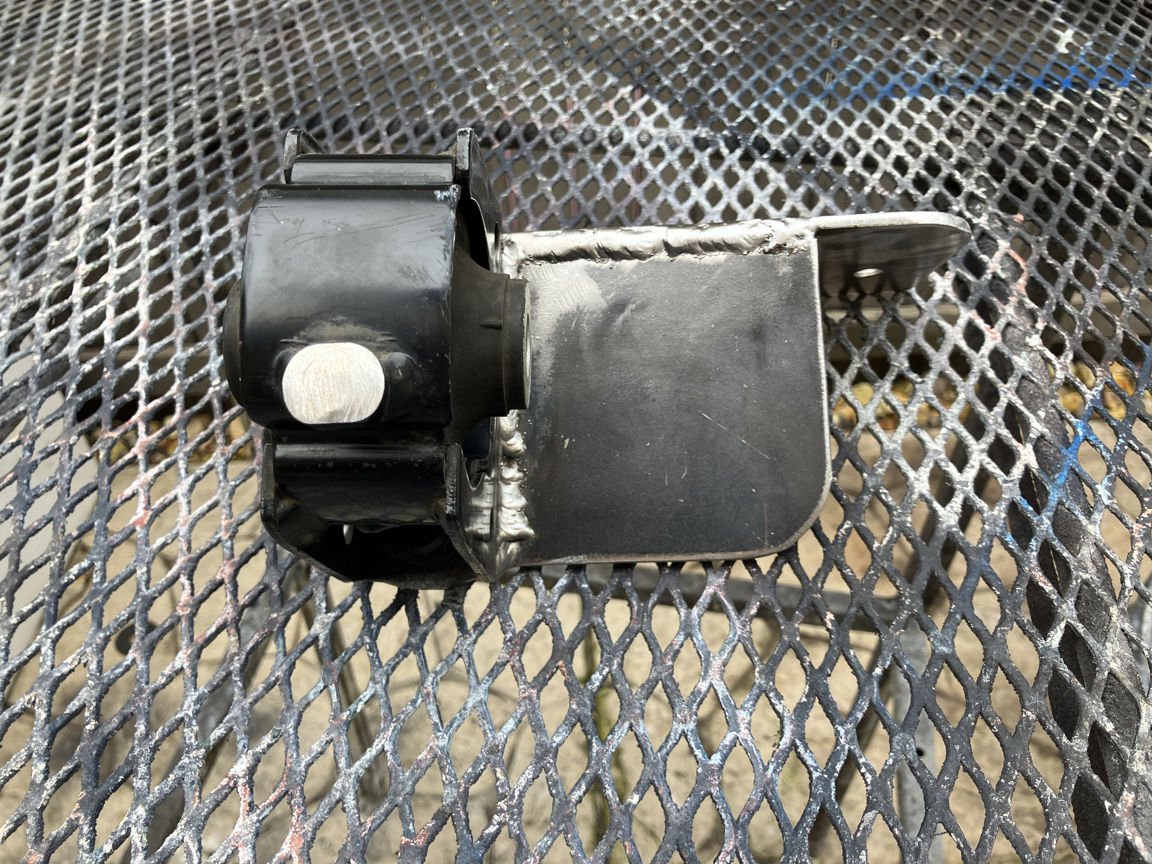

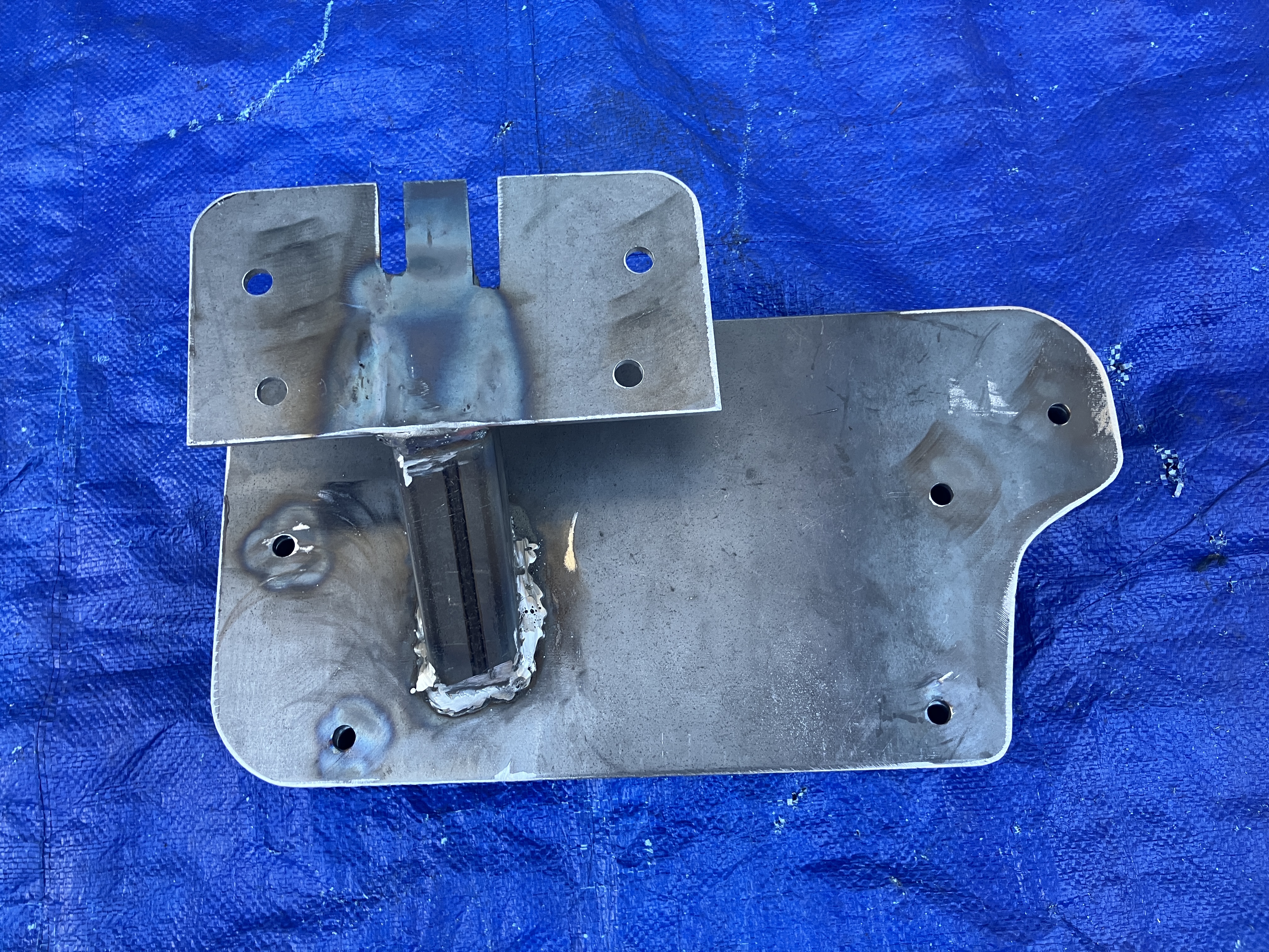

I could have just welded the bars to the stock Prius bracket, but that would have made it much harder to assembly and disassemble, plus it may have melted the rubber bushing, so I made a plate instead
The Sandwich Design

some people cut corners, I prefer to round mine
"Look at those perfect welds" said no one on the Internet ever!

oh, and this is the sh!iet I'm dealing with when I say cattywampus
take a closer look at that smaller bracket see how it's thicker on one end than the other

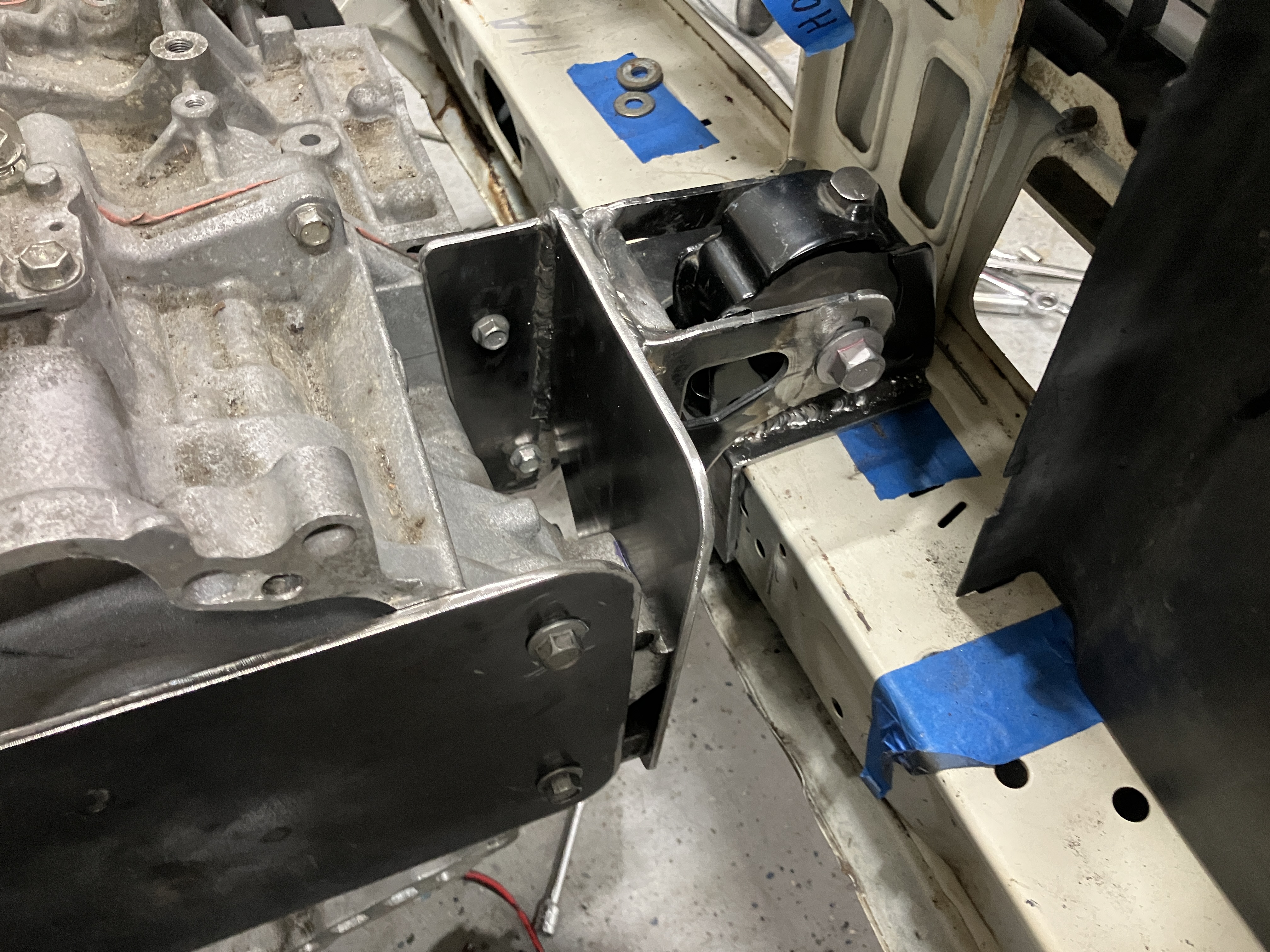

some glamour shots of the front motor mount
Post by Gregski »
and here she is all trimmed down and installed, some day she may even see sum paint
