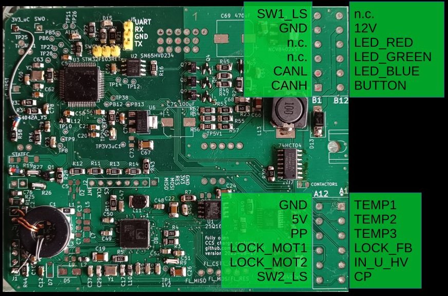

- switch that closes when PP is pulled to GND by charging cable - I use a P-MOS pulled to permanent 12V with 4k7. The existing pull-up to 3V3 would need to be removed and the voltage into the MCU pin limited to about 3V3. Also the unpowered MCU mustn't pull down PP - high value resistor between pin and PP
- The output of the switch powers up the foccci simply by supplying it with 12V
- Foccci may wake up or power components with a switchable 12V output - Say another P-MOS that can safely conduct about 5A.
- A 12V "ignition" input powers up Foccci when the car is turned on for status reports if you so wish. Super fancy alternative: use above output also as wakeup input (bidirectional wakeup bus)
- So we need 1 or 2 more pins on the Deutsch connector, there are 3 n.c.

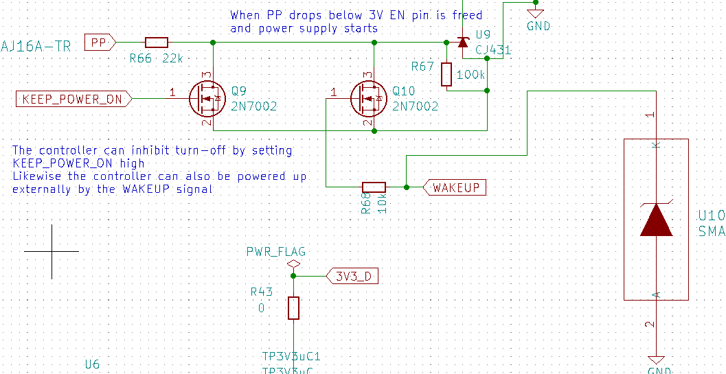

I have finished up the schematic for full wakeup functionality
I have added a bidirectional WAKEUP signal to B7. When pulled high it will turn on the 5V reg and thereby the controller. The uC on the other hand can pull high the wakeup signal itself (TRIGGER_WAKEUP) e.g. when woken via PP. The P-MOS isn't particularly strong but wanted to stick with a basic part for now.
I didn't add an extra uC pin for the wakeup signal, instead the uC can read the PP level to decide whether it's a PP or WAKEUP wakeup :)
The uC can also choose to keep running after wakeup or PP are gone by pulling KEEP_POWER_ON high
I also did some BOM optimization to use more basic parts. Hope uhi agrees with all that.

Two questions:
1. Where does the pull-up of the PP get the voltage from? For the use case, that everything sleeps (5V is off), and the user plugs the plug in, do we wakeup?
2. While the plug is connected, no sleep is possible, right? For the use case, that the car is parked for days with plug connected, this would drain the battery. Right?

uhi22 wrote: Mon Feb 19, 2024 12:49 pm 1. Where does the pull-up of the PP get the voltage from? For the use case, that everything sleeps (5V is off), and the user plugs the plug in, do we wakeup?
In that case it gets it from 12V_P via 6k2 which must be permanent 12V. There are solder bridges to choose between 12V and 5V on PP
uhi22 wrote: Mon Feb 19, 2024 12:49 pm 2. While the plug is connected, no sleep is possible, right? For the use case, that the car is parked for days with plug connected, this would drain the battery. Right?
Right. The TRIGGER_WAKEUP can be kept low to at least not wake up other components but apart from that I don't see how to put the 5V reg to sleep. The most we can do is put QCA and STM to some low power mode.
To overcome this the PP signal would have to be artificially made momentary, like with capacitive coupling. Would save that for a later revision
EDIT: I should also mention that I greatly downsized the 12V bulk capacity. It was 680uF but for a maximum 6A PWM I think it can be less (power inverters have that sort of capacity). They are now 3x22uF film caps where one is placed right next to the motor driver IC.
Also on the 3V3 rail no elcap is needed in my opinion. So now the design is elcap-free

If you make sure the STM32 can put everything on the board into shutdown/standby and that the regulator setup is efficient at currents in the range of 1mA, then I don't think it's a problem if the STM32 is always powered when plugged in. Managing the sleep states and wakeups of course takes some effort but it's doable.
If you want to go as far as stop the main oscillator, check if the STM32 in question has an internal RTC oscillator that can be used as a timed wake-up source, or whether you have to add an external RTC crystal for that.
But, if you use CAN transceivers without a standby pin, a wasteful regulator or something of that nature, you'll of course easily end up consuming tens of mAs even while the STM32 is taking microamps. Making electronics is one thing, but making low power electronics is a whole another level of effort.
Then again, of course, just using a series capacitor in line with the PP wakeup signal probably works just fine and you'll get to skip all the annoying sleep state management and the replacing of components with standby-capable ones.

If the PP pullup is at 12V, and the 12V is variable between 10 and 15V, this makes the PP resistence measurement inaccurate. Would need to measure the 12V, too.
Been thanked: 1914 times
Re: Develop a QCA7000 board?
celeron55 wrote: Mon Feb 19, 2024 4:33 pm Then again, of course, just using a series capacitor in line with the PP wakeup signal probably works just fine
Yes it just needs to bias the CJ431 reference input long enough for the uC to run through the boot loader and enable the KEEP_POWER_ON pin.
uhi22 wrote: Mon Feb 19, 2024 5:16 pm If the PP pullup is at 12V, and the 12V is variable between 10 and 15V, this makes the PP resistence measurement inaccurate
Oh, didn't think of that. Well then we can either deploy an aux 5V reg (they consume like 2 uA) for PP or indeed measure "12V" also

Small findings:
- The hardware version resistor R62 with C22790 has 0805 footprint, but 0603 component. Hopefully it fits nevertheless :-)
- The p-channel-FET Q11 does not have a jlc part number.
- The 22uF have C12891, which are 1206, but the footprint is 1210. Well, should not hurt.

Too small footprint is not good, too large usually works :) Have added the part number locally, probably didn't commit
No idea how remote controls exactly operate in the car and whether there is a "wakeup bus" that you could tap into. In Touran the interior lights switch on when you unlock, not sure how that is achieved. Could tap off them :)
I have made some calculations about PP measurement and I don't think further optimization is needed as the values don't overlap at different "12V" levels:
If you find it too embarrassing to display inaccurate resistor values you could just look what interval you're in and then display the ideal resistance value ;)
