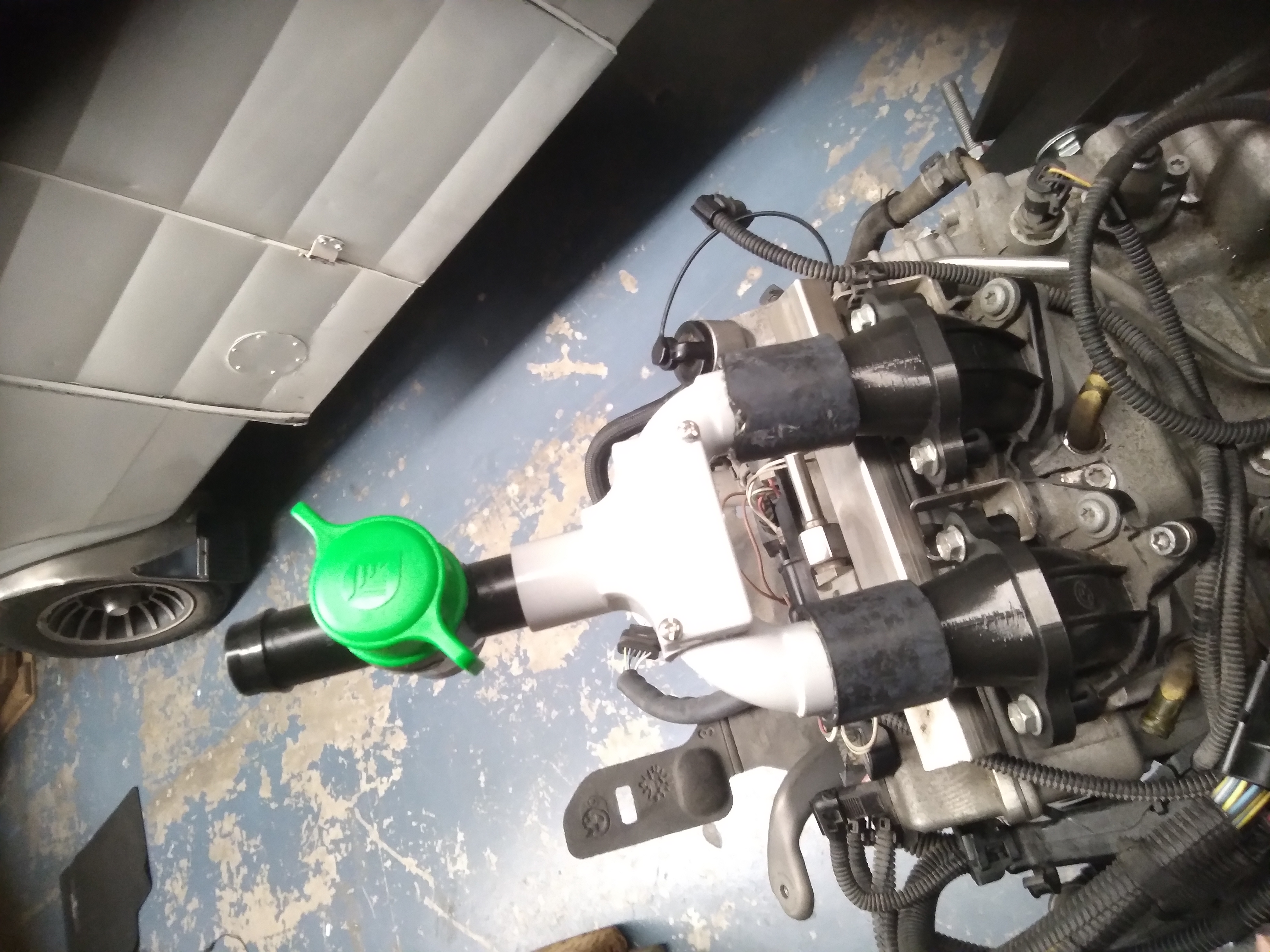

Inlet manifold with specific small volume , to be more LPG friendly, than a large induction chamber of gas with combustible mixture, even if uncompressed
Throttle body has common or garden watering look.
Next to print a magnet timing disc, for hall probe sensors
And learn how to fire the coil overs.

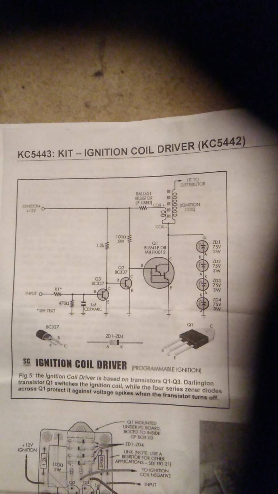

A kind person shared the info. This is a cut down version of the coil wiring,
So as crasbe mentioned, these coils will need a coil driver / strong Mosfet for them to fire. No worries about dwell besides cooking them long term.
Up top is 12v. Brown is ground, likely to the cylinder head / valve cover. White for cylinder 1, white with green for cylinder 2 are the pulsed - to dwell & fire the coil.So as crasbe mentioned, these coils will need a coil driver / strong Mosfet for them to fire. No worries about dwell besides cooking them long term.

This is Great, What would be a strong Mosfet 3 A ?jrbe wrote: ↑Mon Feb 05, 2024 5:38 pm A kind person shared the info. This is a cut down version of the coil wiring,

A typical coil driver is a bip373 but they are getting hard to find.
https://www.diyautotune.com/product/coil-driver-kit/
http://www.megamanual.com/ms2/bip373_datasheet.pdf
It's been a while since I've done these things. I'm not up on what's a commonly stocked coil driver. Most are moving to coil on plug with built in drivers. You could look at using coil on plug coils but a lot of them are dwell time sensitive and it might be tough to find one to fit.
https://www.mouser.com/c/semiconductors ... &instock=y has a few through hole options. I don't think typical mosfets last very long driving ignition coils.
You can hit up a junkyard to get a coil driver too. Bosch 211 coil drivers are 4 channel and common in late 90's to mid 2005? European cars. Get the pigtails as well if you go this route.

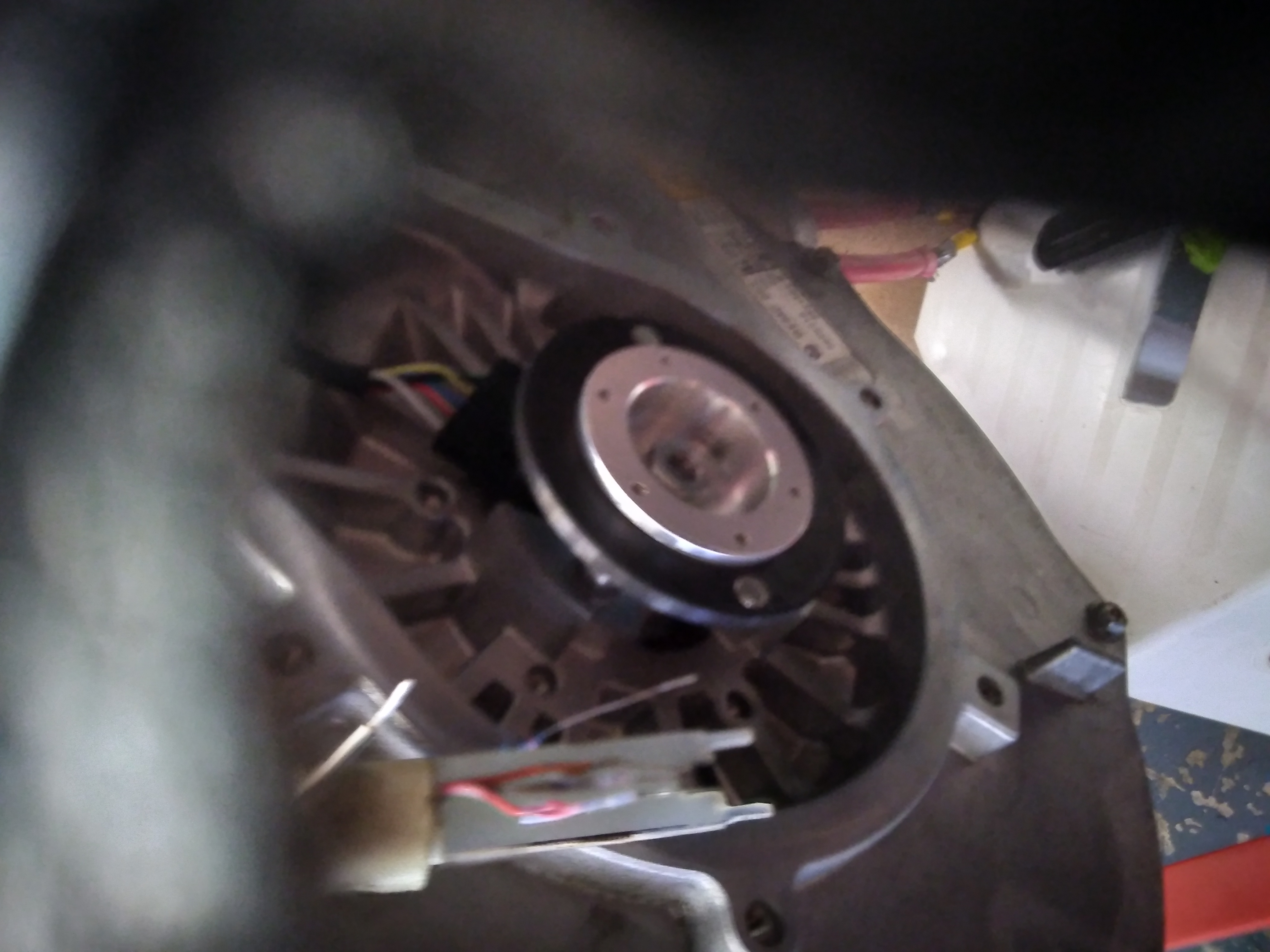

Some Rex ignition Progress,jrbe wrote: ↑Mon Feb 05, 2024 10:02 pm A typical coil driver is a bip373 but they are getting hard to find.
An adapter to pick up the spline of the resolver, and 3D printed magnet disc, loaded with the magnets.
Have the magnets and sensor giving a clean switch on check before mounting.
Will check with scope once rotating, for waveform.
Have Established engine rotation is Anticlkwise from resolver view, I.e. suction on the intake.
Plug removed to set timing position. Figure doesn't matter whether the adjacent cylinder is ahead or behind 180 °, as is wasted spark method .
So onto coil, have 12v on, and the WS 16 connection is at 12v,
So confirming its a two wire system, operation the third wire is coil ground return ,
I.e. a normalish coil.
Mr Kettering used a condenser, not seeing such on this diagram, looks like resistor of some size..
Any thoughts?

yes had made sure the plug is firmly secured to the engine ground, to eliminate any high voltage going where it shouldn't.
In past, on a prius project, had used some coil driver kits from silicon chip magazine from Jaycar electronics.. these now are long gone, but have sourced the specific coil drive transistor pair , (BU941P ) from ebay . Unfortunately a long delivery time, so may borrow from the prius set up, till they arrive.
Hope that having the brown ground wire separate compared to the circuit diagram will still work,

The capacitor on an ignition coil harnesses is typically a plastic cube with a ground / mounting tab that grounds near a coil. It's likely easier, safer, cleaner, cheaper to add the nearest coil or coils ground wires than to have a bunch of loose ground ring terminals to connect.
The engine should still be connected to the 12v system - / ground.
It will very likely run without the capacitor unless you have sensitive electronics running the engine that are getting interference from the coil noise.
You could hunt down a coil driver from a recycling yard too.
