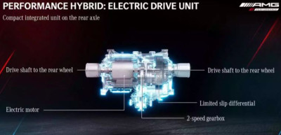

I agree a mechanical LSD would be difficult - AAM also make the rear motor for the AMG GT 63 E which is the same power! and same inline/axial configuration - with an LSD!

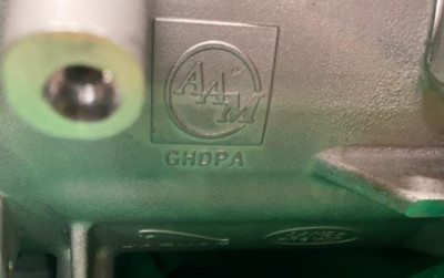

I Pace motor:
Gear ratio =9.04
Max rpm 13,000
Axle torque peak 3150Nm
Torque peak 348Nm
Power peak 147kW
Weight 73.8kg
There is also AAM casting branding - which is American Axle Manufacturing
Designed in Sweden, Manufactured in Poland.
