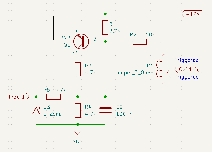

I opened the board. I have a few questions. I attached a pdf of the current R3 design (as is.)
drv103 pwm economizer.pdf
(164.62 KiB) Downloaded 847 times
Mounting hole spacing is 36.6mm / 1.441". Is this sized to fit something specific?
2 mounting holes leaves the board susceptible to vibration / resonances. I'll likely add 2 more mounting holes that can be ignored if desired.
The board size is currently 44 x 32. Any size limitations besides try to keep it small?
Were 1206 components used so these could be hand soldered? If this is going to be assembled by JLC, any issue using 0603 or 0805 components? Its much more likely to be able to use basic components (less setup cost) in those sizes.
Are the NPN's required?
Any issue feeding the DRV103 input through 4.7k resistors along with zener clamps as a turn on voltage limiter?

The NPNs I think were only required if you need to invert the signal. That is one catch to making it universal, it's good to be able to provide for either a positive (12-15v?) or negative signal to trigger the DRV. The last rev allowed for this by either pacing a limiting resistor for a + signal or a different resistor and the transistor for a - signal to be inverted. Zener clamps sound like a good idea too.

I added a solder jumper to select + or - triggered, otherwise the circuit is very similar to the last run. Anyone see any issues with this?
C2 is to debounce the input.
R6 shouldn't do much unless the signal is over 5v. Then the Zener will clamp around 5v to keep the DRV103 Input turn on voltage from going too high and R6 will limit current when shorting. Ti may have said it was ok to go higher but its a simple thing to prevent issues.

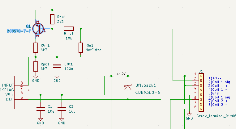

BC857B-7-F is an extended part ($5 charge for each batch of extended parts) I might swap it to a basic component. I think the DRV103 is the only extended component this will need.
This was the previous version,

This was planned with the drv103 to try to keep it simple and hopefully reliable. And my history with dc-dc's says it won't work exactly right the first time.
If someone wants to make a schematic I'd be happy to do a layout and the JLC side of things.

I simulated the + / - trigger part of the circuit, I believe it works as expected. The left 2 position switch flips between + & - triggered, this will be a 3 pad solder jumper.
The right 2 position switch flips the enable to + or - to simulate a ground or +12v turn on.
https://everycircuit.com/circuit/4812355044900864
Any input / feedback?
I have an unrelated circuit using a TI high side switch, I've had 2 short out on the enable line. It's a similar protection circuit as seen in this design. The other chip doesn't say anything about the enable line voltage needing to be equal or lower than the input voltage like this drv chip specs.
I haven't thought through how to do a simple & effective protection for that. Just a diode to feed power from the enable line over to the input will have the diodes voltage drop and the drv chip will still very likely blow...

It feels unsophisticated, but that's why I had a regulator in the original.

Zieg wrote: Fri Mar 29, 2024 1:23 am It feels unsophisticated, but that's why I had a regulator in the original.
It's not a bad thing, it can start getting busy, large, and costly.
With the drv chip enable =\< input voltage & < ~5v it might be worth adding a logic gate IC & 5v regulator. It might simplify the whole thing.
*Edit, I did not see where a regulator was used early on.
*Edit 2, coils should have no initial turn on spike, I had not realized this early on. This means a dual voltage dc-dc might be a really good option.
