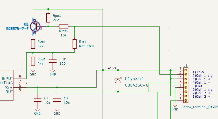

I opened the board. I have a few questions. I attached a pdf of the current R3 design (as is.)
2 mounting holes leaves the board susceptible to vibration / resonances. I'll likely add 2 more mounting holes that can be ignored if desired.
The board size is currently 44 x 32. Any size limitations besides try to keep it small?
Were 1206 components used so these could be hand soldered? If this is going to be assembled by JLC, any issue using 0603 or 0805 components? Its much more likely to be able to use basic components (less setup cost) in those sizes.
Are the NPN's required?
Any issue feeding the DRV103 input through 4.7k resistors along with zener clamps as a turn on voltage limiter?
Mounting hole spacing is 36.6mm / 1.441". Is this sized to fit something specific?2 mounting holes leaves the board susceptible to vibration / resonances. I'll likely add 2 more mounting holes that can be ignored if desired.
Re: DIY Economiser for OEM Contactors
I don't think the mounting hole spacing was meant to coincide with anything, Pete could correct me if I'm wrong. 4 holes also sounds like a good idea. I have the prototype on a 3d printed base for more support.
1206 was selected because I felt like that was about the limit that I could comfortably hand solder. I see no issue going smaller if they are made by JLC.
The NPNs I think were only required if you need to invert the signal. That is one catch to making it universal, it's good to be able to provide for either a positive (12-15v?) or negative signal to trigger the DRV. The last rev allowed for this by either pacing a limiting resistor for a + signal or a different resistor and the transistor for a - signal to be inverted. Zener clamps sound like a good idea too.

I looked quick at using a DC-DC to drive the coils at a lower voltage. They are around $2-3 for the circuitry for each contactor for an automotive rated ~2-5A buck dc-dc.
Could do something like a one shot 555 to time the full on time then swap to the lower voltage DC-DC with some logic. There might be a delay between switchover. DC-DC's are something I don't always have good luck with on the first run so I don't think this will work as intended on a first try. Seems like something worth pursuing but I don't have a need for these and won't be testing them.
A small microcontroller complicates setup and adds a few potential failure points. Also, having to edit code and burn it to the driver makes it much less simple to setup for some.
I added a solder jumper to select + or - triggered, otherwise the circuit is very similar to the last run. Anyone see any issues with this? C2 is to debounce the input.
R6 shouldn't do much unless the signal is over 5v. Then the Zener will clamp around 5v to keep the DRV103 Input turn on voltage from going too high and R6 will limit current when shorting. Ti may have said it was ok to go higher but its a simple thing to prevent issues.
BC857B-7-F is an extended part ($5 charge for each batch of extended parts) I might swap it to a basic component. I think the DRV103 is the only extended component this will need.
This was the previous version,

If relays are used to swap between say 14vdc and 4vdc there will either be a 0v change over time or potentially overlapping voltages. Dumping 14v into the 4vdc doesn't sound like it would be good for the dc-dc. Could use beefy diodes but those will have their own voltage drop, footprint size, cost, and waste heat.EV_Builder wrote: ↑Mon Mar 18, 2024 7:11 pm If the "stick" or secundary voltage is the same why to simply use 555 timer and feed 2 voltages one 12 and one from the DC/DC? Small relais can do the magic. Maybe KISS method?
If adjustable dc-dc's are used a one shot 555 could kick in the higher pull voltage resistor value in the feedback voltage divider then default to the lower adjust voltage after that. But this means the DC- DC needs to be able to supply the inrush current for the contactor.
This was planned with the drv103 to try to keep it simple and hopefully reliable. And my history with dc-dc's says it won't work exactly right the first time.
If someone wants to make a schematic I'd be happy to do a layout and the JLC side of things.

I simulated the + / - trigger part of the circuit, I believe it works as expected. The left 2 position switch flips between + & - triggered, this will be a 3 pad solder jumper.
The right 2 position switch flips the enable to + or - to simulate a ground or +12v turn on.
https://everycircuit.com/circuit/4812355044900864
Any input / feedback?
I have an unrelated circuit using a TI high side switch, I've had 2 short out on the enable line. It's a similar protection circuit as seen in this design. The other chip doesn't say anything about the enable line voltage needing to be equal or lower than the input voltage like this drv chip specs.
I haven't thought through how to do a simple & effective protection for that. Just a diode to feed power from the enable line over to the input will have the diodes voltage drop and the drv chip will still very likely blow...

It feels unsophisticated, but that's why I had a regulator in the original.

It's not a bad thing, it can start getting busy, large, and costly.
With the drv chip enable =\< input voltage & < ~5v it might be worth adding a logic gate IC & 5v regulator. It might simplify the whole thing.
*Edit, I did not see where a regulator was used early on.
*Edit 2, coils should have no initial turn on spike, I had not realized this early on. This means a dual voltage dc-dc might be a really good option.
