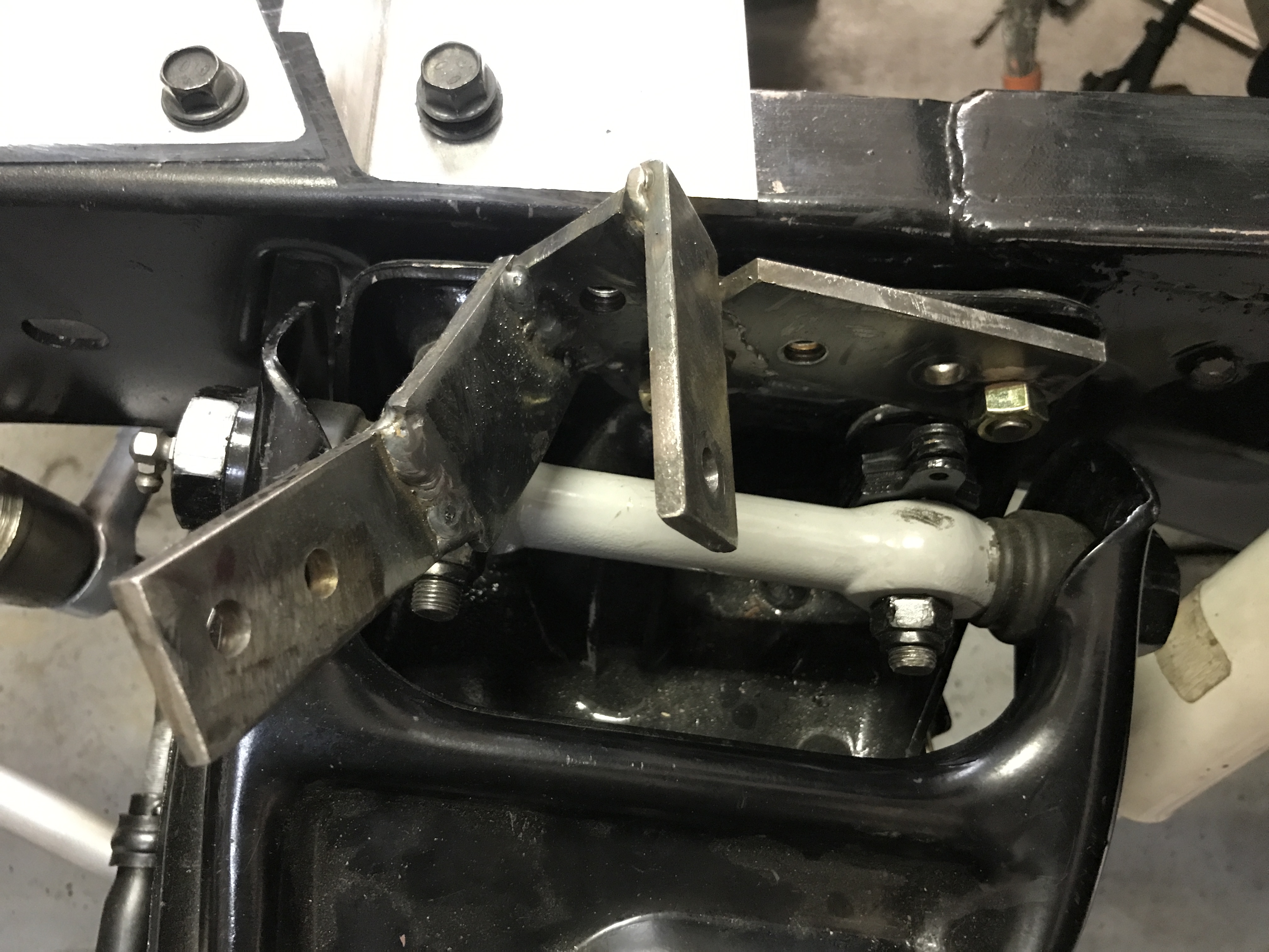

1984 Voltswagen Rabbit DIY EV Conversion Motor Mounts Part 4

Gregski wrote: Fri Mar 15, 2024 3:23 pm 1984 Voltswagen Rabbit DIY EV Conversion Motor Mounts Part 4
Nicely done! Your welding seems solid.
My mindset to building new mounts was to make them removable or better yet them allow me to directly access the motor and stuff that i would need to replace or service. I would be really annoyed some day if i would have to take complete transmission out because i have to get to the power steering....
Of course i have done it that way and i had to correct it eventually - Murphys law at work :).

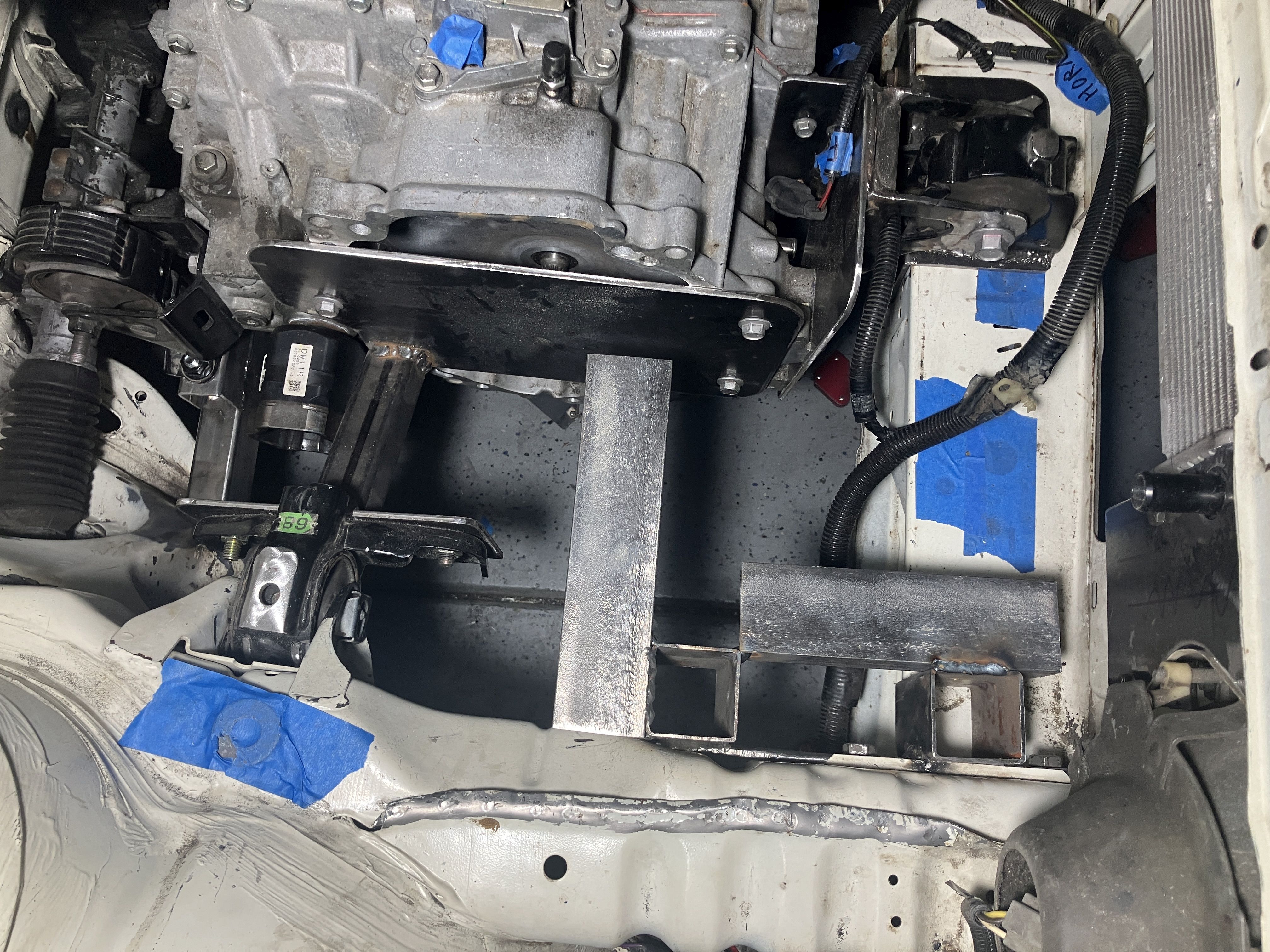

nice that will add some stiffness, but there is the original motor mount right under the rack.
i made a cradle that bolted on to the motor mount and to the front grill section on the cabriolet.

Bratitude wrote: Fri Mar 15, 2024 11:06 pm nice that will add some stiffness, but there is the original motor mount right under the rack.
i made a cradle that bolted on to the motor mount and to the front grill section on the cabriolet.vwunder.jpg
cool I see you made yours run front to back I made mine run left to right

Gregski wrote: Fri Mar 15, 2024 11:47 pm cool I see you made yours run front to back I made mine run left to right
One of the popular mods on these back in the day was a lower k frame brace. It connected the 2 forward lower control arm bolts together - very similar to your brace.
I'd feel a lot safer with the brace going left to right (as you have it) in an accident. Adding tubes front to back are tricky to make / guesstimate for crash safety.
Most of the mk1's have rotted k frames on this coast. It's surprising to see one in that good of shape. I know you're battling some rust but its looking much better than what we commonly have here.

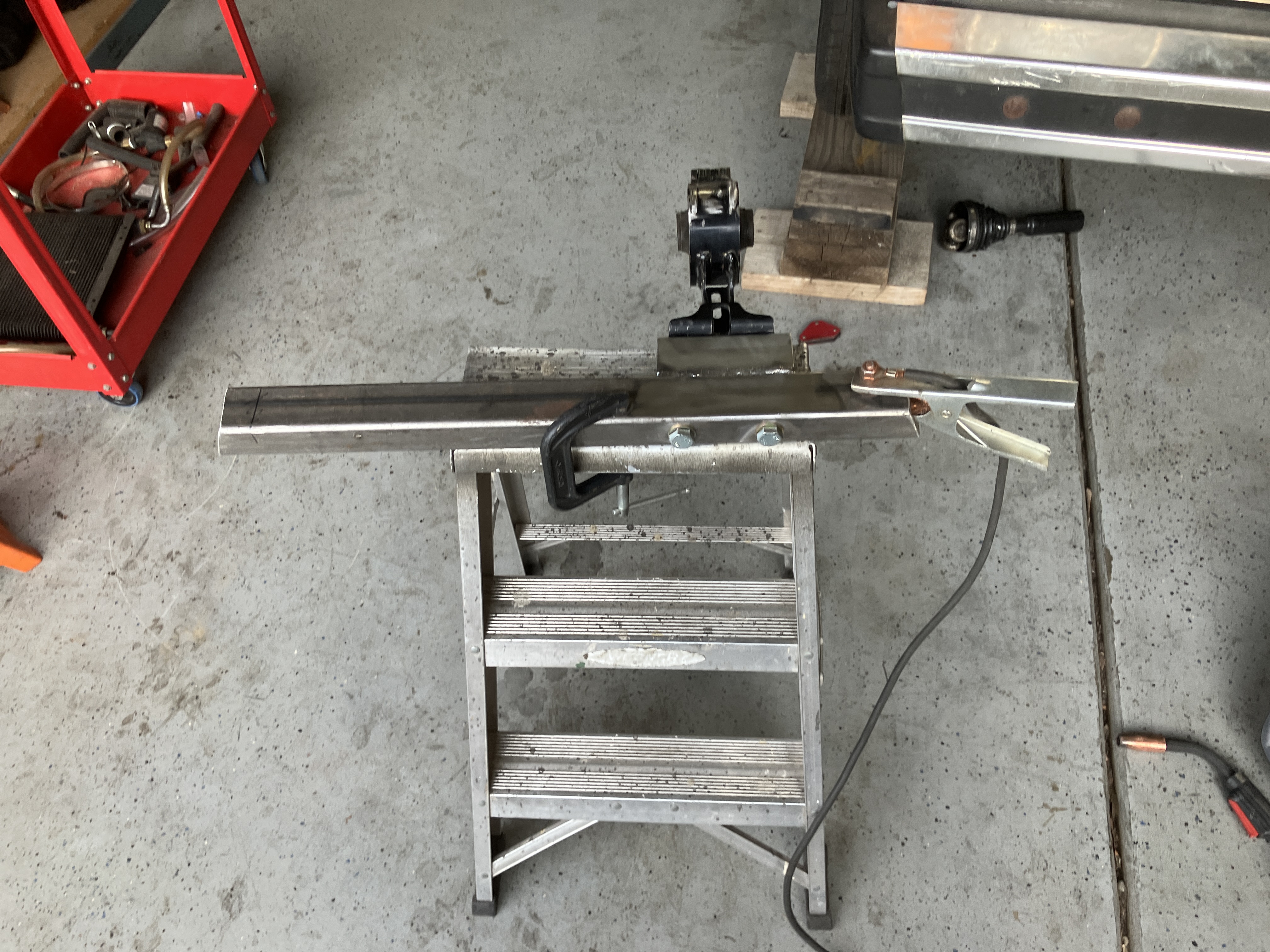

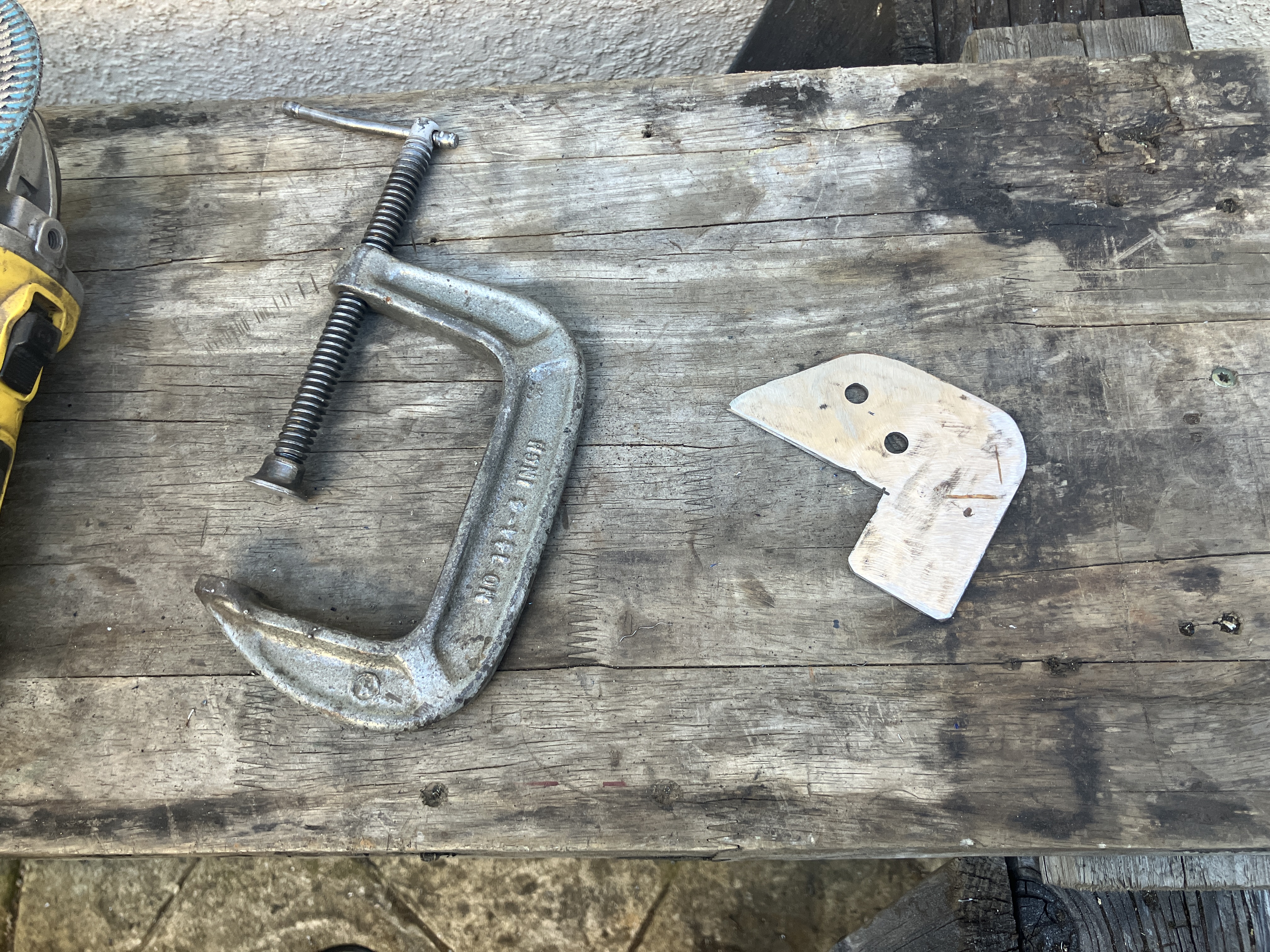

then it was time to lay down some dimes, I bet you can't even tell the difference between the last two pics

Gregski wrote: Sat Mar 16, 2024 6:04 pm then it was time to lay down some dimes, I bet you can't even tell the difference between the last two pics
the seam is not heated up enough, there is no need to rush.

midway wrote: Sun Mar 17, 2024 10:58 am the seam is not heated up enough, there is no need to rush.
thank you, I am having difficulty seeing the puddle, I run the VIKING 1740 Matte Black Welding Helmet K3282-3

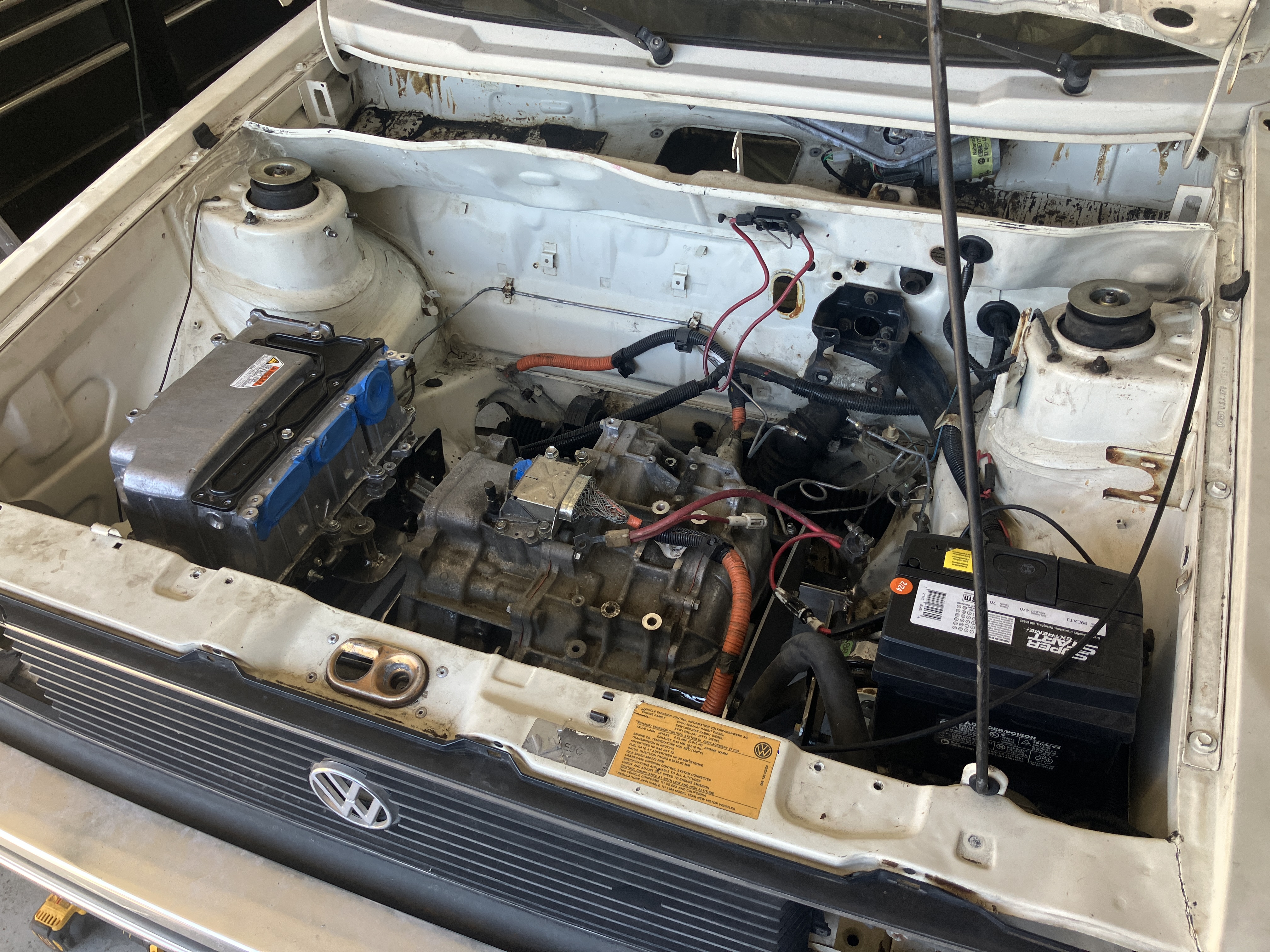

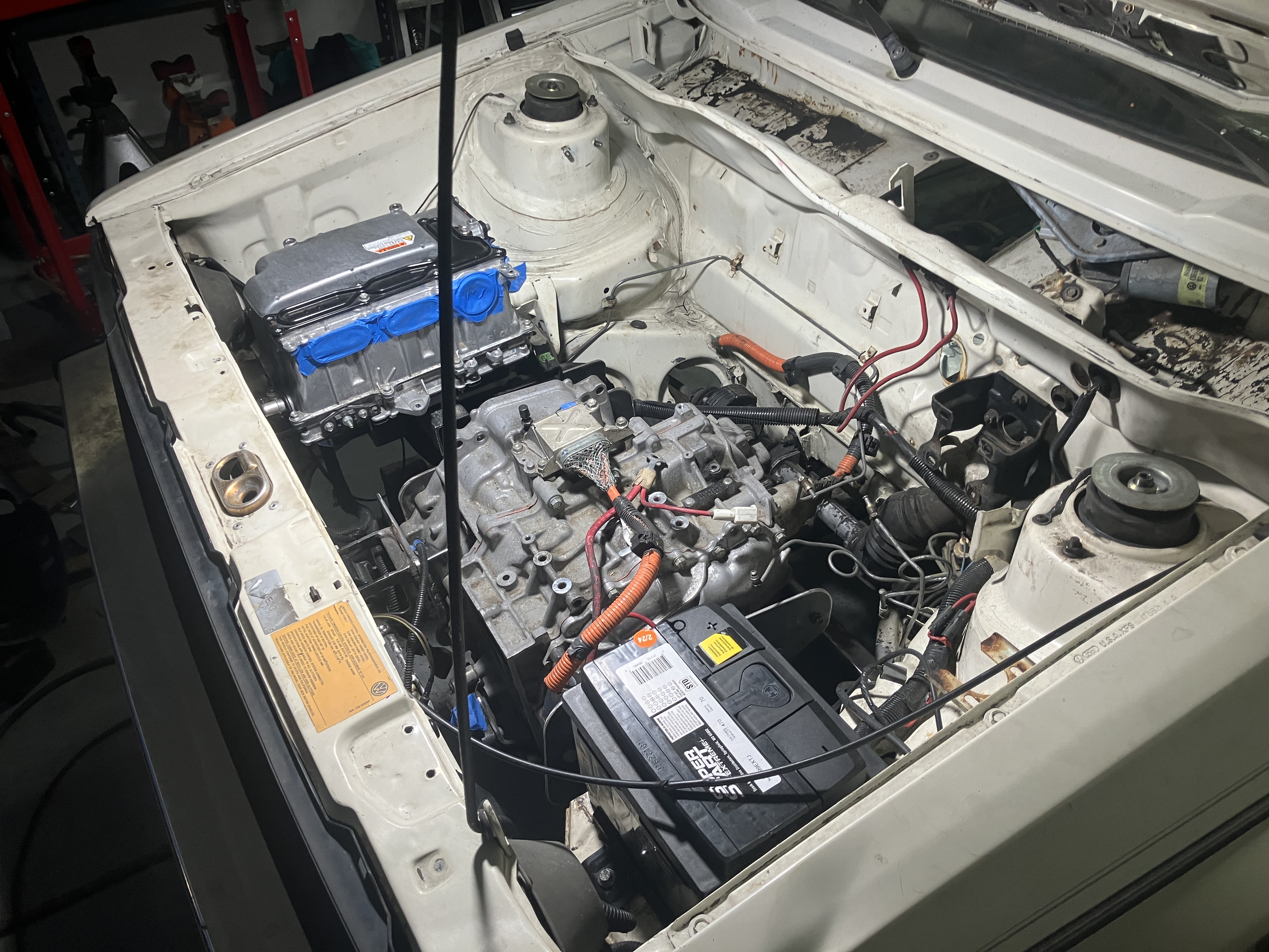

Gen 3 Toyota Prius Inverter in a 1984 Volkswagen Rabbit

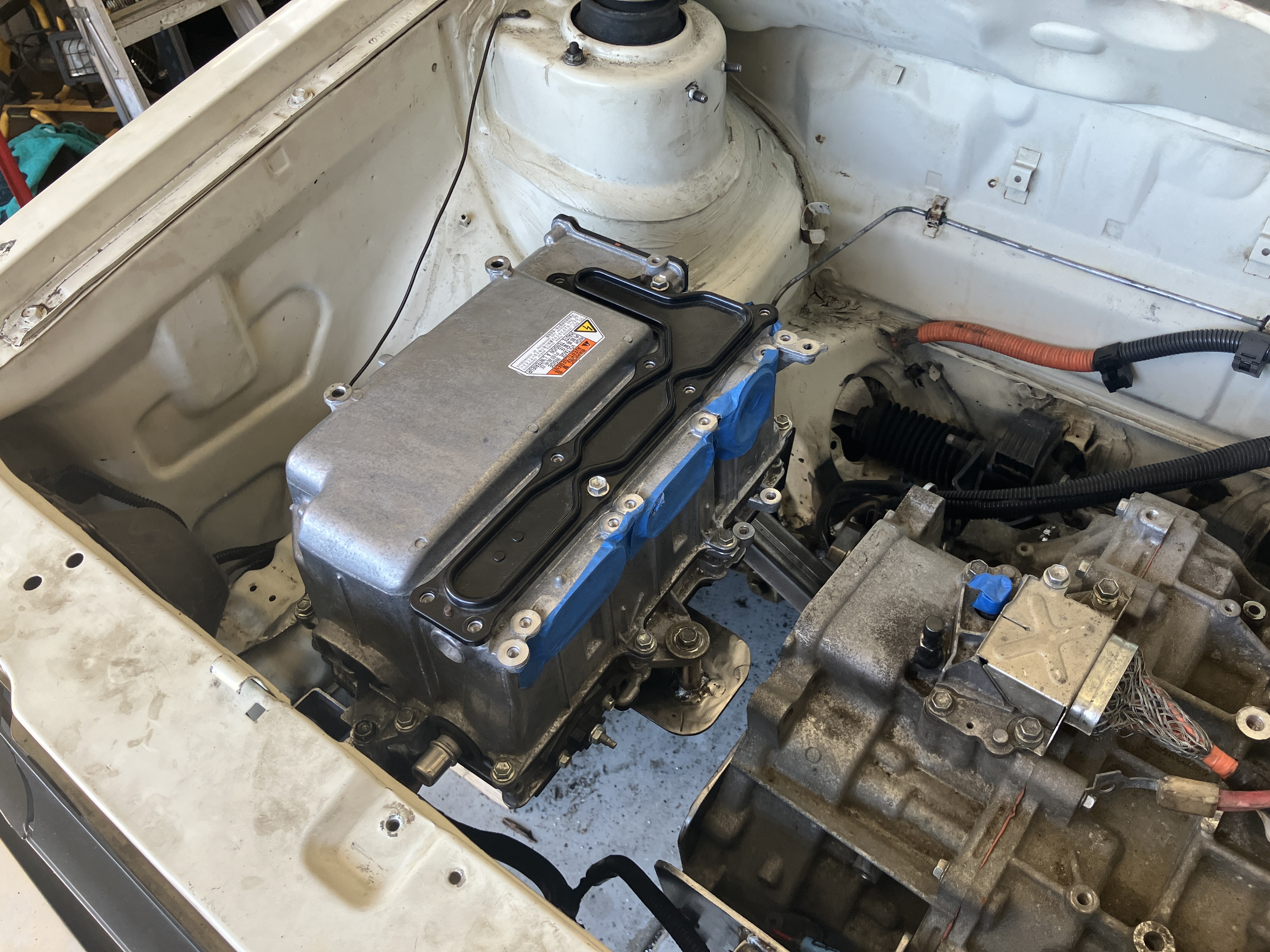

Post by Gregski »
Scraptastic
one of 900 trial fits

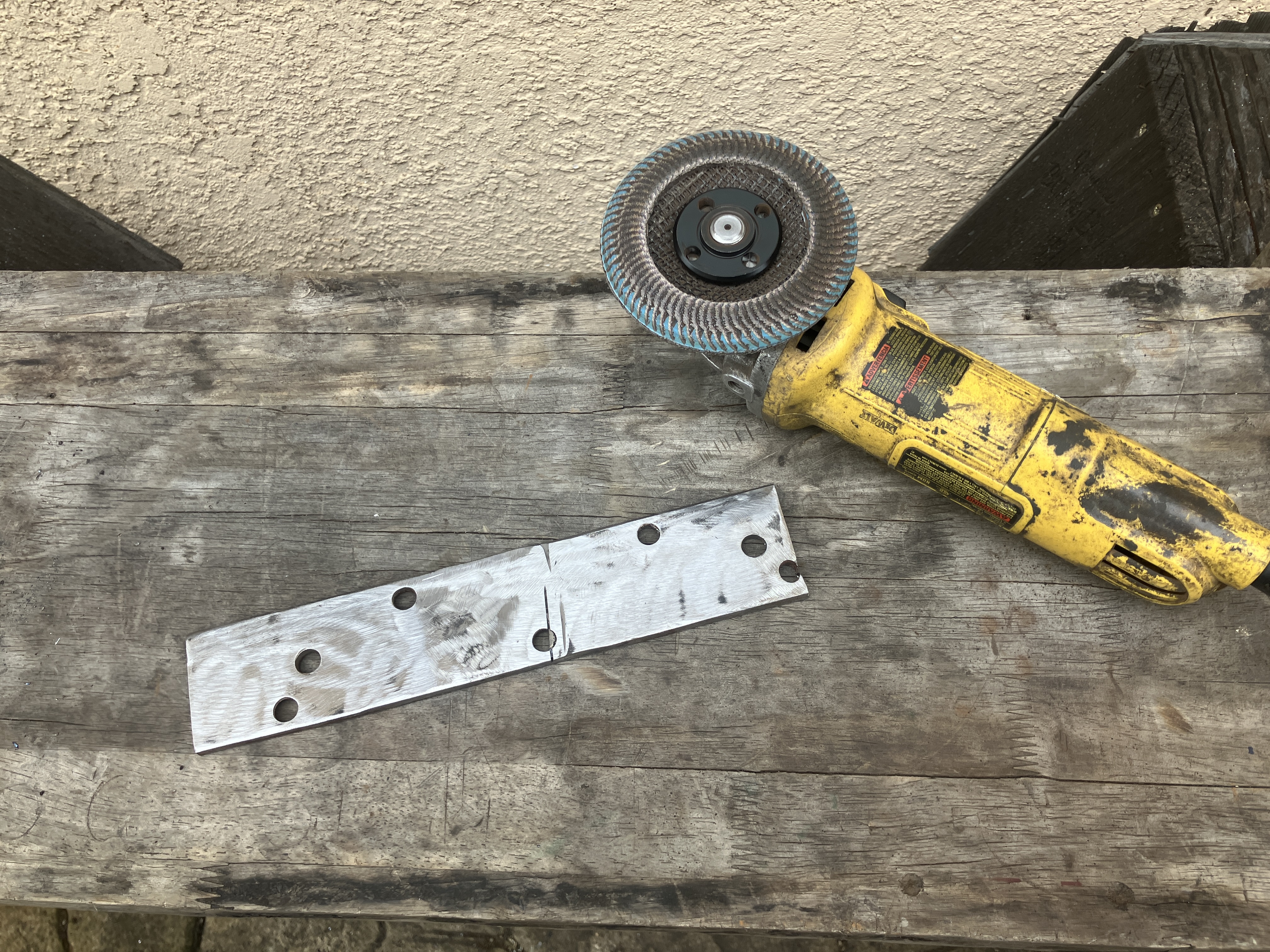

Post by Gregski »
this inverter bracket aint gonna fugly itself

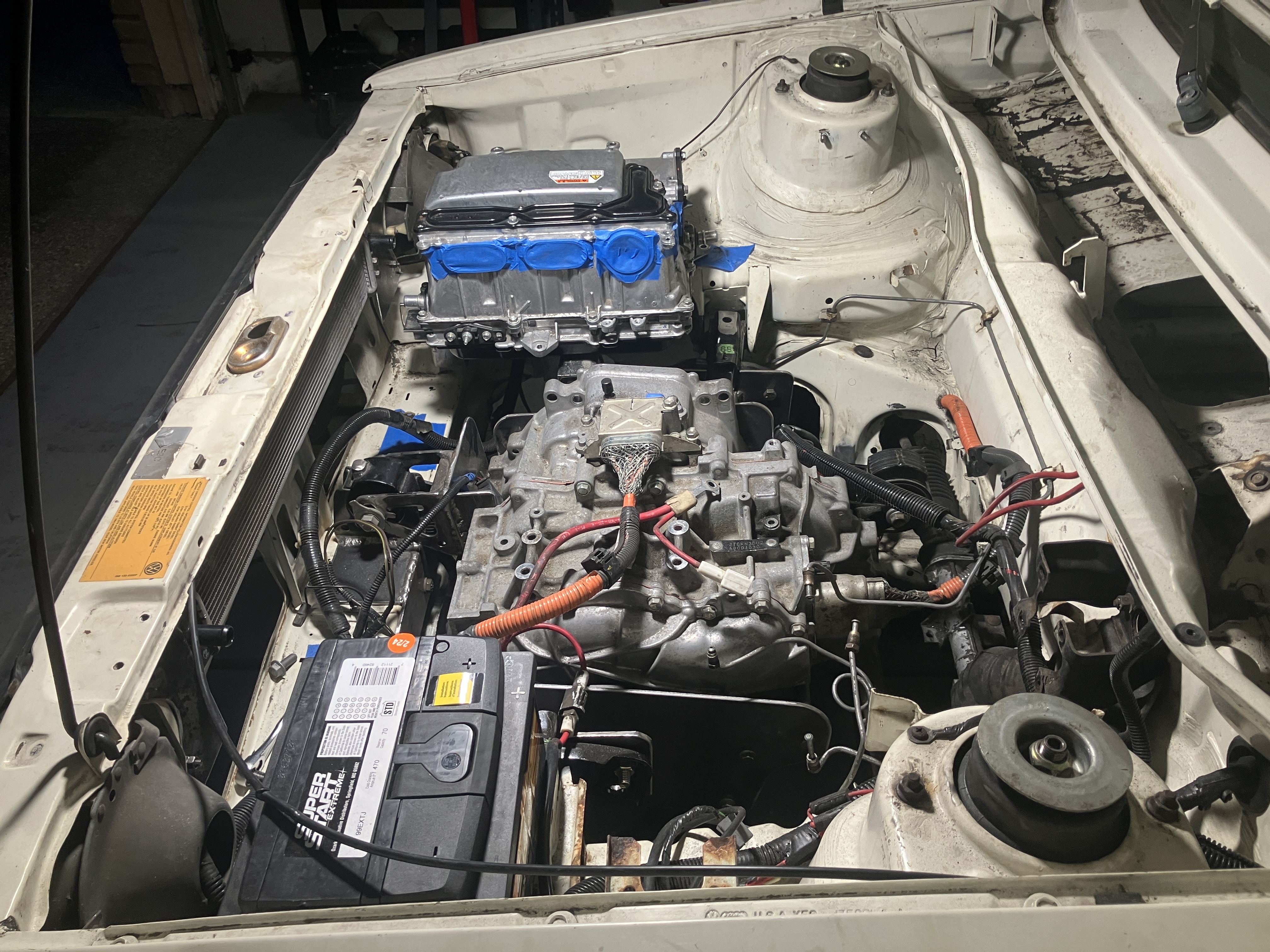

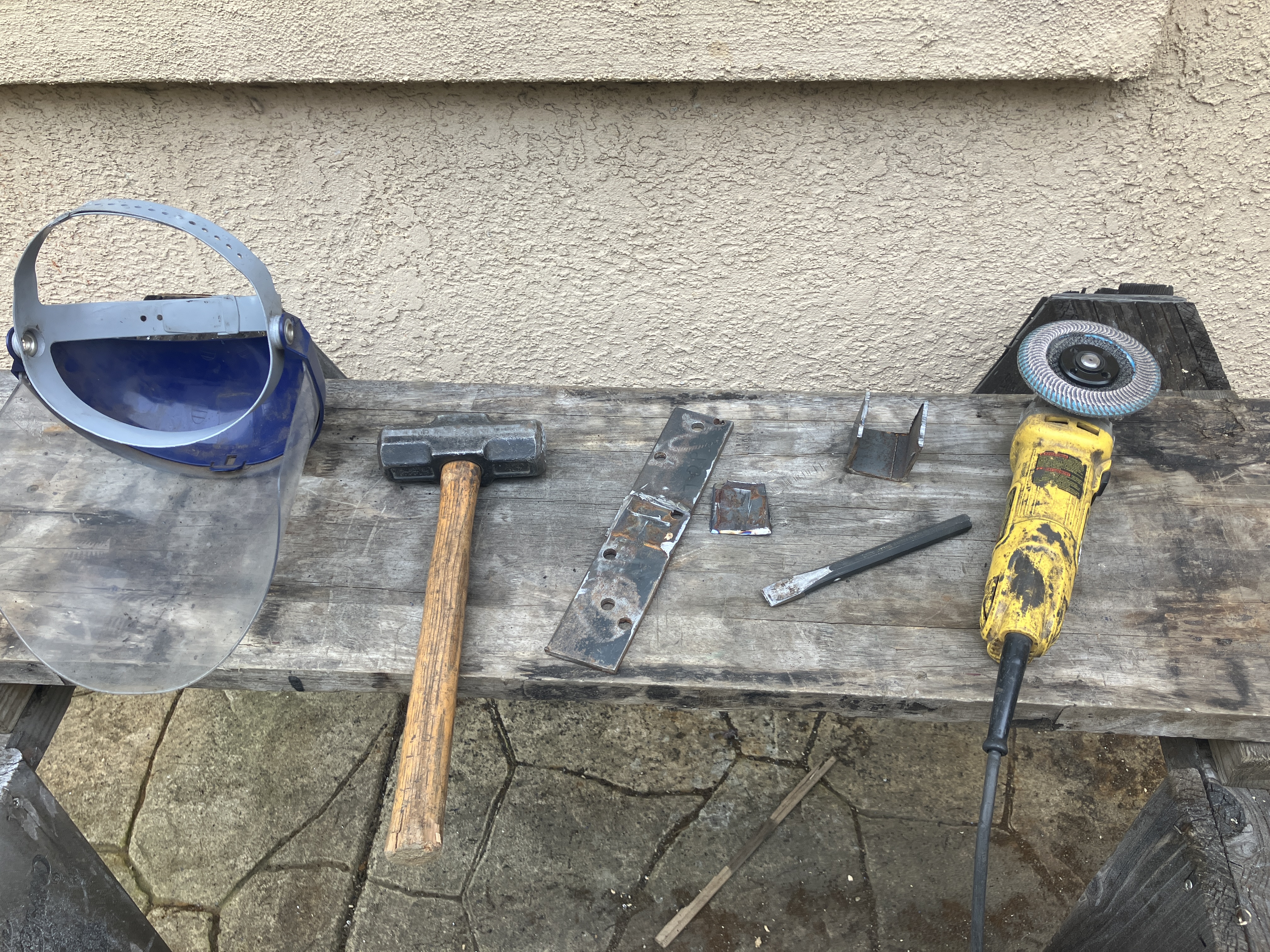

and she's in there for good(ish), note the pedestal riser mount thingies

That is truly the ugliest bracket I have ever seen in my life. I watched it evolve and am still shocked at its form. If a bracket could have a spirit animal, it would be a platapus... after dancing with a woodchipper. It's like a Picasso of what a bracket should be. Horrendously patchworked, stylistically inconsistent, geometrically outcast, supportively cantilevered, and hopefully at least structurally significant else all you've created is a lump of what could only of the thinnest definitions be called "art" and best placed at the end of a boat chain. What a deeply shameful design. My only solace is that it was immediately hidden by the inverter and I shan't have to gaze upon it again. It's a cointoss whether your car now needs an exorcist or whether I need a rag, some chloroform, and some cartoons to wake up to to forget it was ever under there.
My confidence in the rest of my own build has risen significantly after being subjected to that.

MattsAwesomeStuff wrote: Wed Mar 20, 2024 11:48 pm That is truly the ugliest bracket I have ever seen in my life. I watched it evolve and am still shocked at its form. If a bracket could have a spirit animal, it would be a platapus... after dancing with a woodchipper. It's like a Picasso of what a bracket should be. Horrendously patchworked, stylistically inconsistent, geometrically outcast, supportively cantilevered, and hopefully at least structurally significant else all you've created is a lump of what could only of the thinnest definitions be called "art" and best placed at the end of a boat chain. What a deeply shameful design. My only solace is that it was immediately hidden by the inverter and I shan't have to gaze upon it again. It's a cointoss whether your car now needs an exorcist or whether I need a rag, some chloroform, and some cartoons to wake up to to forget it was ever under there.
lOl, my trucks Prius EPAS bracket has entered the chat
