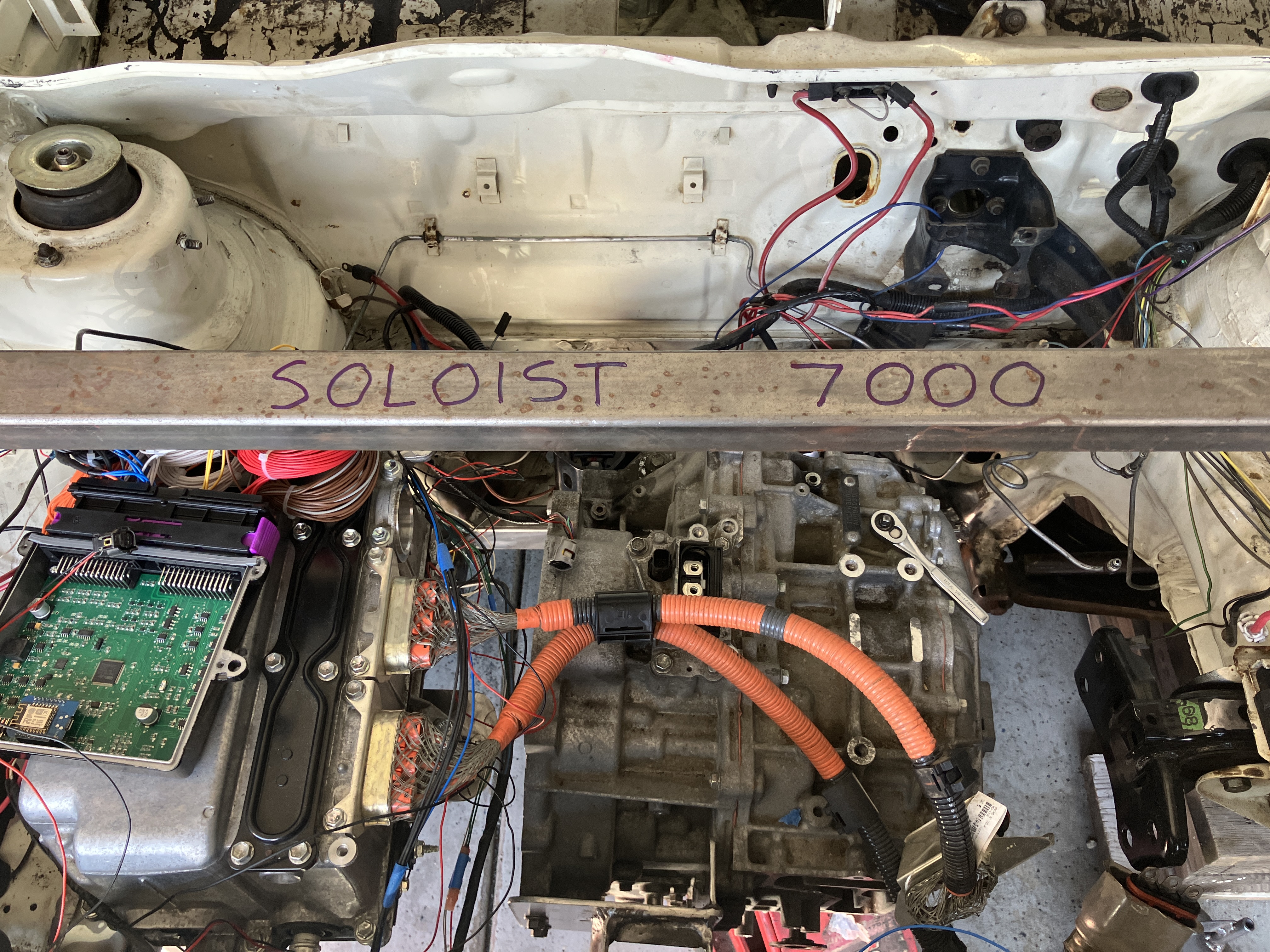

I decided to drop the transaxle, so naturally first I had to either grow a third arm, make some friends, or invent the Soloist 7000

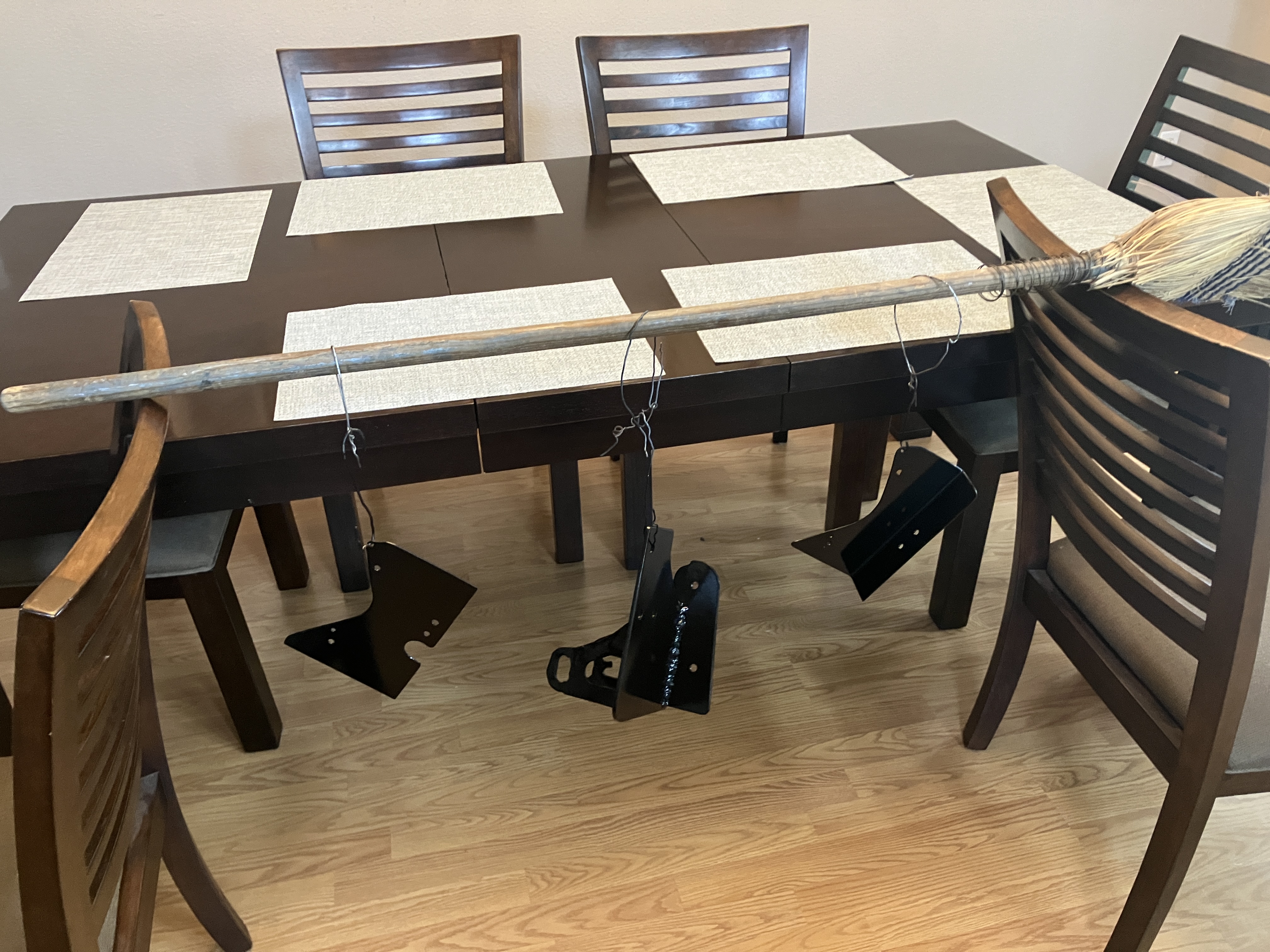

with the transaxle out I thought it was as good a time as any to make some things black (after making them red)
I luv this primer
I wanted to hang these up to cure in the garage, but the wife insisted I move them into the formal dining room, while she's on Girls Weekend Out !
I luv this primer

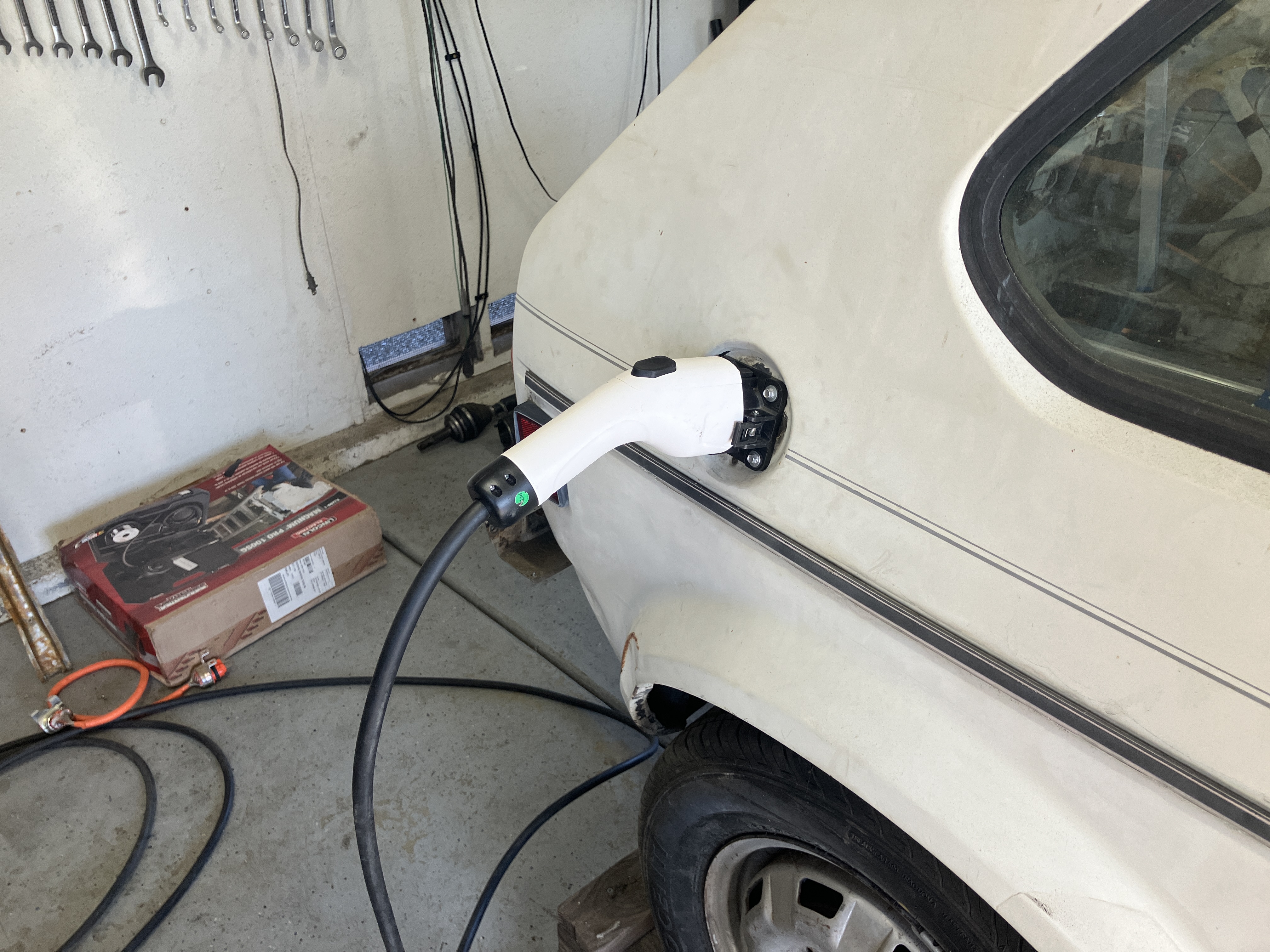

VW Rabbit DIY EV Charge Port
some day I'll own a car with a fuel filler door

Charge port install in 3:50 single take - in sport climbing we'd call it onsight

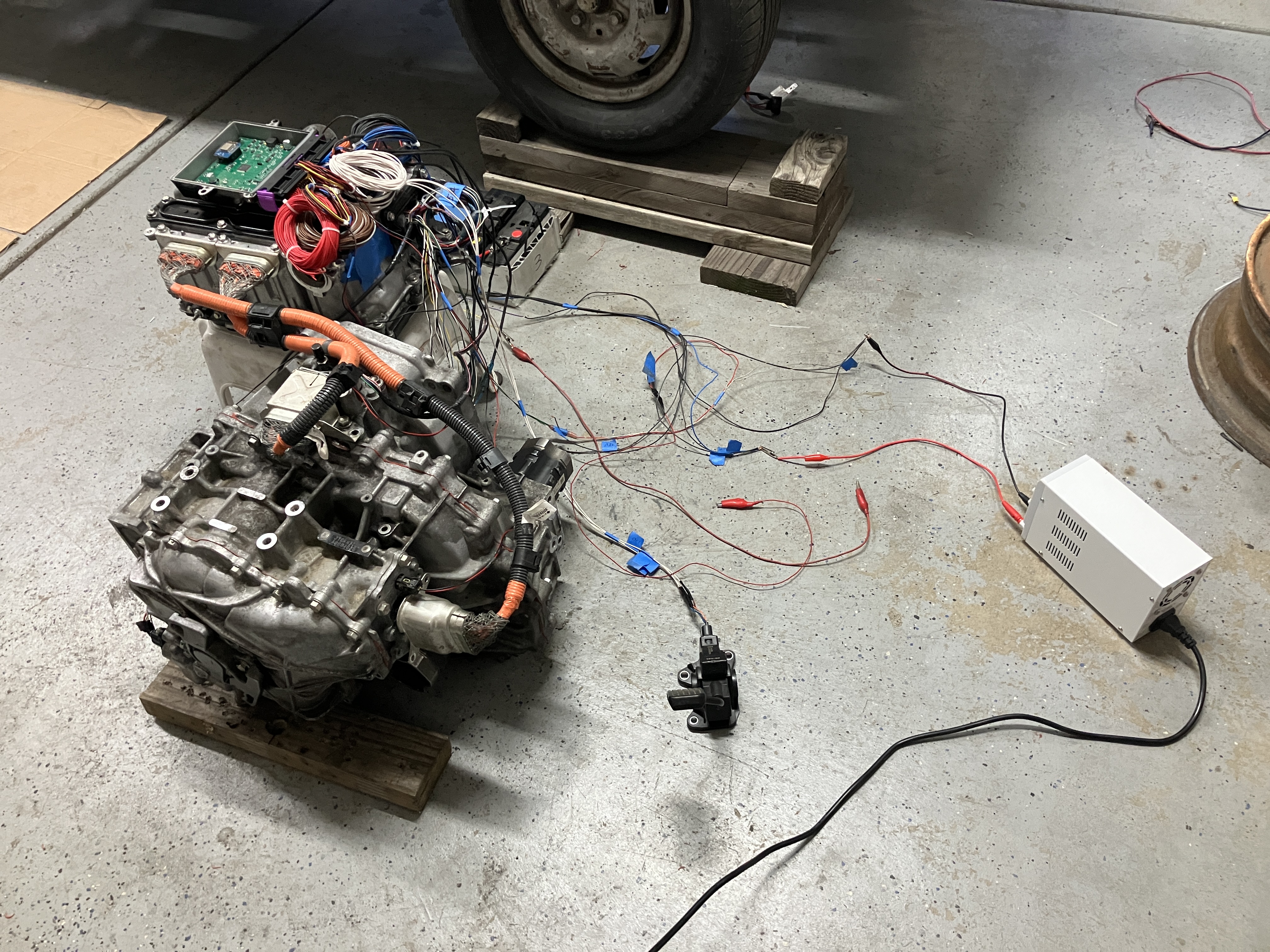

First motor spin... [again]
always, sometimes, bench test first
the battery module is from a 2018 BMW 530e (same as the 330e)
throttle pedal is from a 2010 Honda Fit (cause I thought maybe the Prius one was whack, but turns out it is fine)

Great work here, have just stumbled across your build..
For this spin up, think was a mention somewhere of changes made by forum folks.
Wondering if still using 2.05a code, or a mod to it?

There is a mod in the works (not by me Damian and others) that's going to fix the issues, so rather than potentially adding a bug and have an accident and the bad publicity that might be causes it would be prudent to wait for the fix.

Yes I am still using 2.05A with a change to a parameter called tmpmmax = 300
I posted this specific issue under the OEM Specific Topics where some of the developers have chimed in
Gen 3 Prius Transaxle P410 Makes Clunky Noise
