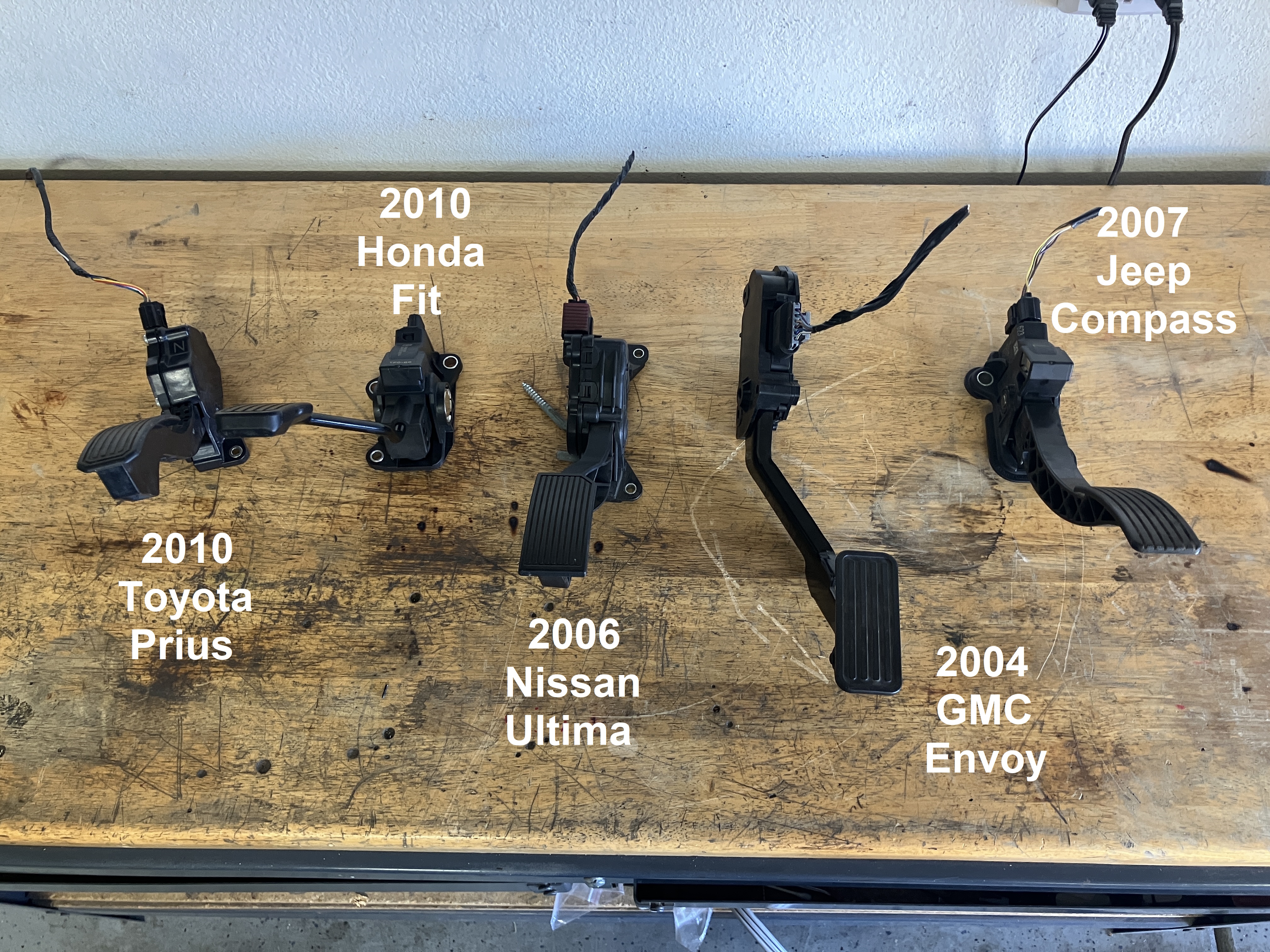

VW MK1 Rabbit Electric Throttle Install
- Gregski
- Posts: 2755
- Has thanked: 508 times
- Been thanked: 1069 times
first we tried a 2010 Toyota Prius pedal to keep it in the family
because of the wiggliness in the Rabbit firewall I had to make a block for an offset
nice thing about metal is that you can weld up the holes you don't want
- Gregski
- Posts: 2755
and then I decided to go with one that [ahem] fit, as in 2010 Honda Fit
- Posts: 1021
- Has thanked: 409 times
- Been thanked: 261 times
The first part of this video is solid gold. I hadn't considered that you didn't just pick a bunch of pedals, you chose ones that were all different. Maybe even on purpose!
I'm going to try to get around to adding that info to the wiki somewhere, I think a lot of people could benefit from it.

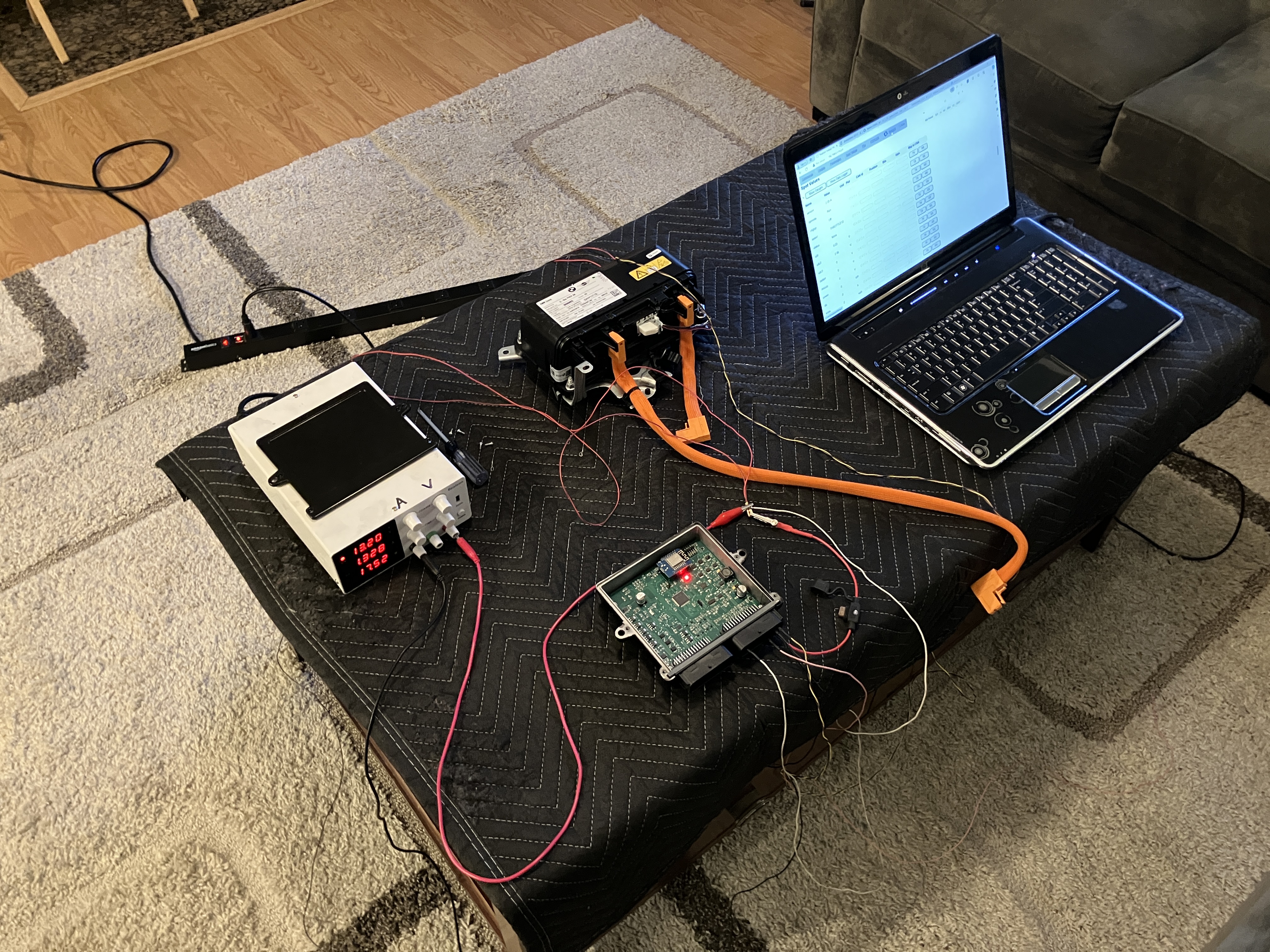

while I'm literally waiting on the paint to dry I decided to have at the Zombie controlling the BMW Safety Box
things weren't working, so T-Bone my trusty assistant, suggested we plug more skinny wires into the Zombie
and that did the trick

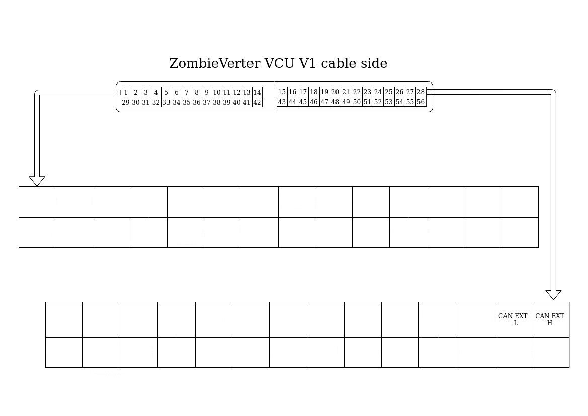

ZombieVerter VCU - Permanent Power Connection
This is the minimum wiring required to access the Zombie via it's Web Interface. Requires two pins. The Zombie is always "on" maybe a better term would be enabled, this is required to detect charge mode and facilitate timers.
Pin #55 - negative / ground
Pin #56 - positive / 12 volts (fuse recommended)
- Gregski
- Posts: 2755
ZombieVerter VCU - Ignition Connection
In addition to the two wires above, we need a third wire, this wire when disconnected turns the Zombie OFF. However when connected it does NOT change the mode at all, for that to change see Start Connection below.
Pin #15 - positive / 12 volts (fuse recommended)
- Gregski
- Posts: 2755
ZombieVerter VCU - Start Connection
In addition to the three wires above a fourth wire is needed to put the Zombie in RUN mode. This requires a momentary switch, think of turning the key in the ignition switch to the Start position and have it automatically spring back after the starter starts the engine.
Pin #52 - positive / 12 volts (fuse recommended) momentary only
- Gregski
- Posts: 2755
ZombieVerter VCU - CAN1 Connection
The Zombie supports three different CAN channels, this is the first one. It requires two wires one for CAN High signal and a second for CAN Low signal. Usually this two wire pair is twisted together aka a twisted pair. This requires two pins.
Pin #27 - CAN Low will run from the Zombie to some CAN device (Charger, Safety Box, etc.)
Pin #28 - CAN High will run from the Zombie to some CAN device (Charger, Safety Box, etc.)
