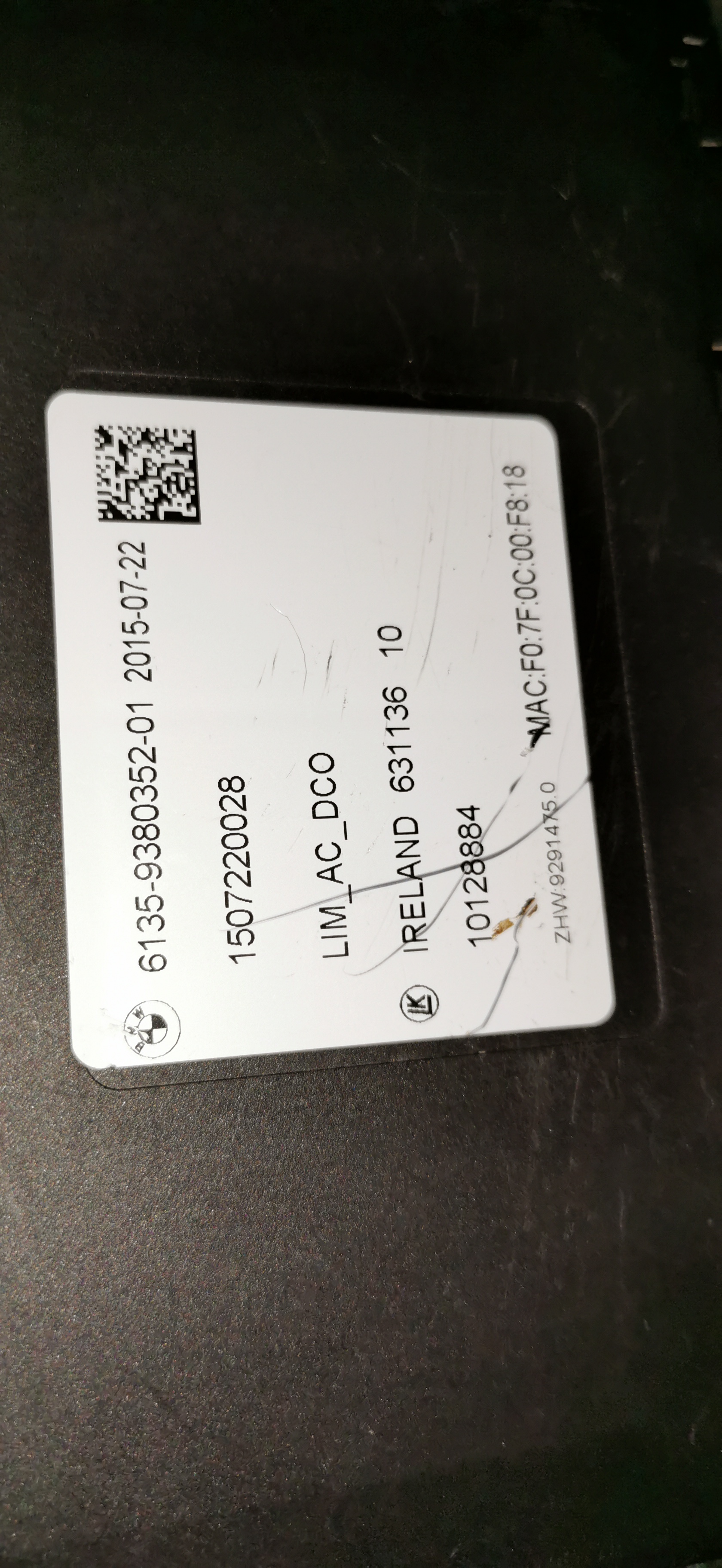

In the past I could not get LIM to work, its 61356828052-01 2017-08-16 with BMW i3 charging port. For AC charge it will lock the charge plug but never activate CP to activate EVSE, I get CP and PP amps and chargepower is transmitted to the LIM. CCS weldtest always fails to d12, which should be "0011 Last requested contactor adhesive diagnosis could not be carried out". Could weld test needed for AC, no?
Now I moved it to table test, 15R resistors simulating contactors and switches for cp door and wake. If I supply voltage to measuring input, state changes from d28 to d24 and I still can't get it to pass weldtest just d12 as a result.
Could there be something I'm doing wrong? Also AC charge missing CP activation is a bit mystery.

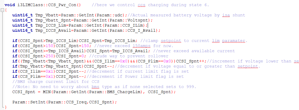

Here is the BMW I3 LIM github, it includes code that was used before it was tranfered into the ZombieVerter, possibly does not support AC charging, along with a CAN dbc.
https://github.com/damienmaguire/BMW-i3-CCS
https://github.com/damienmaguire/Stm32- ... /i3LIM.cpp Here is Zombie file you need to use. Alot of the values are fixed so it is quite straight forward.
Even the WIKI has a list of the CAn messages. https://openinverter.org/wiki/BMW_I3_Fa ... LIM_Module

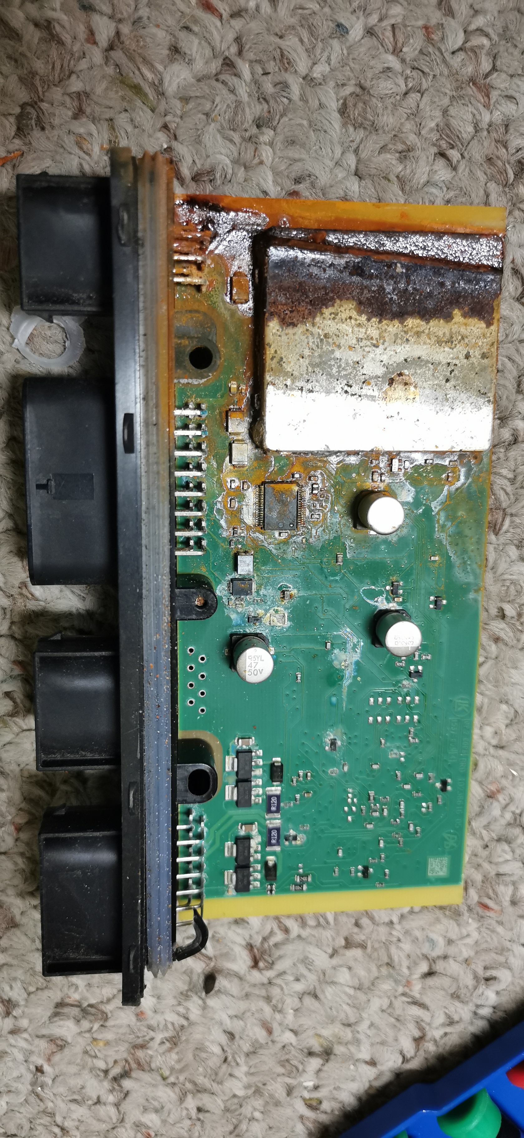

- Posts: 277
- Has thanked: 71 times
- Been thanked: 29 times

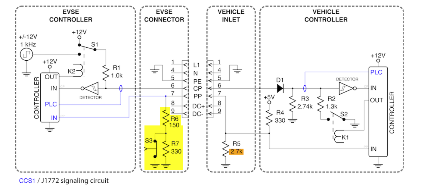

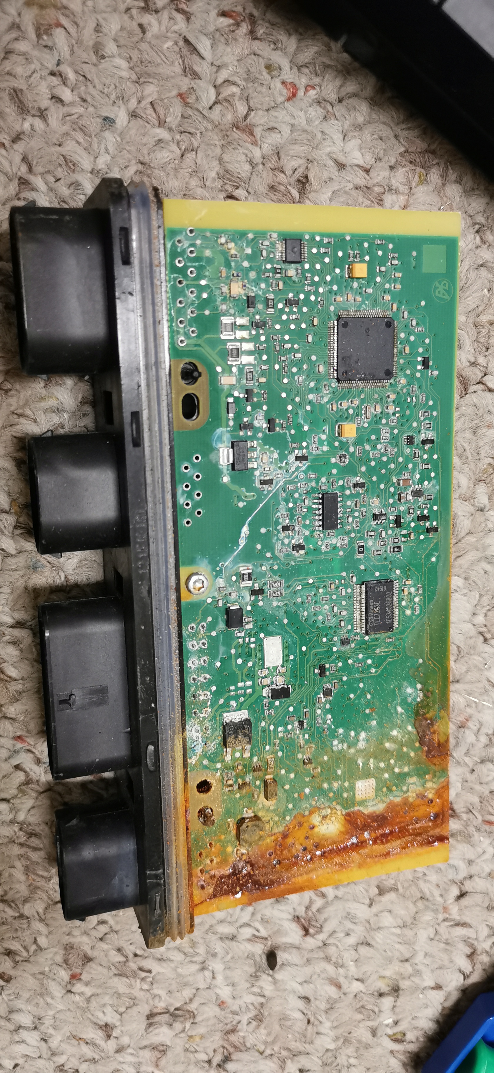

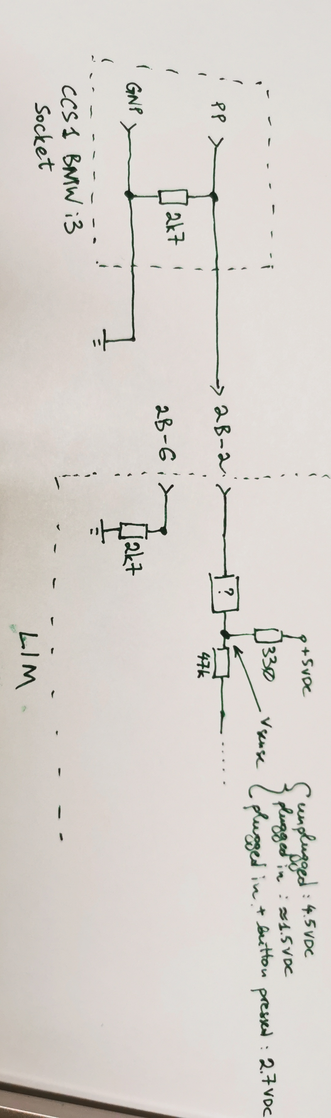

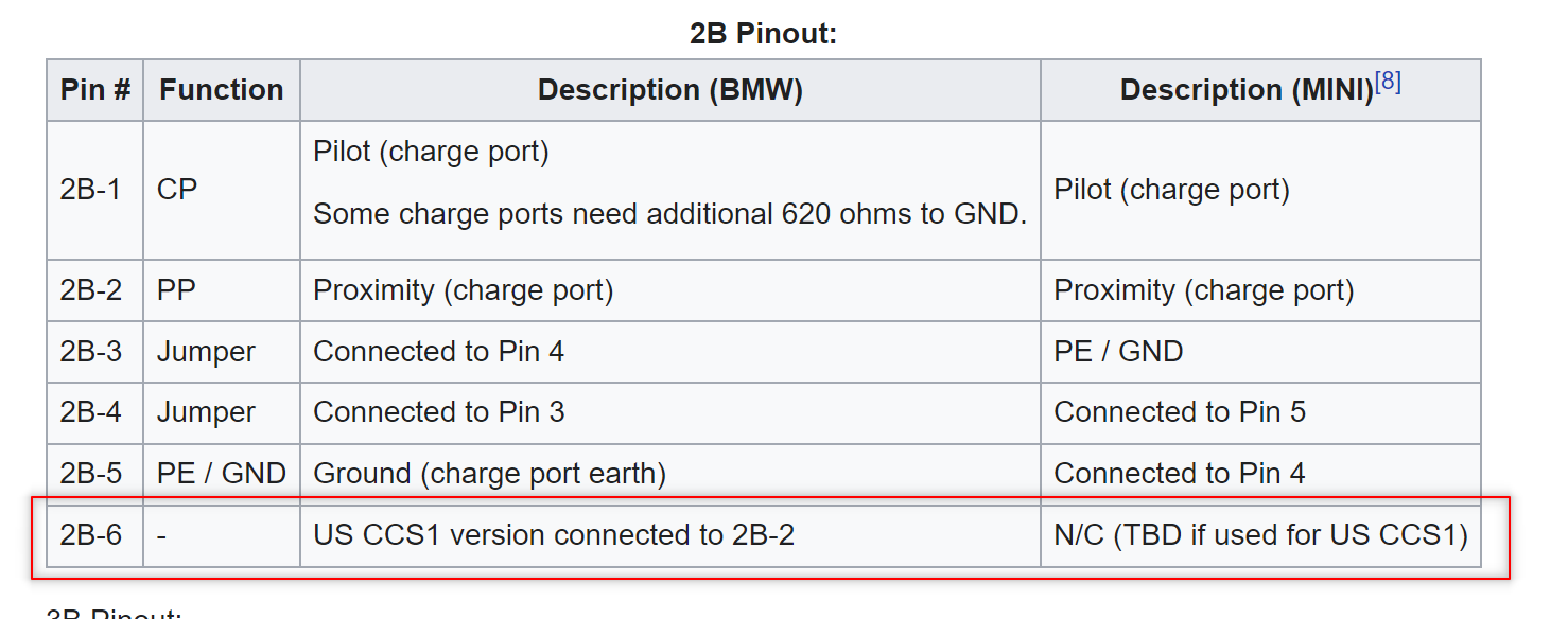

None of the LEDs driven by the LIM turn on. I tested LEDs with the meter, they light up and are the correct polarity. I tested the voltage on LIM outputs for the LEDs (2B-6, 2B-7, 2B-8 referenced to 2B-9) - 0VDC on all of them whether the charger is inserted or not.

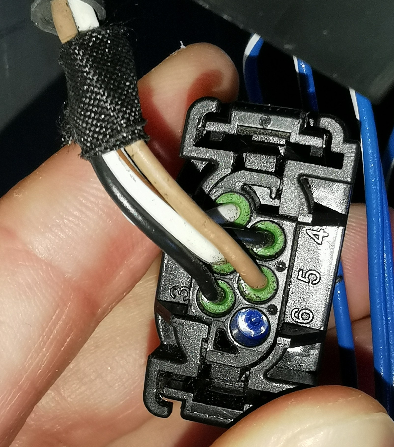

Since it's i3 socket the PP and CP are already prewired to the correct connector which goes to LIM 2B input. I verified that there's continuity from the socket to the correct connector pins.

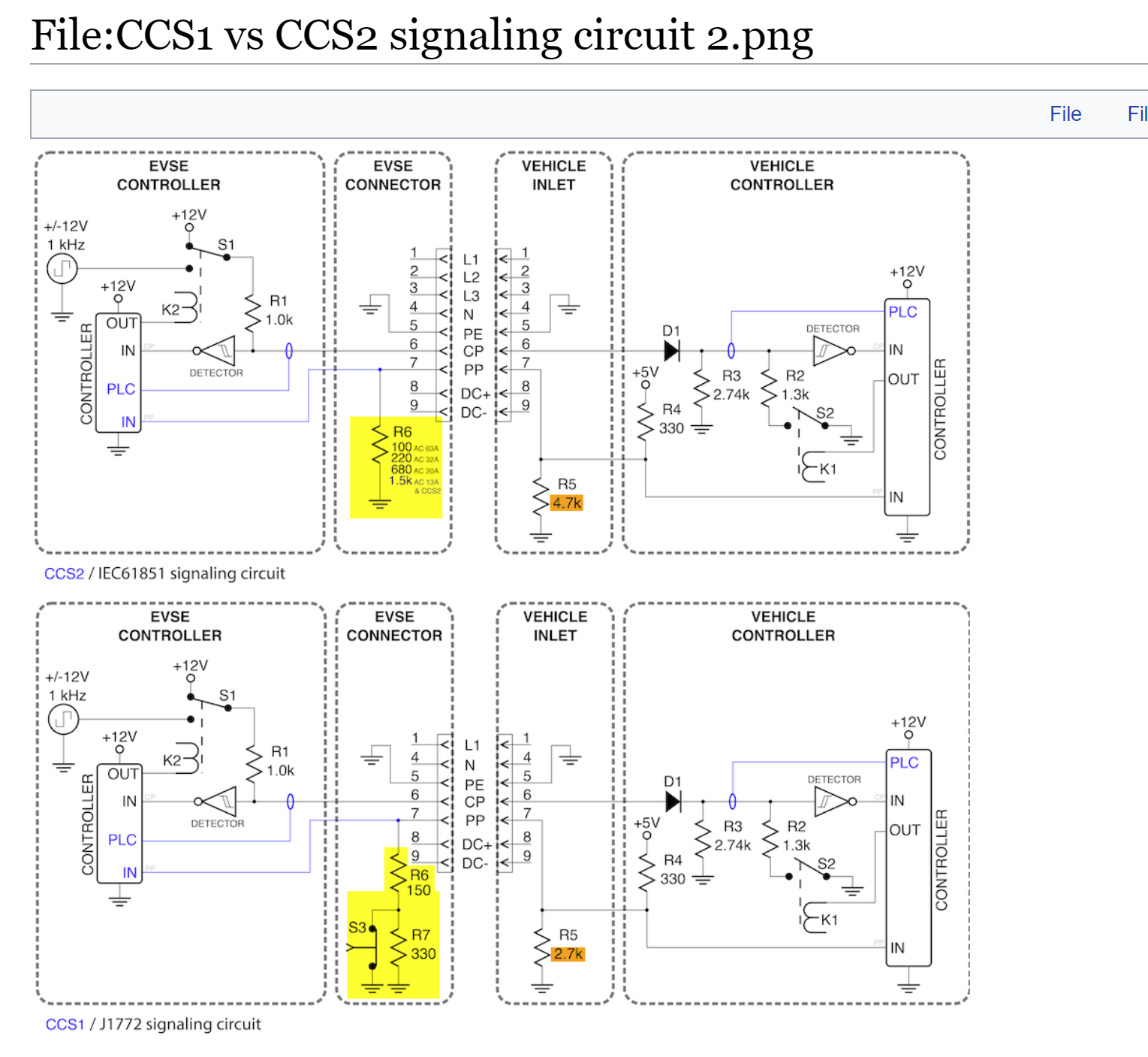

PP to ground reads 2k7, which matches wiki . I have a CC1 socket. My LIM came from Ireland. So maybe a mismatch!?
There's a note on the wiki about the "US" LIMs. The connector from my CCS1 socket doesn't have a wire on 2B-6. And 2B-2 and 2B-6 are not joined inside of my LIM. Below is a schematic of what it looks like inside of LIM. So looks like if we have a none i3 socket, just jumping 2B-2 and 2B-6 will do the trick and no need for the external resistor. My socket did come from the i3 so I left 2B-6 floating.
Still looking where the trace goes further as it disappears to a sub layer after 47k resistor, but the Vsense matches what I'd expect given the voltage divider in the charger plug+socket+LIM:
Charger unplugged - 4.5VDC; charger plugged in - approx. 1.5VDC; charger plugged in and the button on the J1772 pressed (stop charging) - 2.7VDC.
Not sure what component is which I marked as ?. Read close to 0ohms regardless of polarity.

Oh so you have a Type 2 coded LIM, note the wiki states that the BMW I3 Type 2 does not have a resistance to ground.
Try to remove the resistance to ground in the charge port to see if this allows it to operate as you would expect. As you would want the LIM to wake up correctly when the plug gets inserted.

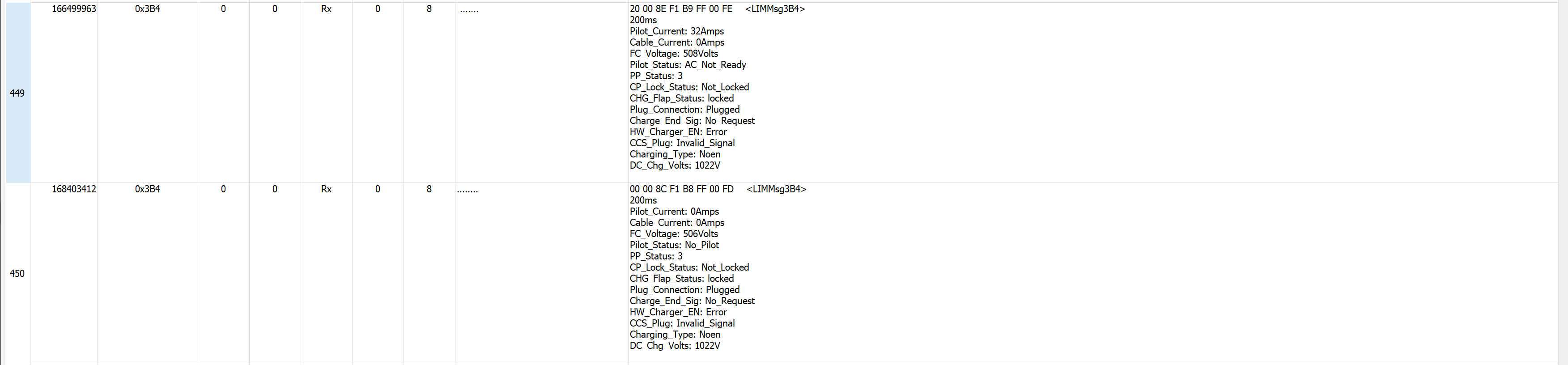

Removed. Still LIM reports the Plug Connection as plugged in, even with nothing inserted. All LEDs are off, plugged in or unplugged. Charger "Connected" LED turns on when plugged in, turns off when unplugged.tom91 wrote: ↑Thu Apr 04, 2024 10:06 pm Oh so you have a Type 2 coded LIM, note the wiki states that the BMW I3 Type 2 does not have a resistance to ground.

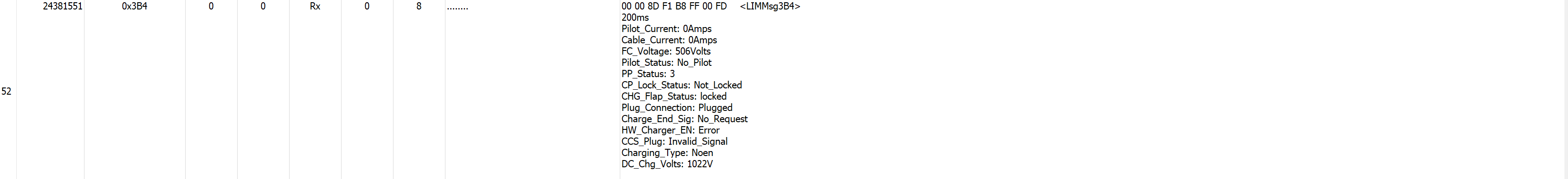

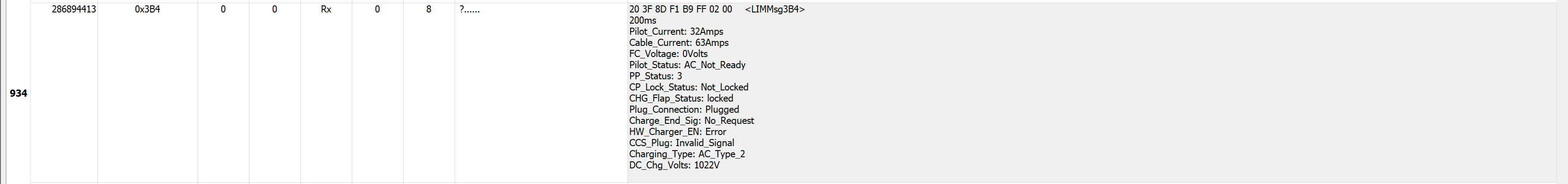

Snapshot of data when charger plugged in (pilot current =32A) vs unplugged (pilot current 0A) Maybe the R6 coding makes a difference since this is a CC2 LIM!? Edit: Ok. Something properly weird. While SavvyCAN reports plugged in all the time. My teensy VCU reads "no plug" when nothing is connected and "plug error" when cable plugged in. Which is something I'd expect given the R6 values in CCS2, none of which match those in CC1 plug.
In the VCU I'm decoding 0x3B4 byte2: PP = ((incoming.buf[2] >> 0) & 3);
Byte 2 when nothing is plugged in: 10001100
Byte 2 when plug is inserted: 10001110
Before removing the resistor from the socket. Both SavvyCAN and the VCU reported the same thing.

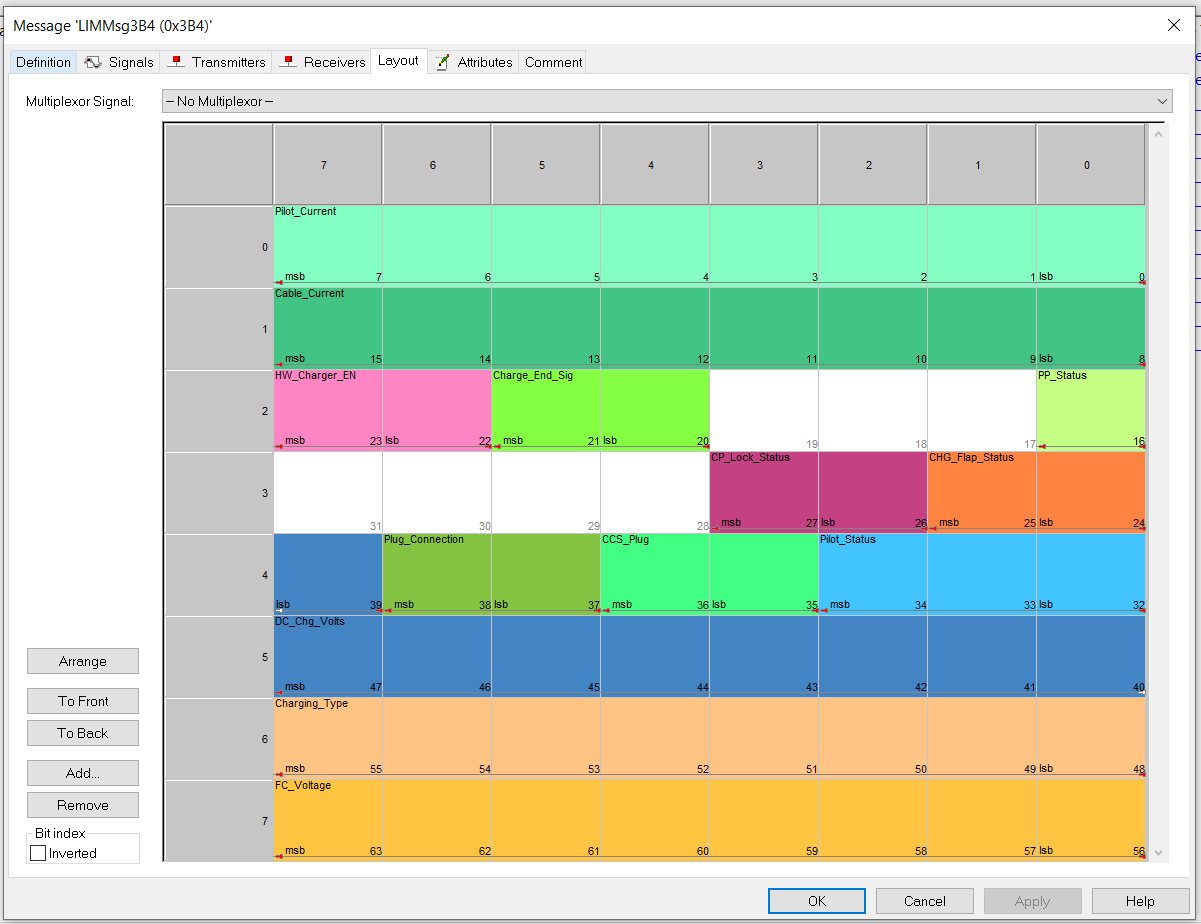

From the DBC file, it bit one that shows PP state, but most likely the three other bits also mean something.
What is the Cable limit after the resistor is removed?
If the LED lights up when plugging in things should be okay, what does it report the cable limit as?

the meaning of the 2 bits (16+17) is:
00 Not plugged in
01 Plugged in
10 Error
11 Signal invalid
the meaning of the next 2 bits (18+19) is:
00 Button not pressed
01 Button pressed
11 Signal invalid
only for type 1

Here's what I'm receiving on 0x3b4, decoded per my understanding. Looking back at my notes, before removing the resistor LIM did id the charger as Type 2 AC, but now doesn't.
I have watchdog setup and LIM Alive counter on 0x272 does update, so the data is refreshing.
Nothing plugged in to the charge socket:
byte[0] =0 - charger amps 0A
byte[1] =0 - cable max. 0A
byte[2] =10001100 - cable not plugged in (bits:0-1 = 00), CCS1/J1772 plug button invalid (bits:2-3 = 11)
byte[3] =11110001 - charge flap locked (bits:0-1 = 01), CP lock unlocked (bits:2-3 =00)
byte[4] =10111000 - pilot none (bits:0-2 =000), ccs plug invalid (bits:3-4 =11), plug connection - completely plugged in (bits:5-6 =01)
byte[5] =11111111
byte[6] =0 - charger type none
byte[7] =11111101 - volts on DC (scale 2V) = 251V
Charger plugged in and the button on the charger isn't pressed as well as plugged in and the button on it is pressed.
byte[0] =100000 - charger amps 32A (correct)
byte[1] =0 - cable amps (0A)
byte[2] =10001110 - cable error (bits:0-1 = 10), CCS1/J1772 plug button invalid (bits:2-3 = 11)
byte[4] =10111001 - pilot not charge ready 10-95% (bits:0-2 =001), ccs plug invalid (bits:3-4 =11), plug connection - completely plugged in (bits:5-6 =01)
byte[5] =11111111
byte[5] =11111111
byte[5] =11111111

So it could be a coding thing meaning using a type 2 LIM will not work with a Type 1 socket. You can always try adding the jumper as per wiki.
- Posts: 277
I removed the resistor permanently. So I followed my schematics and jumped 2B-2 and 2B-6 to reinto 2k7 resistor from PP to ground. Below is the data I've captured.alexbeatle wrote: ↑Thu Apr 04, 2024 9:29 pm The connector from my CCS1 socket doesn't have a wire on 2B-6. And 2B-2 and 2B-6 are not joined inside of my LIM. Below is a schematic of what it looks like inside of LIM. So looks like if we have a none i3 socket, just jumping 2B-2 and 2B-6 will do the trick and no need for the external resistor. My socket did come from the i3 so I left 2B-6 floating.
Also attaching the sticker from my LIM module.
I scrolled through all of the eBay listings last night. Were all of the LIMs manufactured in Ireland but then coded per the region!? All stickers I found say Ireland. Even those pulled from the scrapped cars in the US - say Ireland. Mine was actually shipped from a seller in Ireland.
There was a good last minute deal and I bought another LIM module last night ensuring it's from the US vehicle. Should arrive next week-ish. Hopefully it will give better results.
Thanks for your help. I'll report back when the new unit arrives.
nothing plugged in
0 =0 - charger amps 0A
0 =0 - cable max. 0A
10001101 - cable plugged in (bits:0-1 = 01), CCS1/J1772 plug button invalid (bits:2-3 = 11)
11111111
plugged in with wall charger powered off
11111111
plugged in
0/111111 -0/63 - cable max. 0A/63A (jumping back and forth in confusion !? R6=480Ohm isn't defined for CCS2)
11111111
10 - charger type AC-type2
plugged in with button pressed
100000 =32 - charger amps 0A
111111 - cable max.63A (steady)
11111111
- Posts: 277
Just FYI to the community.alexbeatle wrote: ↑Fri Apr 05, 2024 6:36 pm
There was a good last minute deal and I bought another LIM module.....
Beware of the good deals. DOA.
