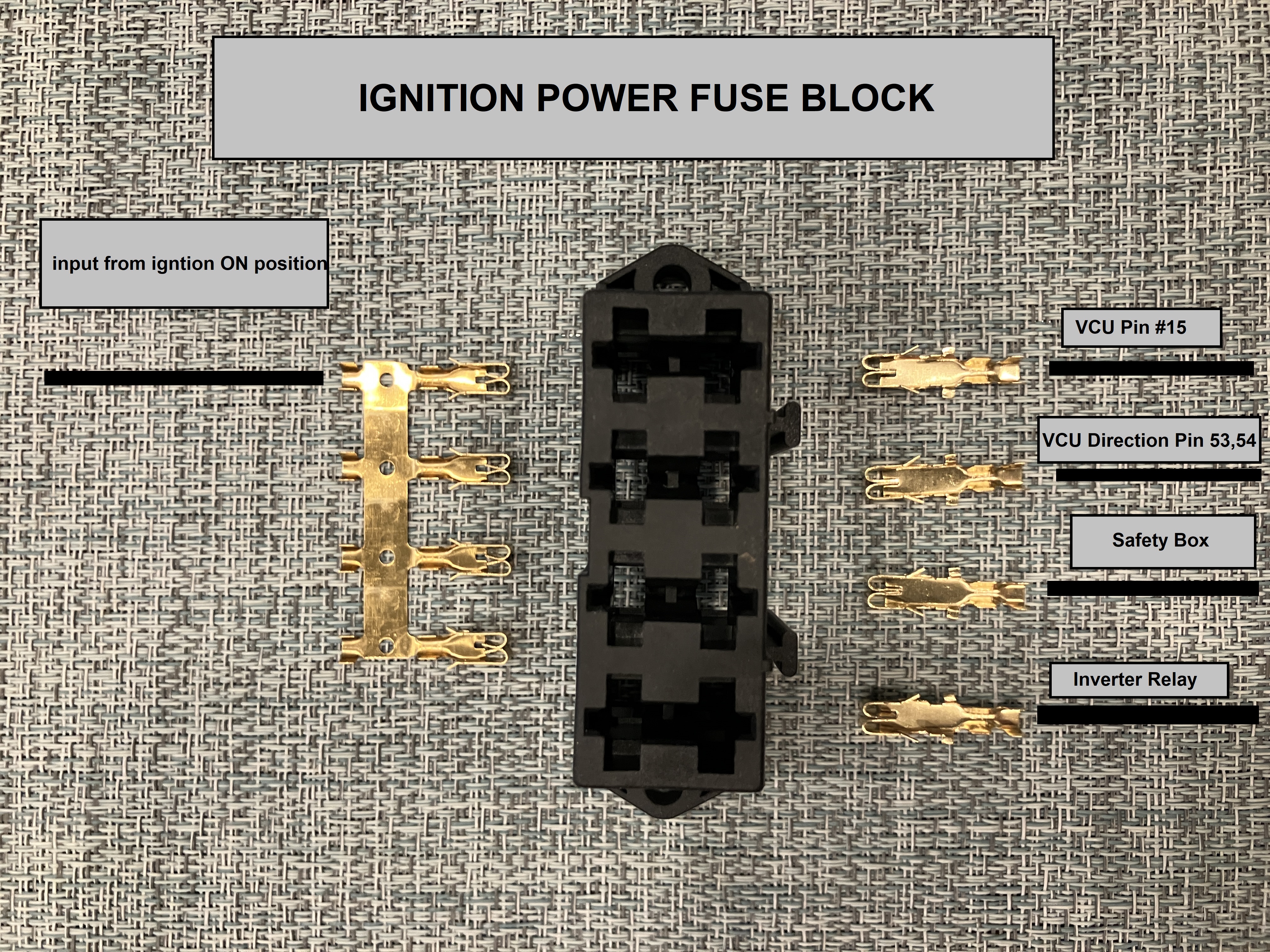

84 VW MK1 Rabbit DIY Wire Harness 3 - Ignition Power Fuse Block
the one where the Greg adds a second four fuse block, this one gets it's power when you turn the key in the ignition to On
The man responsible for the ZombieVerter tells us about Pin #15

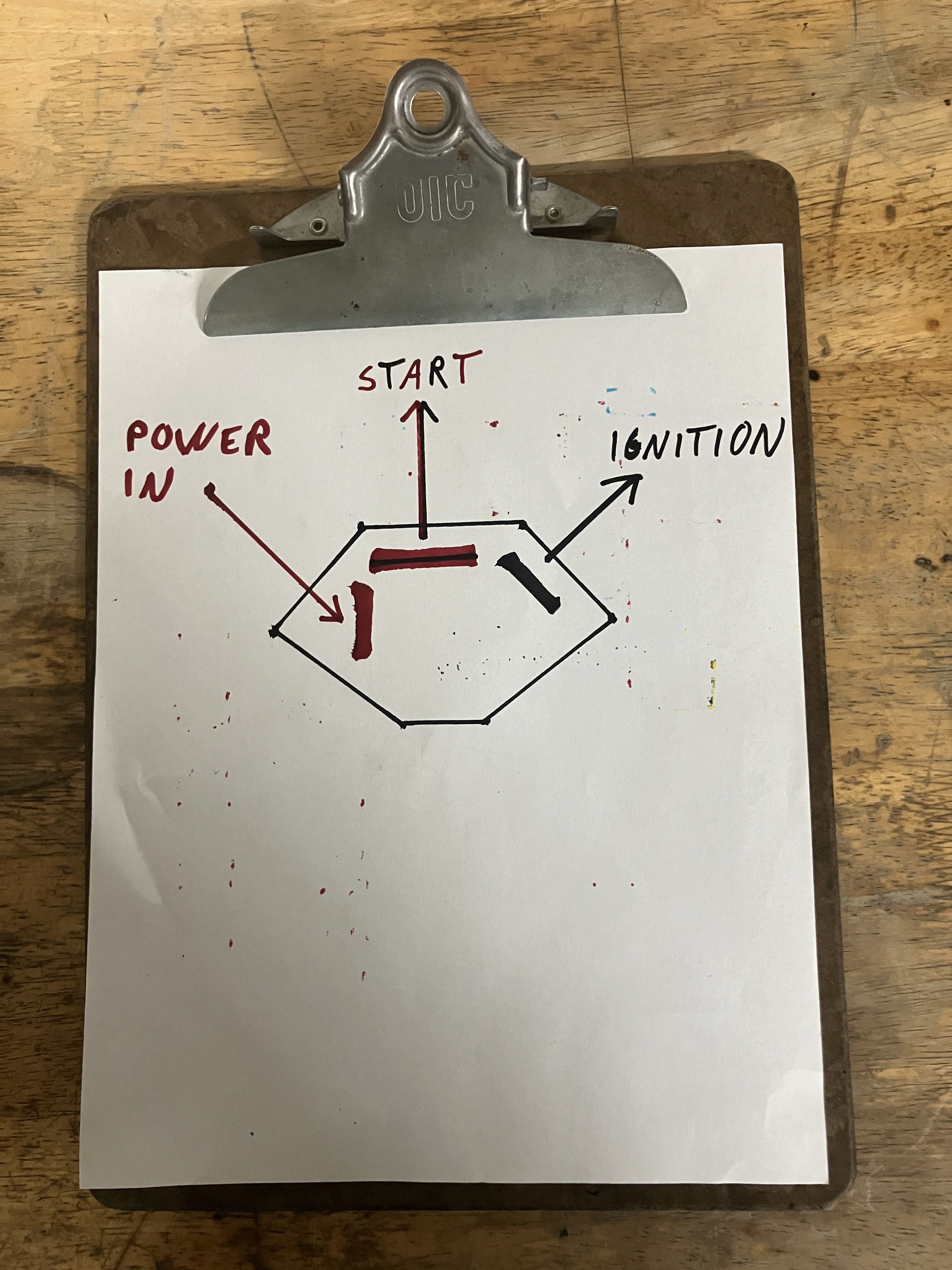

84 VW MK1 Rabbit DIY Wire Harness 4 - Start Power Fuse Block
The guy who invented the ZombieVerter tells us about Pin #52

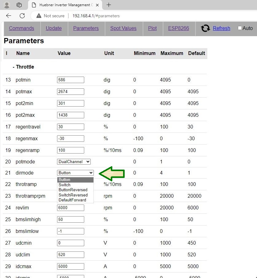

just want to share some screen shots with those who are still waiting on their Zombies to arrive ;)
we find the dirmode [direction mode] under the Parameters aka "Settings" section in the Open Inverter web interface for the ZombieVerter VCU accessible via WiFi
Button is our first choice. This option is designed for one or two momentary press buttons to put your car in either Drive aka Forward direction or Reverse. The way this works is you press a button and you are in that mode until you press the other button
