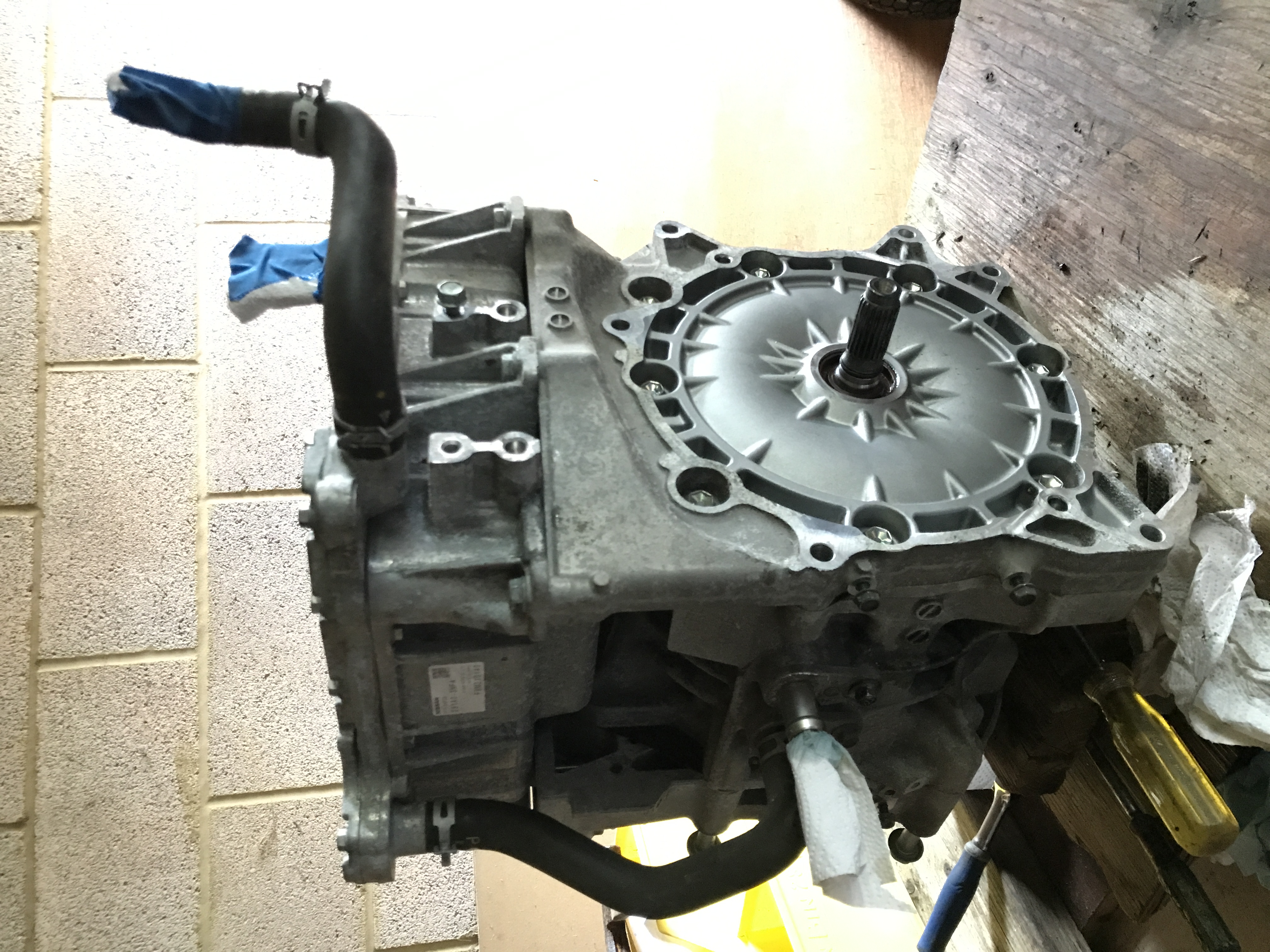

Take object A and insert into position B. Simple.
Actually, slightly stuck on the aircon currently. Still pressurised on the Leaf and have not found anyone interested to come out and suck it out professionally. Need to sort that before I can get the engine out from what I can tell.
Object A (shown upside down, not my fault)
Position B

It’s free… (meaning released from captivity, not zero cost!)
Sorry about photo orientation. Second time it’s done that. Probably a setting I need to work out.
andybpowell
Posts: 334
Location: Southend,essex,uk
Has thanked: 219 times
Been thanked: 257 times
Re: Leaf to VW Type 2 Campervan
Post by andybpowell »
ianlighting wrote: Tue Apr 30, 2024 7:17 pm Image
not sure what you planned to do as far as an adapter goes but I split the leaf gearbox casing and then left the half attached to the leaf motor as a spacer and made an adapter to go from that to the gearbox, here's a link to my post if you want to take a look it's right near the start
viewtopic.php?t=4064

andybpowell wrote: Tue Apr 30, 2024 7:35 pm not sure what you planned to do as far as an adapter goes but I split the leaf gearbox casing and then left the half attached to the leaf motor as a spacer and made an adapter to go from that to the gearbox, here's a link to my post if you want to take a look it's right near the start
Nice idea. I’ll have a look at what you did when I have a bit more time. Current plan is to get adaptor plates and coupler from BratIndustries, but nothing is finalised yet, but I have sent Angus an email yesterday I think to move it forward a bit.
Now the beast is free from the old Leaf, I am ready to firm up ideas of measurements.
