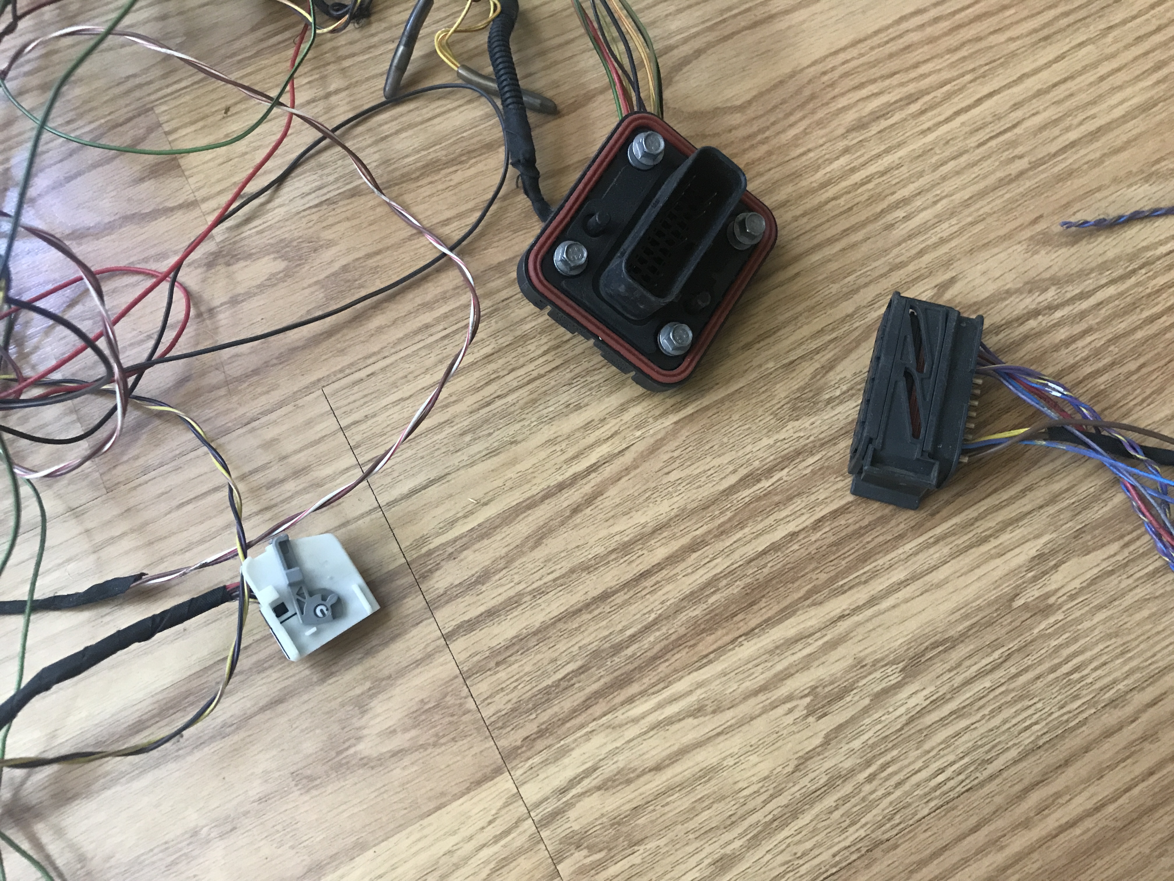

ZombieVerter VCU Prius Inverter Connection
some say this video may cure your insomnia ...
it's going to look like this for both the 3rd Gen Toyota Prius and Lexus GS450h inverters

I think that I might be facing difficulties connecting with the manscaped Zombie wiring!

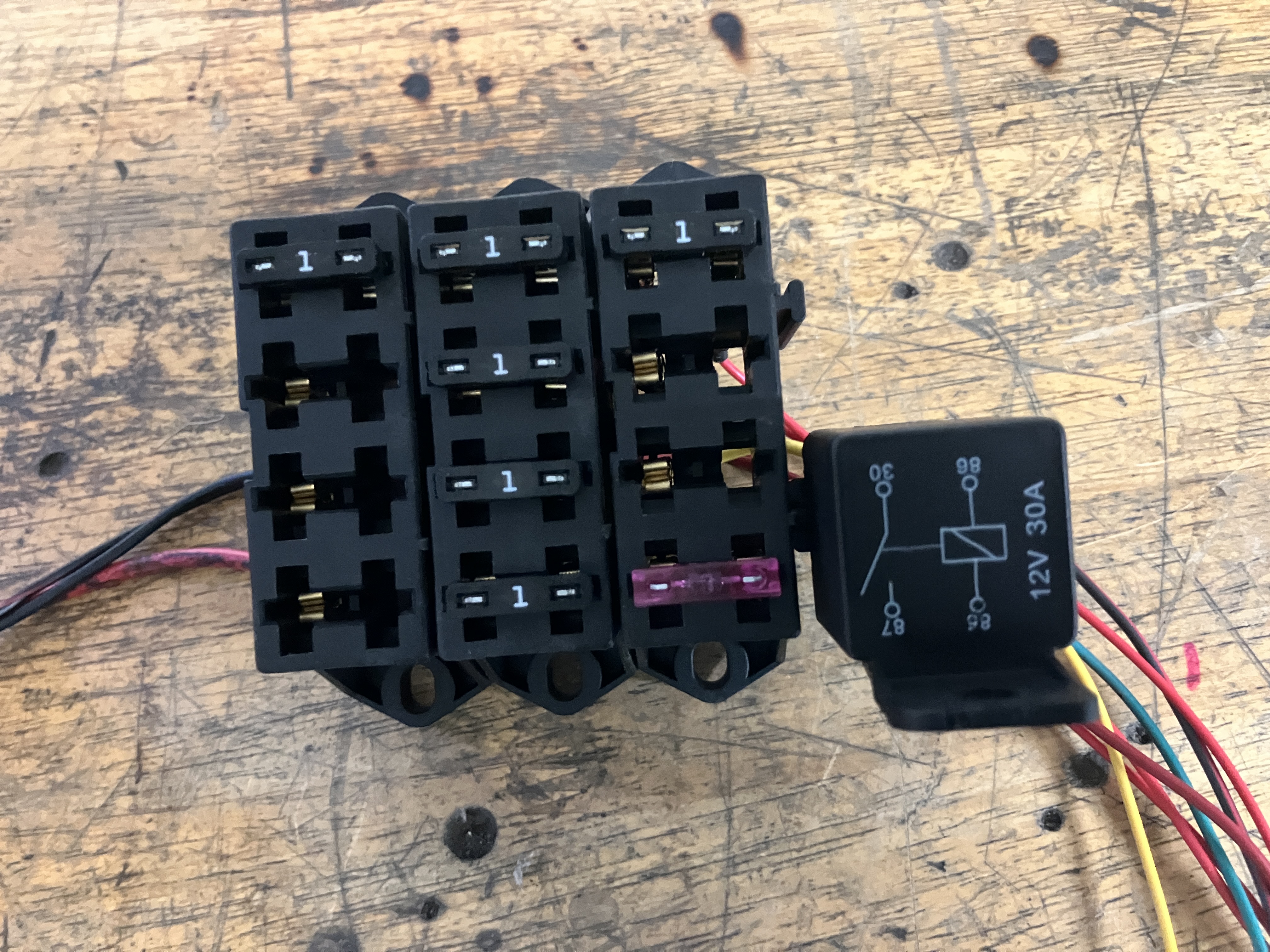

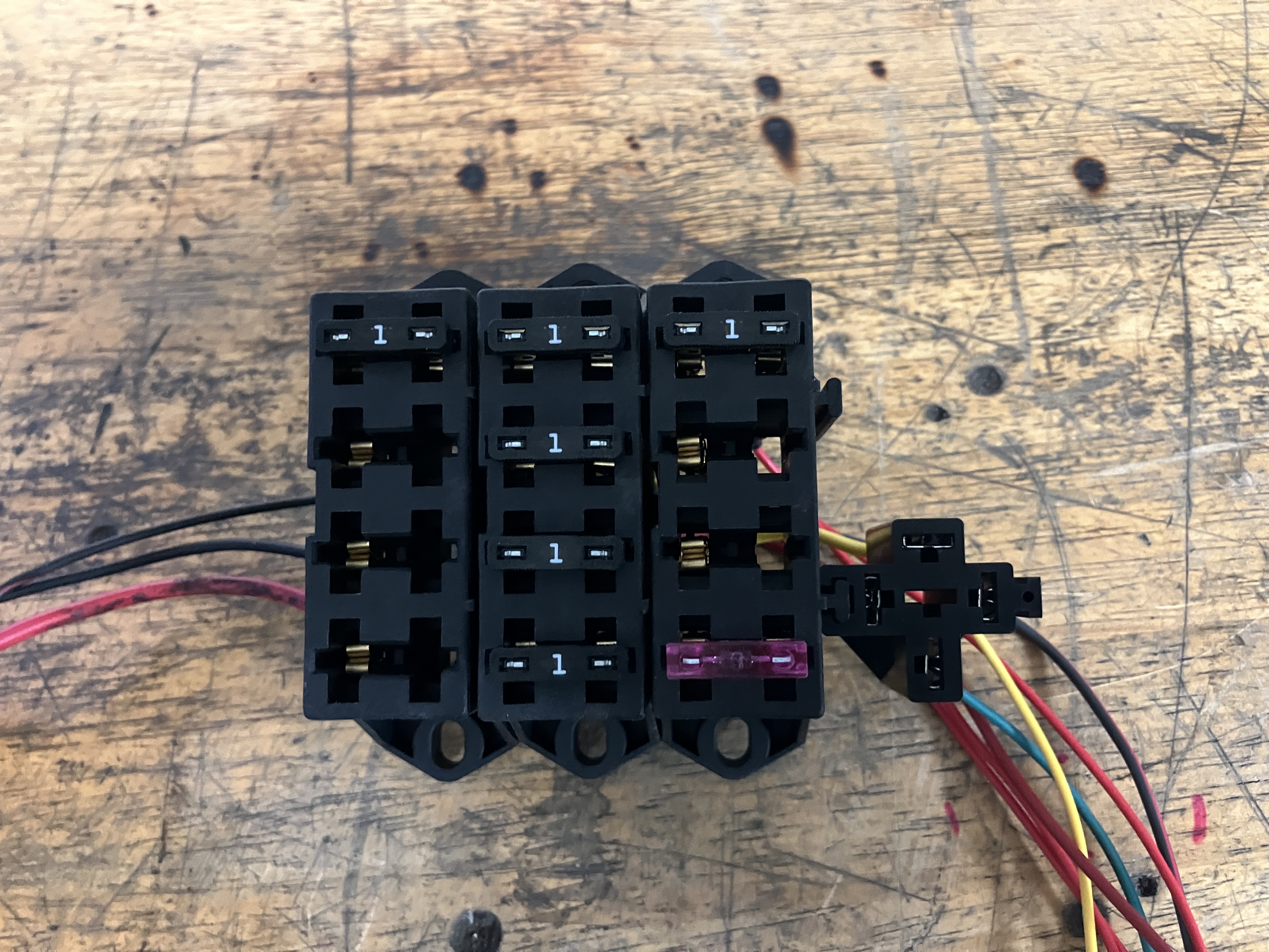

working on adding a relay for the inverter to the DIY fuse block
Relay Connector, MUYI 5 Pin Relay Connector 12V Socket 30Amp 40Amp 6.3mm Truck Vehicle 5 Pack Car Relay
- Gregski
- Posts: 2743
- Has thanked: 500 times
- Been thanked: 951 times
EV Conversion DIY Wire Harness - Inverter Relay
the three wires on the left of the fuse block bring 12 volt power into the block, the thick red wire is permanent 12 volts to the first row of four fuses, then the black wire feeds the middle row ignition key On power, and the other wire only provides power in the Start position to only the top fuse in the upper right corner
all the wires coming out the right side supply 12 volts to various doo dads and doohickeys
the ZombieVerter VCU controls the relay and turns the Inverter Off and On
- Gregski
- Posts: 2743
so this is the last piece of the puzzle, if I can get charging working on the work bench then I will feel confident I can just toss all the bits in the Rabbit and she will run and drive
