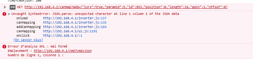

Re: ESP32 Based Web Interface & Data Logger
Just got a new thing while remaking my can man
Edit : I've commented the lines, reuploaded the code to the ESP the wired way, but still no luck. same behaviour, i can't add can messages to the can map. I'm very lost on the workings of this, any help ?
i haven't done the comments to remove the json issue, could this be linked ?Edit : I've commented the lines, reuploaded the code to the ESP the wired way, but still no luck. same behaviour, i can't add can messages to the can map. I'm very lost on the workings of this, any help ?
- Posts: 295
- Has thanked: 79 times
- Been thanked: 96 times
If you look closely you can see the problem: The line that updates the "updstate" should be "updstate = REQUEST_JSON" rather than doing an == comparison and then discarding the result.Bigpie wrote: ↑Fri Jun 28, 2024 9:23 am I've just commented out like this

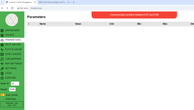

Not sure where to ask this, maybe here makes sense. I've flashed my esp32 per the instructions on the github but the web interface seems a bit flaky. 'settings' and 'wifi settings' are both blank when I click them (except one time it showed up after waiting 5 minutes or so). Is that normal or does it indicate something went wrong? The same interface on my Wemos D1 seems pretty fast and smooth by comparison. Should I try re-uploading the SPIFFS?
Also, trying to enter a node/speed doesn't seem to work and I can't get parameters or spot values from my Foccci (though it's freshly flashed, I cant be certain it's working right either, but I am thinking since the web UI is acting strange I should start there).
- uhi22
- Posts: 1117
- Has thanked: 206 times
- Been thanked: 617 times
This sounds like an instable ESP32. My first point to check would be to have a strong 5V power supply for it. Had bad experiences using crappy USB cables. The ESP needs some current for wifi, and tends to crash if the power drops.

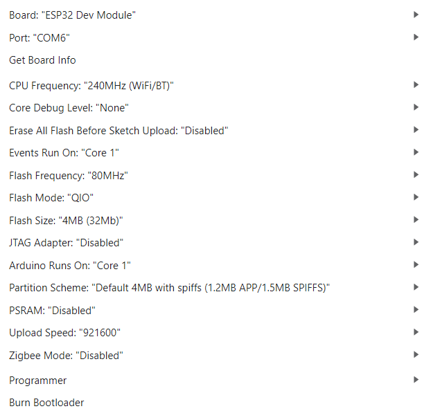

Ah, interesting. I'm using a 12v benchtop power supply though, so I don't think it would be that.
Does this all seem correct? Wondering if maybe one of 'events' or 'arduino' should be on core 0? These are all what came up by default. (Edit: actually from another forum it looks like that would be a bad idea, apparently it runs the wifi stuff on core 0.)
- uhi22
- Posts: 1117
Is it possible to view the ESPs serial? It should give hints how far it comes and what is the reason for crashing.

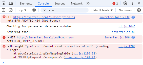

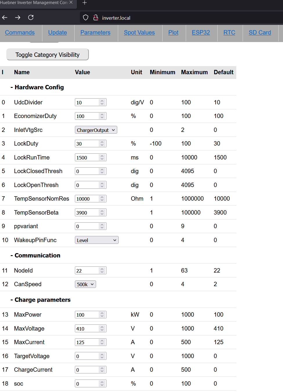

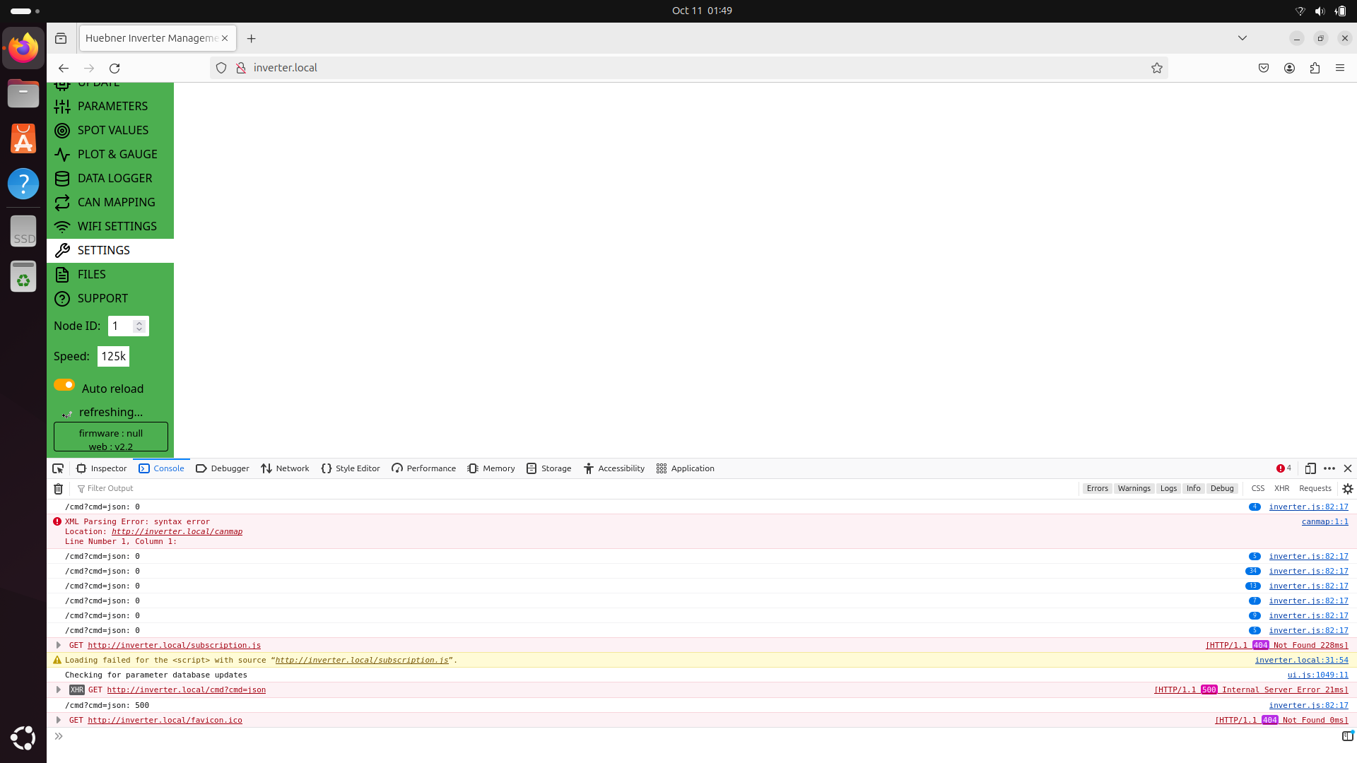

Progress!(?)
Went back the latest everything. Not able to get settings or wifi settings to show anything even when I reload now, but I did enter the node id, left it alone for a bit and I still have nothing in parameters or spot values, but it DOES have a json that appears valid when checked online. I hope that's a good thing?
So far same behavior in chrome, firefox and edge
