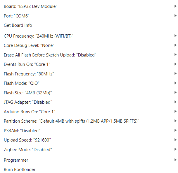

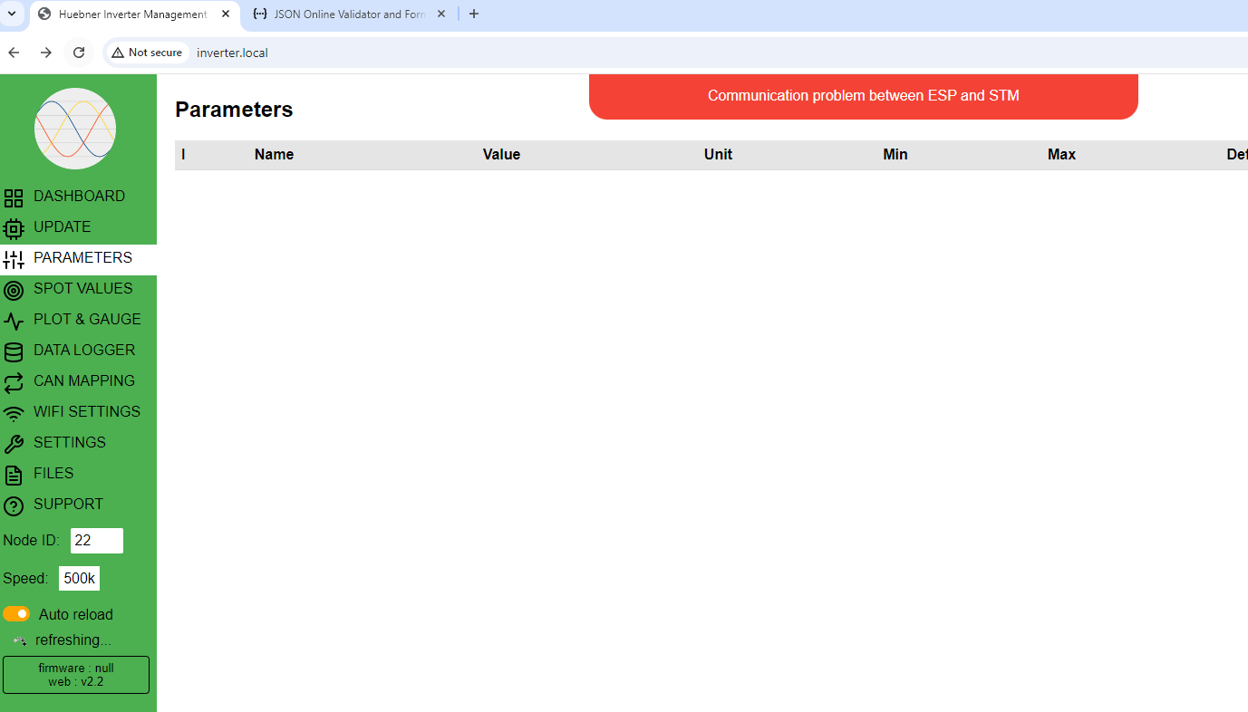

Not sure where to ask this, maybe here makes sense. I've flashed my esp32 per the instructions on the github but the web interface seems a bit flaky. 'settings' and 'wifi settings' are both blank when I click them (except one time it showed up after waiting 5 minutes or so). Is that normal or does it indicate something went wrong? The same interface on my Wemos D1 seems pretty fast and smooth by comparison. Should I try re-uploading the SPIFFS?
Also, trying to enter a node/speed doesn't seem to work and I can't get parameters or spot values from my Foccci (though it's freshly flashed, I cant be certain it's working right either, but I am thinking since the web UI is acting strange I should start there).

This sounds like an instable ESP32. My first point to check would be to have a strong 5V power supply for it. Had bad experiences using crappy USB cables. The ESP needs some current for wifi, and tends to crash if the power drops.

Ah, interesting. I'm using a 12v benchtop power supply though, so I don't think it would be that.
Does this all seem correct? Wondering if maybe one of 'events' or 'arduino' should be on core 0? These are all what came up by default. (Edit: actually from another forum it looks like that would be a bad idea, apparently it runs the wifi stuff on core 0.)

Is it possible to view the ESPs serial? It should give hints how far it comes and what is the reason for crashing.

Well I had the monitor running but didn't get anything out of it after the initial bootup. I even tried a full wipe of the ESP and re-flashed it via the arduino IDE (and the web interface CAN-Backend fork which I just downloaded as a zip and extracted to my workspace). Basically I've discovered it will load all the pages except Settings and Wifi Settings on the first try. And if i refresh the page then click settings, it's about 50-50 whether it will load or give me a blank screen. And of course no parameters or spot values are coming through from Foccci when I enter node 22/500k.
Not sure if this tells us anything useful or not.

I'm using an older version (not really sure, something from December 2023 I assume), but can confirm, that the error with the missing subscription.js is also present here. If I try to open http://inverter.local/subscription.js I get a HTTP 404 (file not found). So this seems to be "normal".
When just opening the main page, I get some errors, but they seem not to block the functionality:
No idea what could be the issue on your side. Maybe try an other version, and different browsers. I'm using Chrome and Edge, no problems here with the "December 2023?" version.

subscription.js only exists if you subscribed to a parameter set which I think hardly anyone does. So it's "normal" that it doesn't exist.

Progress!(?)
Went back the latest everything. Not able to get settings or wifi settings to show anything even when I reload now, but I did enter the node id, left it alone for a bit and I still have nothing in parameters or spot values, but it DOES have a json that appears valid when checked online. I hope that's a good thing?
   "UdcDivider": {"unit":"dig/V","id":1,"value":10.00,"isparam":true,"minimum":0.00,"maximum":100.00,"default":10.00,"category":"Hardware Config","i":0},

So far same behavior in chrome, firefox and edge

Got an old version working! I had to roll back the esp32 version in the board manager to 2.0.17 in the Arduino IDE to avoid the compile error (but not until after flashing the OTA sketch to upload the spiffs). Seems like all is good with this version, so I'm happy with that. Appreciate the help guys.
If anyone else experiences something similar, this is the commit that I used: https://github.com/jsphuebner/esp32-web ... e87c7acc8d
And don't forget to fully wipe the board before changing versions. I used a command in powershell to accomplish that.
python -m esptool --chip esp32 erase_flash
