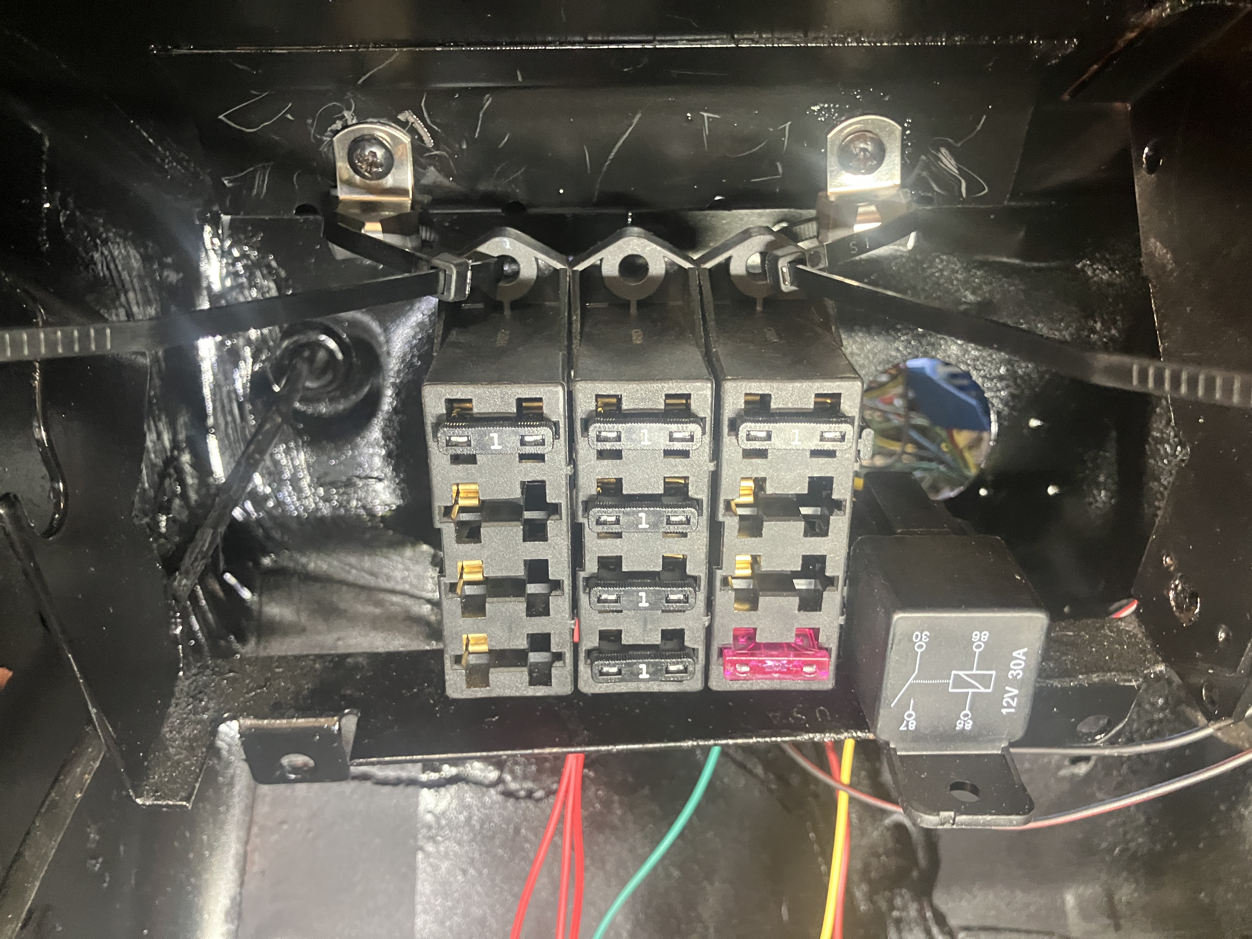

actual footage of me heading into the garage in this heat to tackle the low voltage wiring
- Gregski
- Posts: 2743
- Has thanked: 500 times
- Been thanked: 946 times
it appears The Greg will end up using 30 of the 56 ZombieVerter pins
05 - Prius Water Pump PWM 3 used to control the speed of the pump
12 - Prius Transmission MG2 Temp -
13 - Prius Transmission MG2 Temp +
14 - Prius Transmission MG1 Temp -
15 - Steering Column Ignition T15 In
16 - Prius Inverter Control REQ-
17 - Prius Inverter Control REQ+
18 - Prius Inverter Control CLK-
19 - Prius Inverter Control CLK+
20 - Prius Inverter Control MTH-
21 - Prius Inverter Control MTH+
22 - Prius Inverter Control HTM-
23 - Prius Inverter Control HTM+
27 - BMW Safety Box CAN EXT Low
28 - BMW Safety Box CAN EXT High
29 - Prius Transmission MG1 Temp +
31 - Negative Contactor Low Side Switch used to turn on and off the Outlander charger
32 - Prius Inverter Power Low Side Switch used to turn of and off the Inverter via the Zombie
33 - Main Contactor Low Side Switch used to turn on and off the Outlander DC-DC to charge regular car battery
43 - Mitsubishi Outlander Charger CAN EXT 2 Low
44 - Mitsubishi Outlander Charger CAN EXT 2 High
45 - Honda Fit Throttle Ground
46 - Honda Fit Throttle Channel 2
47 - Honda Fit Throttle Channel 1
48 - Honda Fit Throttle +5v
52 - Steering Column Start position
53 - Toggle Switch Reverse Direction
54 - Toggle Switch Forward Direction
55 - Body Chassis Ground
56 - Car Battery via fuse Permanent +12 Volts (always on / on standby)

later that same evening, and a bucket of sweat later
- Gregski
- Posts: 2743
DIY EV Conversion Final Low Voltage Wiretization '84 VW Rabbit ZombieVerter
