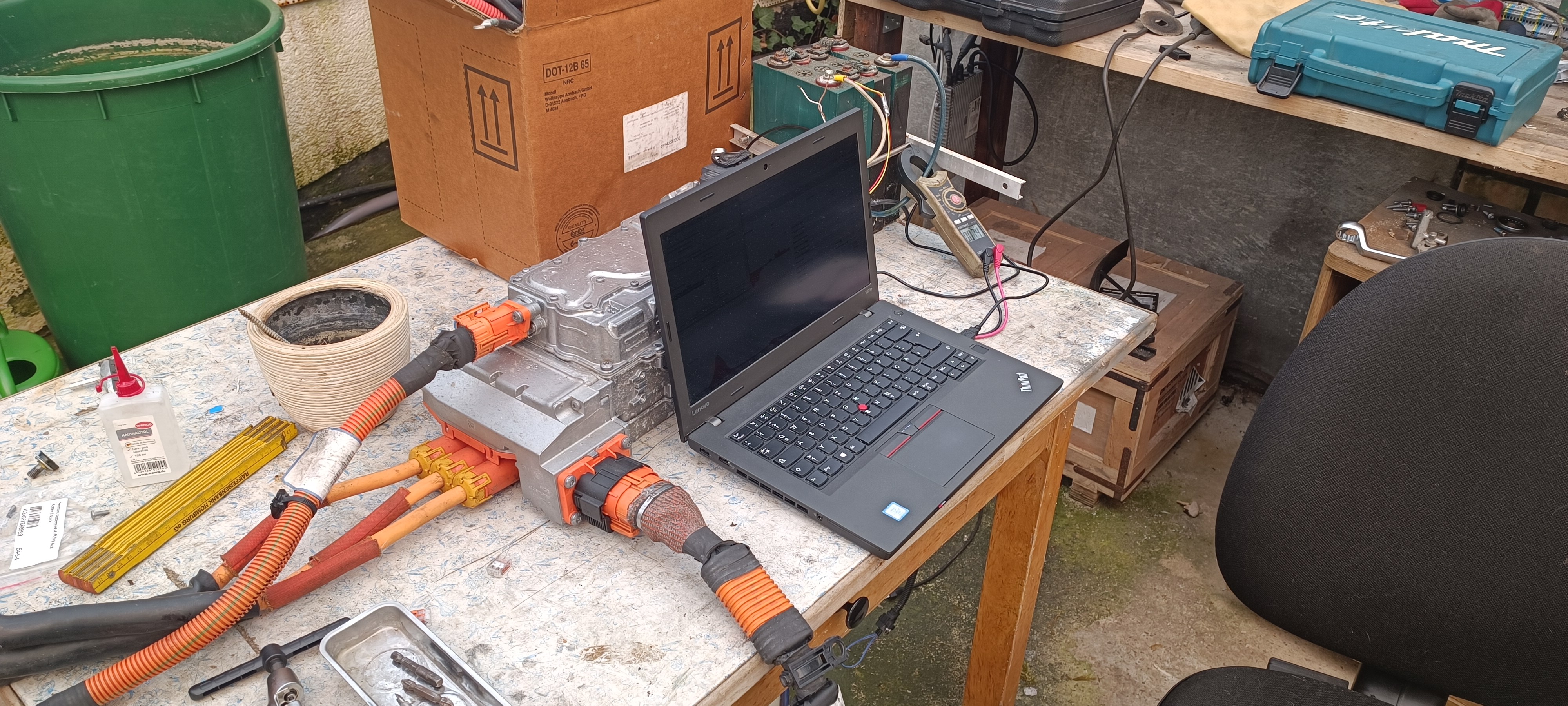

This morning I ran the Zoe motor with the i3 inverter. I found 12V on the excitation results in 1.3A of current. Did get up to 15 Hz then it desychronizes and just rattles. I supplied excitation from a battery. When supplied from a power supply it jumps around a lot when running.
Anyway, it's about the inverter, not the motor. Got it on the table here and trying to get some life out of it. Connected chassis to GND and the yellow wire to 12V. Then results in 5 mA of current. The red wire doesn't really do anything. Also monitored the CAN channels but they don't produce anything either. Put one of the CAN messages from here on the bus but that doesn't wake it up either.

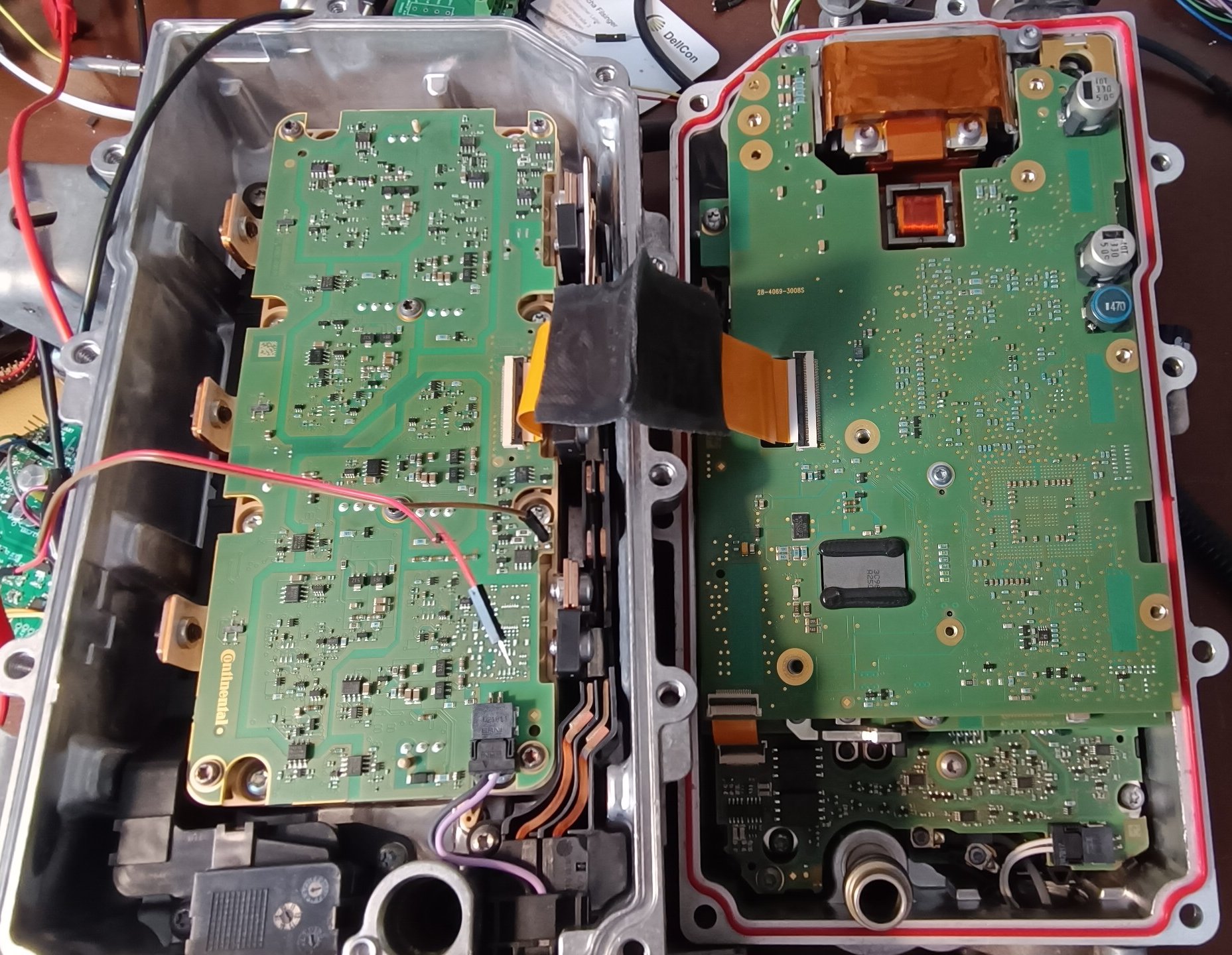

Ok, onto the gate driver board. I did ring out a few signals, like pins of the bidirectional isolator that send the PWM across the galvanic barrier. And the current sensors.
Weirdly all 5V supplies are split up. The low side isolators share common 5V, the high side another common 5V (I assume it's 5V) and another 5V goes to the current sensors. All not interconnected. Weird.
Tried to fire up the gate drive power supplies but also with no luck. Fed 12V to the larger film caps next to something that looks like a driver IC but that resulted in no current draw at all.
Not the best start, hints appreciated

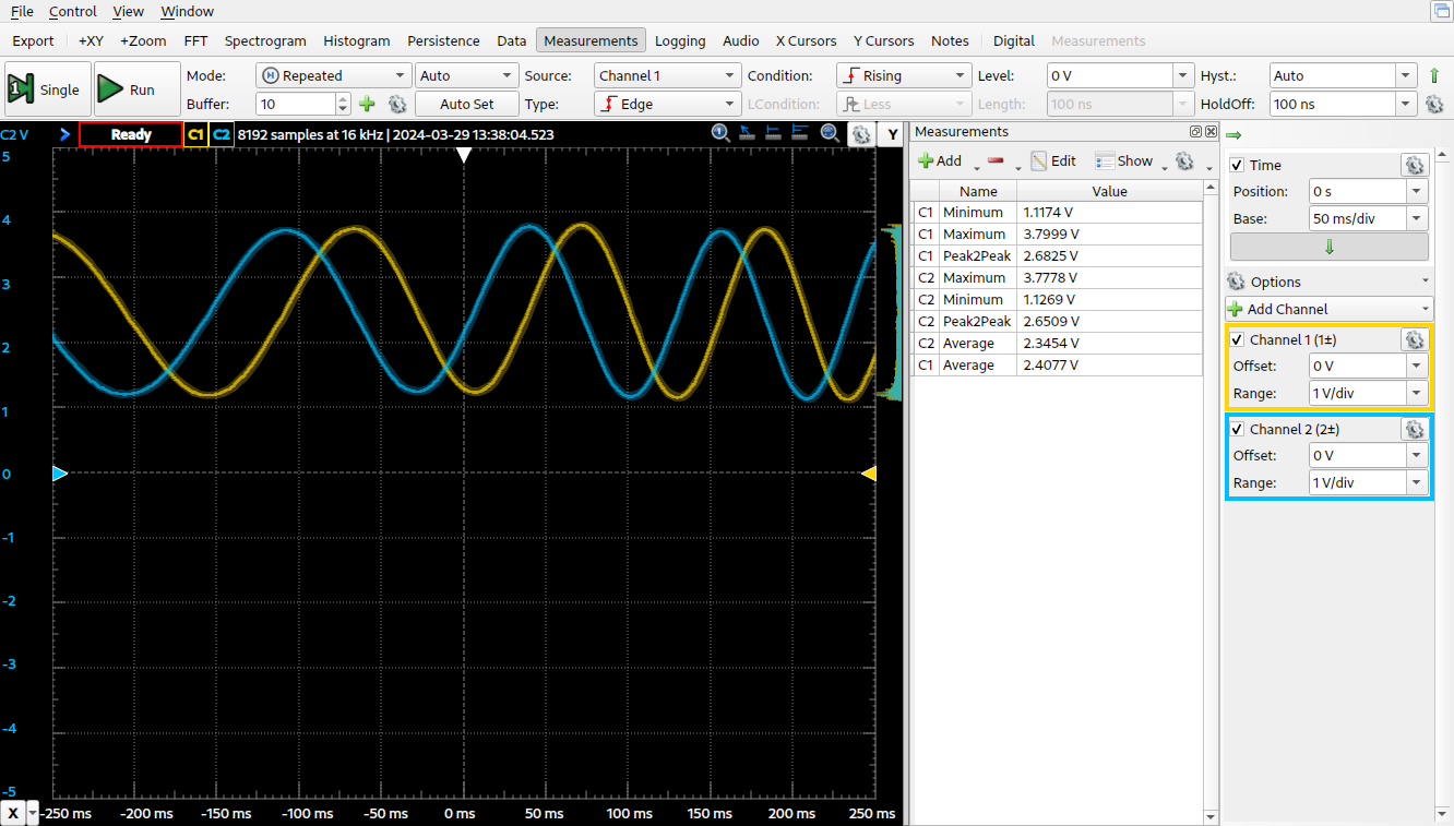

Taking baby steps. I'm trying to figure out the position sensor which I expected to be a resolver. But it isn't.
I have the wiring diagrams and there the pins are called
- Ground
- Supply (measures as permanent 5V)
- Position Signal 1
- Position Signal 2
So I though ok, it must be some sort of position sensor IC that outputs a sin and a cos signal. So had the Analog Discovery supply 5V and then measured Signal 1 and 2. Hmm Signal 2 jumps to 5V, Signal 1 stays at 0. Moving the motor yields no change.
So I thought maybe it's some data protocol, one of them is clock an the other an encoded position. So clocked one signal with 500 kHz while monitoring the other. Nothing. Hints appreciated

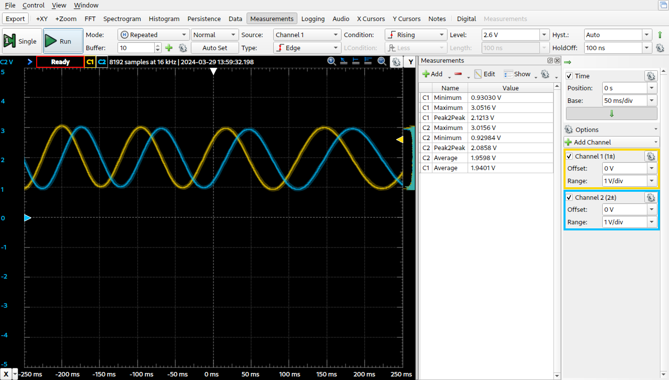

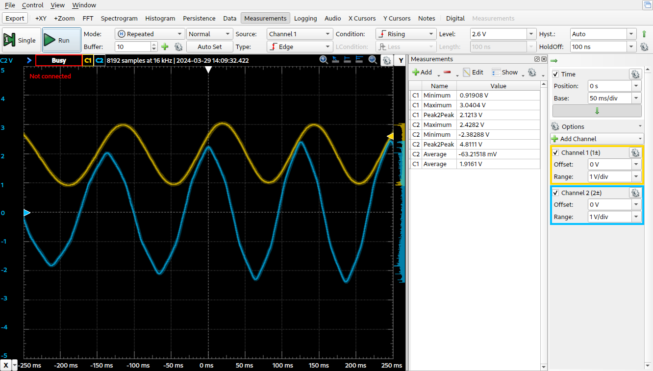

I tried to do so today and that led to the answer
The position sensor sits in the front, et voila: EDIT
Next I tried supplying with 4V instead of 5V: That shifts the signal into the input range of our ADC
Then I connected channel 2 to phases 1 and 2 and supplied the excitation winding with 12V: So respolepairs=polepairs
The ratio is more important then the absolute value.

Now continuing with some more gate driver research. The isolators are ISO7421 from TI. https://www.ti.com/product/de-de/ISO7421
They have one forward one reverse channel. Traced the 6 forward channels that gives me the 6 gate drive signals and the 6 reverse channels give me the 6 desat signals. The forward channels have a 200 Ohm series resistor
Then there are separate logic supplies for high and lowside, and separate supplies for the current sensors.
With all that and the many, many GNDs 43 out of 50 pins of the gate drive ribbon are now traced.
The excitation ribbon is just 20 pins, 6 GNDs, 2 15V and various 5V supplies. I think I'll just trial and error that as it's hard to measure

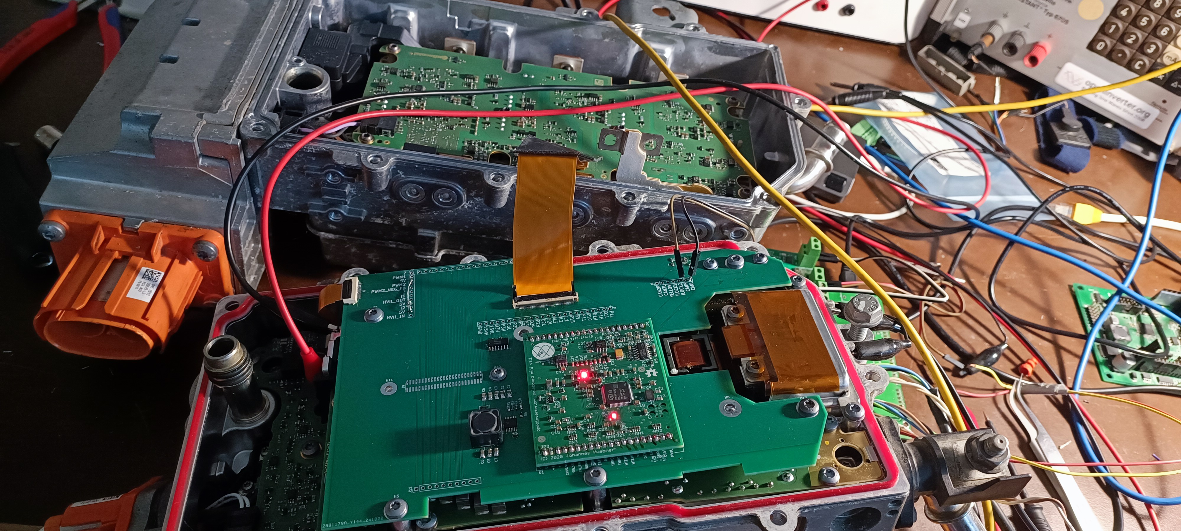

First cut of a breakout board with mini mainboard for first tests

Good testing day today. Got the main inverter and the exciter inverter going.
All runs fine from 3V3 control signals.
I haven't found temperature and bus voltage signals so maybe that is on SPI comms again. But I also found that I forgot to break out two pins so will check these next.
Latest pin map is attached

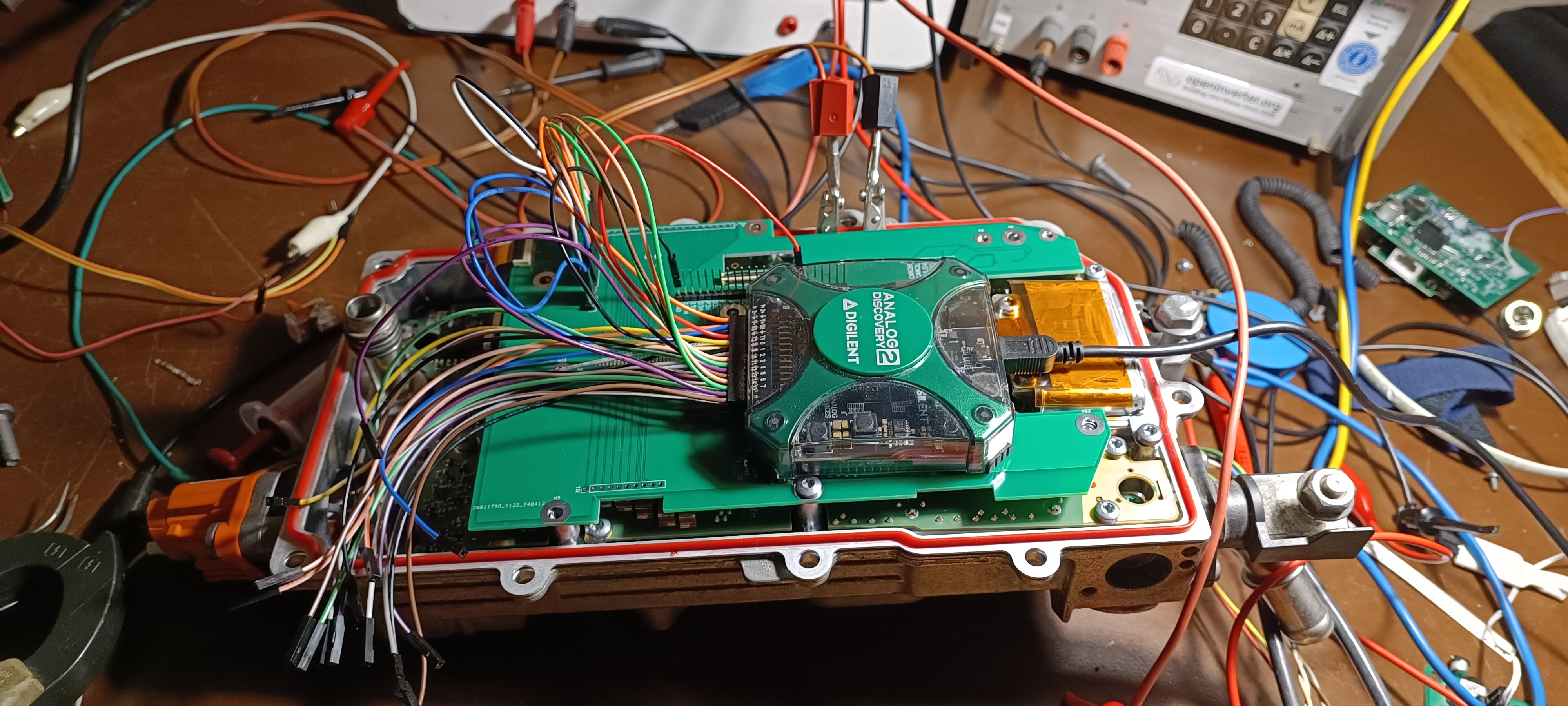

Spied the "comms" with the DC-DC converter today by sandwiching a breakout board between stock logic board and DC-DC converter.
It is mostly static voltages but there is some rather strange comms going on.
On one pin the logic board sends an 11.2 MHz clock, on another a 2.8 MHz clock at 1.8V levels and finally it receives a 9.95 MHz clock and data and two other pins. I reckon it is a sync serial unidirectional protocol because I couldn't find any data upstream of the logic board. I captures a few frames.
The Analog Discovery seems to have a hard time keeping up with the speed so there might be bytes missing. A remember 7E being some HDLC delimiter so I just assumed it to be a frame start or end. Could apply some voltage to see if something changes.

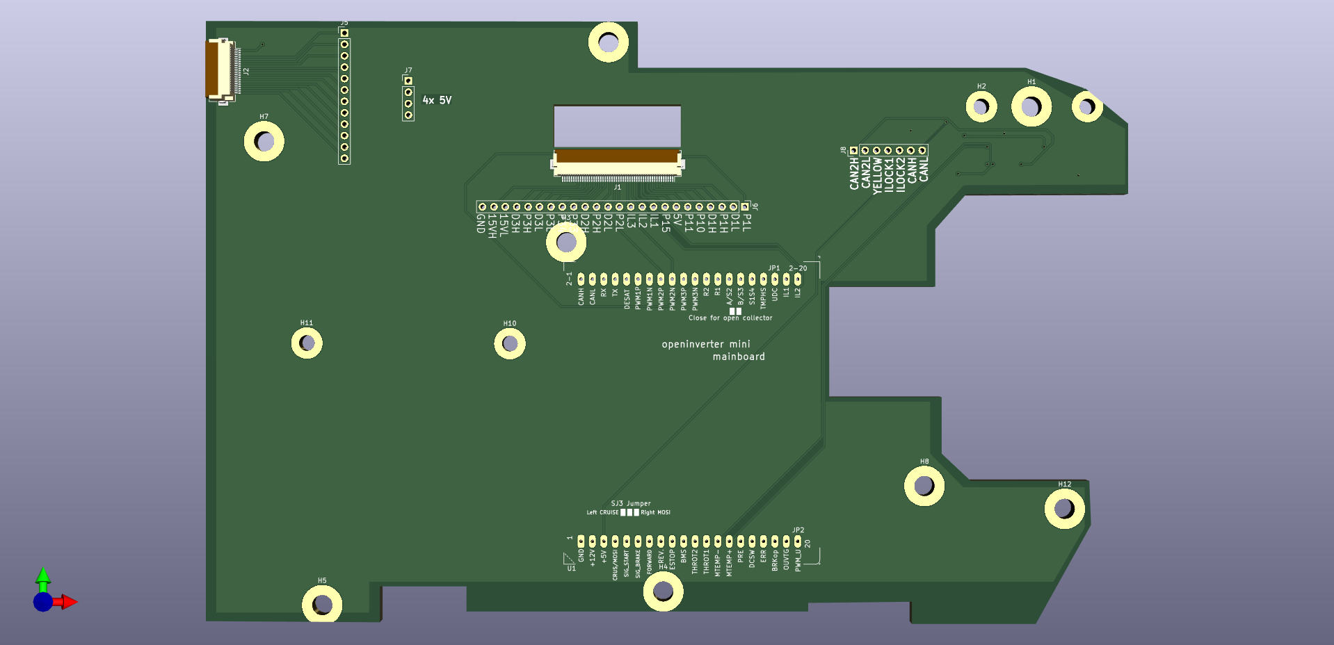

Testing the next iteration.
- Exciter PWM now connected to mini mb user PWM
- Exciter current connected to udc input
- 15V boost converter for supplying exciter and inverter
- Hooked up 6 desat signals to and-tree
- LDO for variable voltage to sin/cos encoder (currently set to 3.9V) - shifts the output signals into the ADCs dynamic range
- Mini MB can be soldered directly to adapter board for lower profile so it doesn't collide with the gate driver PCB
- Bolt holes revised but still not perfect
There are some shortcomings still
- No measurement of inverter heatsink temperature - I hope it just throws a "desat" signal when overheating
- No measurement of udc - not really needed since the board won't perform contactor control
- No operation of DC/DC converter
Will now extend the software to detect the adapter board and allow closed loop exciter current control
Using an offset of 3195 for exciter current sense and a gain of -50 digits/A
