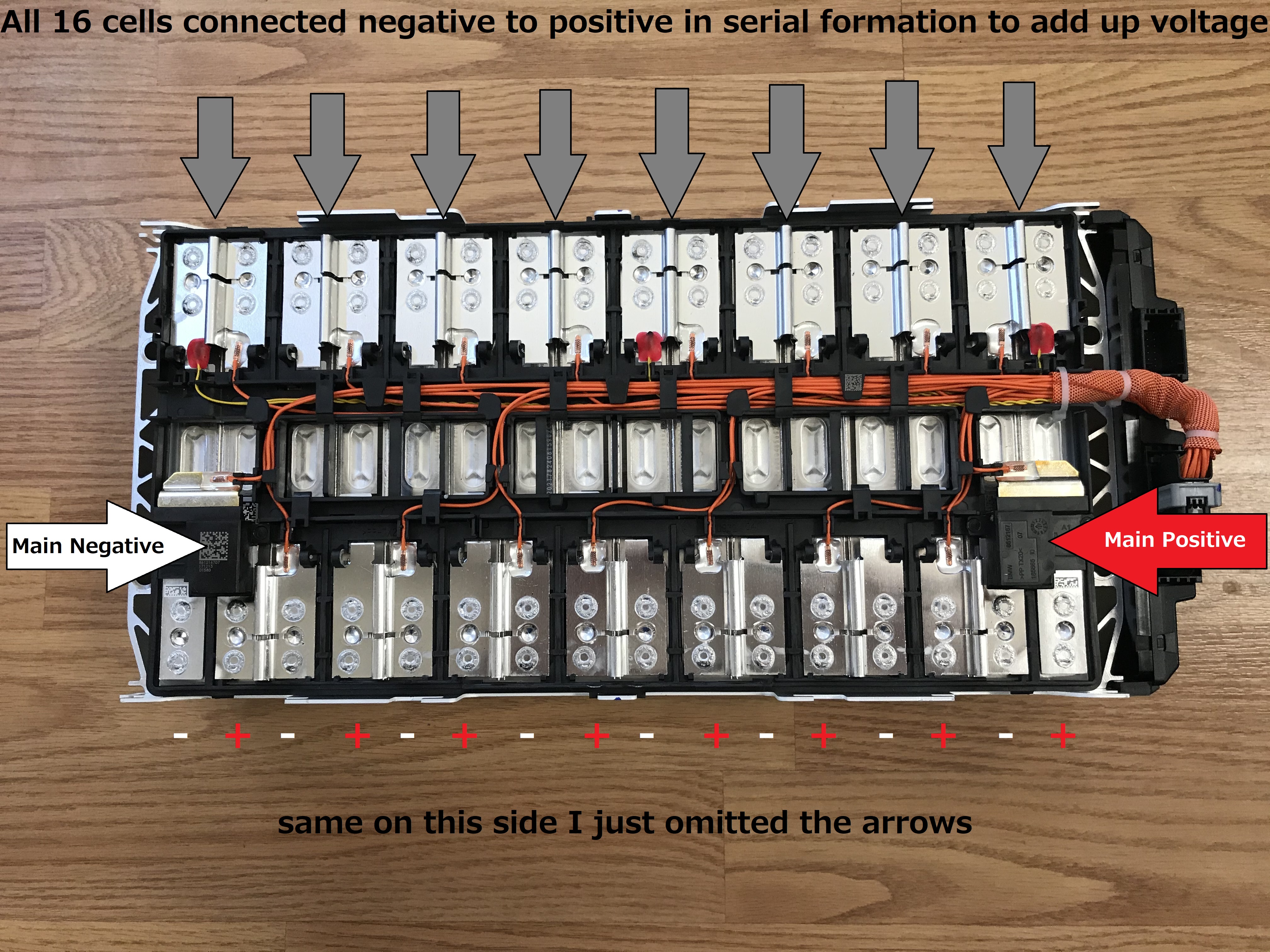

So let's talk charging so I can tell you what you already know
so I am getting braverer and braverer as I charge this dinky 2018 BMW 330e PHEV battery pack, which consists of 5 modules and 80 cells (16 cells per module)
DISCLOSURE: I happen to have some BMW 530e battery specs for the battery pack code name SP06 but I don't have any for the 330e so some maths were involved to come up with the table adaptation
yes this would be more better with some more decimals, but I'm just spit ballin' here
below is one of the five modules with it's 16 cells holding hands nicely in a row
| PACK | MODULE | CELL | COMMENT |
| 331v | 66v | 4.14v | Max |
| 327v | 65v | 4.08v | My Goal |
| 320v | 64v | 4.00v | Next Set Point |
| 310v | 62v | 3.87v | Current Charge Limit |
| 300v | 60v | 3.75v | 1st Charge |
| 292v | 58v | 3.65v | Nominal |
| 224v | 45v | 2.80v | Min |
