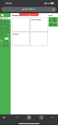

Thank you for such fast shipment of the board. I have wired it in and can see the board access point. However, I can’t get past the error message. Any suggestions?
Posts: 6745
Has thanked: 380 times
Been thanked: 1568 times
Re: Open Inverter Data Logger
bus speed must be 500k and firmware must be pretty new, like 5.27 at least, 5.35 is more reliable

Me again… I’ve upgraded the sine firmware to 5.35. Wow. I’ll write about that in another thread but it’s a significant improvement.
Still can’t get the data logger to establish a connection. These are my comms settings:
Posts: 6745
Can you check the console available on the TX pin next to the wifi module?
Usually it's something with the physical connection. Are there any .json files on the file system? If so delete them and power cycle

To report back: I managed to get this working, sort of. In summary, here's what I did:
1) Upgraded to the latest Inverter firmware
2) Deleted the ESP file system .json file with cURL
3) Connected using a PC (rather than an iPhone). Upon first connection I needed to toggle the node ID from from 1 to 2 and back to 1 again. Didn't need to do this after a power cycle.
This then connected the ESP with the STM as expected and data loaded onto the browser Huebner interface.
What doesn't work:
1) Tried unsuccessfully to connect using various IOS devices. The IP address brings up the OI interface but it says that ESP cant connect with STM
2) When scrolling the parameter list (using a PC), it doesn't load the parameters beyond what's initially loaded on the screen. IE as soon as the curser is used to scroll down, no further parameters load.
