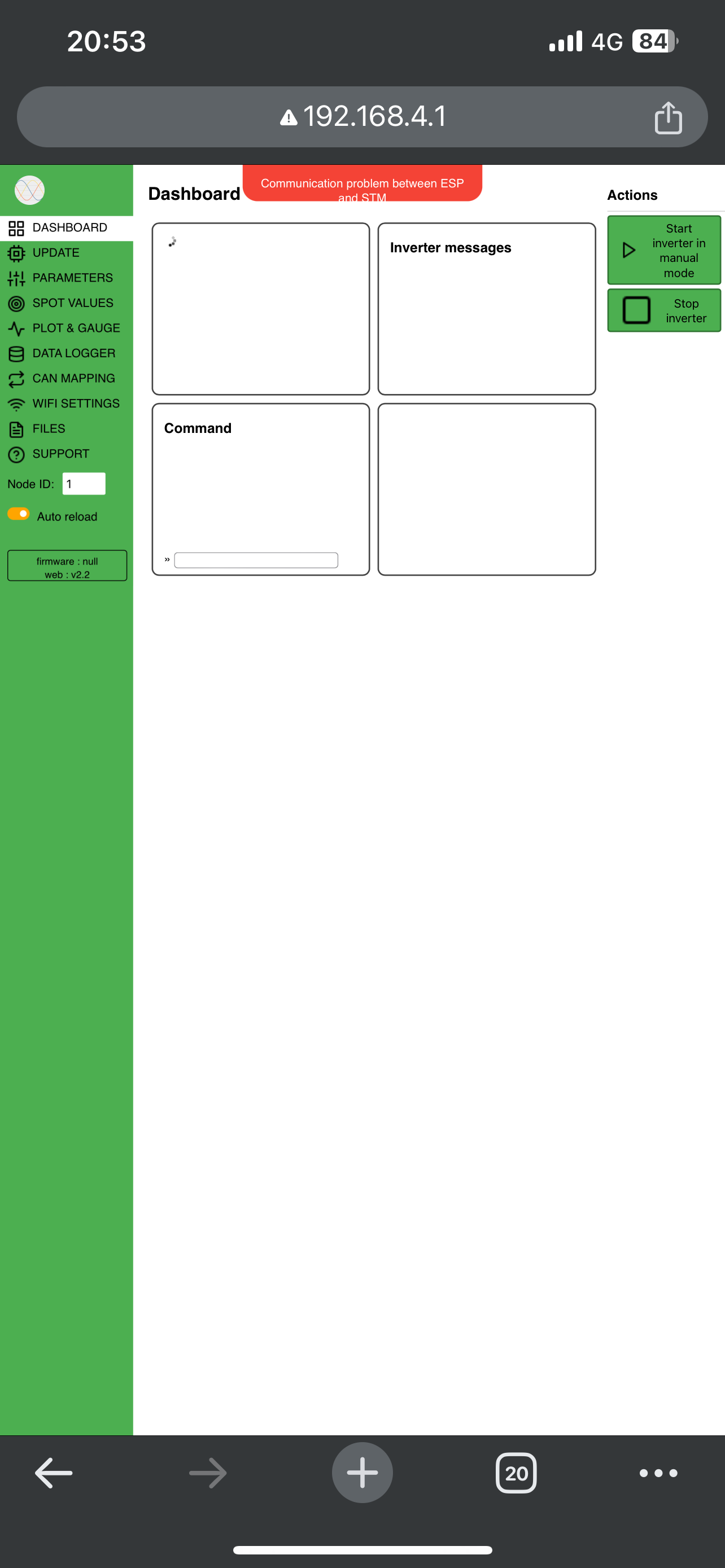

Thank you for such fast shipment of the board. I have wired it in and can see the board access point. However, I can’t get past the error message. Any suggestions?
Been thanked: 1913 times
Re: Open Inverter Data Logger
bus speed must be 500k and firmware must be pretty new, like 5.27 at least, 5.35 is more reliable

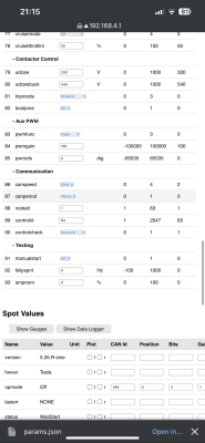

Me again… I’ve upgraded the sine firmware to 5.35. Wow. I’ll write about that in another thread but it’s a significant improvement.
Still can’t get the data logger to establish a connection. These are my comms settings:

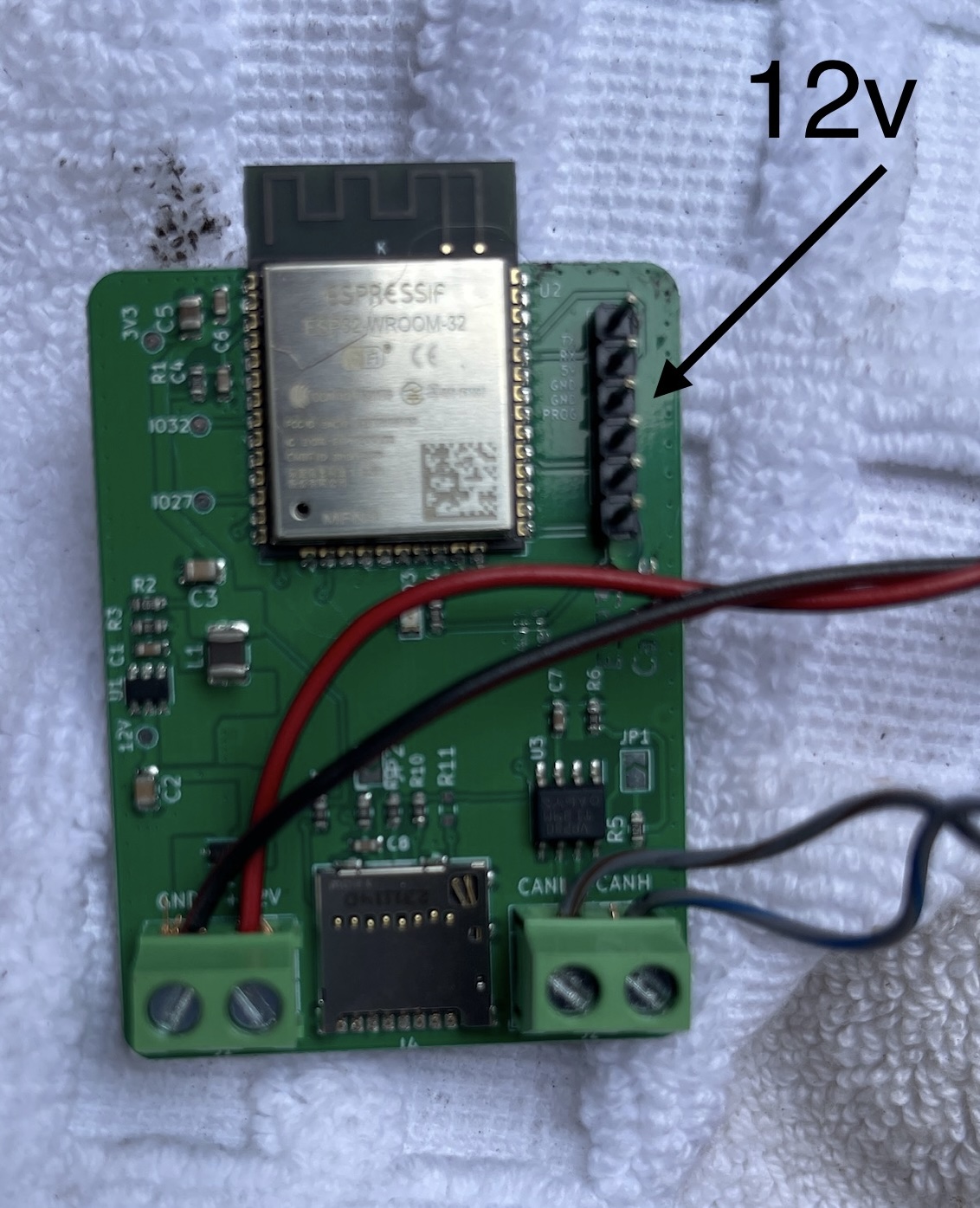

I don’t have access to a scope so I can’t really properly test the tx / rx line. I tried connecting a 3.3v external CAN transceiver but also could not get it to work. I did however notice the following:
On the console to the right of the wifi module, the pin marked 5v is outputting 12v.
In the absence of a scope, I don’t really know what else to try.
Boxster EV wrote: Fri Jun 28, 2024 7:53 pm On the console to the right of the wifi module, the pin marked 5v is outputting 12v.
Oh yes, I use the header for programming and feed 5V into this pin. There used to be a diode in between but the voltage drop was too large. So not it is connected straight to the 12V input of the 3.3V reg

To report back: I managed to get this working, sort of. In summary, here's what I did:
1) Upgraded to the latest Inverter firmware
2) Deleted the ESP file system .json file with cURL
3) Connected using a PC (rather than an iPhone). Upon first connection I needed to toggle the node ID from from 1 to 2 and back to 1 again. Didn't need to do this after a power cycle.
This then connected the ESP with the STM as expected and data loaded onto the browser Huebner interface.
What doesn't work:
1) Tried unsuccessfully to connect using various IOS devices. The IP address brings up the OI interface but it says that ESP cant connect with STM
2) When scrolling the parameter list (using a PC), it doesn't load the parameters beyond what's initially loaded on the screen. IE as soon as the curser is used to scroll down, no further parameters load.
