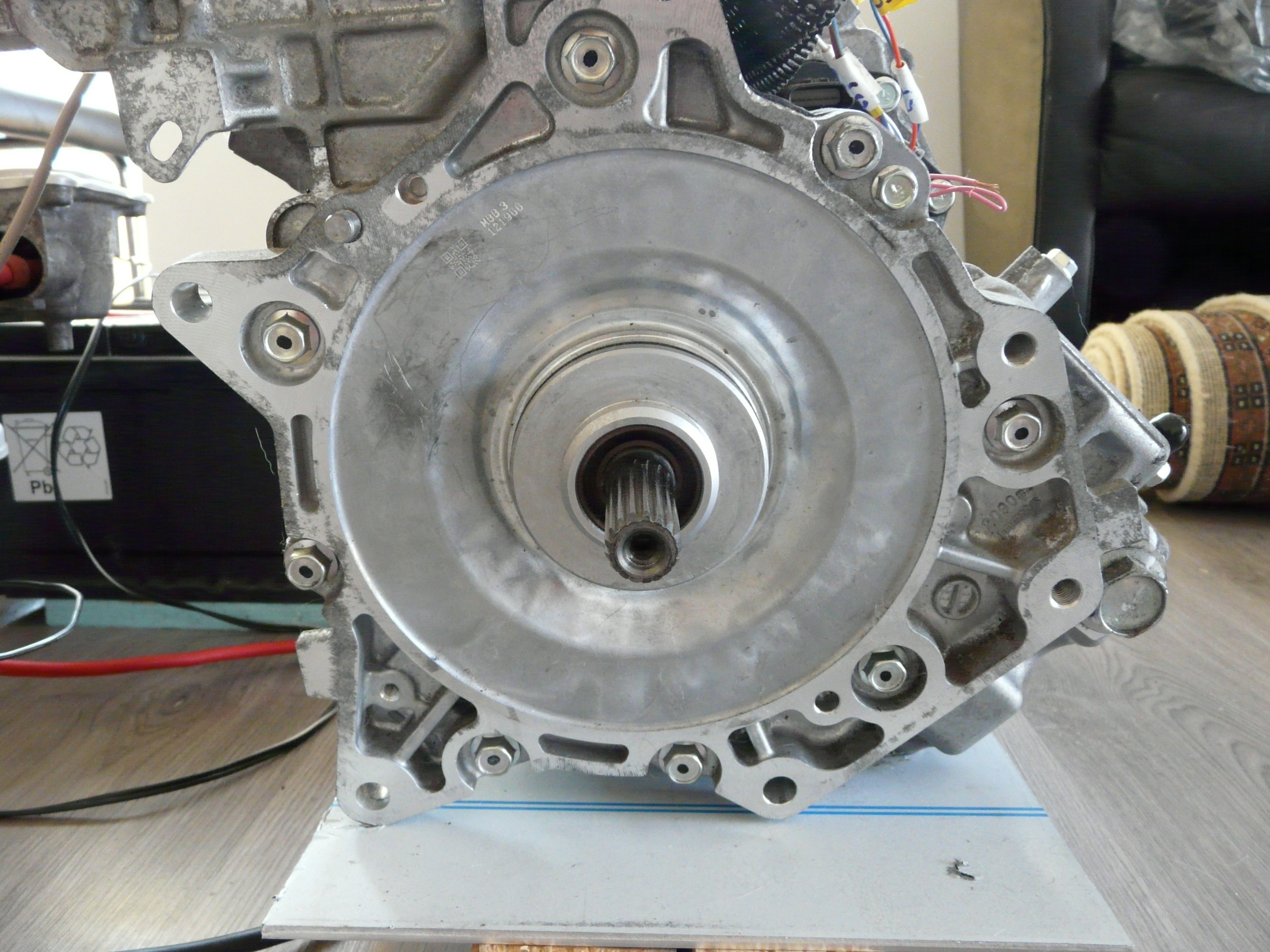

SINCOFS SETTINGS blocked through PRECHARGE warning
DIETZENBACH
- Posts: 62
- Joined: Mon Jan 03, 2022 11:34 am
- Has thanked: 22 times
When trying to set SINCOFS settings , I am receiving in the Plot-Window the message PRECHARGE,and the motor motion get blocked.
At inital start there is no Precharge message and the motor is slowly turning in jittering mode. When halted an restarted again ,the Precharge message pop up and the motor rest silent.
What kind of resistor or device should I use to elminate the precharge and let the motor run.

The error is because your voltage is below (udcsw) setting. So the precharge is not "finished"
If you are using a power supply for testing you can set the (udcsw) to 0. If you are using a battery and contactors set is to a reasonable value.

Hi Manny,
Thanks for the advice.I am setting always the udcsw to the proper voltage I`m using-battery and power supply. Will retry it again

Do you have UDC in the web interface?

some test performed as follows :
1 test with brake and start reles/contactor off:
UDC = 0 or 200V
manual run
lasterr-none,
status -none
different manualID -values set,but motor do not move.
2.Test -- Inverter HALTED
angel graf ON
motor cliks but no run
opmode - =RUN
3. Test INVERTER ON
no angel graf available
no more motor clicks
opmode -= run
UDCSW - =0 or 200v
manual ID different -values set,but motor do not move.
lasterr -none
status -none

What motor and inverter are you using?

SEIKOSH MOTORA japanes motor and PRIUS GEN 2 inverter.

When the inverter is in Run mode. With Id and Iq 0A. Can you graf the motor angle while spinning the motor by hand?
Can you post the output from http://192.168.4.1/cmd?cmd=json on the inverter

The graf angle in run mode is going by itself.turning the motor by hand is not changing the graf pattern.
Here is the JSON file for refference.{
